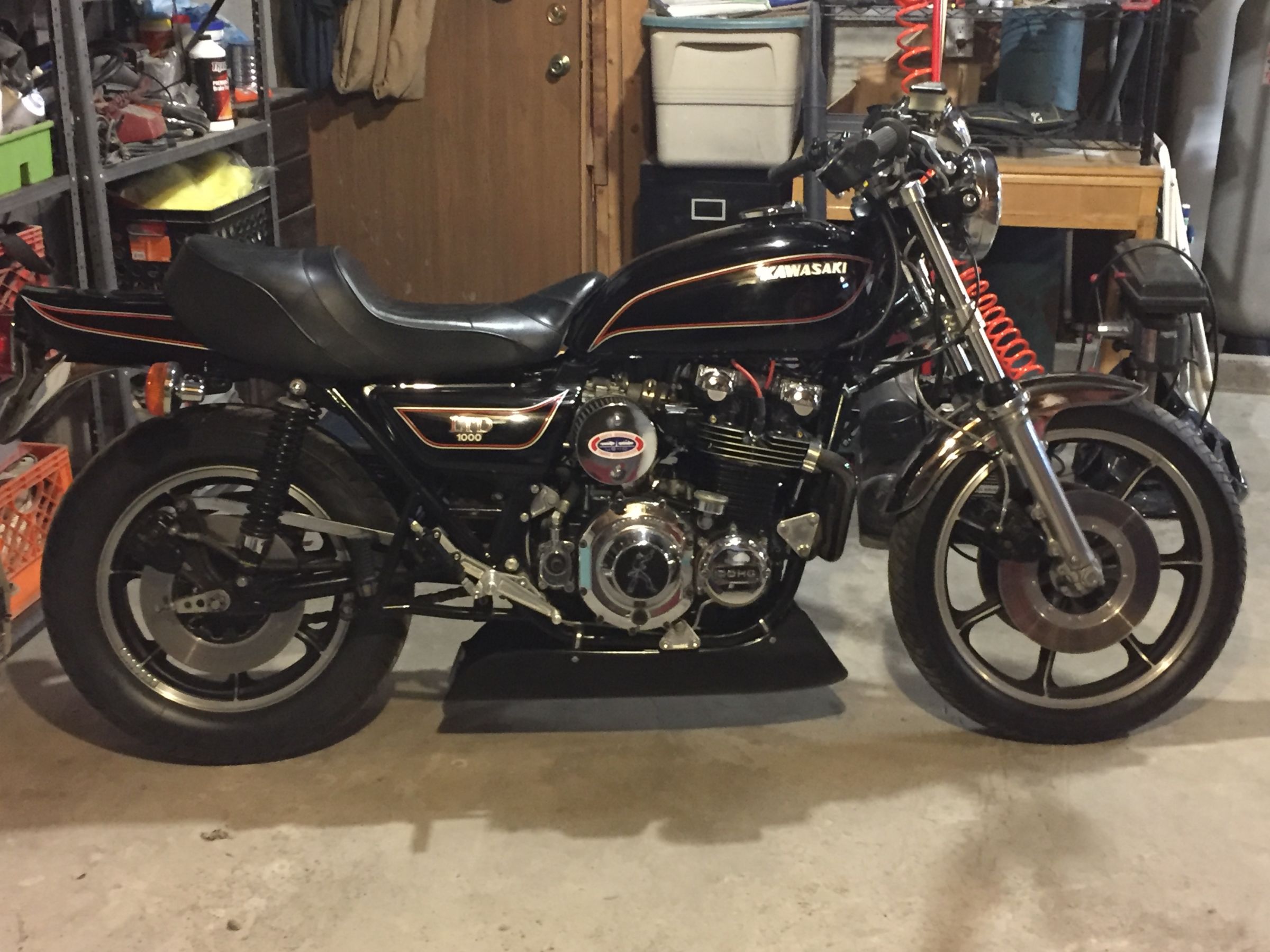

Thanks for the info Does this bike look familiar . I call her Black Beauty This is my 1978 LTD

jumbulias wrote: Thanks for the info Does this bike look familiar . I call her Black Beauty This is my 1978 LTD
Ahh Yes :P
Brings back memories of where life began ;)
Dave B) B) B)
Now mine looks like this
Mine is called SUZIE B)

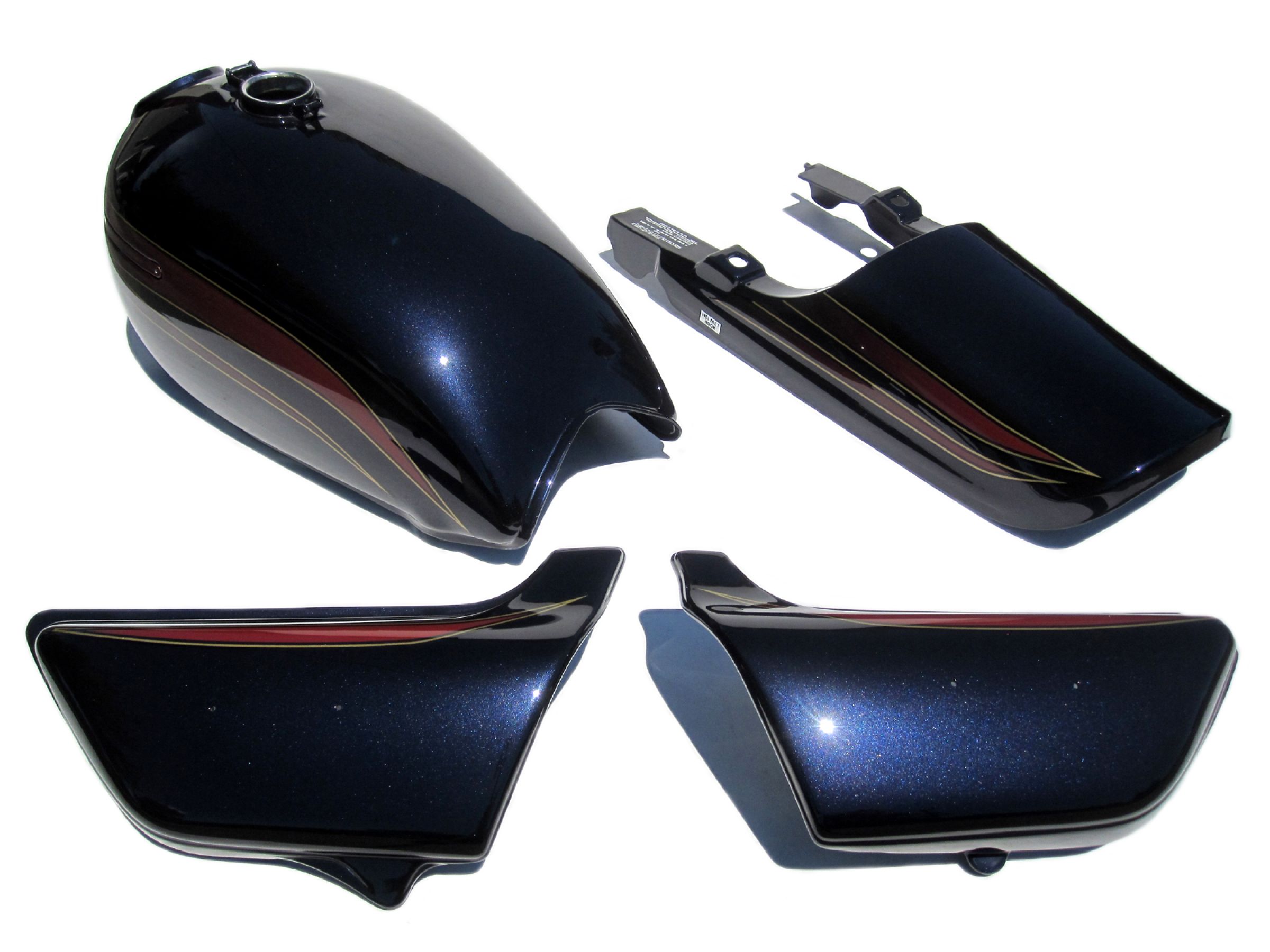

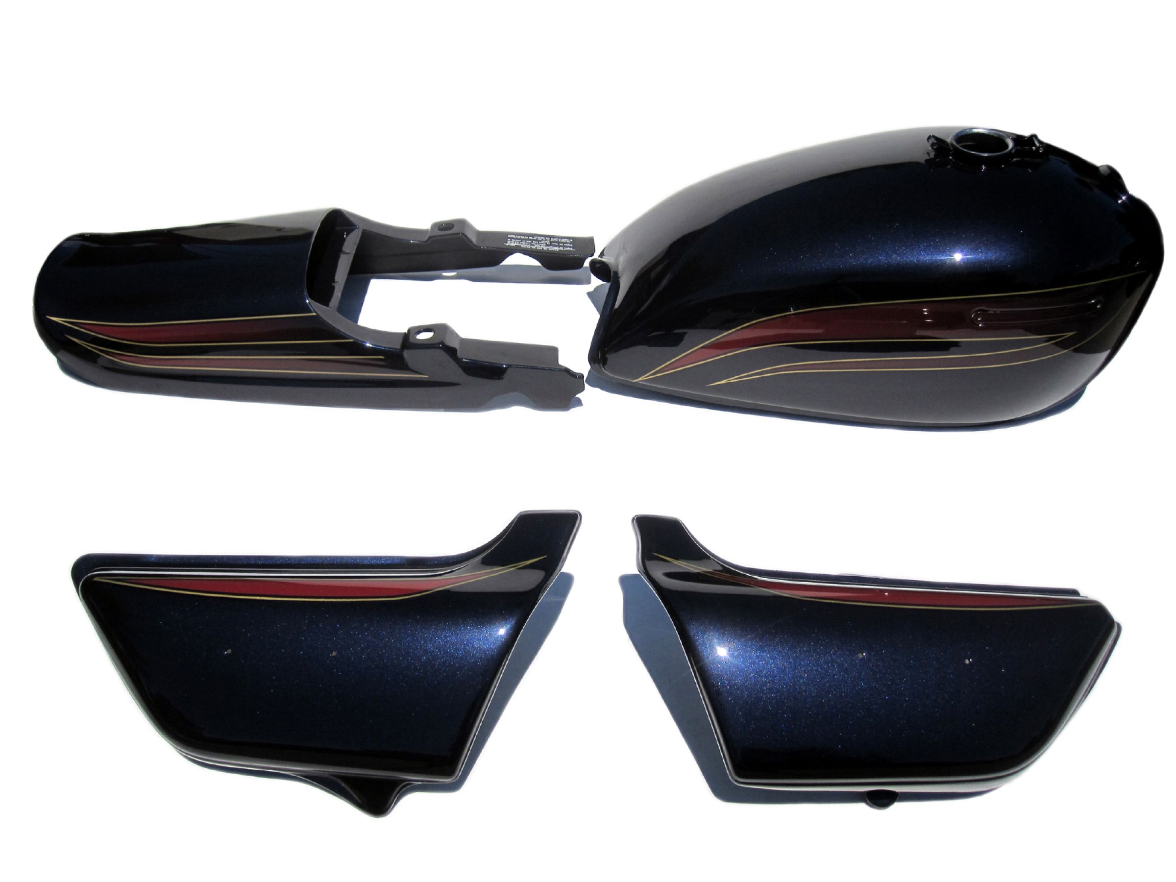

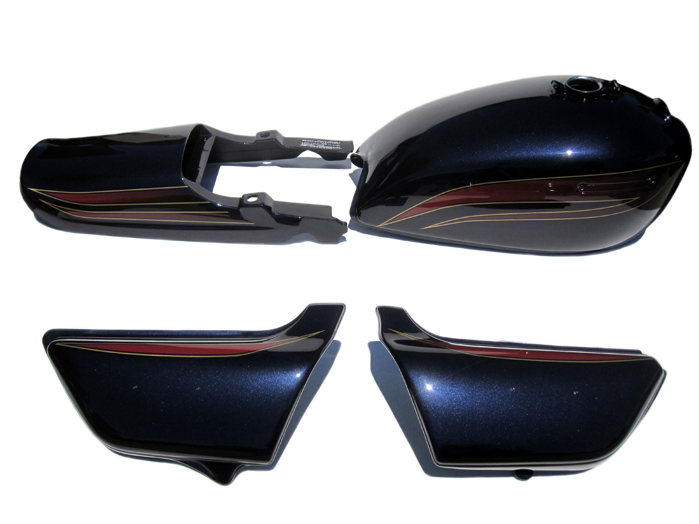

Here is a couple of Pics of the !977 body Set. Painted by WFO .
