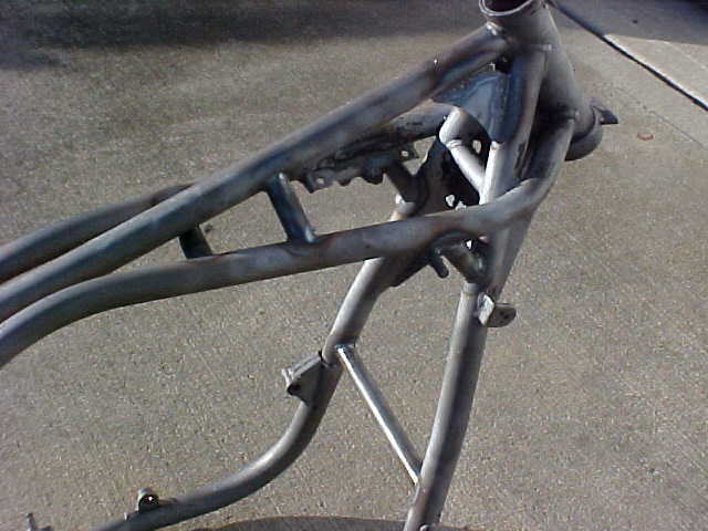

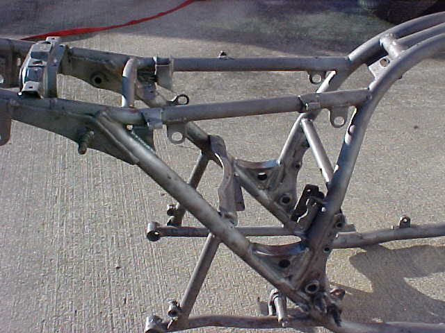

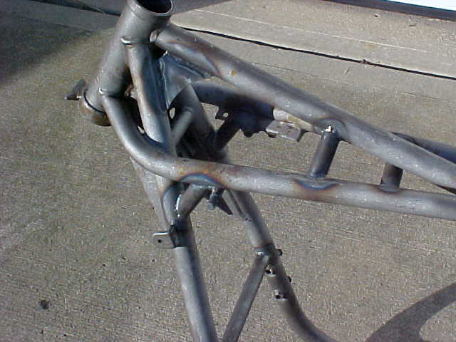

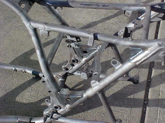

Got the Frame Brace Kit Tig Welded in. Here are are some Pics. Powder coating is next. Have to save up money for it.

man this thing is turning out awesome. Following along.

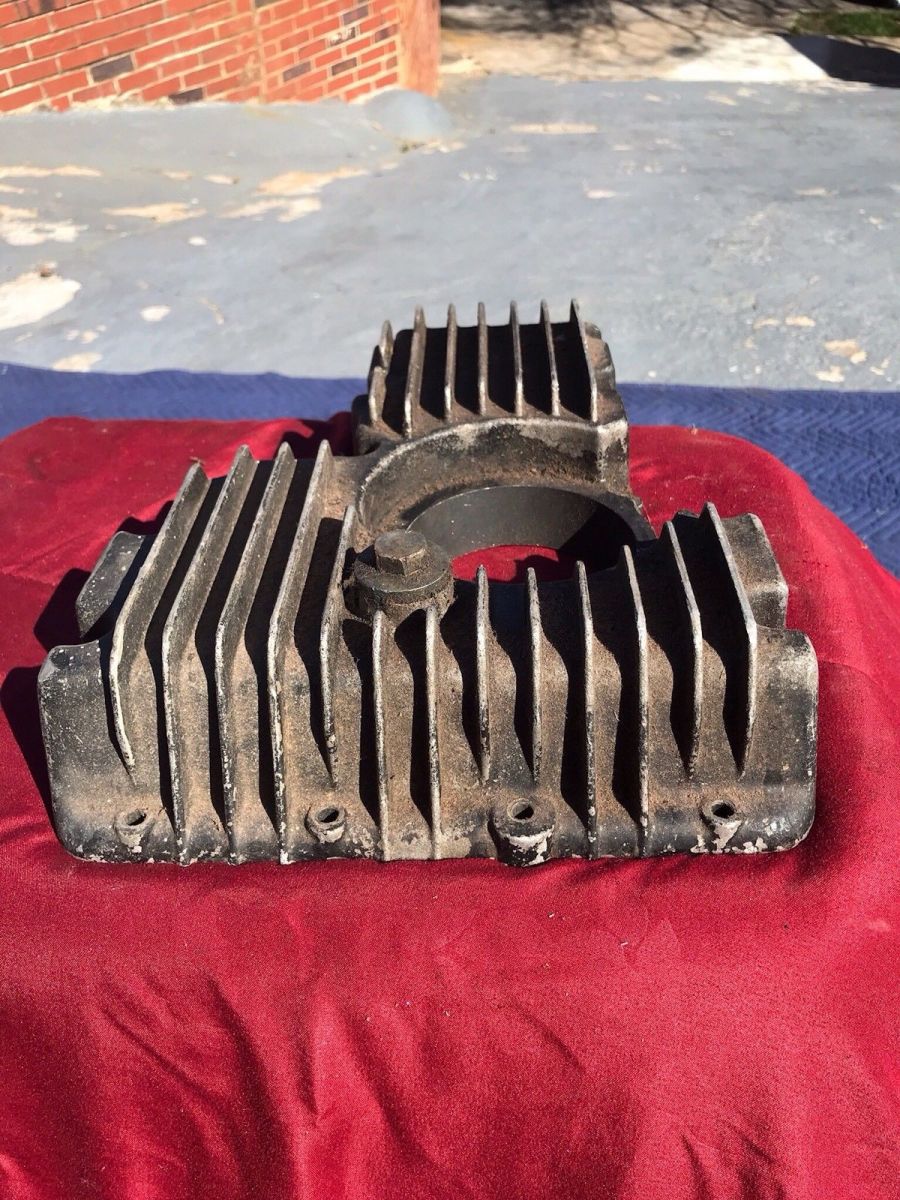

Got A Deep Pan. Should Refinish Well. Know looking for oil pump extension. Hopefully back to work on it soon !!!
- zed1015
- Posts: 3368
- Thanks: 2075
Re: What size Piston kit to run with Mr Turbo kit
01 Apr 2018 15:25 - 01 Apr 2018 15:36jumbulias wrote: Got A Deep Pan. Should Refinish Well. Know looking for oil pump extension.
Nice find.
I have one just the same.
I scored an unused Turbomaxx billet pump for mine in a trade
30% extra flow but they are not cheap new.
The stock pump is easily extended though if you have access to a lathe.
Those pans have excellent baffling so no need for a rear pick-up.. Just extend downwards.
The early pumps can have it as a bolt on mod and the later ones a light press fit extension with 3 tig spots to make sure it stays put.
