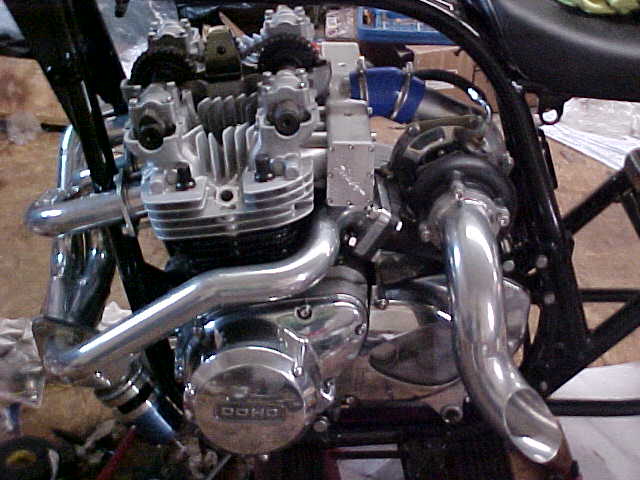

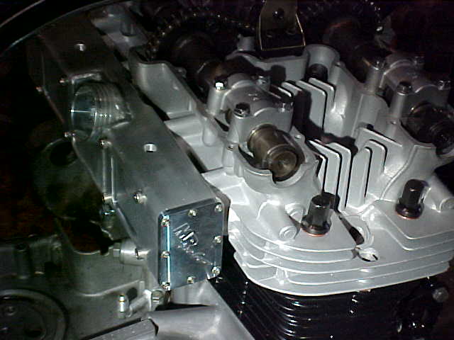

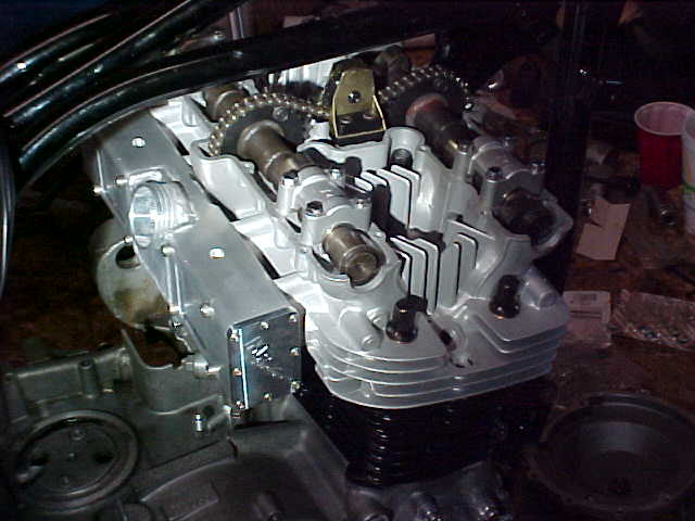

Finally had some time today . Got the gpz1100 Cams Installed . And installed the manifold and Kick starter cover drain.
  • Street Fighter LTD
  • Street Fighter LTD's Avatar
  • Moderator
  • Moderator
  • Posts: 5184
  • Thanks: 2339
Re: What size Piston kit to run with Mr Turbo kit
26 Mar 2017 04:56
#757718

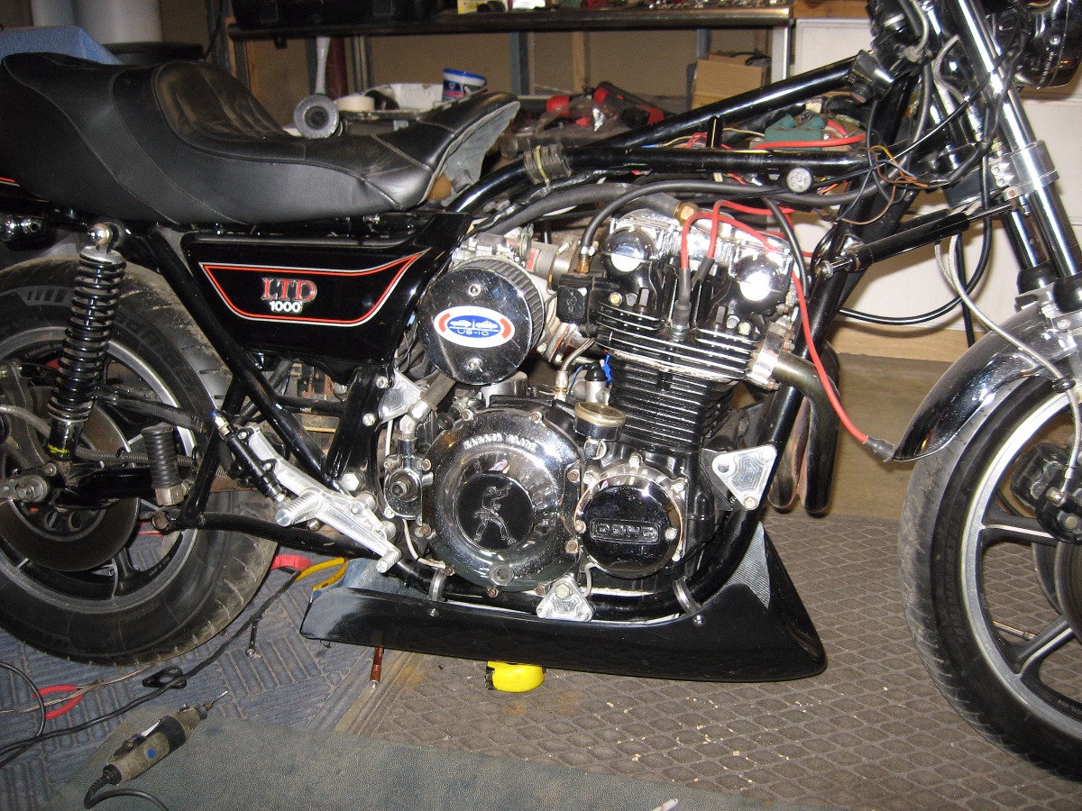

I love the redesigned intake manifold !!!!!!!!!!!
Dave B) B) B)

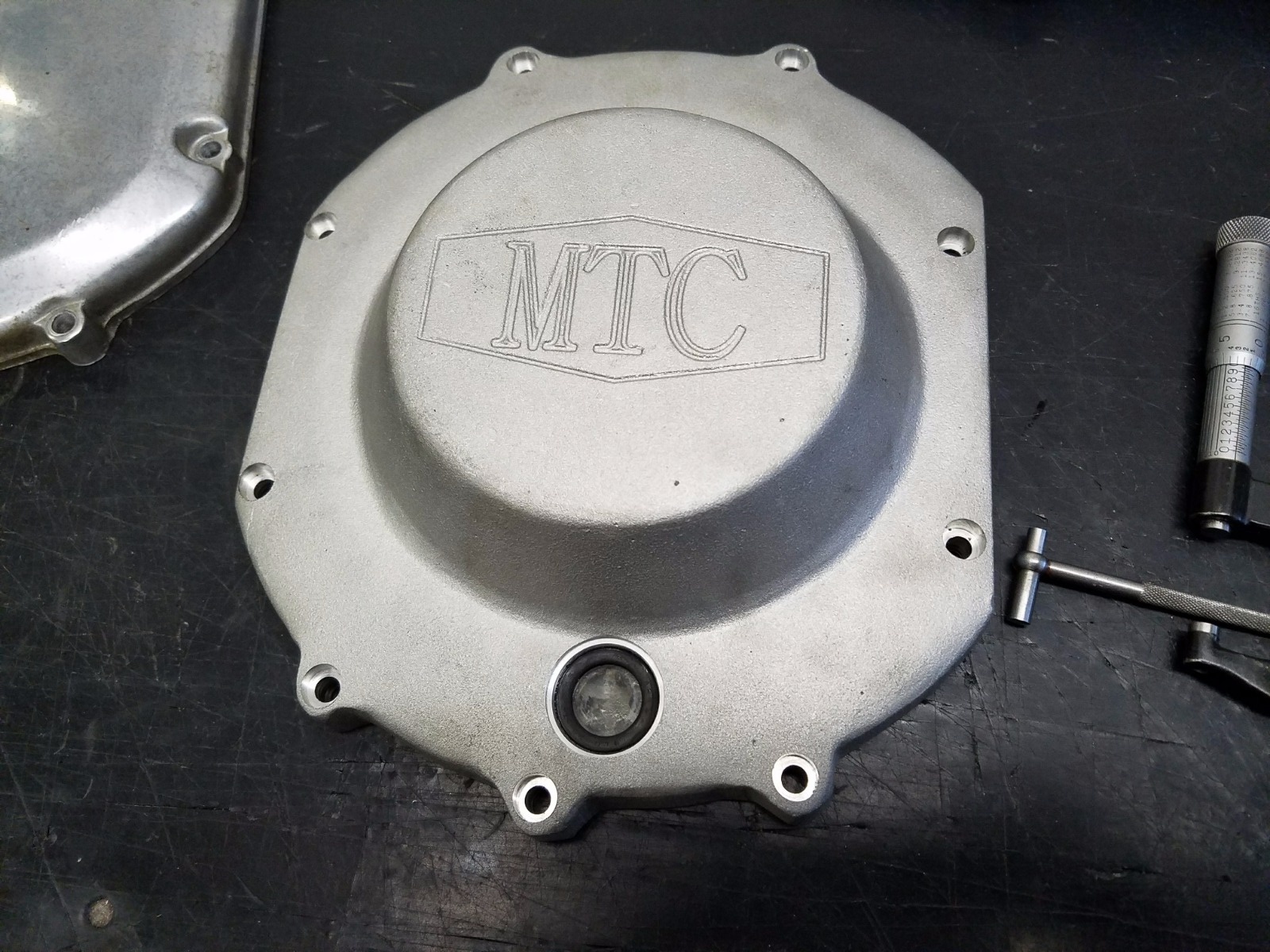

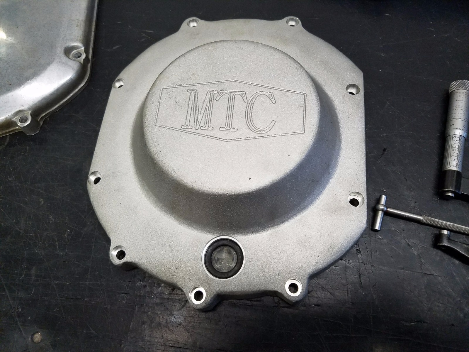

Going to Degree The Cams Today, Here is a Pic of the Clutch cover, I had oil level window installed in it.
13 May 2017 05:33 - 13 May 2017 05:34
#761867
Nice cover
The Karata Glide Covers came with a oil sight glass
Last edit: 13 May 2017 05:34 by Street Fighter LTD.
  • Moderator
  • Moderator
  • Posts: 5184
  • Thanks: 2339

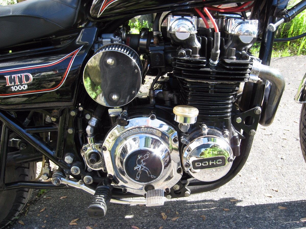

13 May 2017 07:27
#761873
I was just thinking about your cover.
If you are going to use stock foot pegs and brake pedal as shown in the old picture of my bike you should look into widening your brake pedal. THe MTC cover will keep your foot from being able to fit over the brake pedal correctly. I added to my pedals width by welding on a half of a pad I cut off another extra pedal. Since then I have gone to rear sets made by Les Holt at PDM which you can see in the picture I posted at the beginning of your thread. Now would be the time to do this as fishing for the rear brake while on boost is to late
Dave B) B) B)

Thanks for the info. Your bike is very nice.

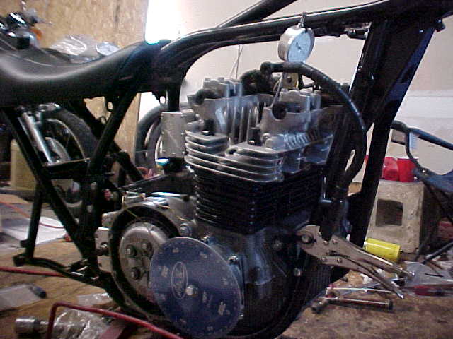

Camshafts have been Degreed . What a Pain. Set at 108/112

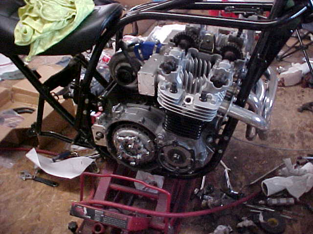

28 May 2017 16:51
#762981

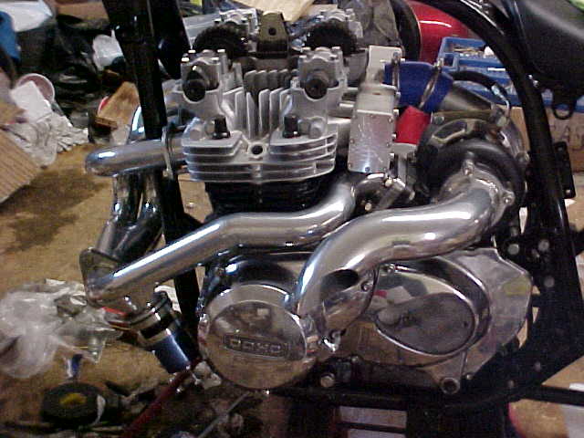

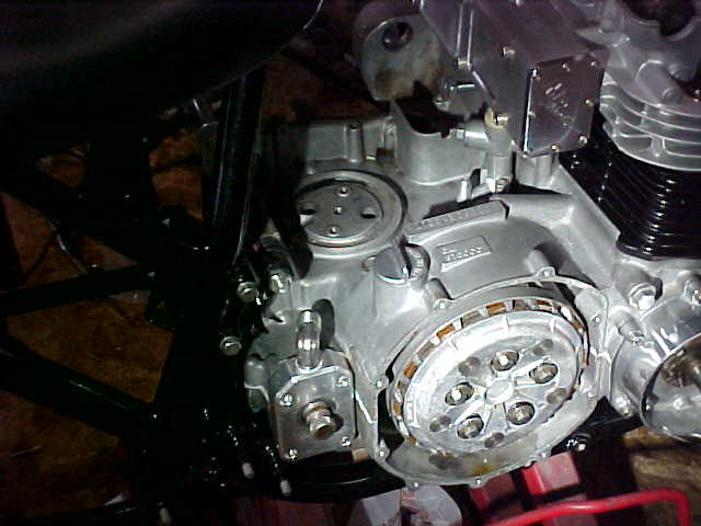

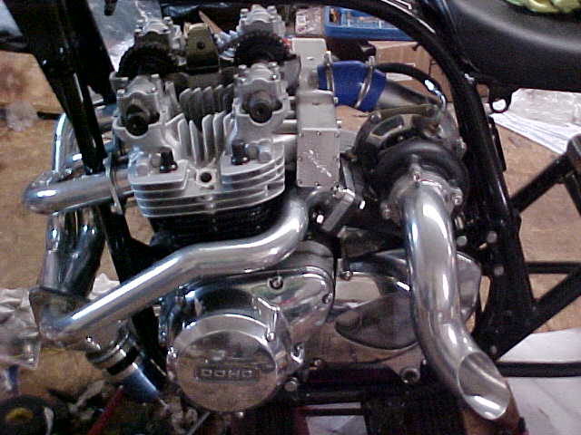

Got a little bit done today!!!!!!!!!!!

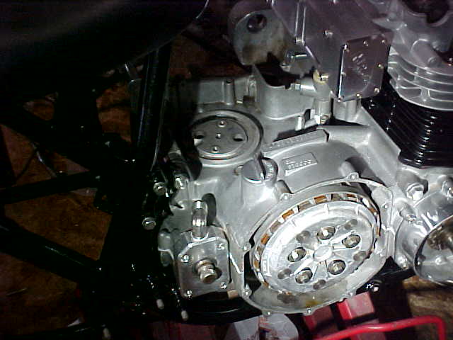

28 May 2017 16:52
#762982
  • jumbulias
  • jumbulias's Avatar Topic Author
  • Posts: 96
  • Thanks: 23
28 May 2017 17:02
#762983
Think the banana pipe goes this way.
