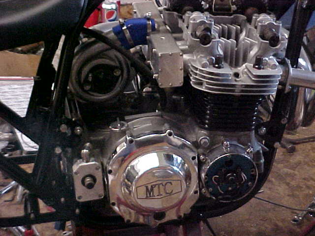

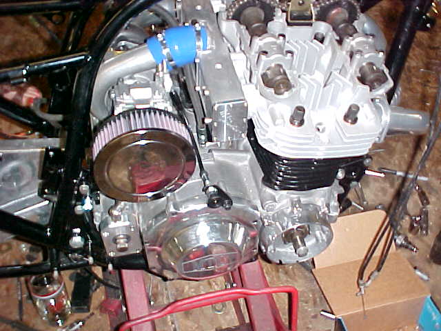

Clutch Cover buffed out pretty nice. Used Menzerna buffing compound, It is the best by far!!

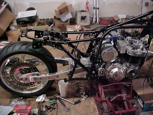

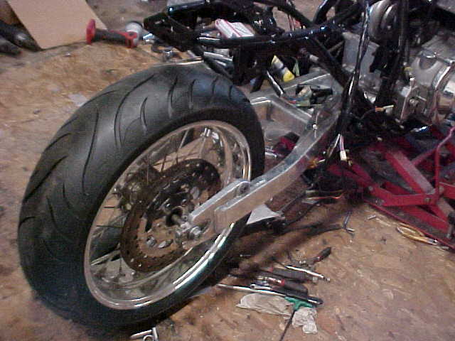

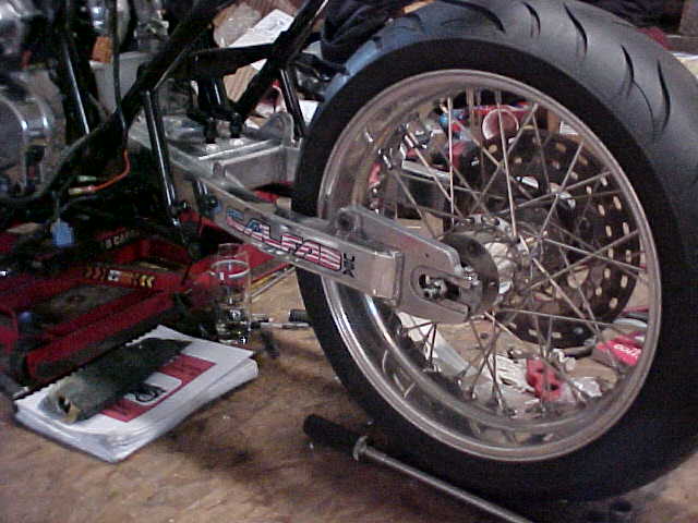

Finally found a swingarm Looks nice with 180 tire.

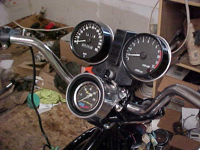

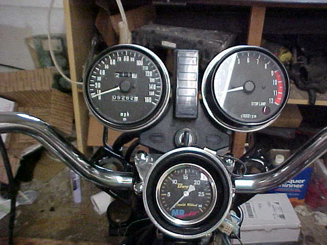

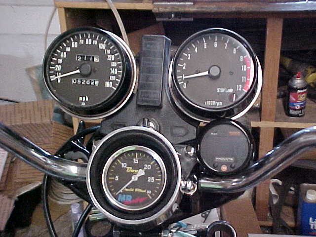

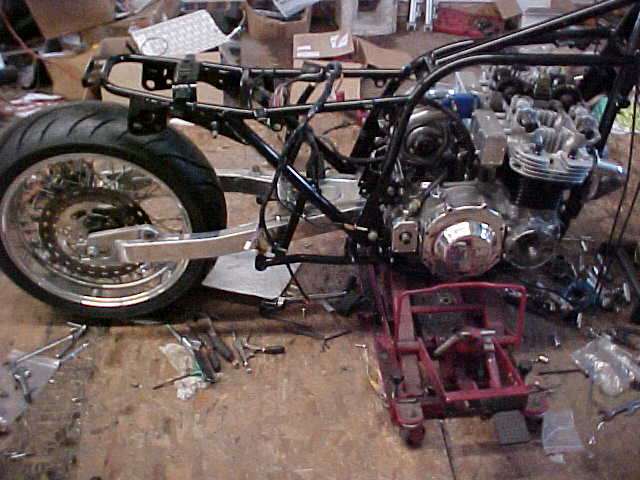

Off work this week Hope to get alot done. Here are some pics. Electronic Tach , Boost Gauge , etc.

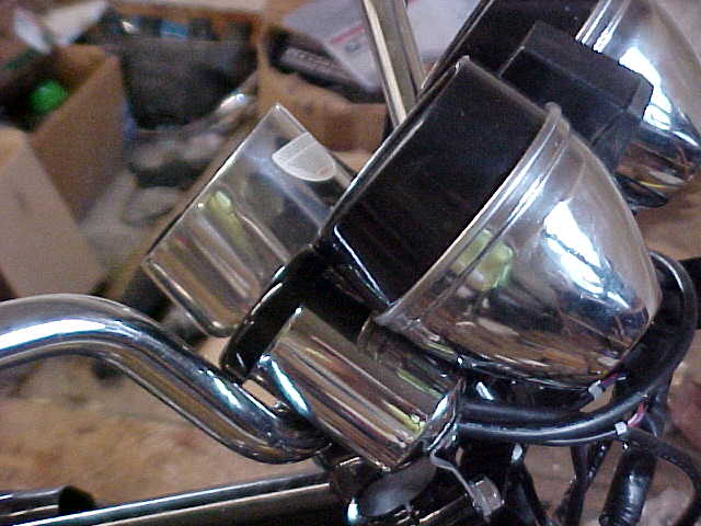

Found a spot to mount The Innovate SCG-1 Wideband Gauge , Made a little bracket that mounts to the Triple Tree. The fun part will be installing the wideband sensor.

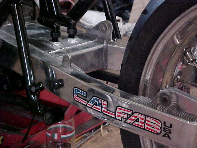

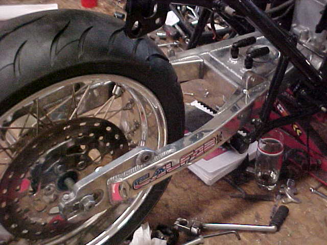

Made a oil catch in the front of the Swingarm. Welded 2 bungs on top 1 goes to low profile breather cover ,other goes to crankcase breather filter, and one on bottom for drain port.

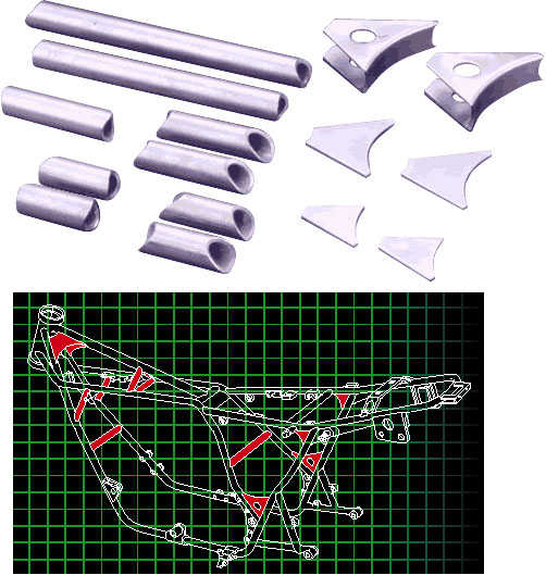

Love what Im seeing. Have you given any thought
to bracing the frame and getting stronger motor mounts
Dave B) B) B)

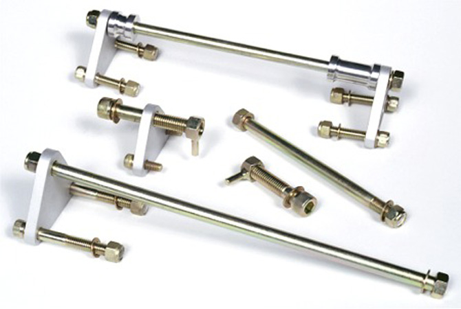

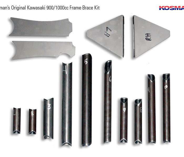

Hello Dave Yes I have been thinking about it. I like the Pingle Motor mount kit and for the frame bracing either the Kosman kit or making it myself. Low on funds at the moment.

Went ahead and ordered Pingle Motor mount kit . I also found a frame bracing kit from PMC Part # 74-0020 looks nice

I went ahead and ordered The PMC Frame Kit . Should be here in a week

Glad to hear you are doing the frame and mounts . I would hate to see all that boost cause you grief
with a wobbling bike. Keep up the good work
