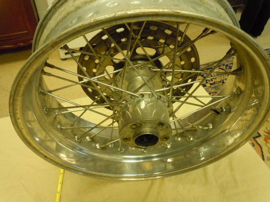

17 Sep 2016 13:04
#742626
Finally found Akront 18- 5.75 rim for my project..Know looking for extended swingarm.

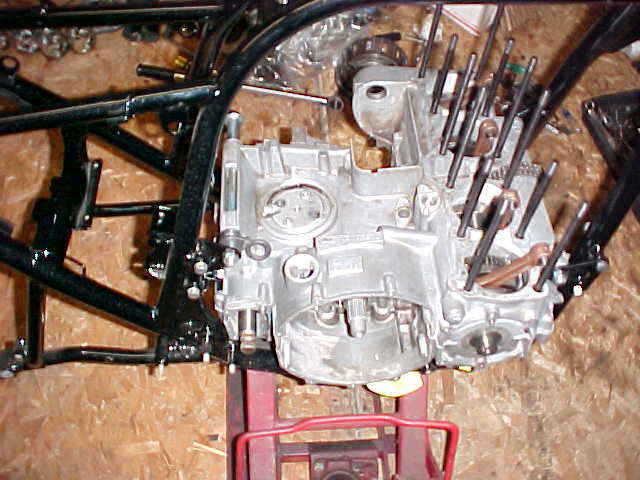

14 Jan 2017 15:30
#752196

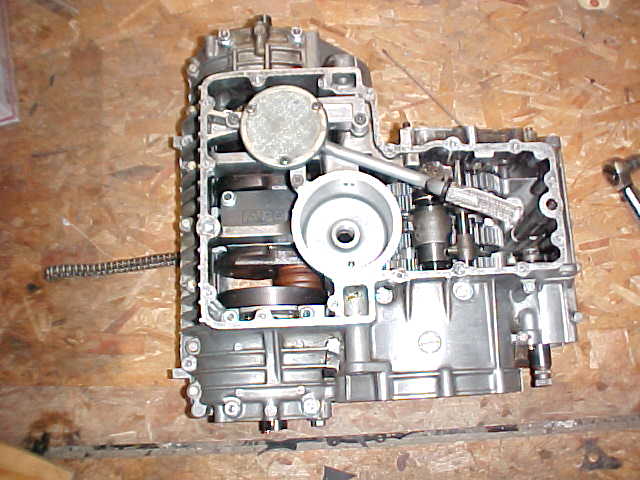

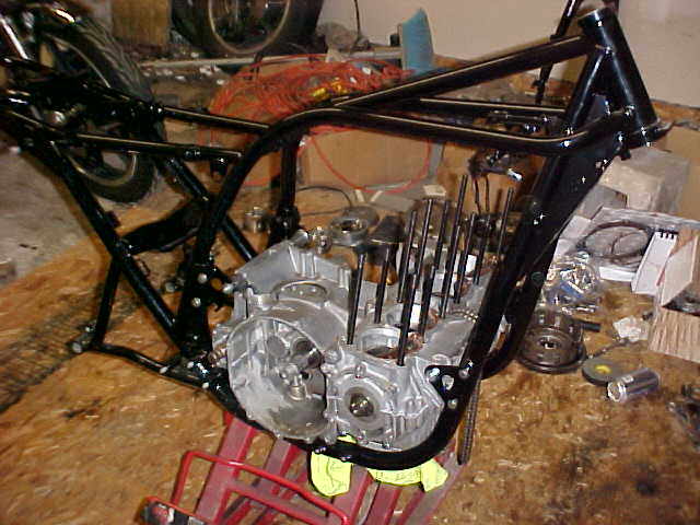

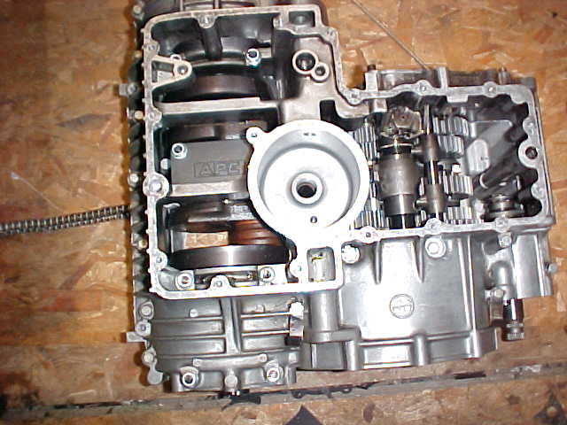

finally got a little bit done today. Got the crankshaft, trans and cases put back together. and installed in the frame.

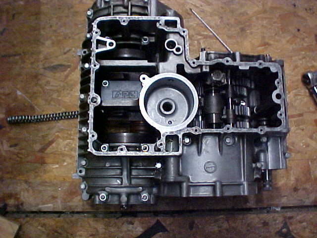

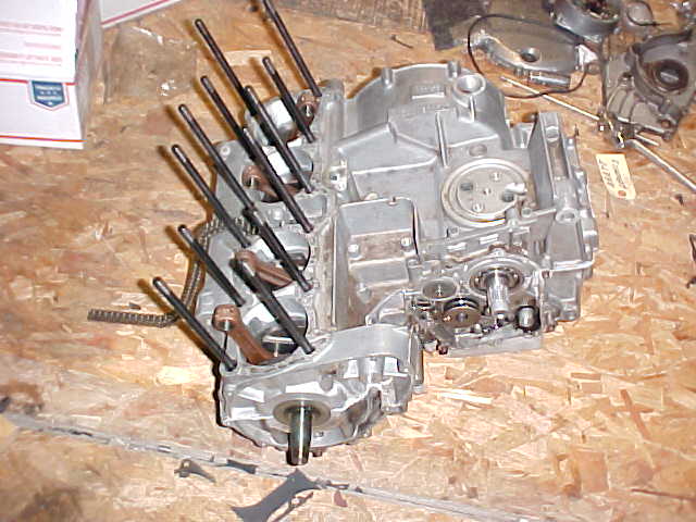

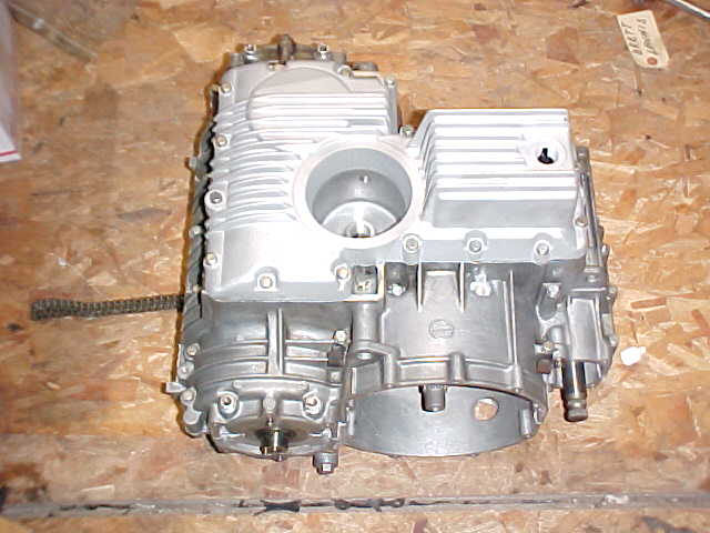

14 Jan 2017 15:32 - 14 Jan 2017 15:39
#752197

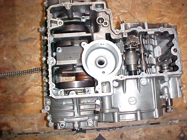

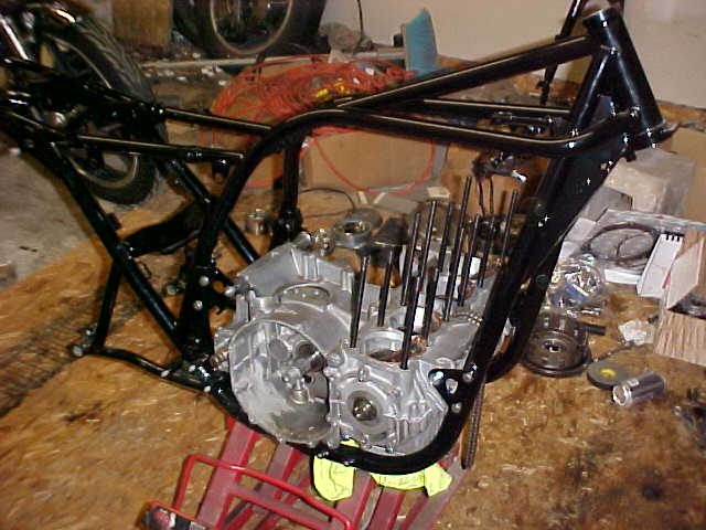

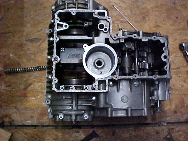

more pics

Re: What size Piston kit to run with Mr Turbo kit
14 Jan 2017 15:34 - 14 Jan 2017 15:39
#752198
Will be installing the block with the MTC 1197 Turbo pistons next
15 Jan 2017 05:40
#752227
Awesome
I cant see clearly in your pictures if the oil pickup is set to be down into your rear deep pan.
Bad camera angle ?
Oil pickup should be about 3/4 of a inch above deep sump bottom
Keep up the good work !!
Dave B) B) B)
  • JOE MKII
  • JOE MKII's Avatar
  • Posts: 99
  • Thanks: 25
15 Jan 2017 06:39
#752233
Cool project, I always wanted to do a turbo but never have mostly because of the $$$$.
Looks like its being done well.
One question, I am new to KZ's so I don't now much, but doesn't the clutch hub have to go in before the cases are put together, or is it different with a lock-up clutch, or on different year KZ's
16 Jan 2017 13:05
#752312
Thank You!!!! Looks like I am back to the drawing board. Totally forgot about the clutch housing.. I thought about sending the clutch housing to Ape Racing to be be rebuilt with there heavy duty kit, looks like I will have time know. Thanks Again You saved me alot of time in the long run.

Thanks for the info. I will check that out when i Split the cases again. I forgot to put the clutch housing in. Did you have ape racing rebuild and weld clutch housing on yours?
