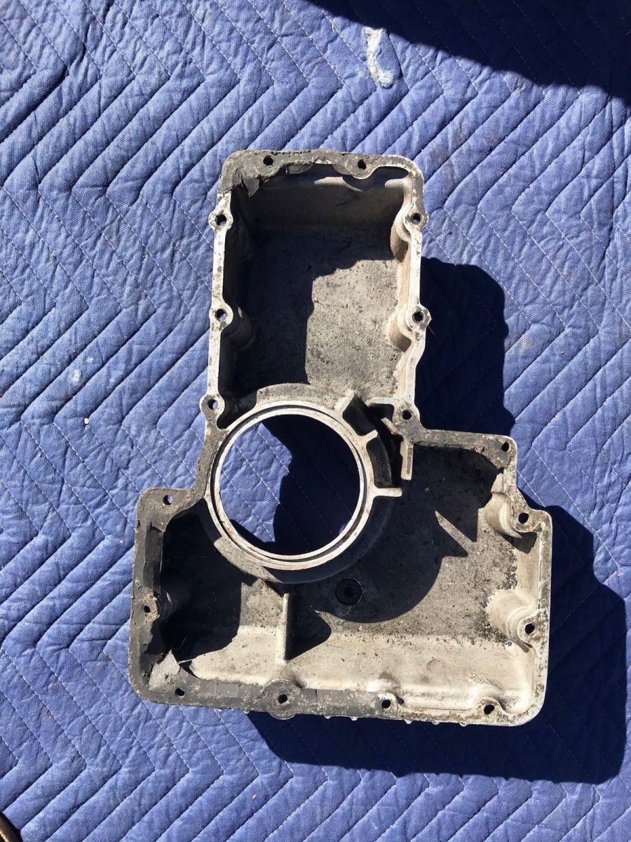

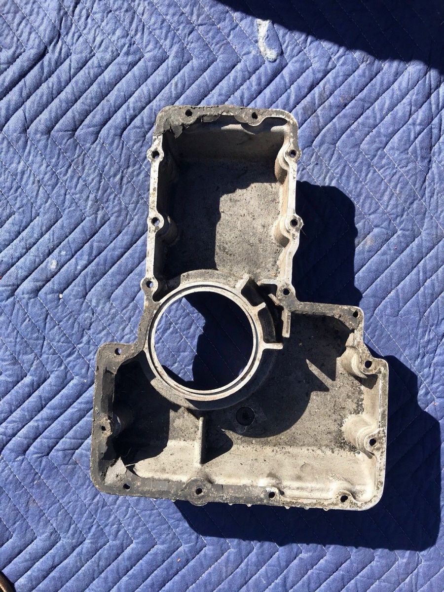

No need for a gate on these deep sumps.
They have a superior baffle design which limits oil flow to the back of the sump under acceleration but allows a less restricted path for the oil to return.
Look at how the baffle webs are orientated.

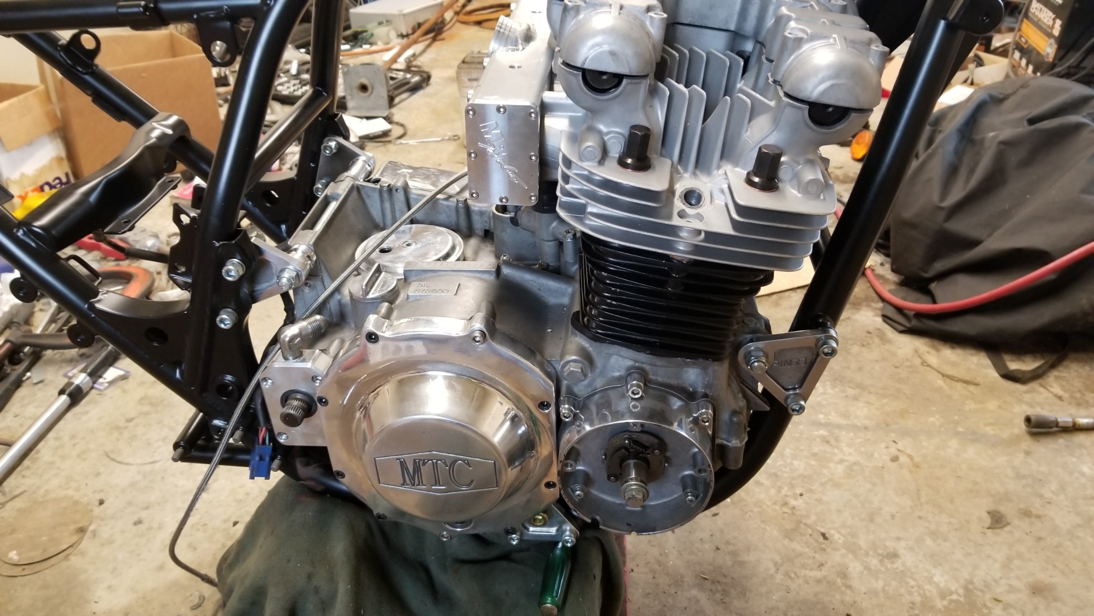

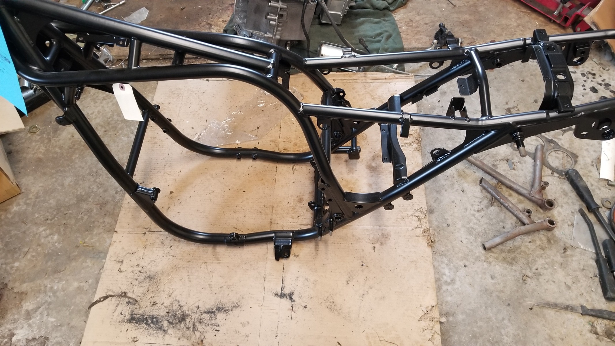

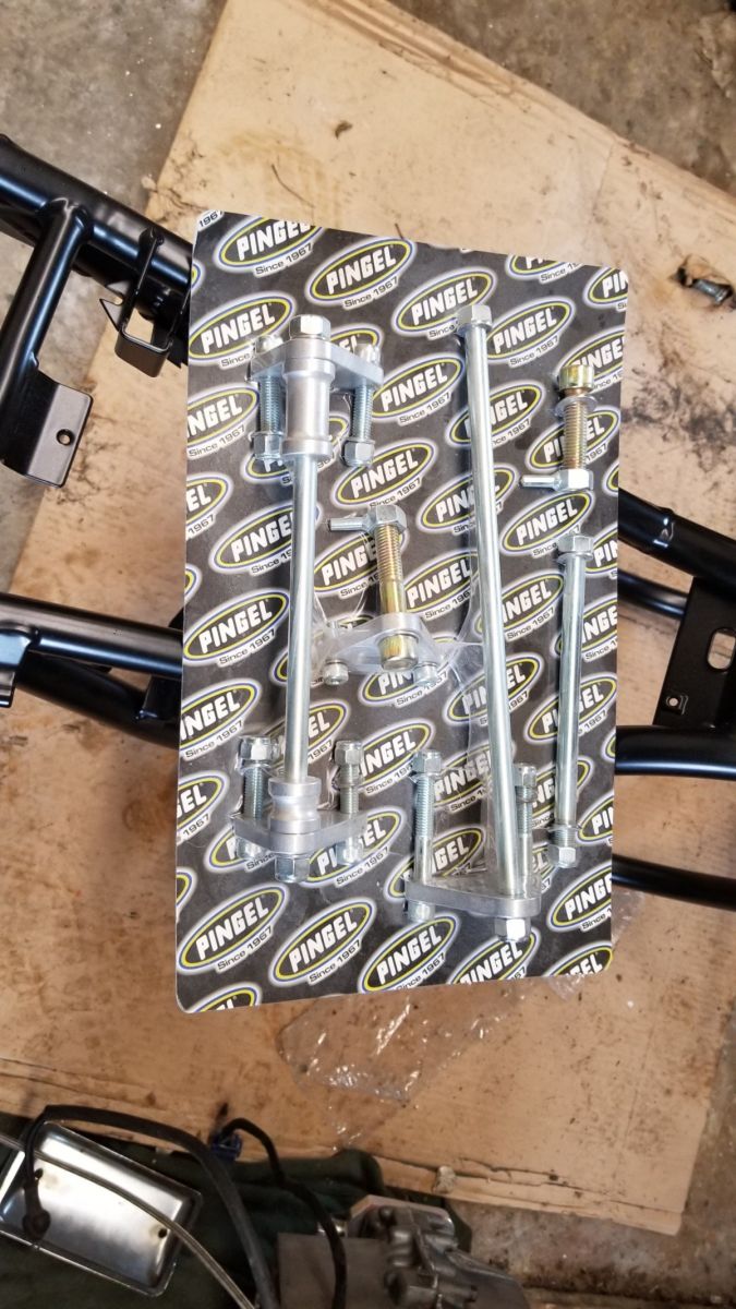

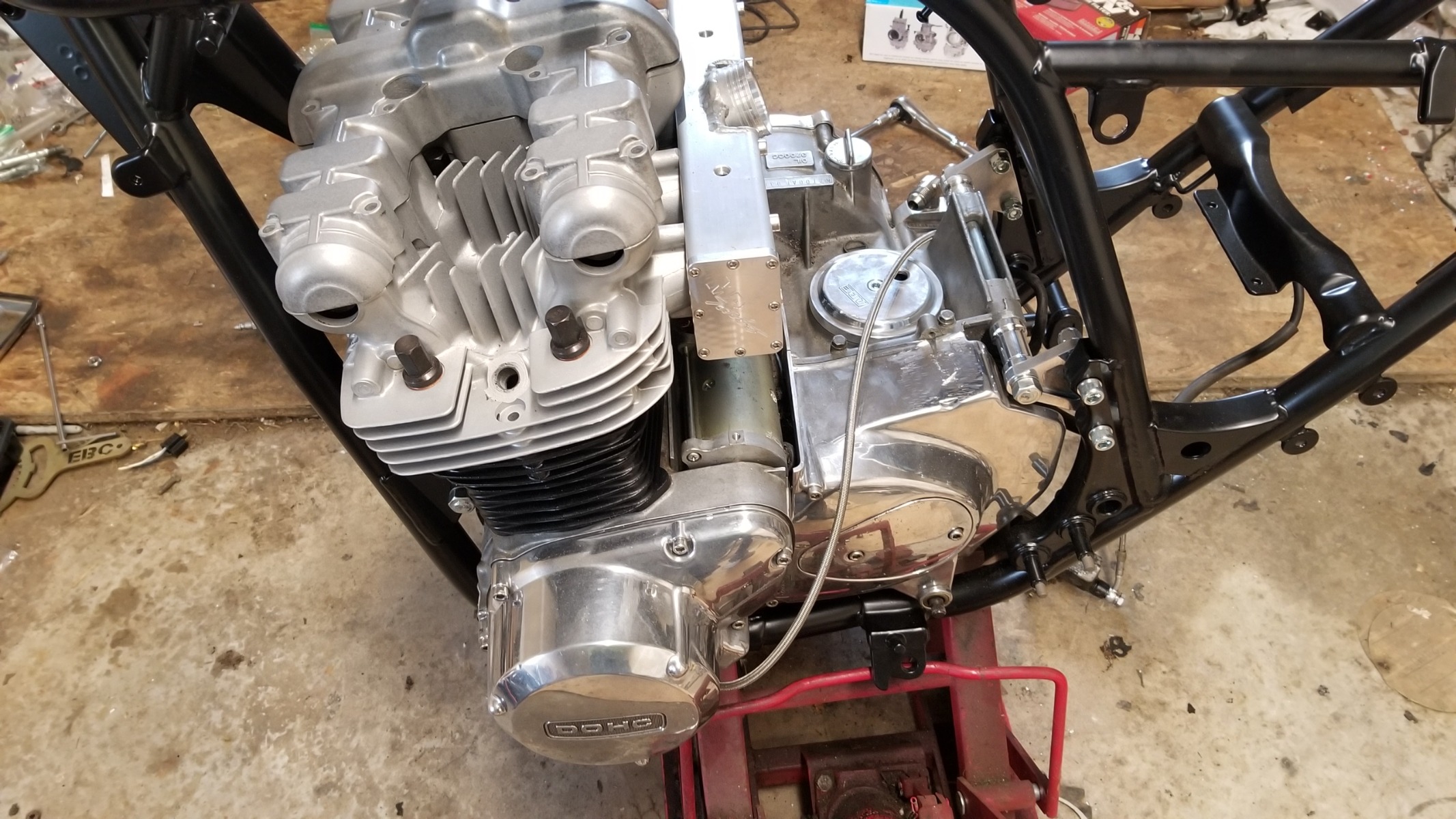

Re: What size Piston kit to run with Mr Turbo kit
27 Oct 2018 14:40
Hello yes I got it. Thanks

- Posts: 5124
- Thanks: 2316
28 Oct 2018 14:00
WOW
Get that bike done so I can feature it as a BOTM !!!!!!
