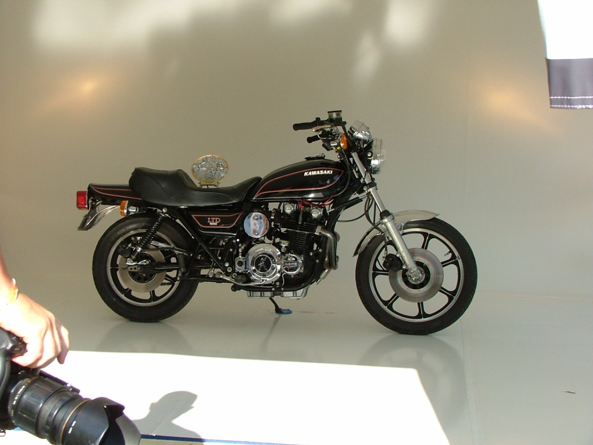

- Posts: 5194
- Thanks: 2341
Re: turbo time....
31 Dec 2012 13:47Lorcan wrote: He never rode a good one
You Tell it Lorcan !!!
My experience with Turbocharging has been very positive.
Ride it coast to coast , Put in good fuel and turn up the boost and go racing , Then ride it home without burning down a high compression normally aspirated motor. ASk the guys I rode the RELAY with here in Michigan. Fast, Can Tour with it and reliable ( other than flat tire LOL )..
OH And A Very Happy New Year to all you Gear Heads

- Posts: 5194
- Thanks: 2341
Re: turbo time....
31 Dec 2012 14:18les holt wrote: Streetfighter, are you running a boost controlled fuel pressure regulator and what kind of boost you run on pump gas?
Les
Shhhhh !! Its a secret :whistle:
To be honest I dont boost the motor ( WOT ) for much longer than a few seconds , as thats all I ever need to on the street to pass anyone foolish enough to run against me , Or to get my blood flowing at a very high rate LOL.
Run a Holly Blue pump at 3.5 psi. and run premium pump gas all the time, unless I know my son will be riding it and out looking for trouble, Than I run Turbo Blue Fuel.
I have the accelerator pump setup to come on very quickly to keep the mixture FAT.
I give up the ragged edge of tuning the bike for peak performance as I want the motor to last a long time so Jetting and all fuel input is set up Fat I guess its all personal , but I ask myself. How Fast Do I Need To Be ??? Answer is Fast enough to have fun and stay out front
Happy New Year My Friend
- Posts: 5194
- Thanks: 2341
Re: turbo time....
31 Dec 2012 14:39
Just looked and forgot to answer all the question .LOL
No boost sensing fuel regulator but would be nice..
Run 15 to 20 pounds of boost for no more than 5 to 10 seconds at a time , or thru 2nd and hit 3rd gear shift. Have hit close to 30 pounds of boost during some Banzai passes or on dyno at local college and thank God didnt hurt anything
