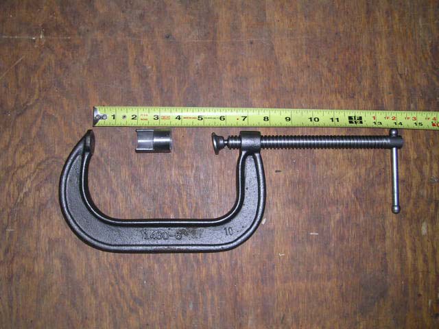

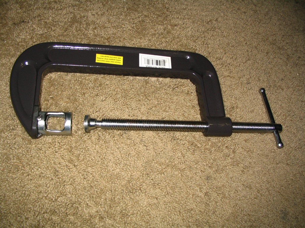

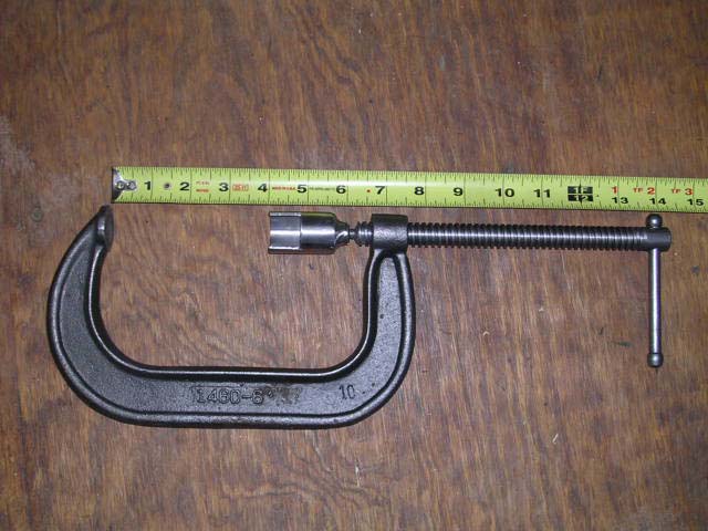

look at the tool the guy used here for removing valve keepers:
www.lextreme.com/valve_seals.html
anyone ever used something similar? it looks like a life saver as far as what i am wanting to do.

This is a little short on details, but here's something that was posted in another thread about changing valve stem seals without removing the head:
Oh and you could change the stem seal when you go to adjust the valves, no reason to remove the head. Hold the the valves in place with shop air, while at TDC firing position. Then you can take the spring off and change the seal. Really the valve can go nowhere when the piston is up, the shop air is to hold the valve to compress the spring.
