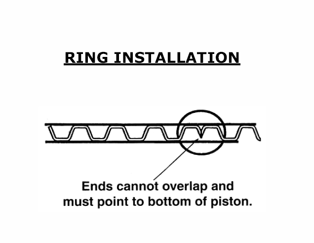

Looks like somebody pinched the very thin and delicate oil rings AND/OR misaligned the oil rings :whistle:
btw, did you get the cylinders honed when put the new rings ?
Maybe you rings never seated properly...possibly out of specs cylinders ?

EDIT: don't forget this
:whistle: :whistle: :whistle: :whistle:
