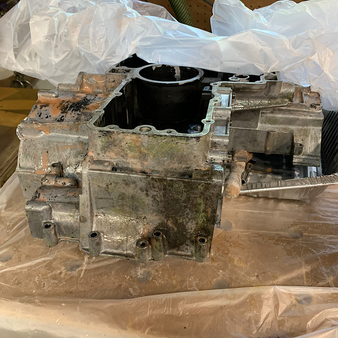

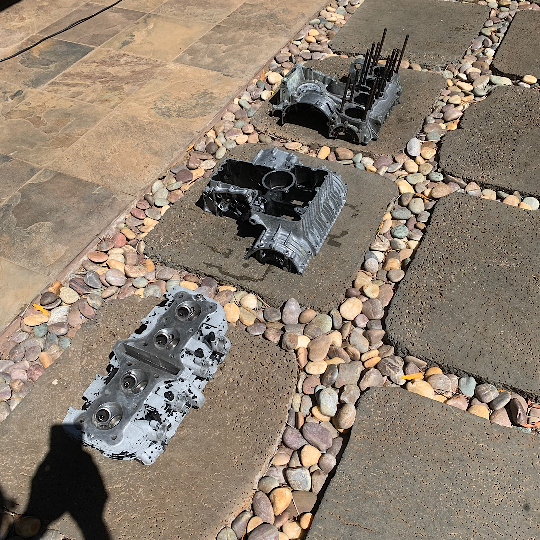

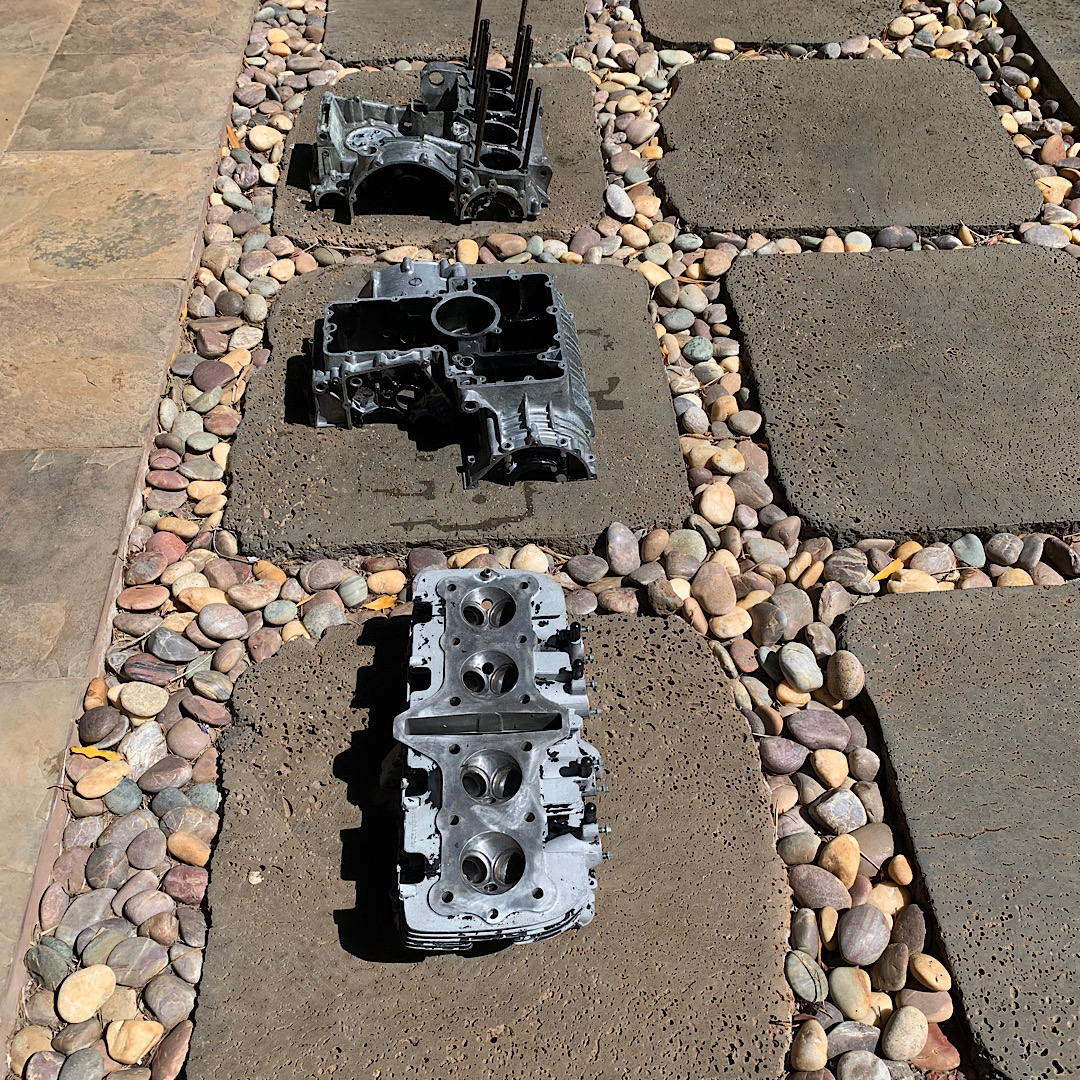

The Citrus Strip paste I found seems to work very well, attached is the result of the first application and pressure wash, it's getting the second to catch what was missed. A little more hand work and it will be paintable after serious degreasing,

A little tip I found handy when stripping hard to do parts, with gloves on, use some steel wool and stripper to clean all the hard to get and stubborn bits of paint, works a treat....

I will try that. It’s cleaning up faster than I expected. The head will of course take some work due to the fins.

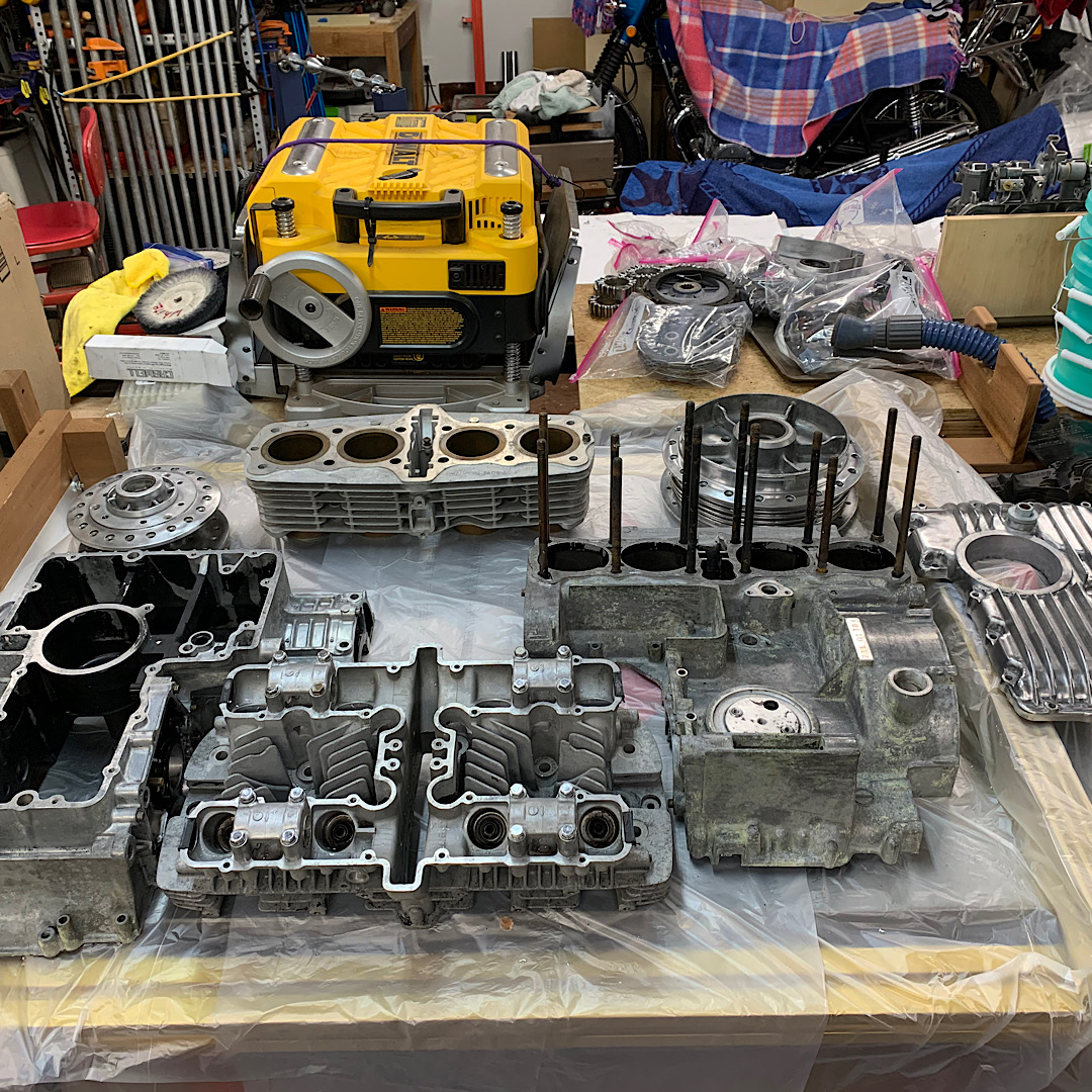

Starting to cover everything up for bead blast, it will take some time. I have to bring beads in from Oahu.
