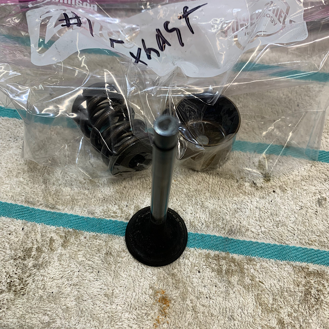

Fnally got my valve spring compressor.
Removed the valves, some of which were pretty sooty. I think this is due to the choke plungers not sealing well making it rich. I sent the plungers to Robert Meggitt in the UK, he does some magic on them. The valves are cleaning up, the compression was good so I think some lapping will clean it up ok. I’ll of course check the guides, which were done in 2009 and don’t have much time on them. I think I will do the seals because I’m there.
Then it’s on to prepping the head for new paint which I’m sure will consume massive amounts of time.

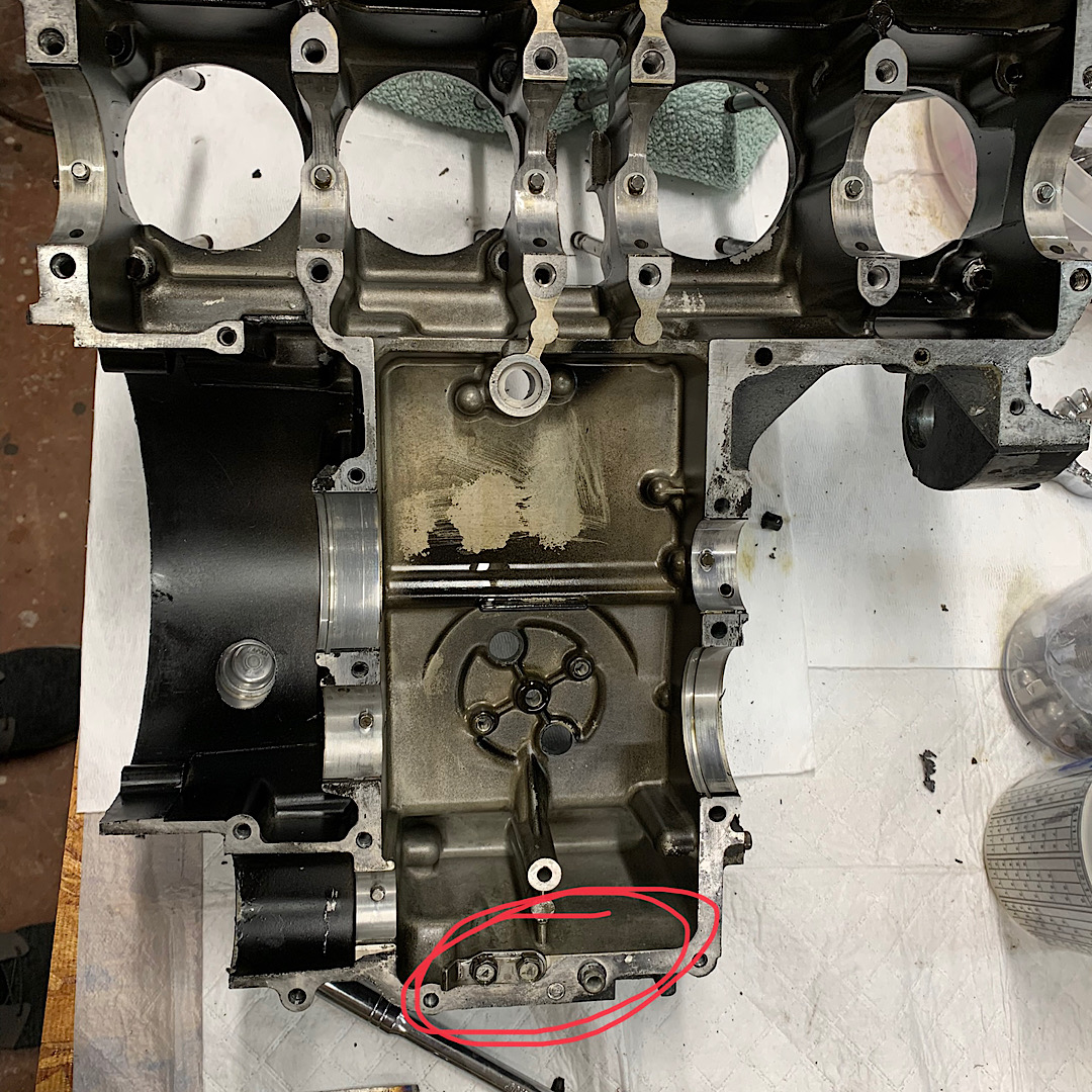

Re: 1973 Z1 Maui
20 Aug 2021 14:29

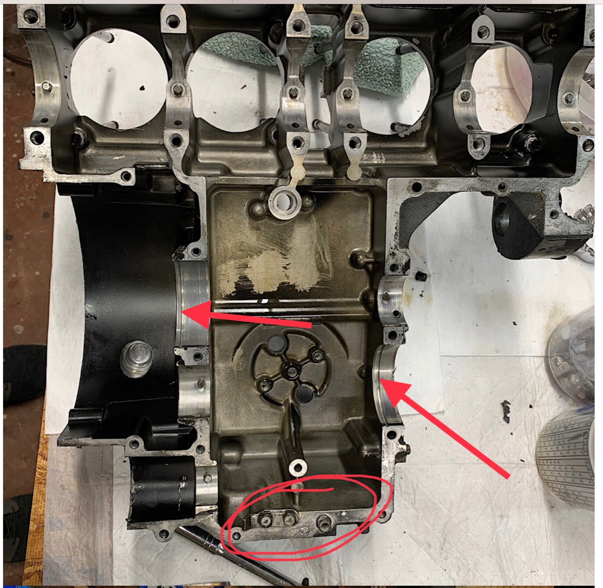

I opened up the case today to start cleaning. I found something that does not appear to be in any of the parts books I have. It’s the red circled bolts with the number 4 on top. My parts book and my Brookes book does not seem to show it unless I’m missing something. Curious.
things generally look ok, now for the very tedious cleanup.

Re: 1973 Z1 Maui
20 Aug 2021 19:15 - 20 Aug 2021 19:17
That is the kick start spot.
Kawasaki 13072-012…. Look at the included fishe, number 22 are the bolts, 21 is the lock tab plate, 20 is the stop.
www.partzilla.com/catalog/kawasaki/motor...ickstarter-mechanism
Normal is to flip the engine upside down and when you split the cases everything stays in the upper case.

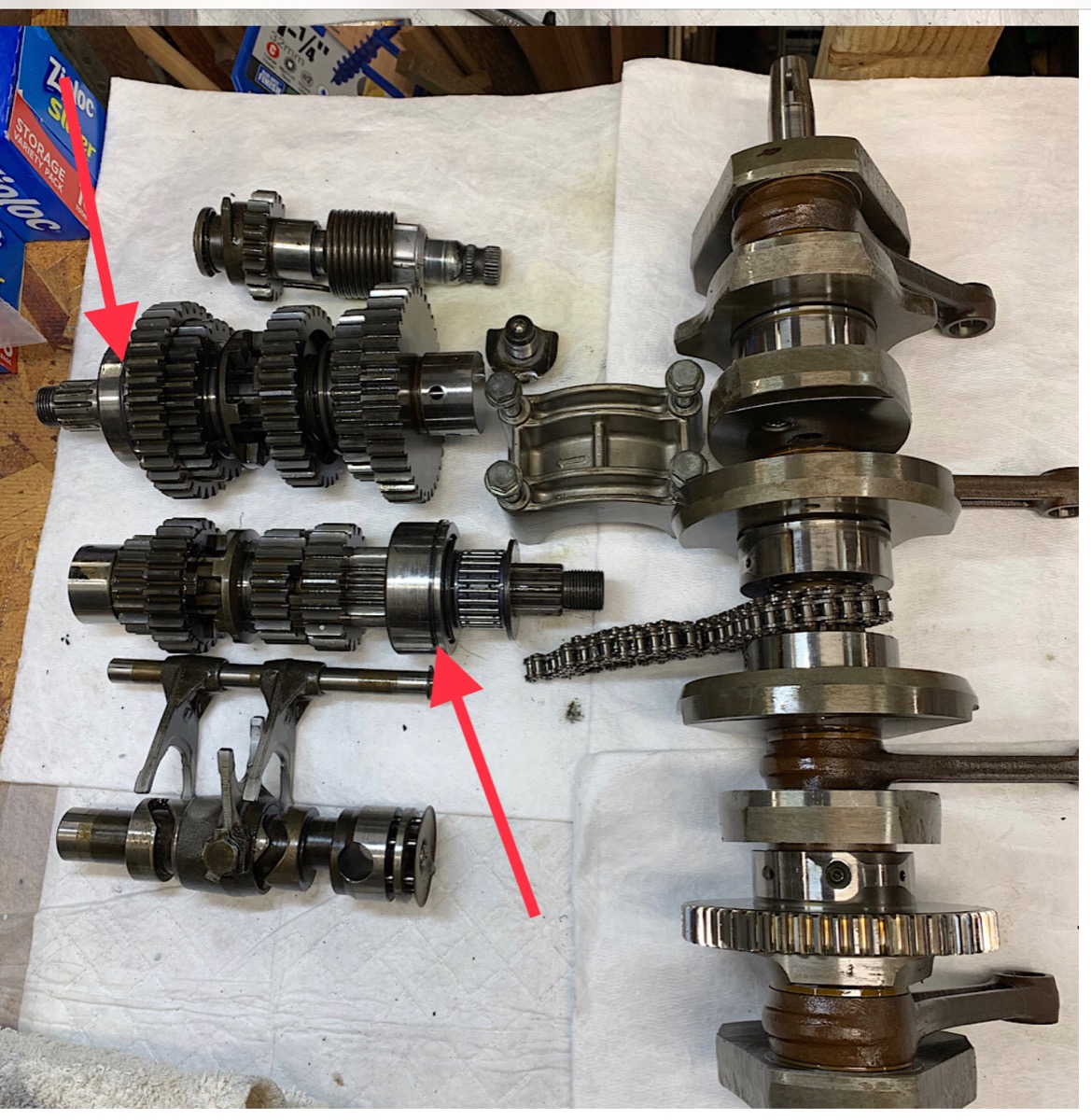

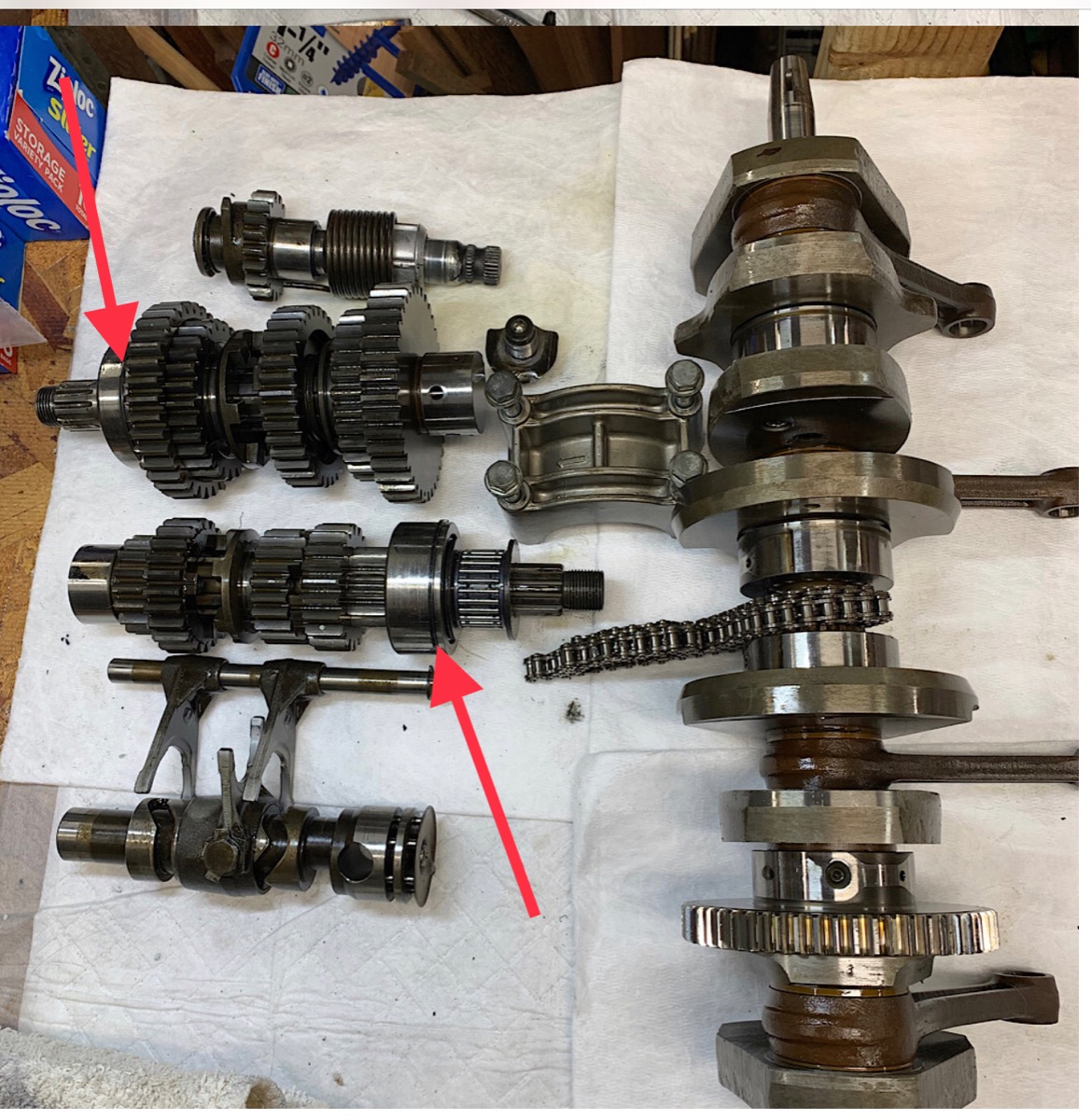

Re: 1973 Z1 Maui
20 Aug 2021 19:22 - 20 Aug 2021 19:24
Make sure you keep the half moon transmission lock ring shown at the red arrows they go in the grooves in the upper case, before the trans in installed.
Last edit: 20 Aug 2021 19:24 by Mikaw.
- MauiZ1
- Posts: 235
- Thanks: 25
Re: 1973 Z1 Maui
20 Aug 2021 21:30
Thank you, I’m changing my setup so I can assemble upside down like I should. I have the rings safely on the bearings.
- Posts: 3156
- Thanks: 1251
Re: 1973 Z1 Maui
21 Aug 2021 04:38
I believe the number 4 indicates the bolt strength, and is the lowest strength bolt made. I've never seen them in that location before.

Re: 1973 Z1 Maui
21 Aug 2021 05:03
The two circled bolts attach the kick start pawl. No reason the remove them we know of unless replacing the pawl. We've never heard of a pawl failing.

- MauiZ1
- Posts: 235
- Thanks: 25
Re: 1973 Z1 Maui
21 Aug 2021 07:53
Thank you all, I'm really in deep now getting it all cleaned up. Now is when the parts ordering gets expensive so I can assemble when ready. I need to blue check the valves and do a little test lapping to make sure they are ok.
