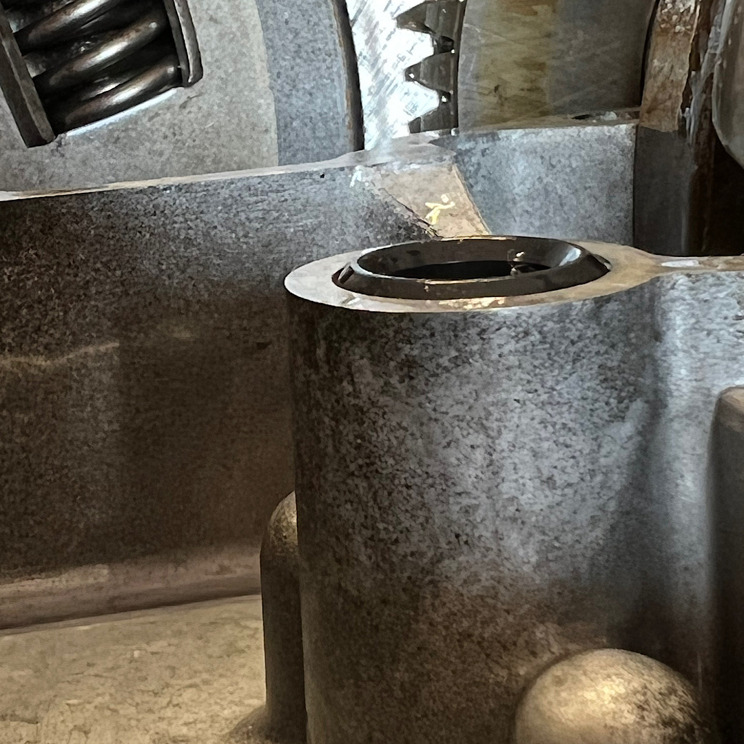

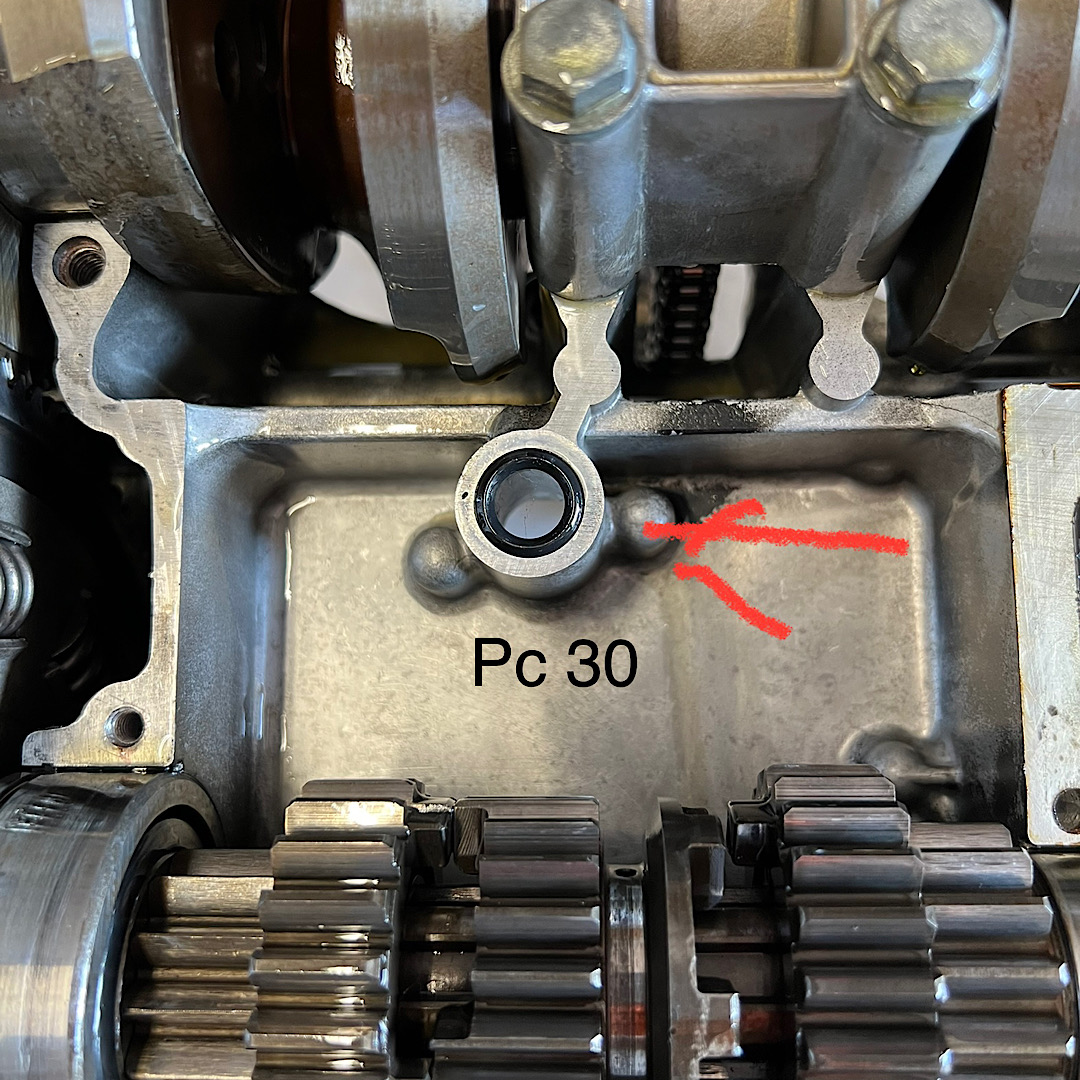

My Z1 project is neatly stored in the garage waiting for me to get back to it. Many things including my own hesitation have kept me from it. I put in a replacement oil pump, it’s assembled, ready for a test. As for plastigage and the cam bearings, it seems to be a moot point, there aren’t any over or under versions of the bearings. Other than checking for installation problems, what would one do if the clearance was a bit large or small. In my case there is sufficient clearance.
Yes, my oring in the upper/lower case is there.

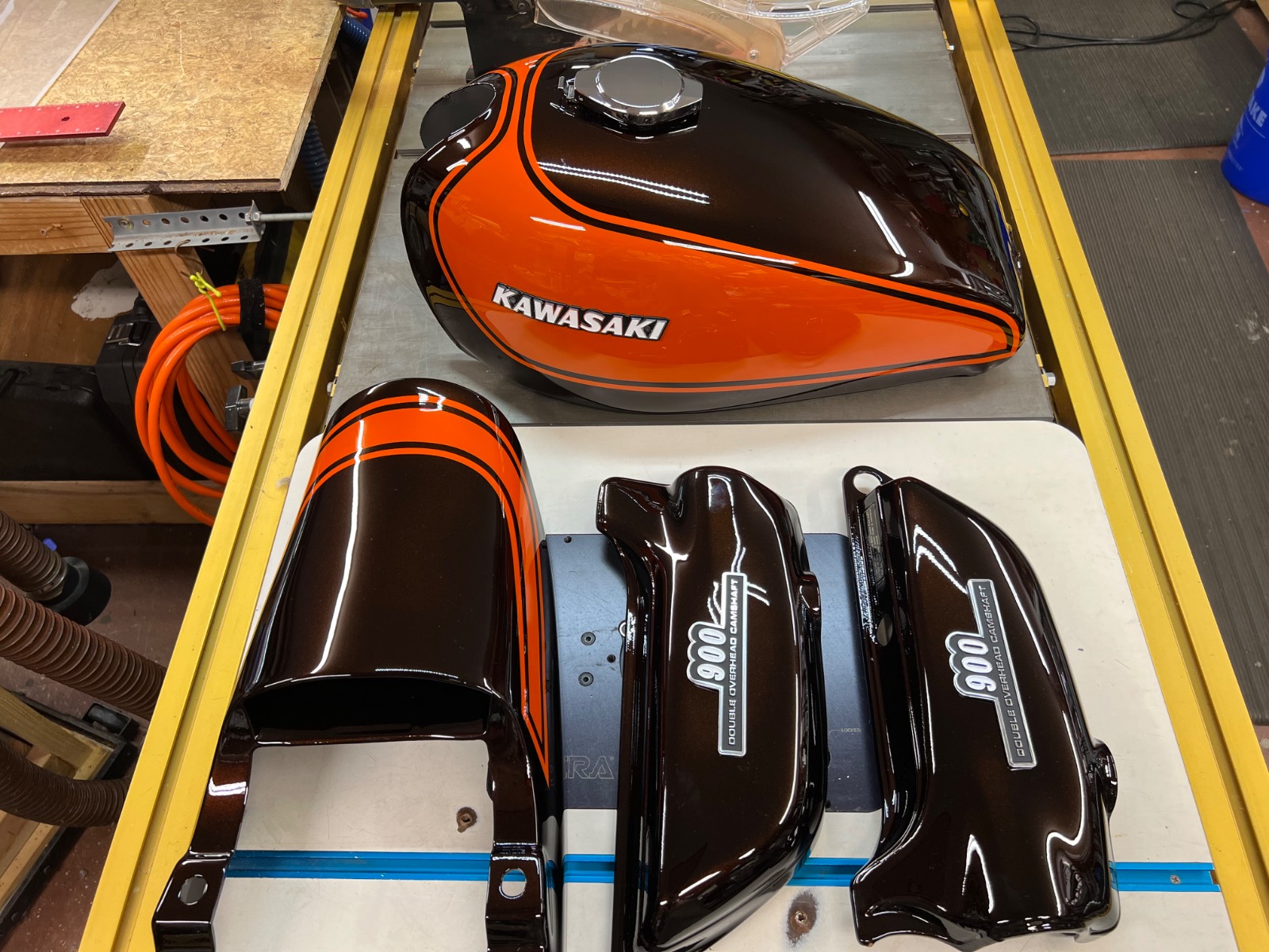

I’m going to give the new oil pump a try and if things go badly I may have to part out the project, I have a LOT of great parts including some rechrome work.
the bike has a title
lots of NOS stuff
beautiful body work, original stuff, repainted by a real master over on Oahu
stainless spokes
new fork tubes
carb chokes we’re renewed

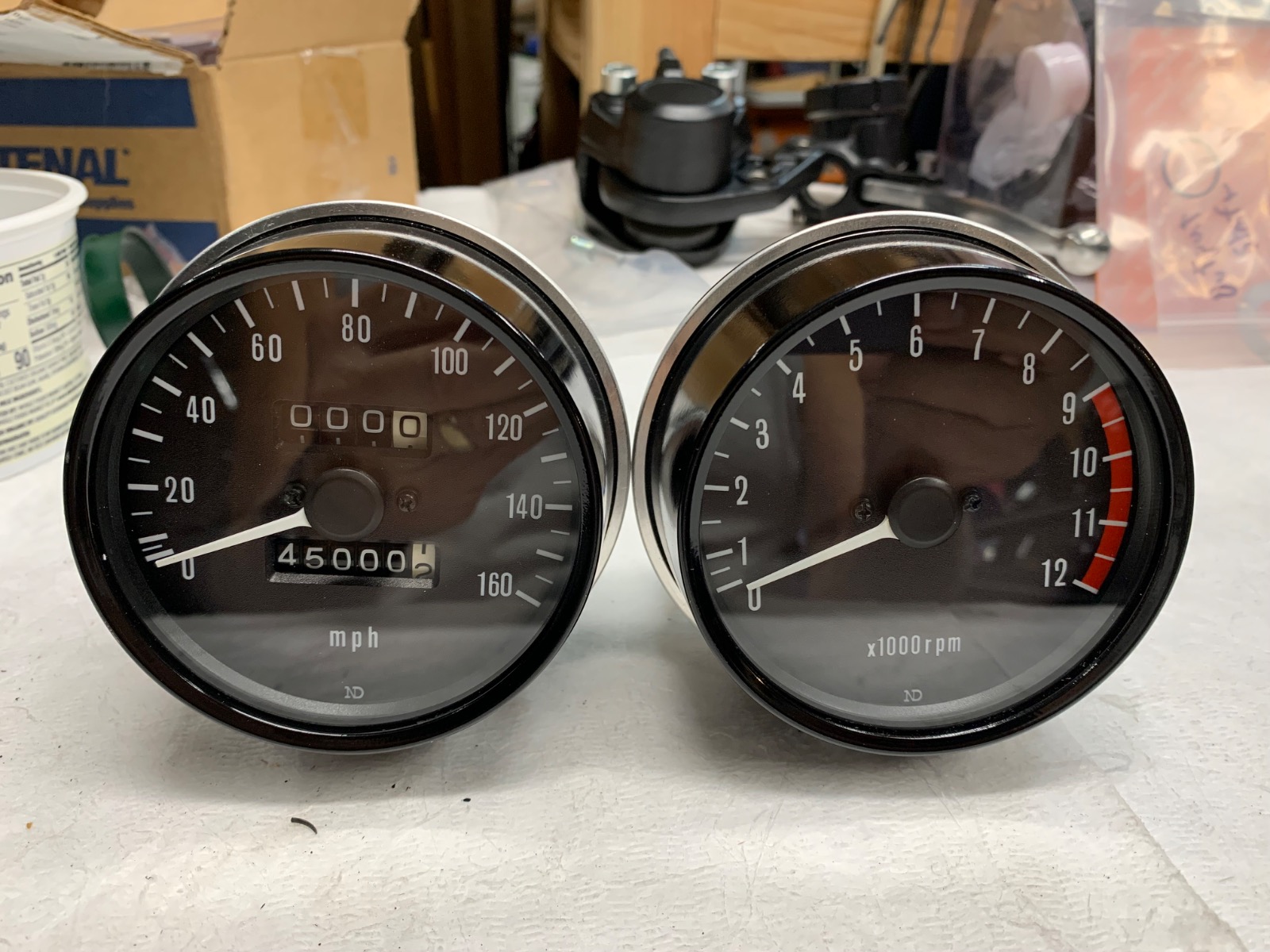

gauges went to Marcel in the Netherlands for freshening up.
new repop exhaust
the list goes on.
