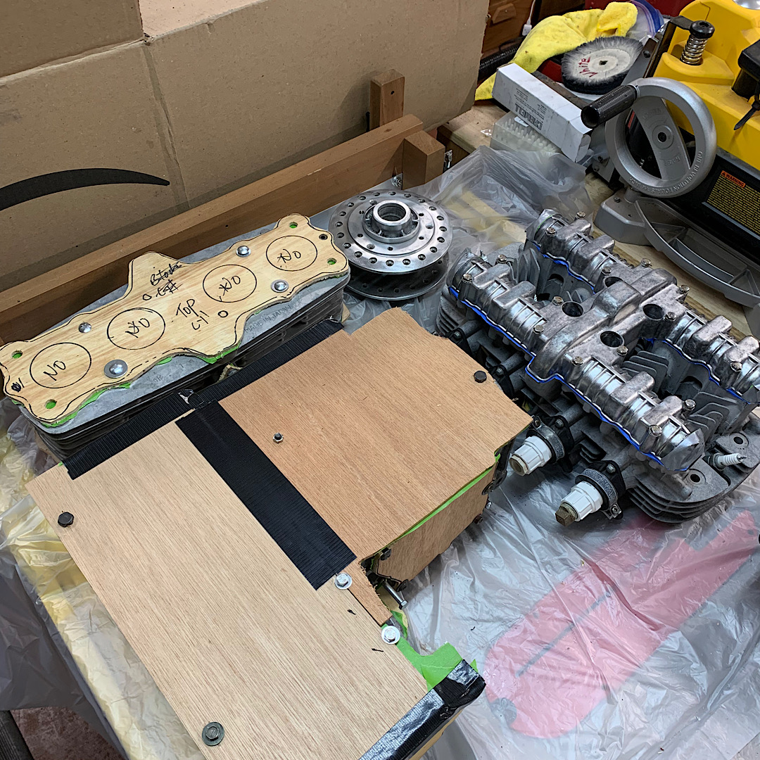

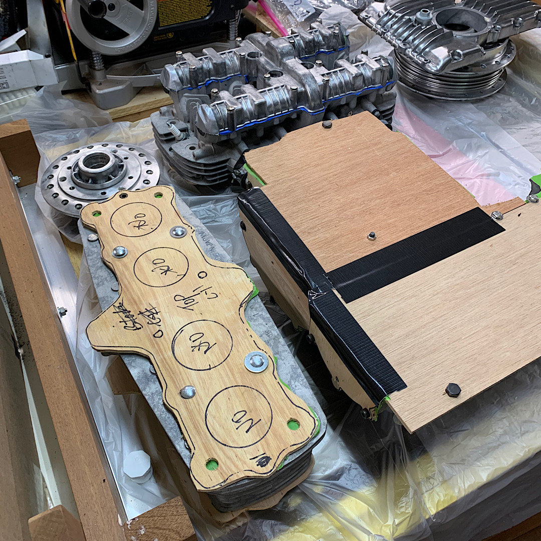

The paint is mostly off, I'm making plywood blanks now. I tape over the critical surfaces and then put the blank on. I'm plugging all the threaded and other holes. I'll get photos of the parts when they are ready, it's tedious.

I’m blanking the upper case, last piece. Each piece is taped off to keep out glass beads and covered with the wood to protect the tape. Bolt holes have bolts in them. I’m hopeful this saves me a lot of cleanup. Internal passages are also plugged in case there is leakage.

When I had my stuff done I only blanked the cylinders and I used duct tape over them. Otherwise I left everything open. Immediately after blasting I used a water hose to thoroughly wash each piece and then compressed air to dry.

Looking good. Advice I've heard suggests putting the blasted parts in hot water and spraying all the passages with compressed air - I suppose you can't be too careful.

Yes, I must admit I’m maybe overly concerned but I will be dunking, blowing, checking with a flashlight in a dark room and anything else I can think of to assure myself there are no beads left in it.

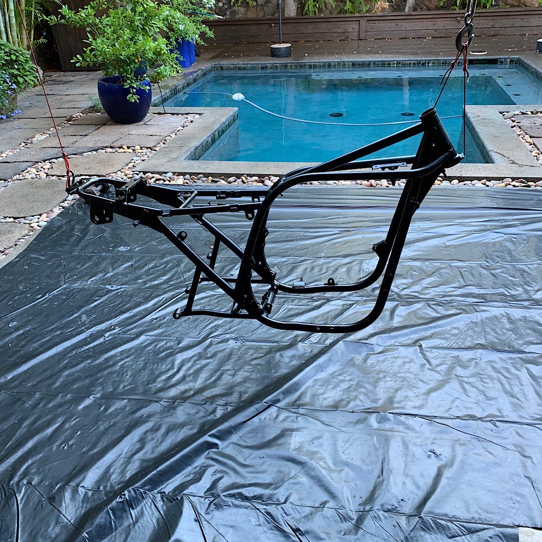

03 Sep 2021 08:25

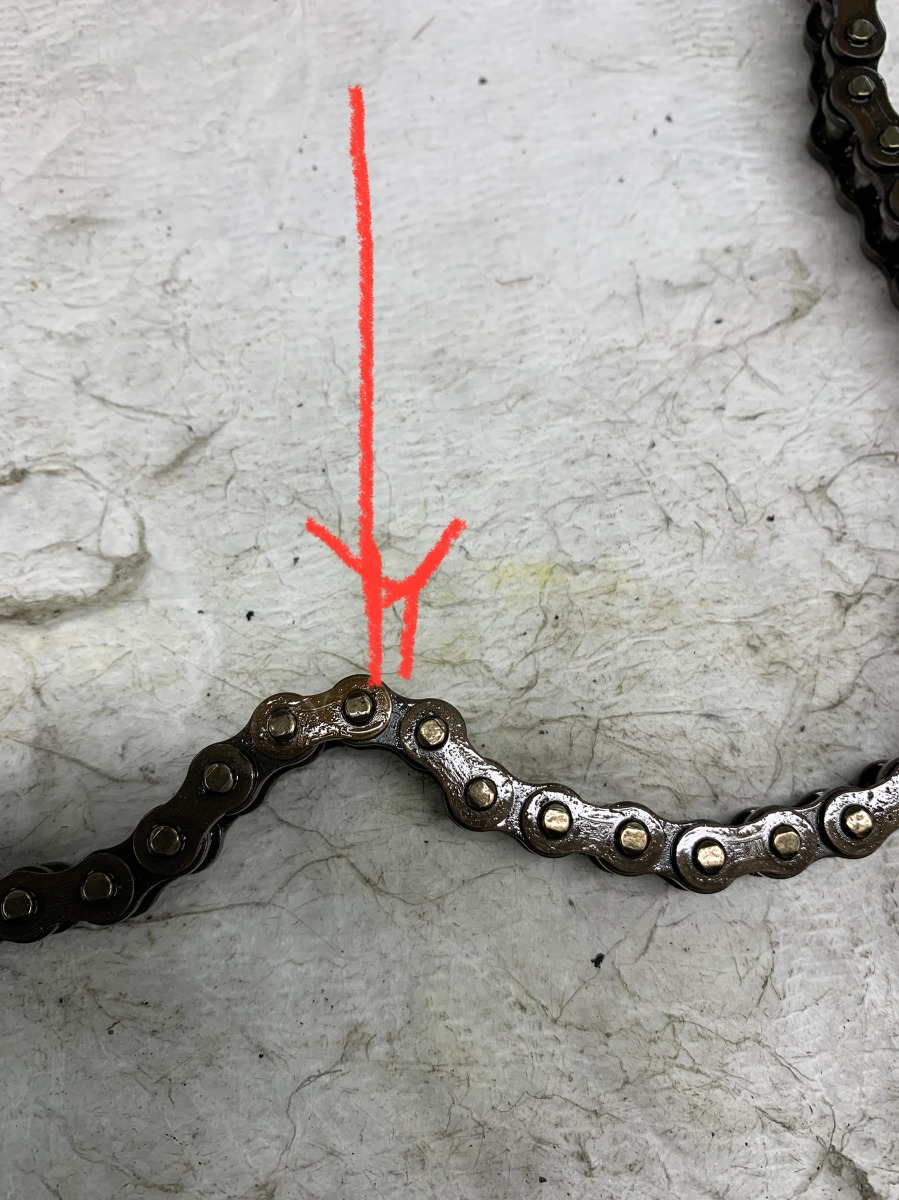

Frame is painted. Looking at other parts, found a stiff link in the cam chain, I will surely replace it as well as a few parts of the tensioner. Most were renewed in 2009 and don't have much miles. The support shafts are the modified type with small cutaways but I think one is not renewed.
