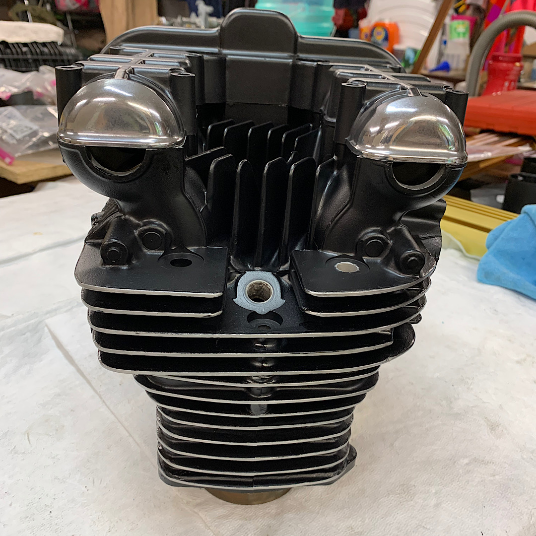

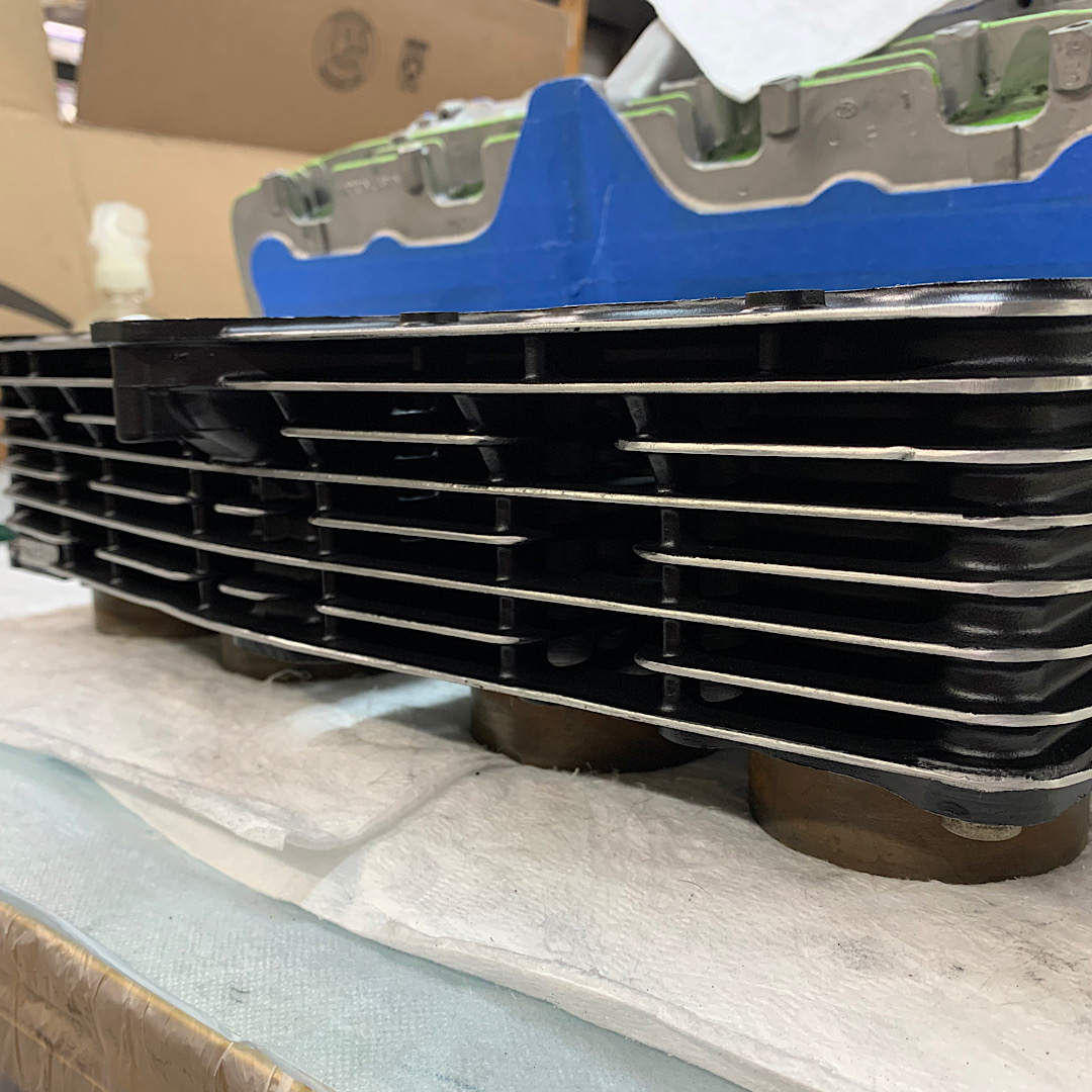

A few updates
My bore gauges came and my guides measure out fine.

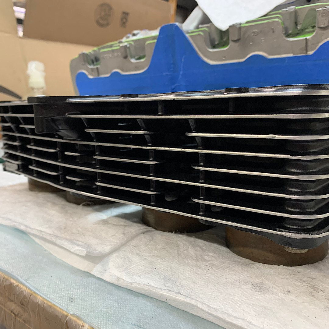

I painted the cylinders, I'm thinking of sealing the edges with a clear coat to help reduce the chance of corrosion on the raw metal. Here on Maui that would be the first place to corrode.
The edges of the fins are not finished very well, pretty rough casting, I cleaned them up some but Kawasaki didn't put any time into them.

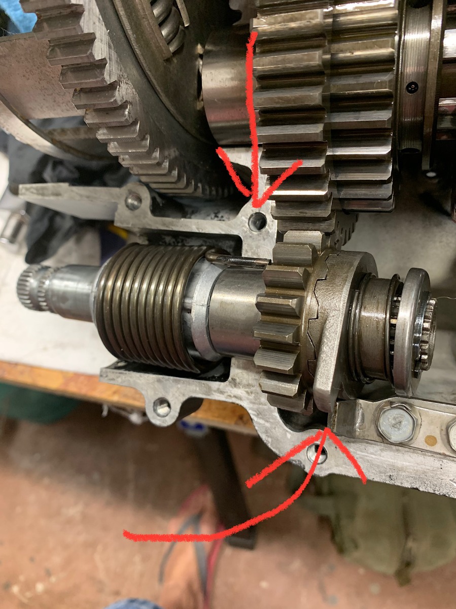

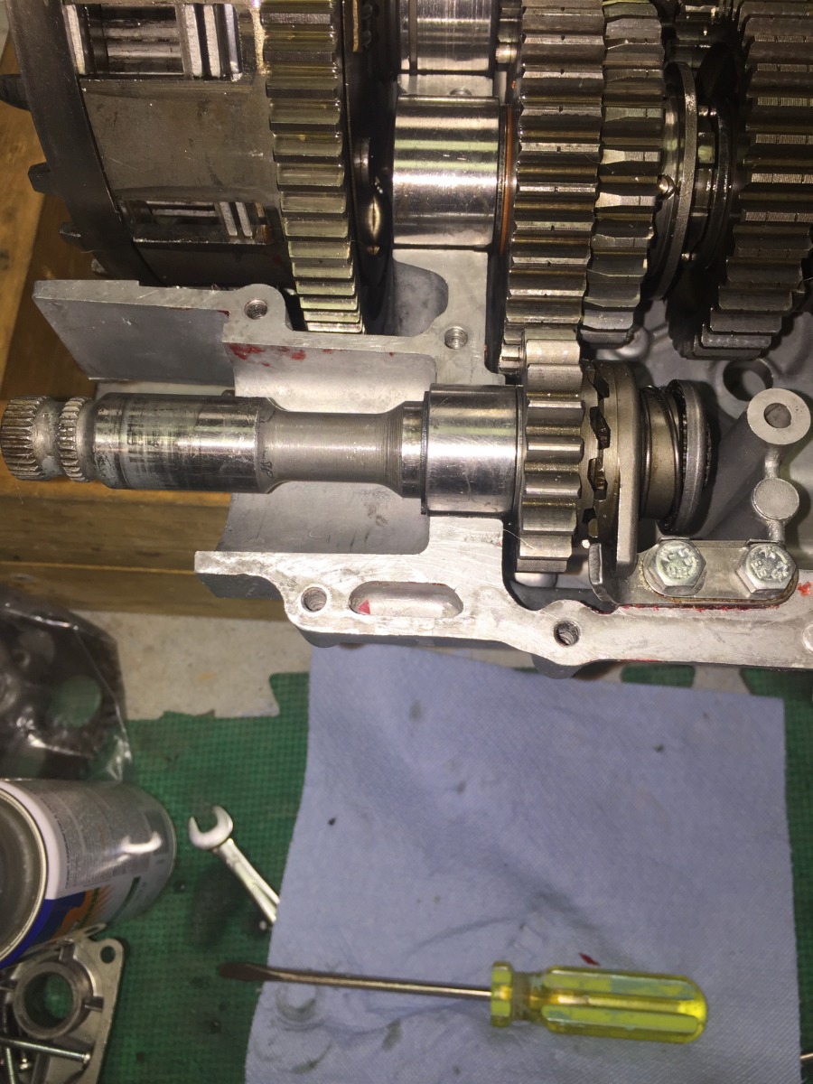

I'm practicing assembling the cases and i can't figure out how to get the kick starter clocked right so the spring will be in the relief slot for it. The videos I've found don't address this, I'm thinking it's simple and I'm just missing something. The manual isn't much help so far.

There's index marks on the kick shaft and on the ratchet that must be aligned for the pawl & spring to locate correctly. Page 47 of the White Manual. Are the index marks aligned?

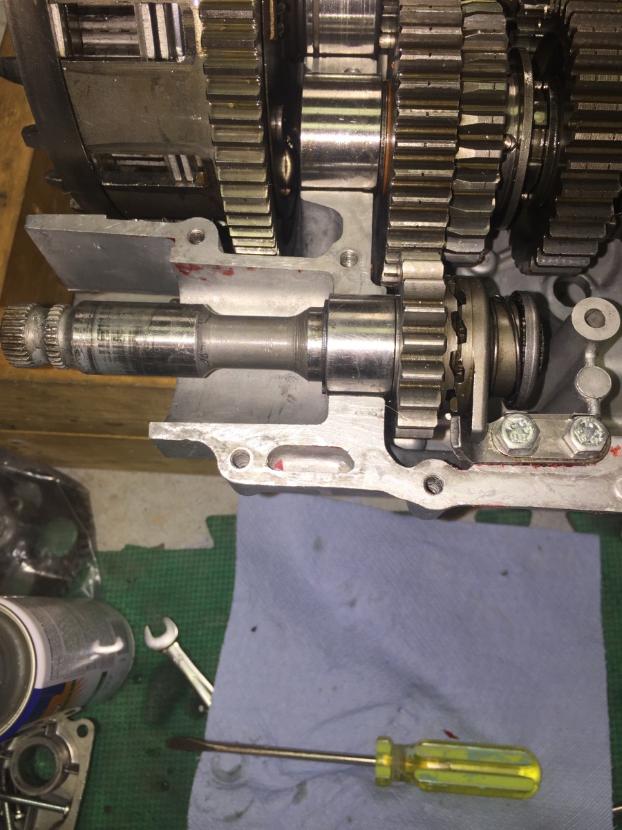

Ditto what Jim said. Additionally, and it may just be the angle of the photo but the tab on piece bolted to your case looks to be bent at a right angle, but it should be angled slightly towards the ratchet as shown in the photo below. The ratchet should slide along the tab to open up when the kicker isn't in use.

20 Sep 2021 09:45
Thank you all
i feel dumb, I should never start a new phase late in the day, tired brain.
my splines are clocked correctly.
I just realized the spring and spacer go in after cases are assembled.

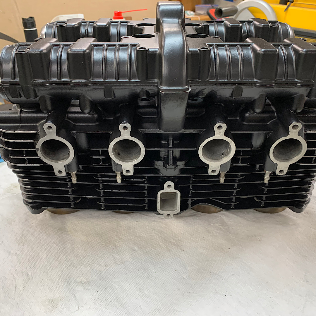

The head has valves back in it now. It went smoothly if a little fiddly. I stacked it up just to have a look. I realized the valve cover looks to be symmetrical, no front or back as far as I can see. I’m studying John Brookes book and it doesn’t indicate a back and front. I’ll check some more to be sure.
Onward I go. Chrome stuff going to SoCal tomorrow.

I've always assumed the valve cover is symmetrical.
What paint did you use?

Re: 1973 Z1 Maui
24 Sep 2021 08:22
Choice is limited here and shipping paint here is almost impossible.
I used Duplicolor engine paint low gloss black, seems to be nice paint.
The bare edges of the fins have Duplicolor engine clear. Very tedious to do.

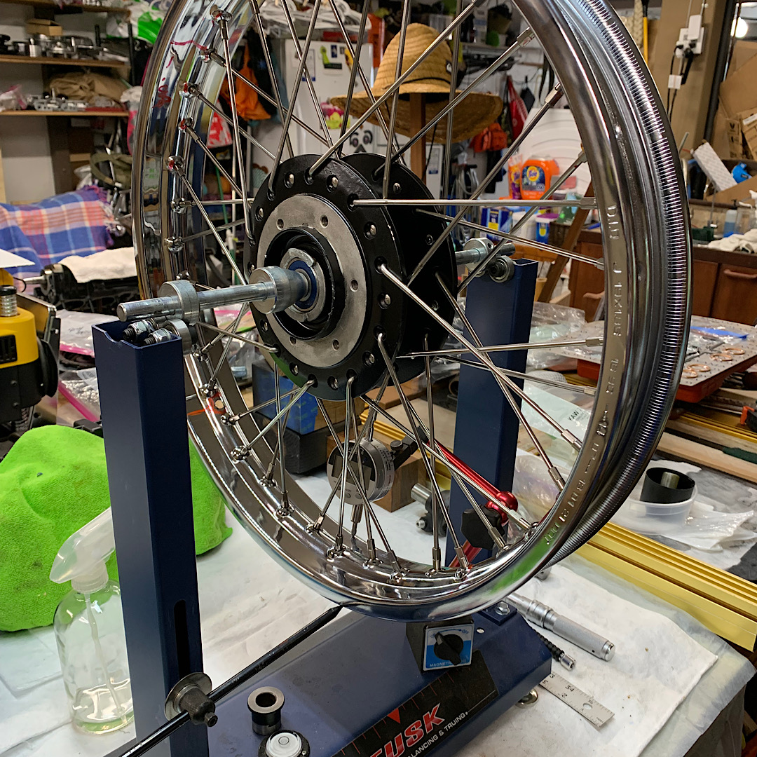

25 Sep 2021 09:13I'm putting the front wheel together and I'm getting close. I'm down to about .070" hop near the weld, side to side is nearly spot on. More to do.
I wonder about spoke torque, Buchanan says 80 inch pounds which seems high, they are getting pretty tight sounding and feeling at 45 inch pounds. I forget what I went for on my K3 750 Honda using the same spokes and rim style.
Anyone have any suggestions?
