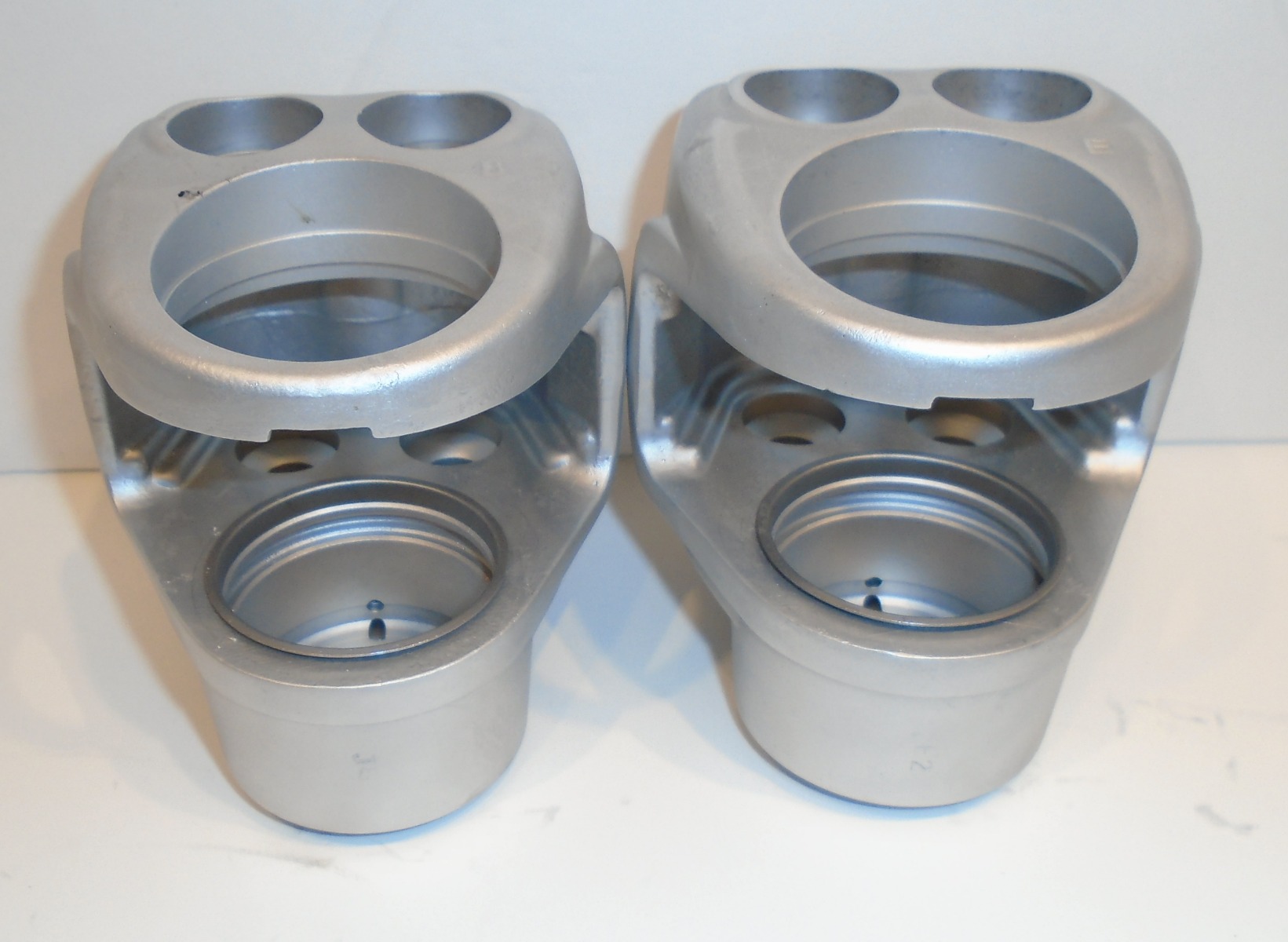

The piston came out fine using the master.
I'll start looking for a disc.

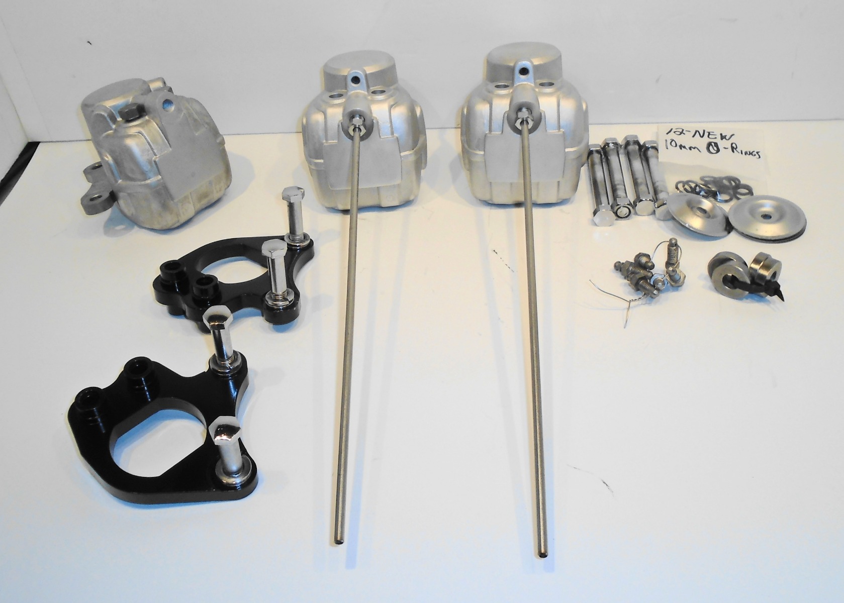

The parts book lists a shim behind disc pad A.
my caliper does not have one, is this shim only there if needed?
43076-001
the shop manual is a little light on information
43076-001

That is an anti-squeal shim. It looks like there are some on eBay.
One issue is that the pads need to have two posts on the back to hold the shim. Many aftermarket pads don't have the posts.
For example, the SBS pads I bought recently did not have the posts.

Book Em' Danno! Nice work you do! Glass bead is great for the caliper parts. Just a note, Are you aware of the 2 socket head bolts that hold caliper together are early only? With the star looking blanchard machining marks inside the opening? If you have your hardware zinc plated? Make sure some kid don't grind them out, thinking he's cleaning them up for you.
I am not sure about Brake Crafters making a Z1 rebuild kit? But I have purchased 3 for the 76 calipers with SS pistons. Great Product as others here have used also. Don't trust a pitted piston. I also have been using 304 stainless brake line and fittings. I sold these cores cheap a few months ago.
