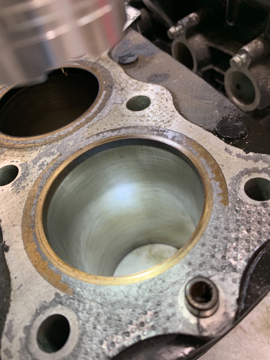

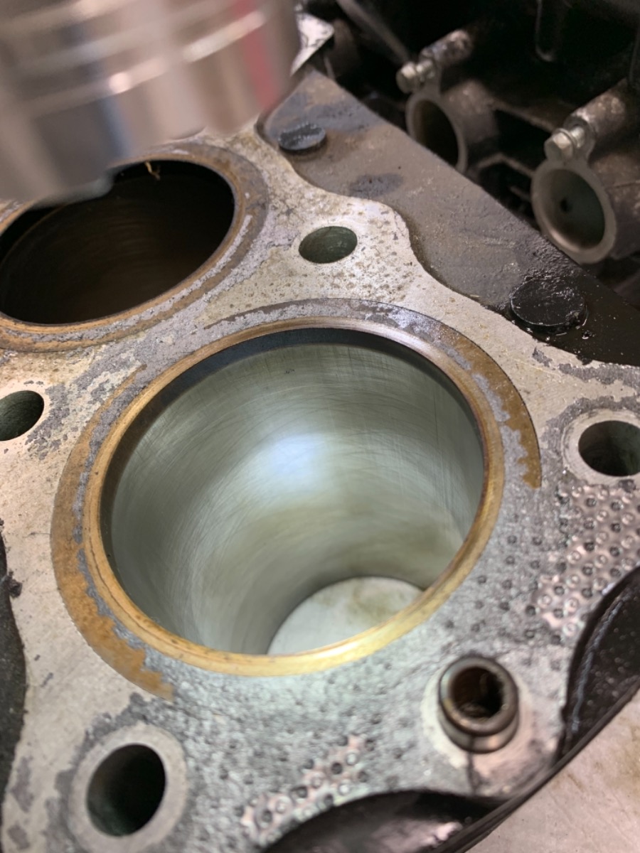

Correction, the pistons/bores are first over, 0.5mm
I spent the morning measuring pistons and bores. As seen in earlier photos, the pistons and bores look great, hone marks in the bores, un-scuffed surfaces on pistons.
Readings were consistent in all cases. I used my telescoping gauge and my 2 to 3 Starrett micrometer.
The conclusion? The previous work setting it up with first over pistons put the clearance with the bores at the top of the tolerance which is 0.0025” to 0.003”. I’m at the top.
I didn’t want to see that but there it is. This bike will likely never see big mileage (Maui is an island after all), drag racing, desert riding, etc. maybe this clearance doesn’t matter that much, I imagine really high mileage bikes go over this limit and run fine all else being equal.
My only option would be to go second over and find someone that knows how to bore/hone one of these without screwing it up so I have to re-sleeve it.
I don’t want to do a big bore, I’m trying to keep it close to stock.
Any Z1 opinions are welcome.

If I understand correctly, you're saying you have 0.003 inch clearance between piston and cylinder wall, and that's the top end of the spec. I checked, and that's what the book says, but it also says clearance may exceed the upper limit, but not the lower limit. So I think everything is fine. But you will want to ensure the rings are within spec for gap or you may have a compression issue.
The book also says there should be no more than 0.0004 inch difference in the cylinder bore diameter.
