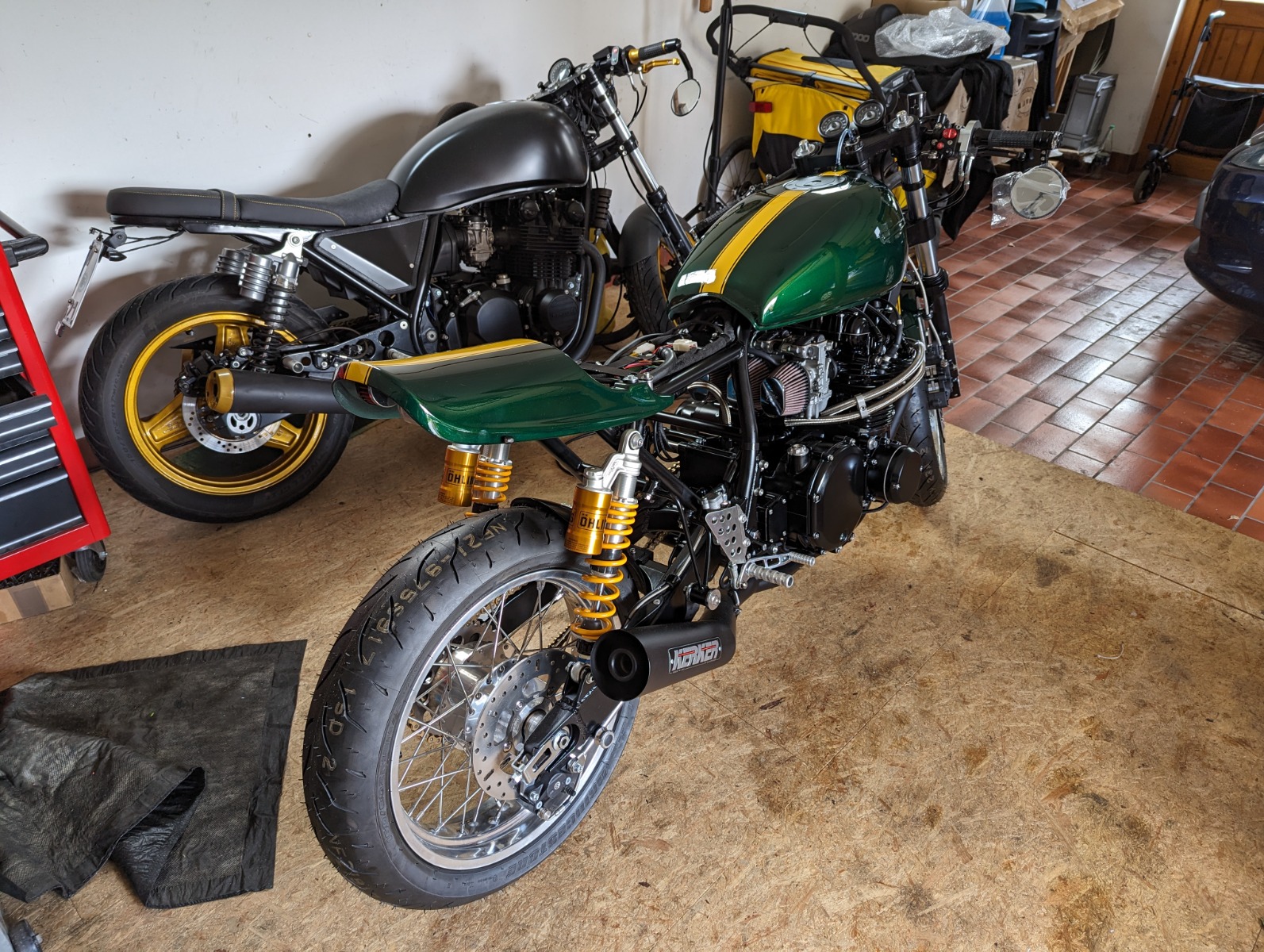

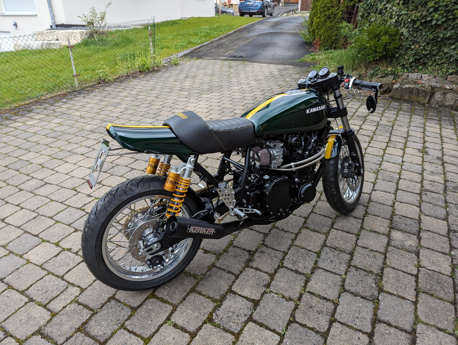

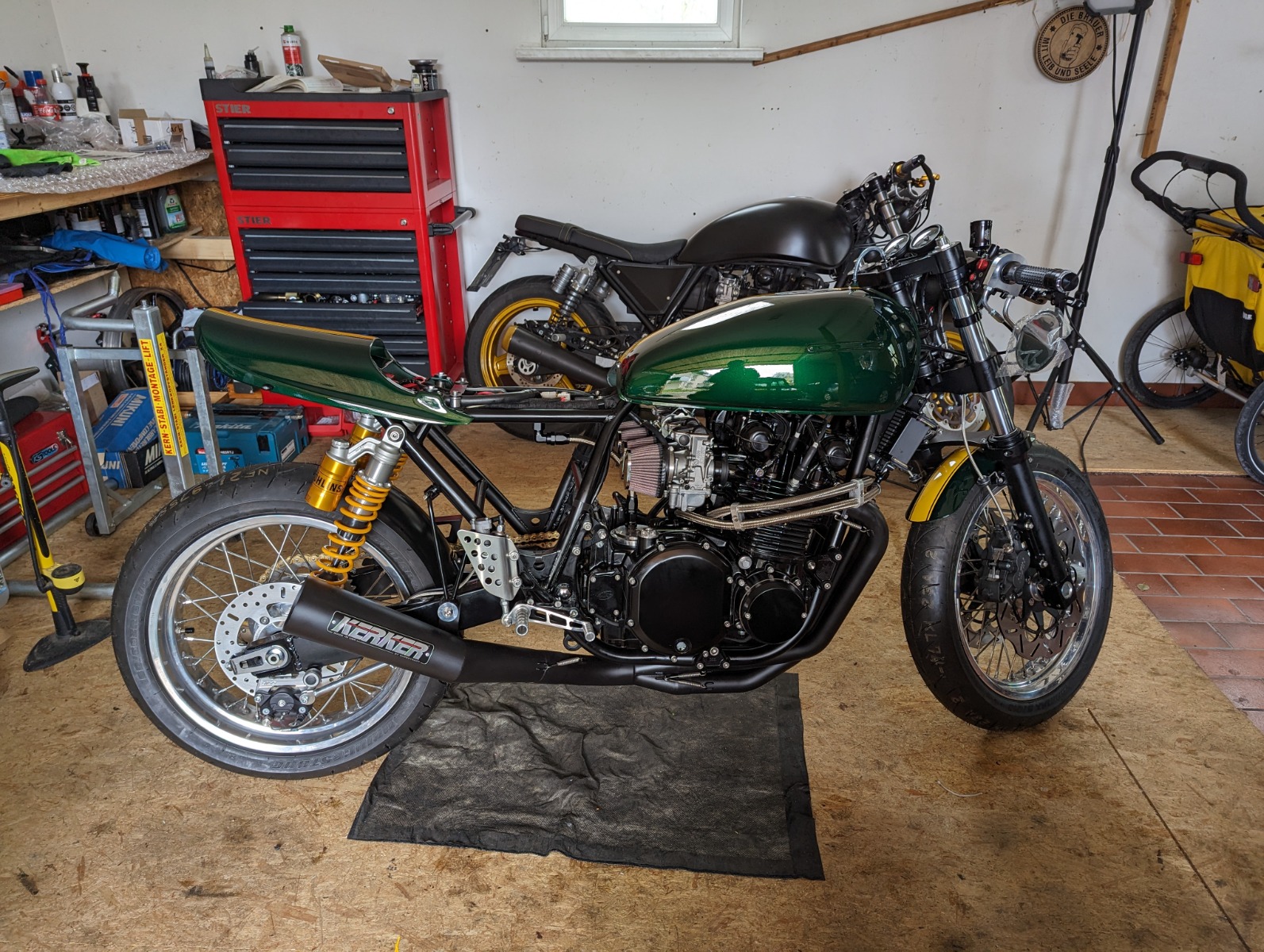

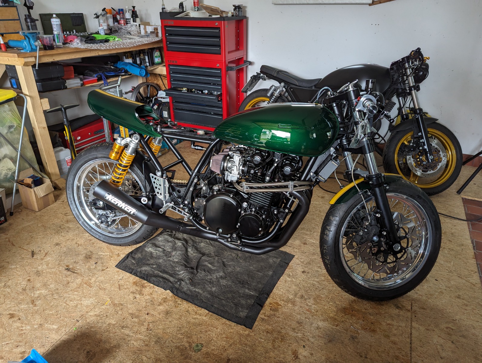

Got everything ready to start her up. Will have to wait til the weather clears as I need to hang the back end out of the garage when I start it (not my garage). Chucked the tank on for a couple of photos.

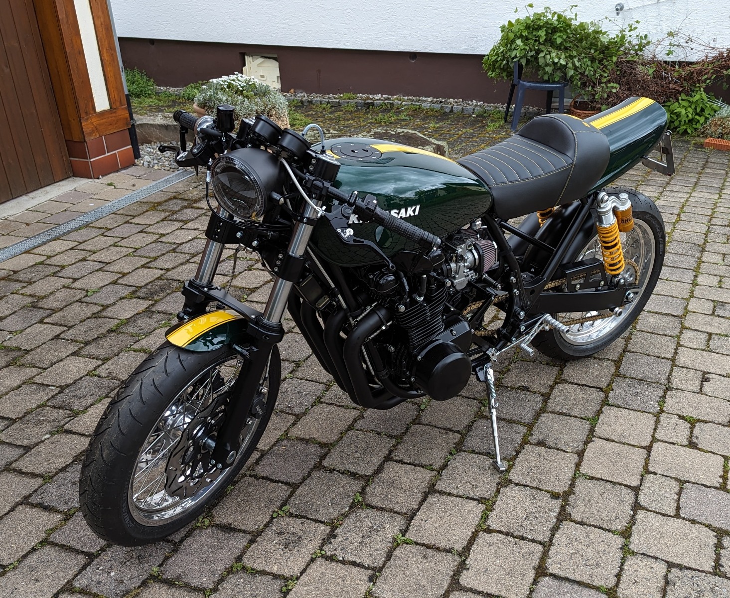

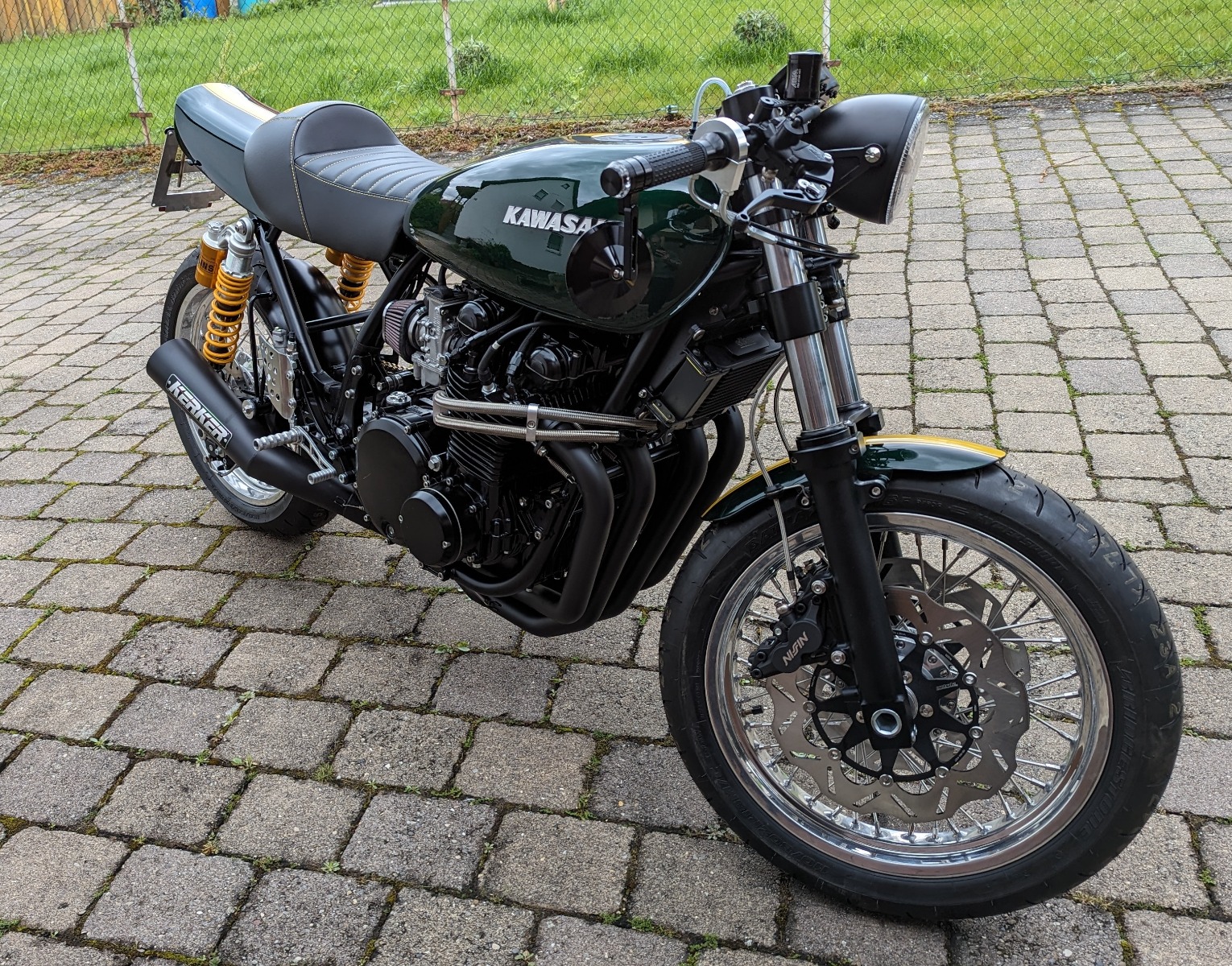

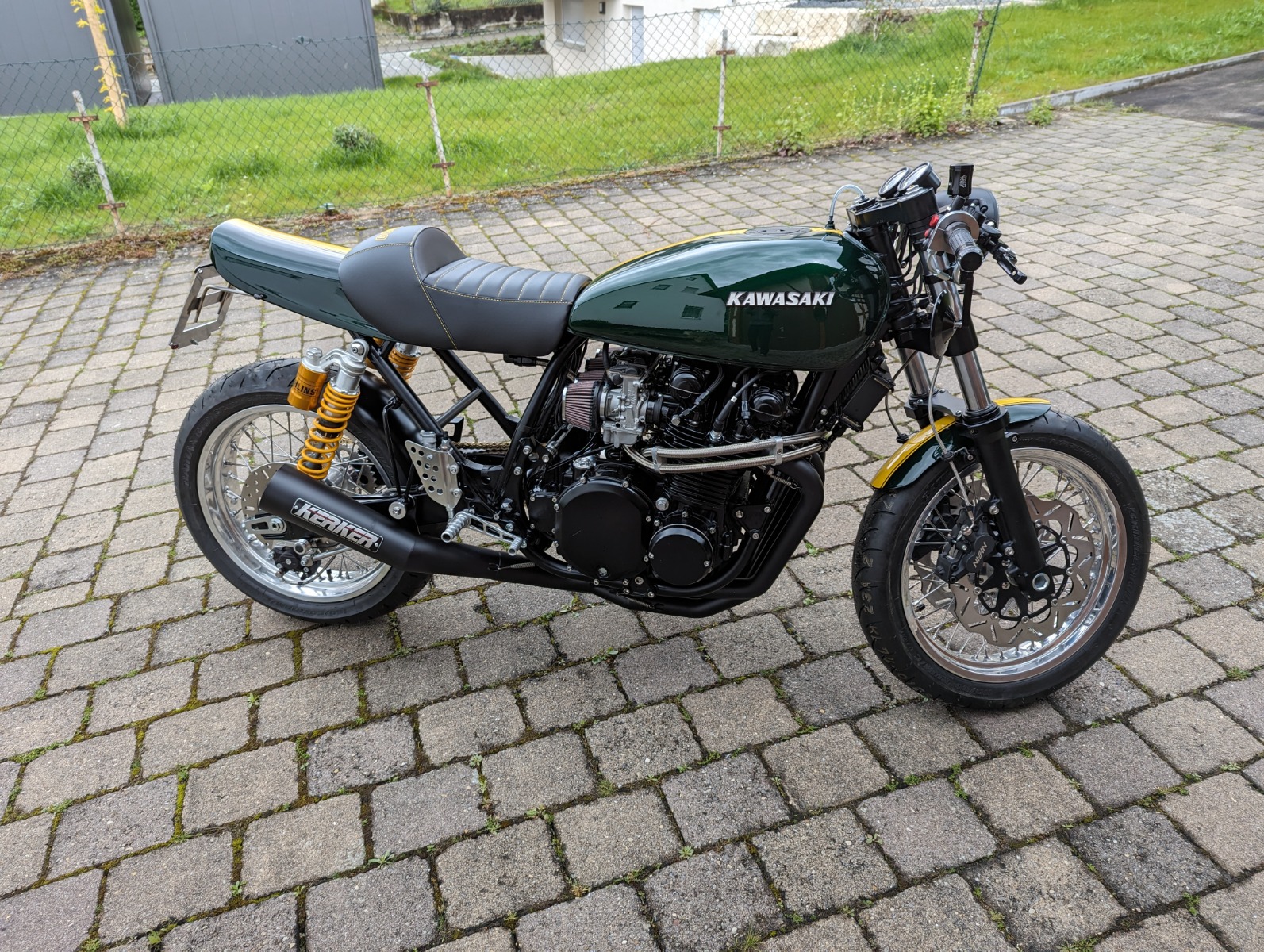

Finally! Haven't touched the carbs yet but it started easily and idled steadily at about 1000 rpm. Will sync the carbs and check the pilot screws after a short test ride on the weekend. Or maybe just leave it as is for the MOT and spend some time on it aftwerwards - depends on how well it runs on the test ride.

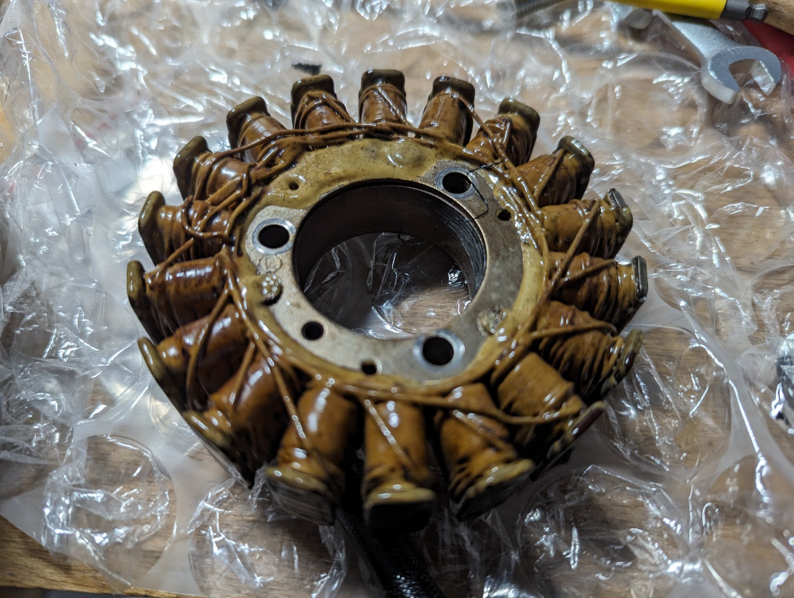

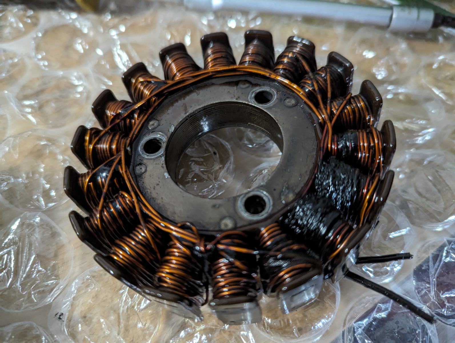

Swapped out the stator and now the battery is holding a charge. Not sure I'm getting full power from the regulator. I was getting about 12.5V at about 2000rpm - it was pretty early on a Sunday morning so I didn't want to open the throttle too wide...
The 750 stator has some sort of coating on it. Not sure if it will hold up to the engine oil but it will be back out after the MOT anyway. Have a replacement MK2 stator on the way.
Can anyone tell me how much AC voltage I should between each of the leads on a disconnected stator?

Oil won't hurt it 50-70v AC per leg.

21 Apr 2024 18:56Oil won't hurt it 50-70v AC per leg.
No load tests are inconclusive. But, I'd say 70+ AC is a reasonable target. 50 is too low.

The stator is shot. The burnd clear coat lost his isolation effect and short cuted the copper wire.

Thanks guys. The stator in the second picture is in the bin already. Should have looked a bit closer before I put it on the bike!
