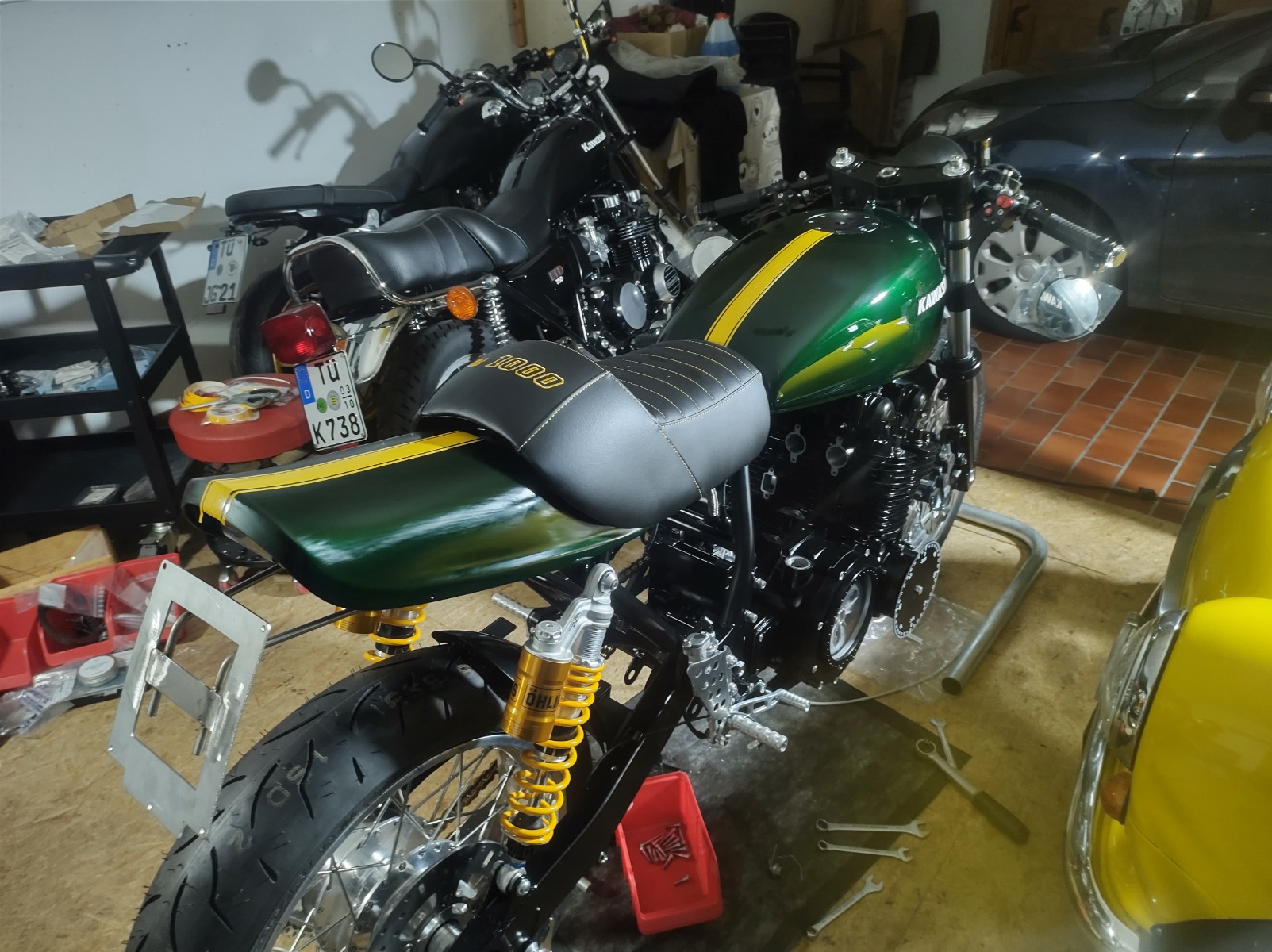

Same here, the one down the middle of the tail.

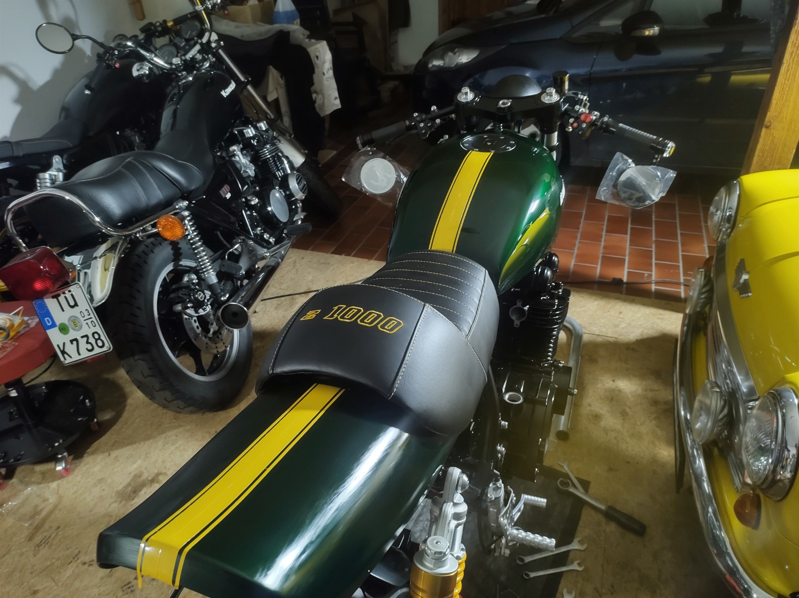

Same. And, fwiw, I'm not sold on the yellow headlight bezel ring. I think the fairing would look better solid green. Just my 2p.

11 Mar 2024 00:36Don't worry it's just the "Oldtimers" kicking in. In my my confused mind those side stripes where on the topOK, the "from the first time" confused me a bit... I'll see how it looks tomorrow, but I think I agree with you guys.

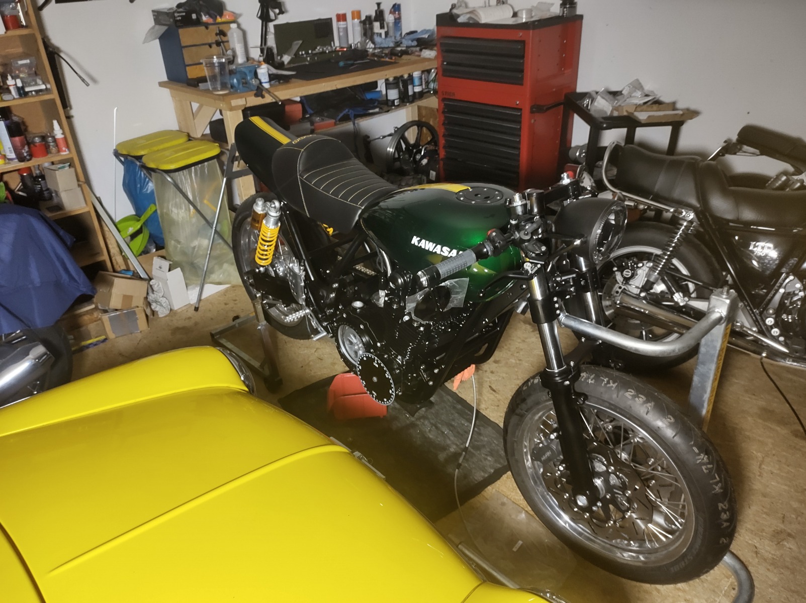

Thanks guys. The fairing is staying on the shelf for the moment. I won't have time to make a bracket for it before I get an MOT and I don't want to rush it. Plan is to get it done next winter - which will unfortunately mean another MOT visit to get it entered into the paperwork... gotta love the German TÜV!

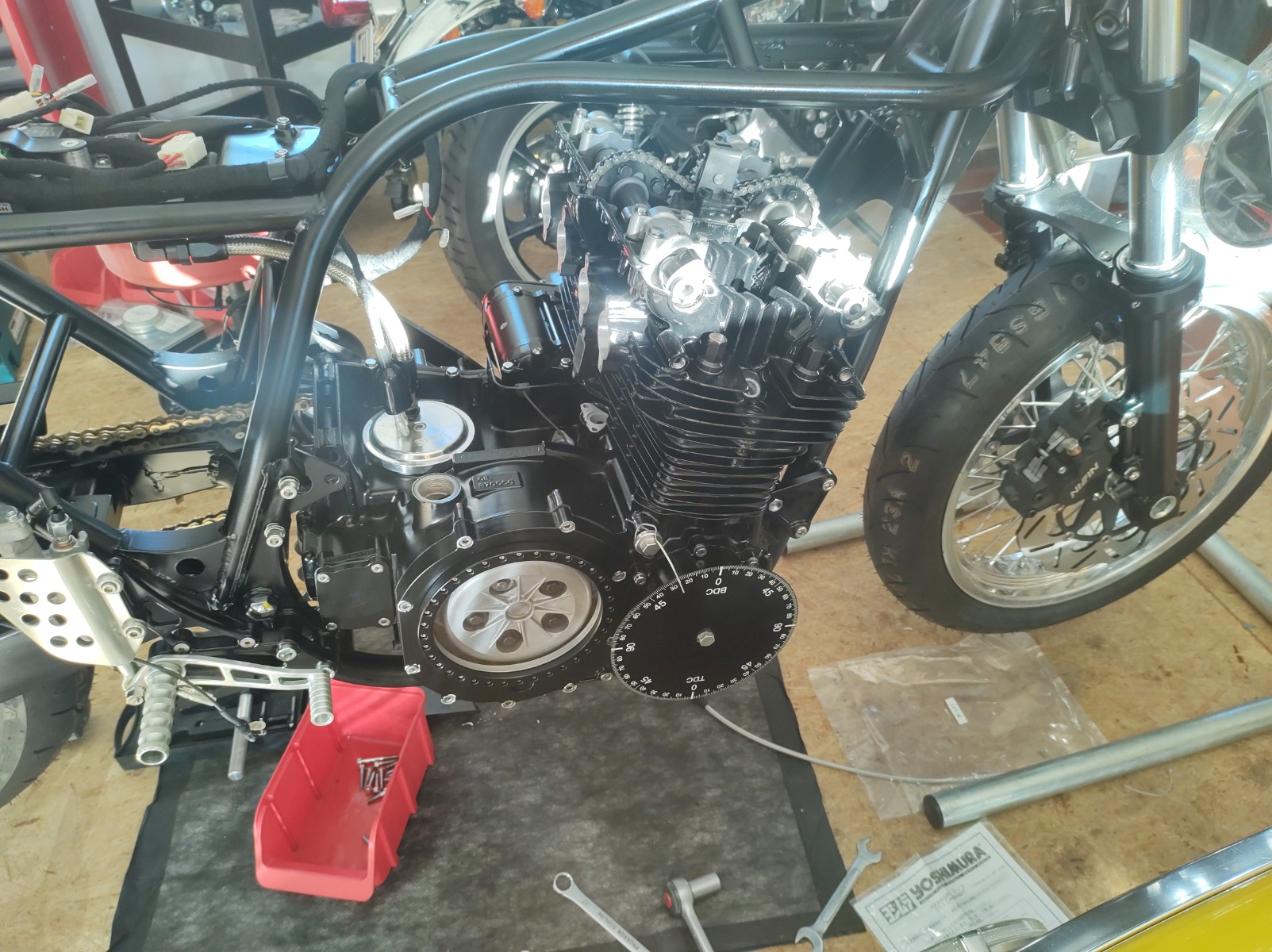

Had an interesting time with the cams today...
Put the cams in and aligned the dots on the APE sprockets then slowly turned the engine over and hit some resistance. Thankfully I didn't force anything - when I looked in the plug hole on cylinder three I saw two valves stuck together I backed off but they stayed stuck until I took the cams out. I was wondering if the yoshi cams where supposed to be aligned differently but can't read japanese so couldn't check the paperwork. Then I took a look at the cams and they were definitely off (was kicking myself for not seeing it straight away). I took a step back and did some other stuff before checking them again. It was then that I saw the second dot on the APE sprocket. I aligned them to the one on the slot and not the one meant for the 28th link (this was fine on the exhaust but not so good on the intake).
After that I got things sorted out and turned the engine over only to see the #3 intake shim being spat out of the head. Not sure if it just wasn't in properly or not enough oil but I think I'll be swapping to shim under bucket.
I put the shim back in and checked the cams. The intake is at 102° instead of 105° and the exhaust is at 111° instead of 107,5°. I'll sort that out when I take the head back off and will also check the valves that got stuck.

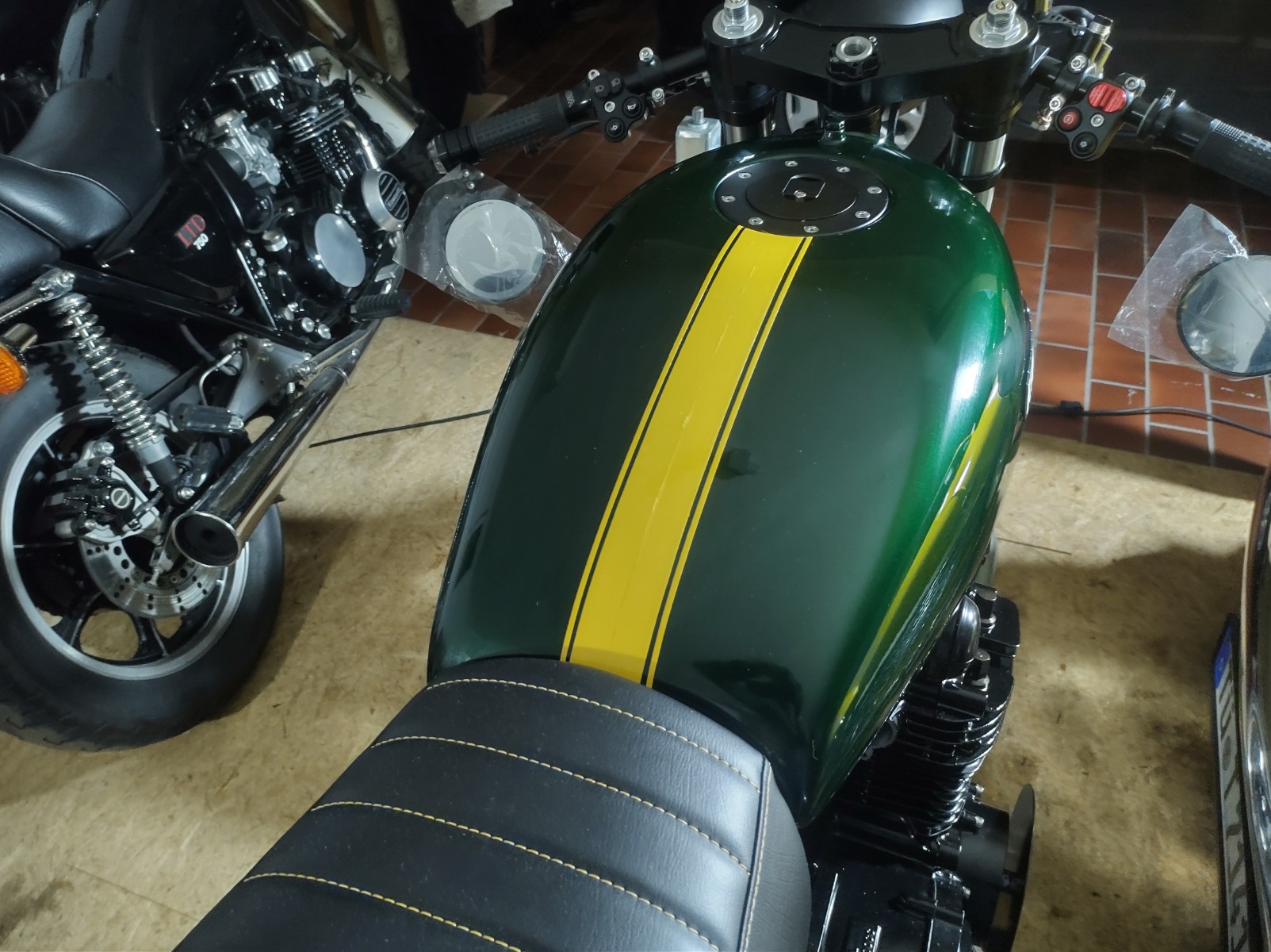

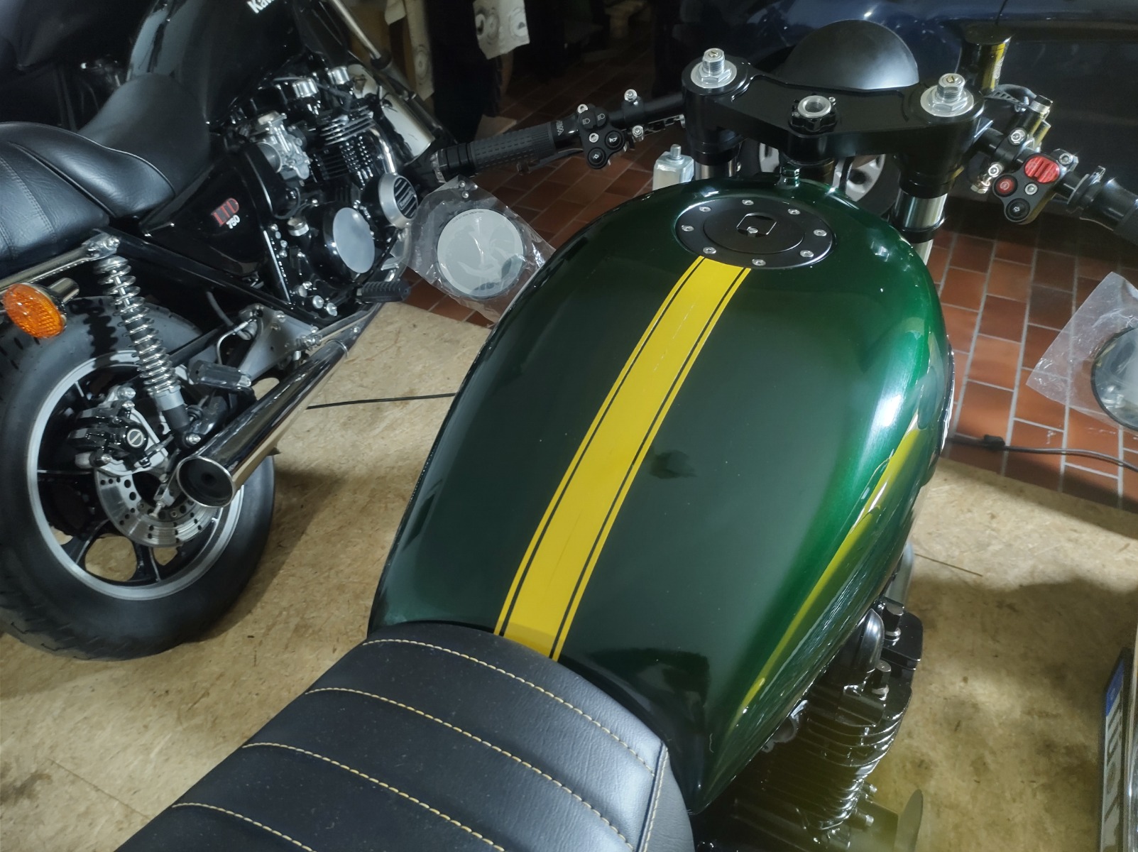

Couldn't help myself, had to go back to the garage and try out the stripes on the tank. I used the same width as the tail and then went a bit wider. I think I'll go with the wider ones - don't need to mess around trying the other options, mind is made up
Only thing I need to sort out ist the vent. I think I'll just get a 22mm punch and put a hole in the middle stripe.

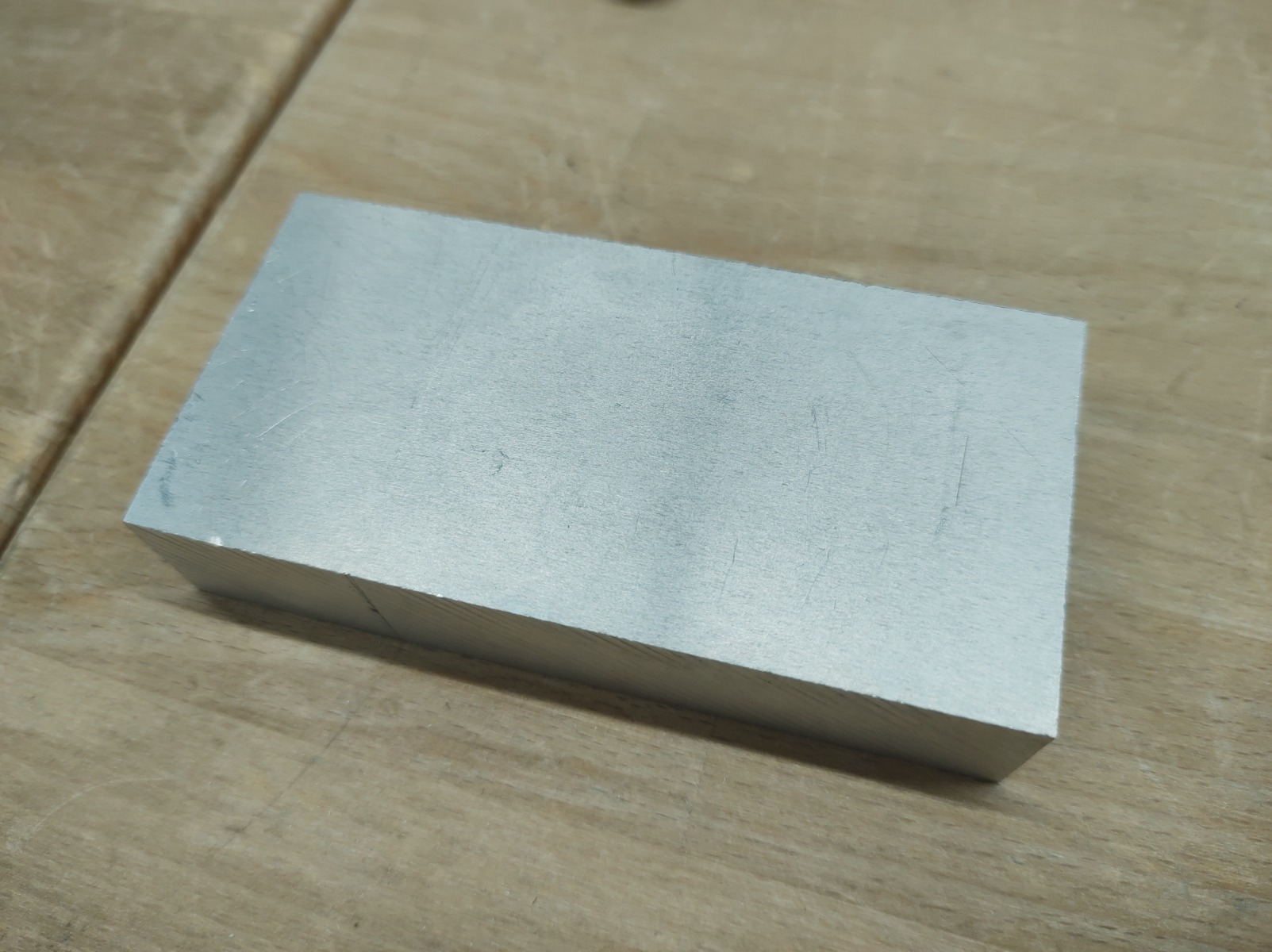

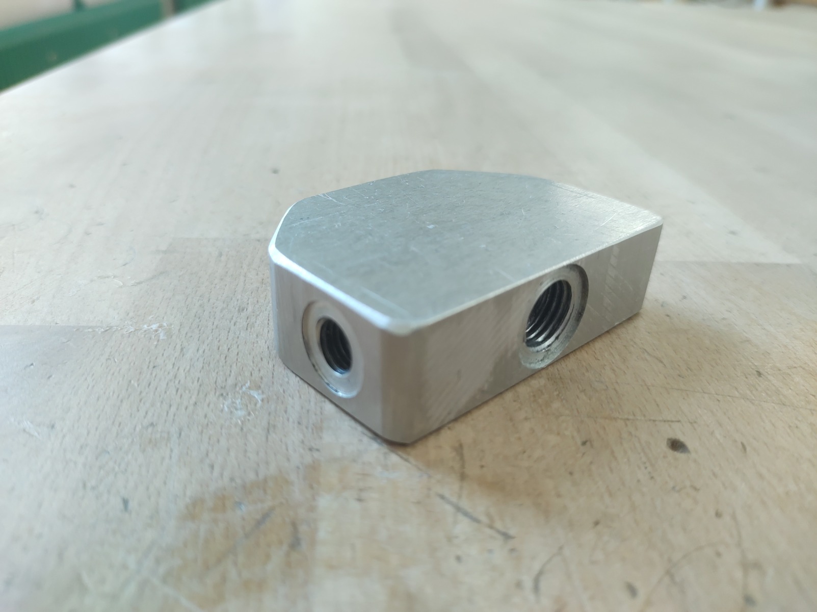

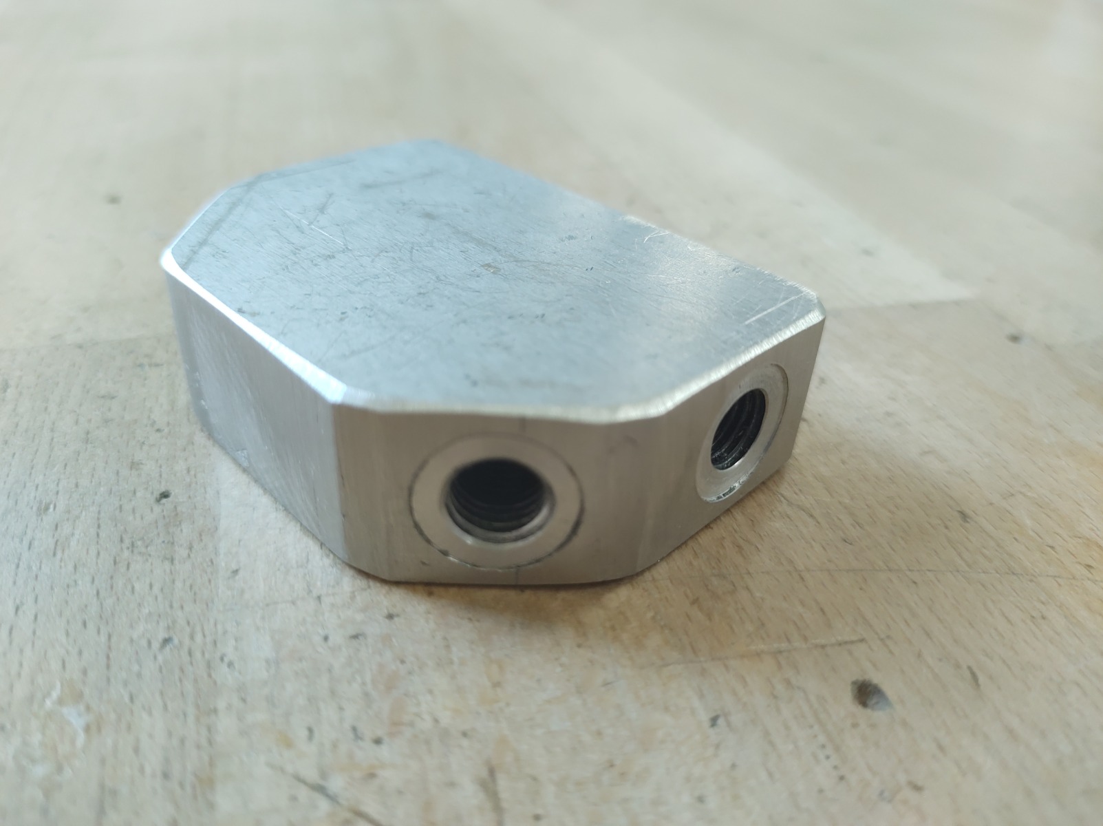

Made the most of my lunch break and got the manifold for the oil lines done. Need to figure out how I'm going to mount it to the valve cover but I have a couple of ideas.
