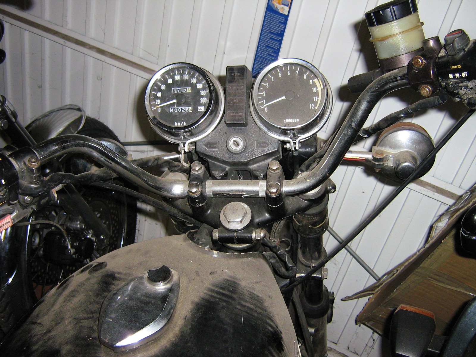

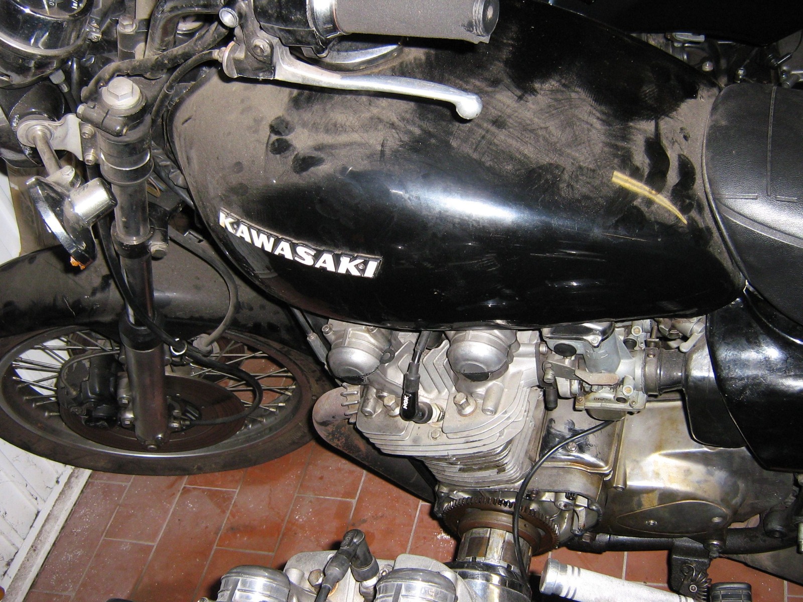

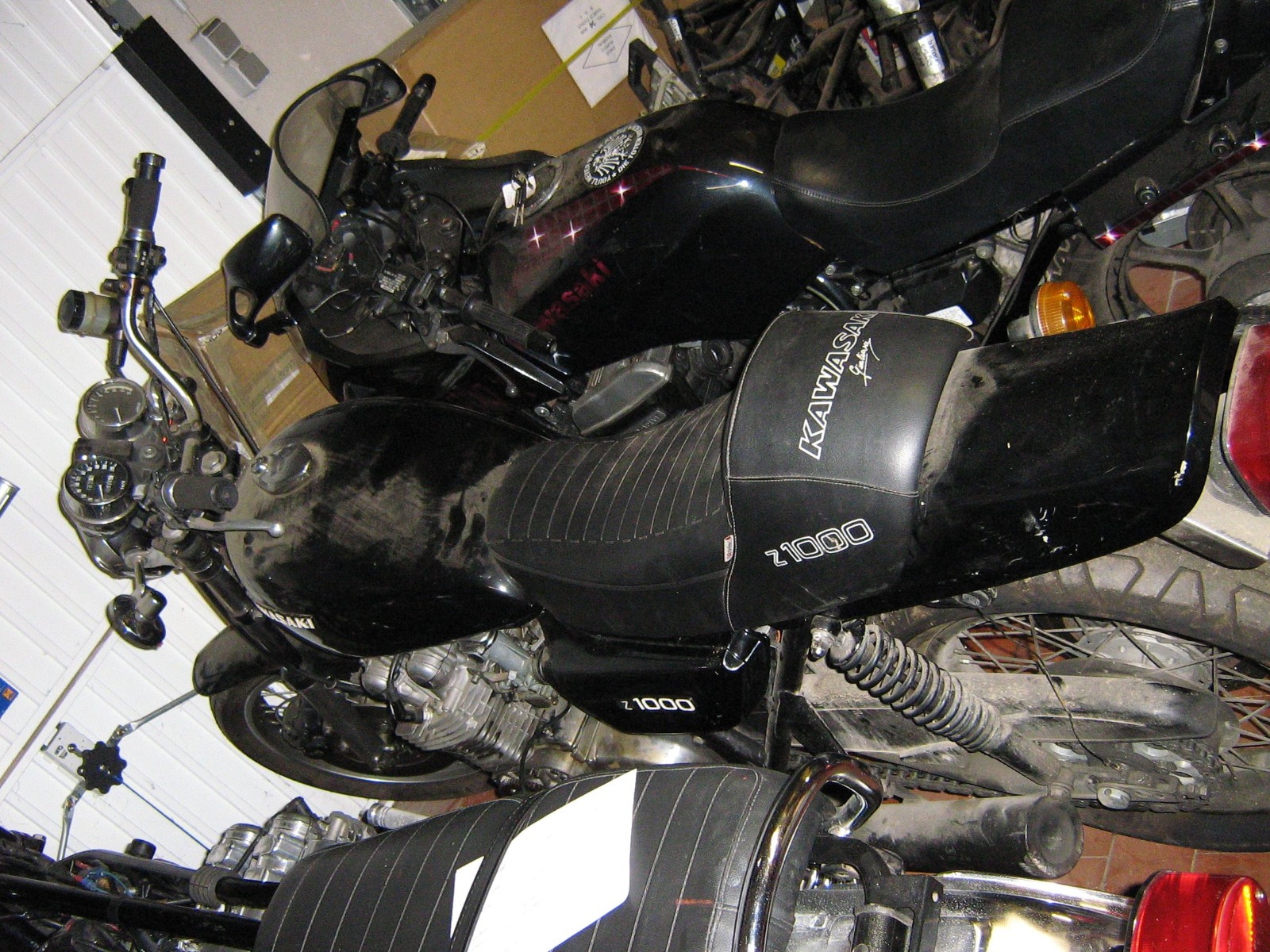

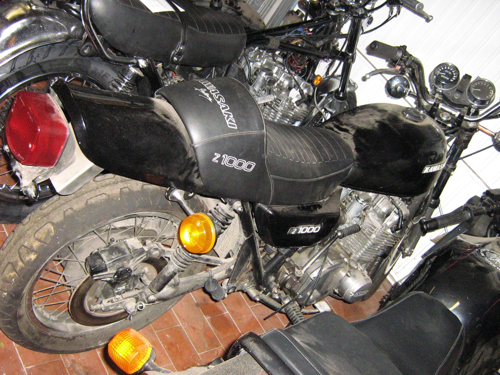

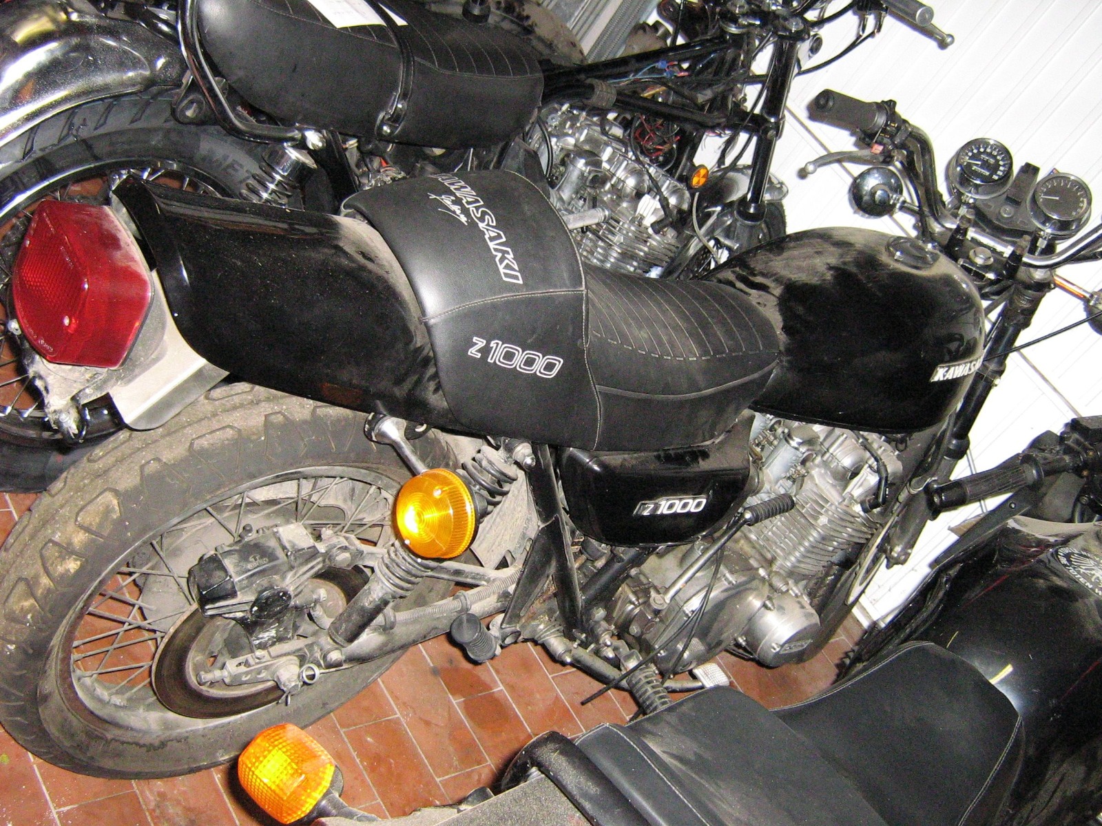

Anyway, here's some pictures of the bike in its current state:
