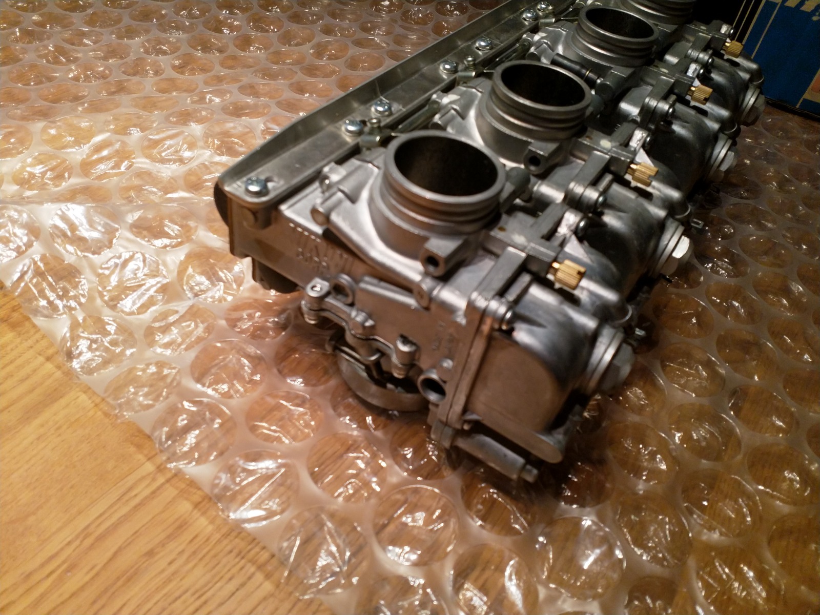

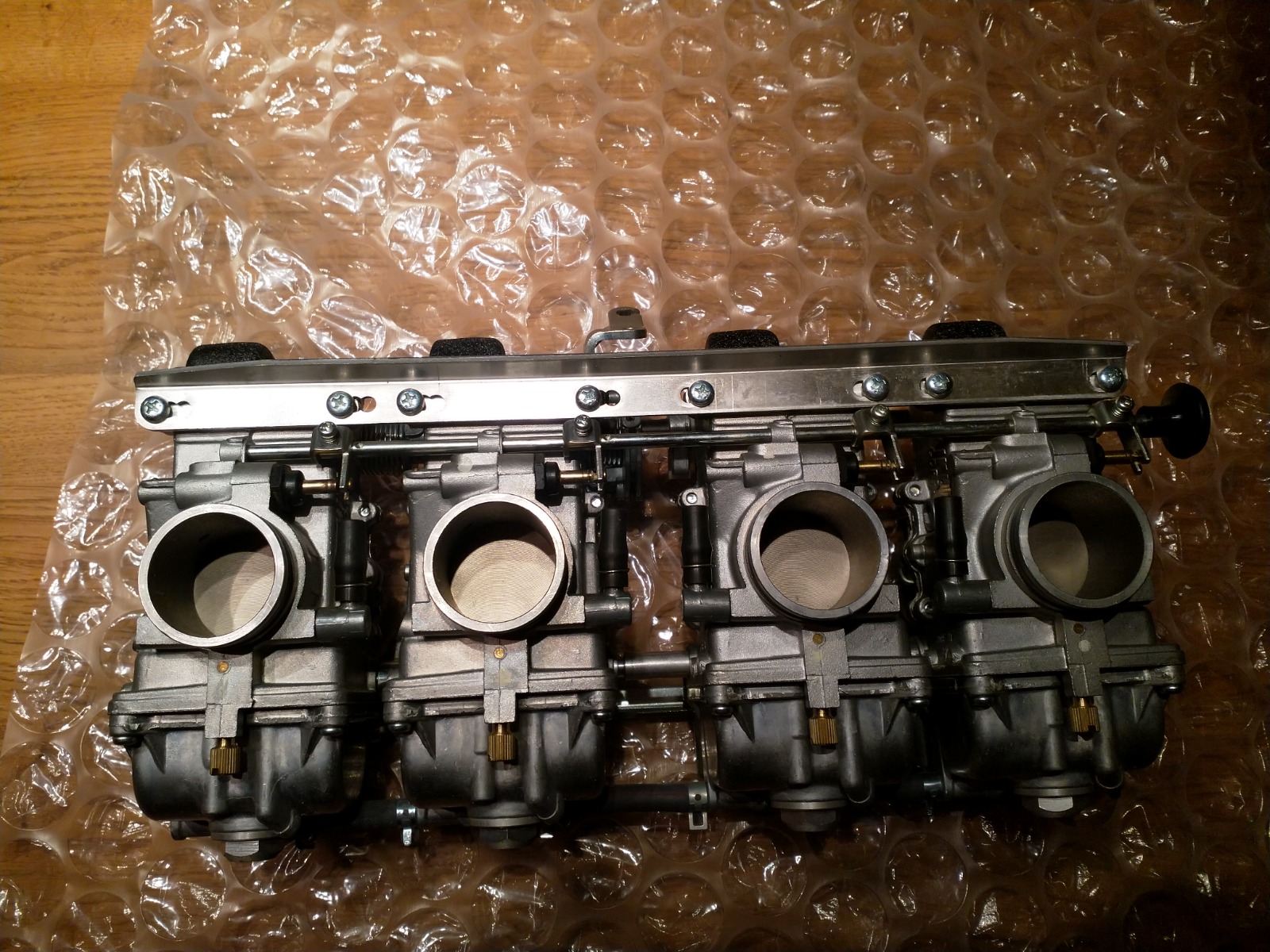

Had another win today - got a set of RS34 carbs (including intake boots and oval K & N pod filters) and also a stainless exhaust system - a good quality copy of the Schüle system: www.schuele-maschinenbau.de/produkte-artikel/z-1000 .
It was all new and unused, but had been sitting in a climate-controlled garage for the last 10-15 years. Carbs have never seen any petrol and the exhaust was just mounted up to see how it fits but has never been on a running engine. Paid about half of what it would have cost new.

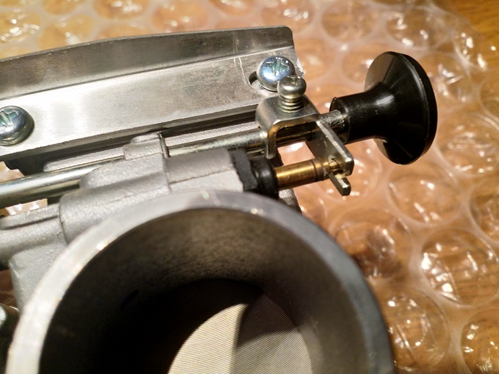

All the rubber on the filters, boots, vacuum plugs etc. ist nice and pliable. The only thing I'm not sure about is the choke. I have no idea about these carbs but the choke plungers seemed to have been greased and the grease is pretty old - not completely hardened but getting there (you can just see it around the end of the shaft in the picture below). Should I pull out the choke and clean up and regrease the shafts? Also, is the choke supposed to spring back unless it's fully open?
Guess I need to learn about these flat slide things now.
