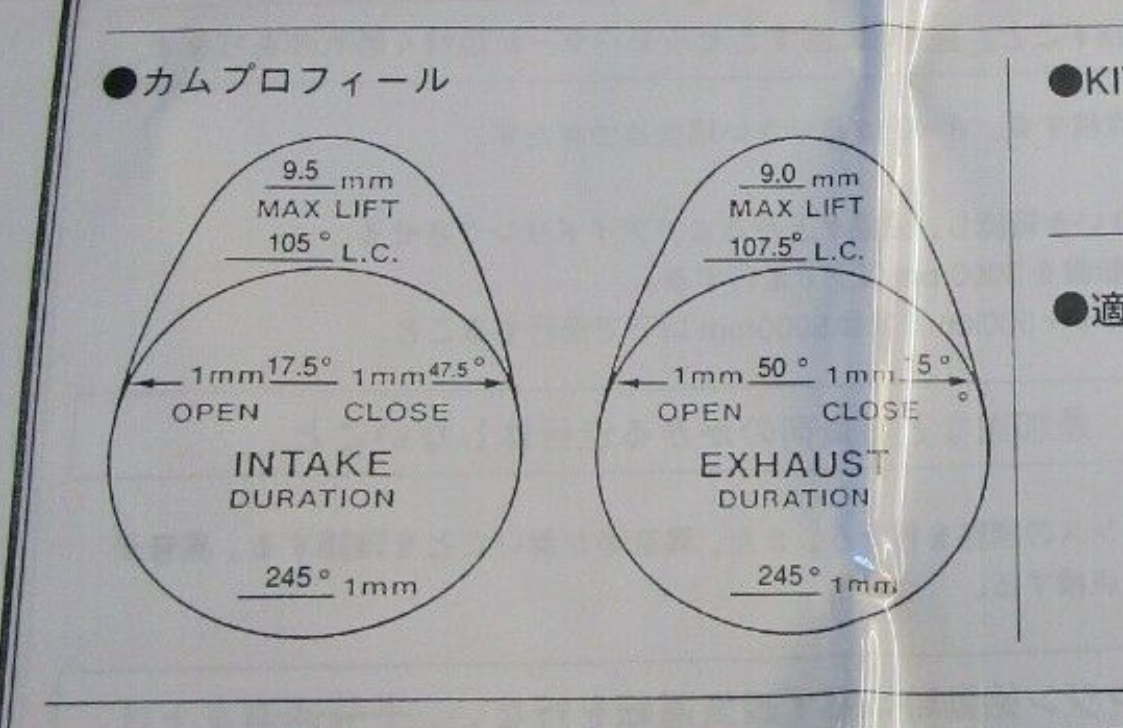

Trying to learn a bit more about cams. Here's what I think I know
Here's what I've got so far: As far as degreeing the cams goes, I think I just need to make sure the intake is at max lift (9.5mm) at 105° ATDC. The exhaust should be at max lift (9.0mm) at 107.5° BTDC. The other values are just the positions at the checking height. Is this right? Does this only work on symmetrical cams? I assume the max lift would no longer coincide with the lobe centre on asymmetrical lobes.
- If I use adjustable camshaft sprockets then I just need to make sure that TDC is the same on the 1 & 4 and 2 & 3 condrods and don't actually have to check the indexing on the crank.
- I then just need to look at the picture below and pretend I understand it :dry:

Regardless of cam symmetry the lobe center timing method will get them degreed correctly every time.
You can use whatever checking height you like ( even negative figures) as long as you use the same ones in all your calcs .
You only need to locate true TDC on cyl 4 ( right hand , ign side, end cylinder) for cam degreeing .
This will cam time all cylinders unless the crank is twisted .
