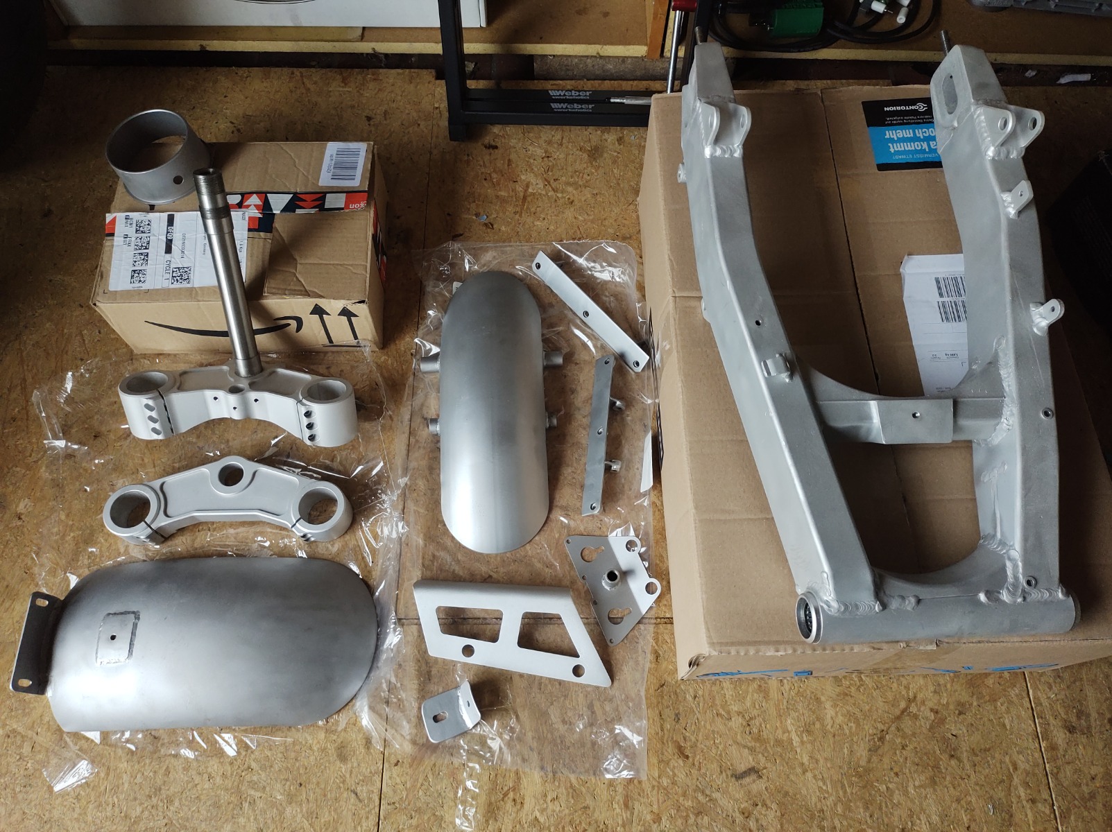

Did some bead blasting today. Will do the forks and tank next week and then start painting (should have the frame back by then).

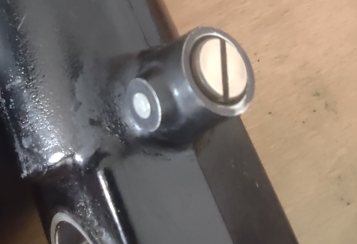

Finally got around to pulling the forks apart today. Will bead blast the lowers next week but before I do I was wondering if it's possible to remove the compression daping screw. I don't think it will come out without drilling out the plug on the side but I figured I'd ask just in case anyone knows better...
Also, I'd be interested to know what the screw actually does - how does it actually restrict oil flow?

The screw changes the size of the by-pass passage (like a mixture screw on a carb) to adjust the oil flow rate
