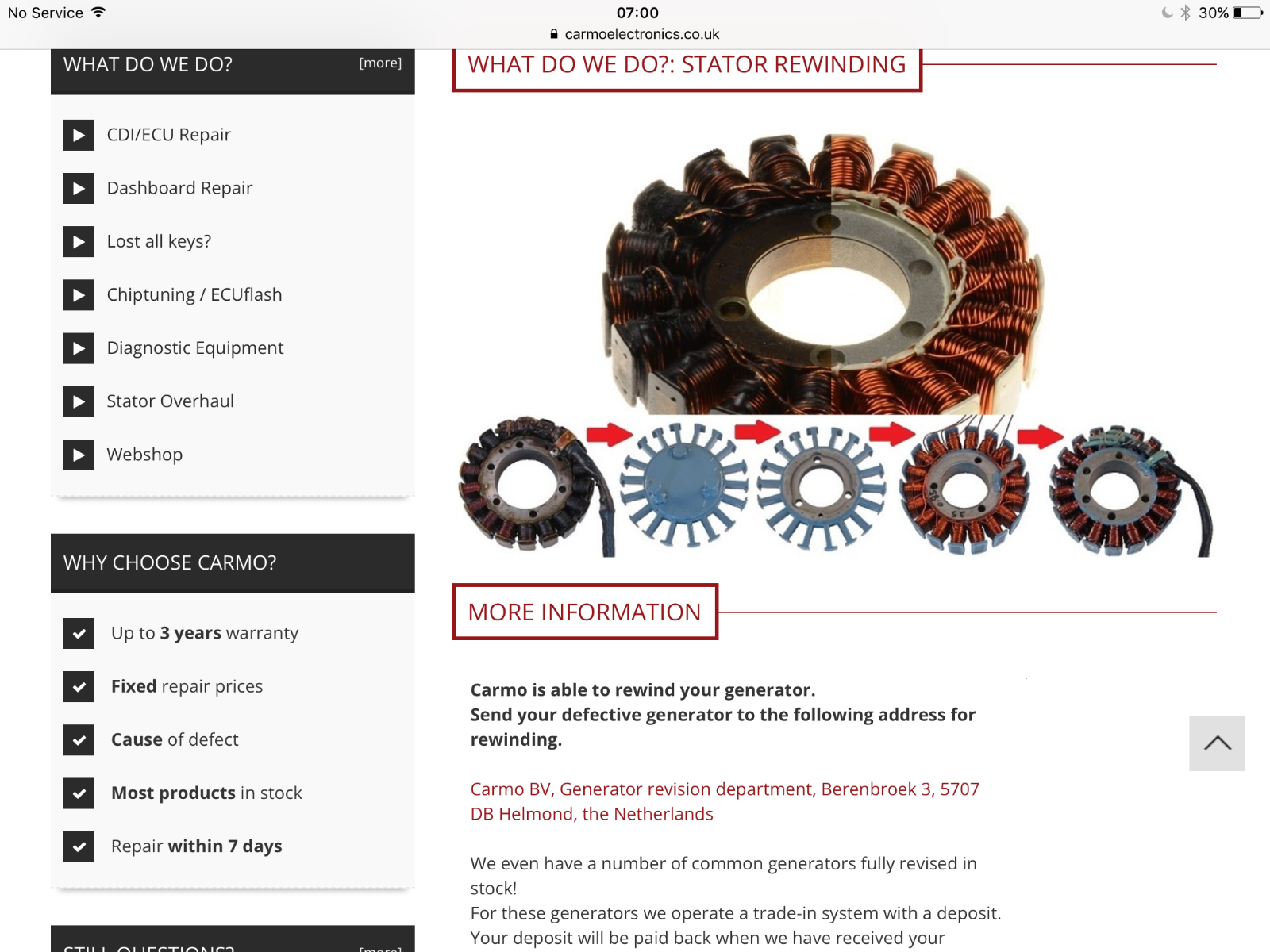

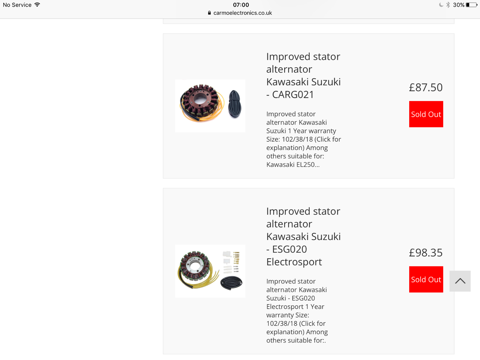

That sucks, don't know where your new stator is coming from but "CARMO Electronics" based in the Netherlands do rewinds for around €100

All good for now with the 750 stator. I ordered the new one from z-fever here in Germany. They usually have pretty decent replacement parts and it costs about the same as the cheaper one from Carmo.

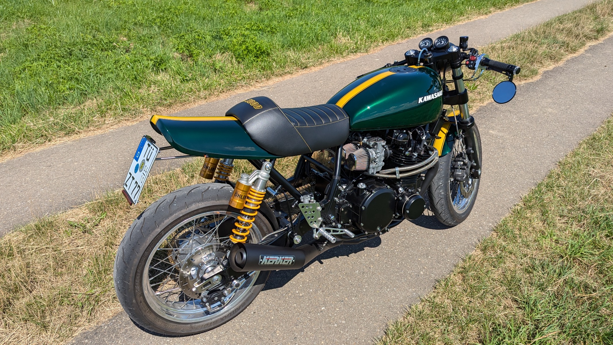

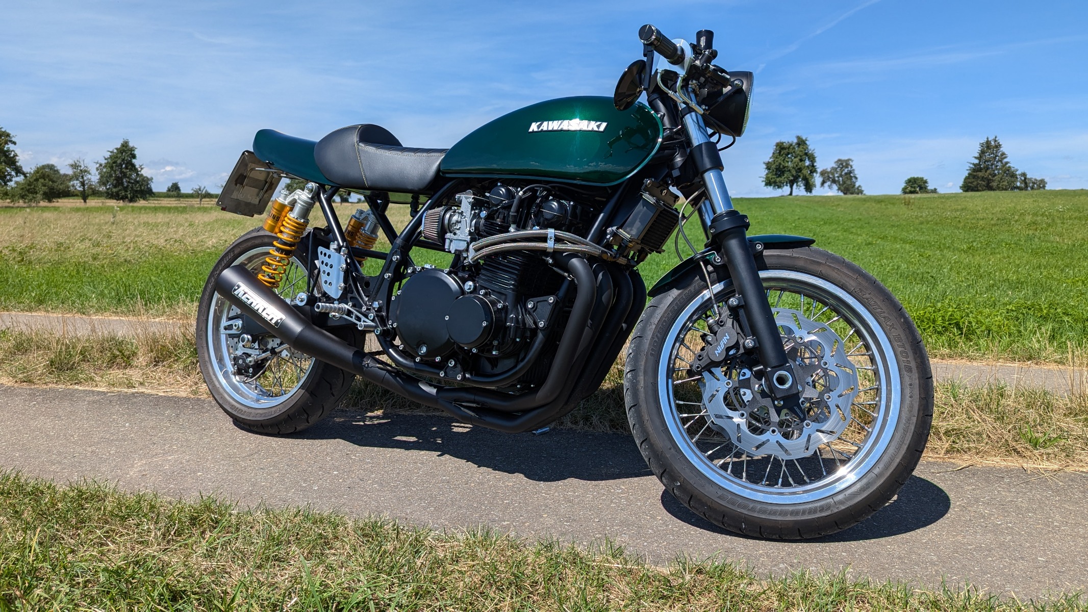

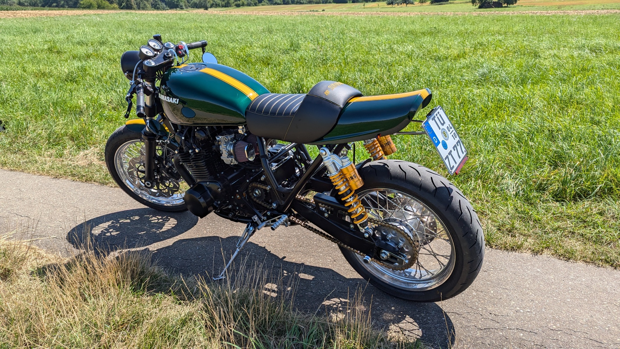

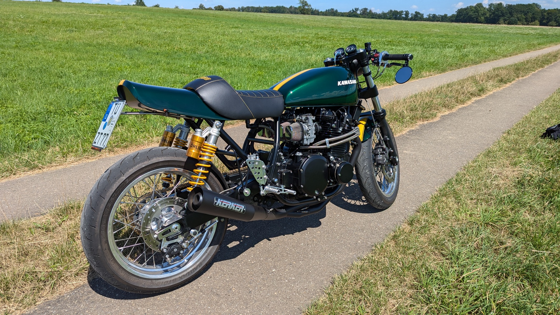

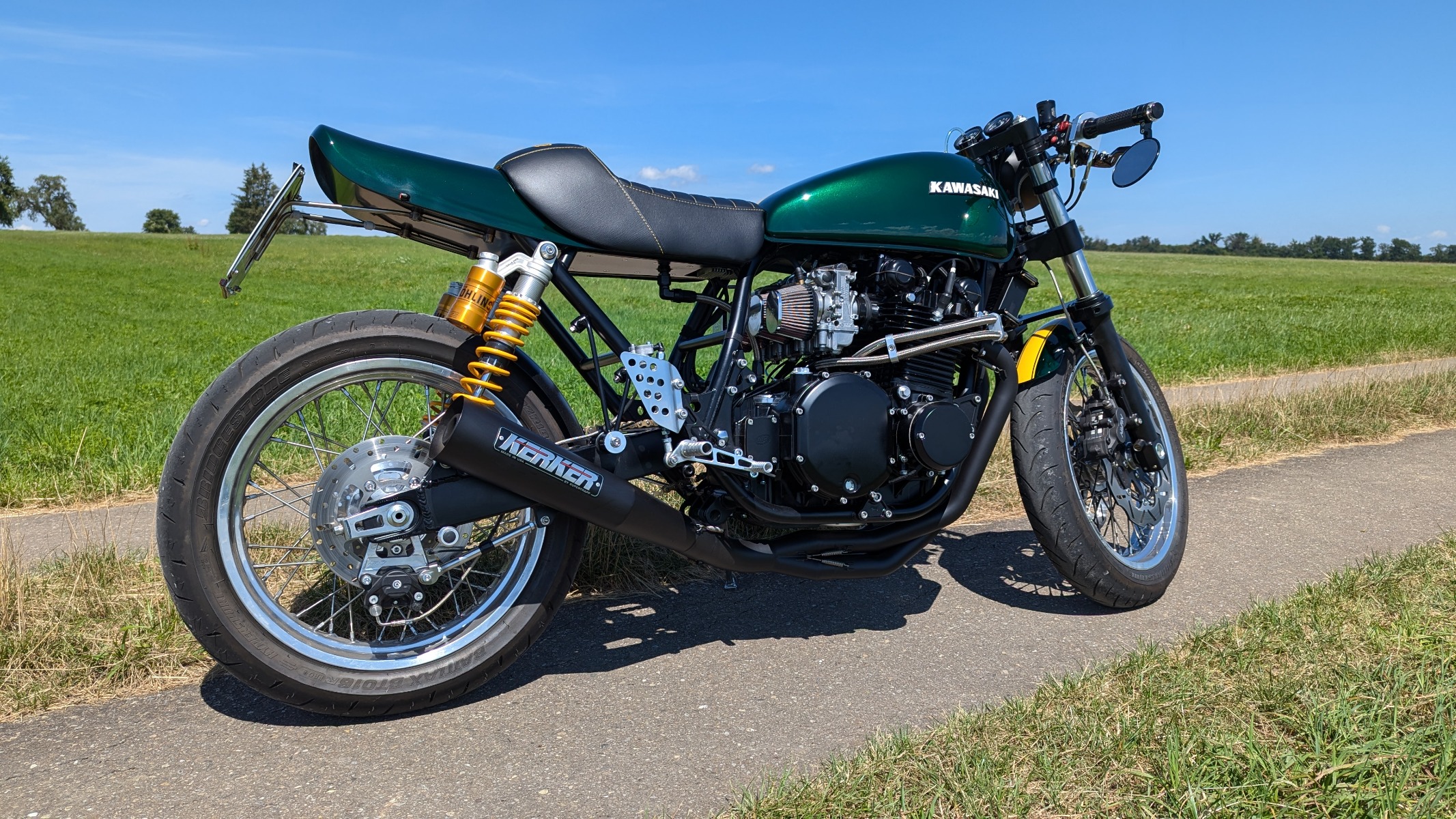

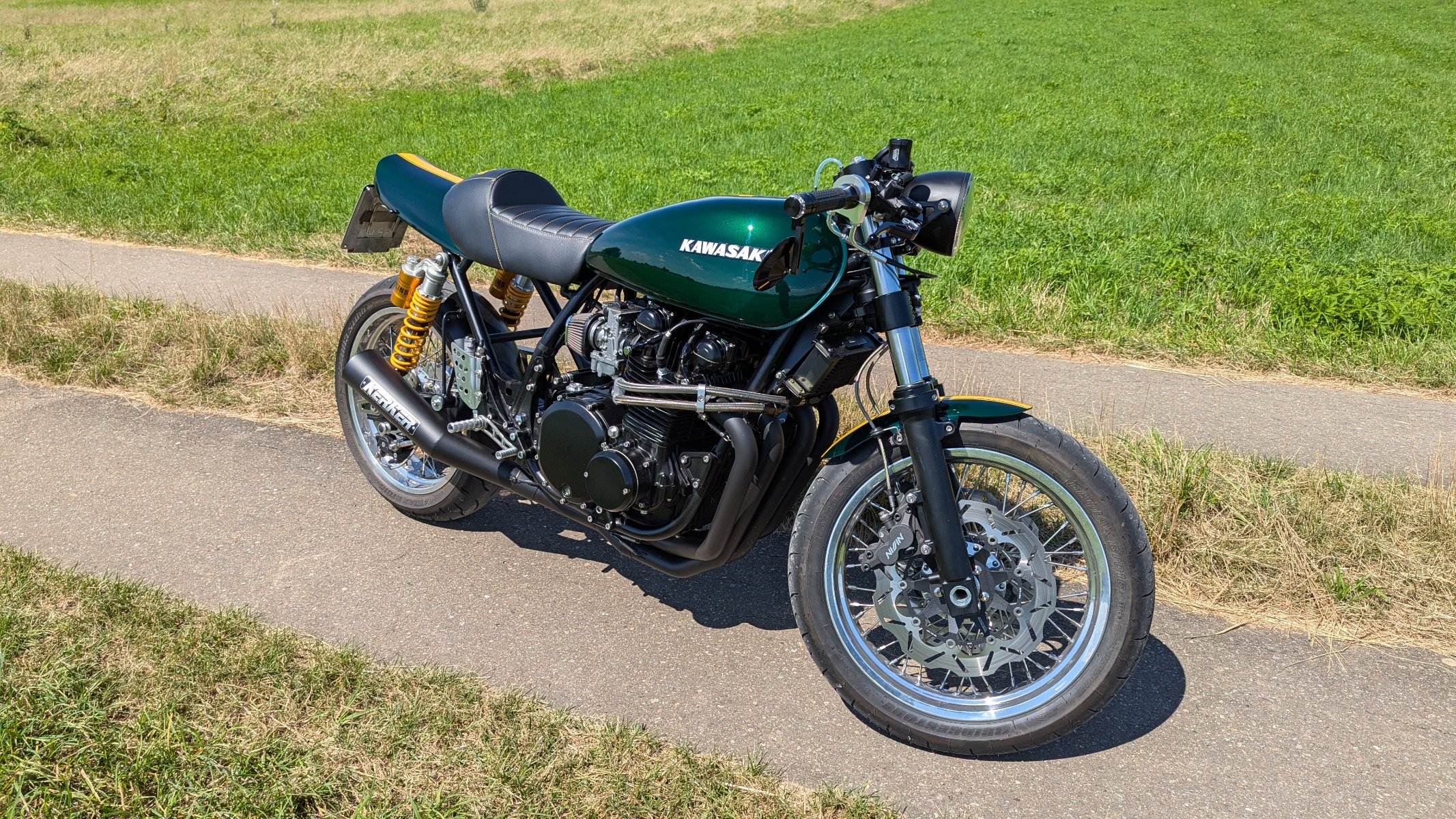

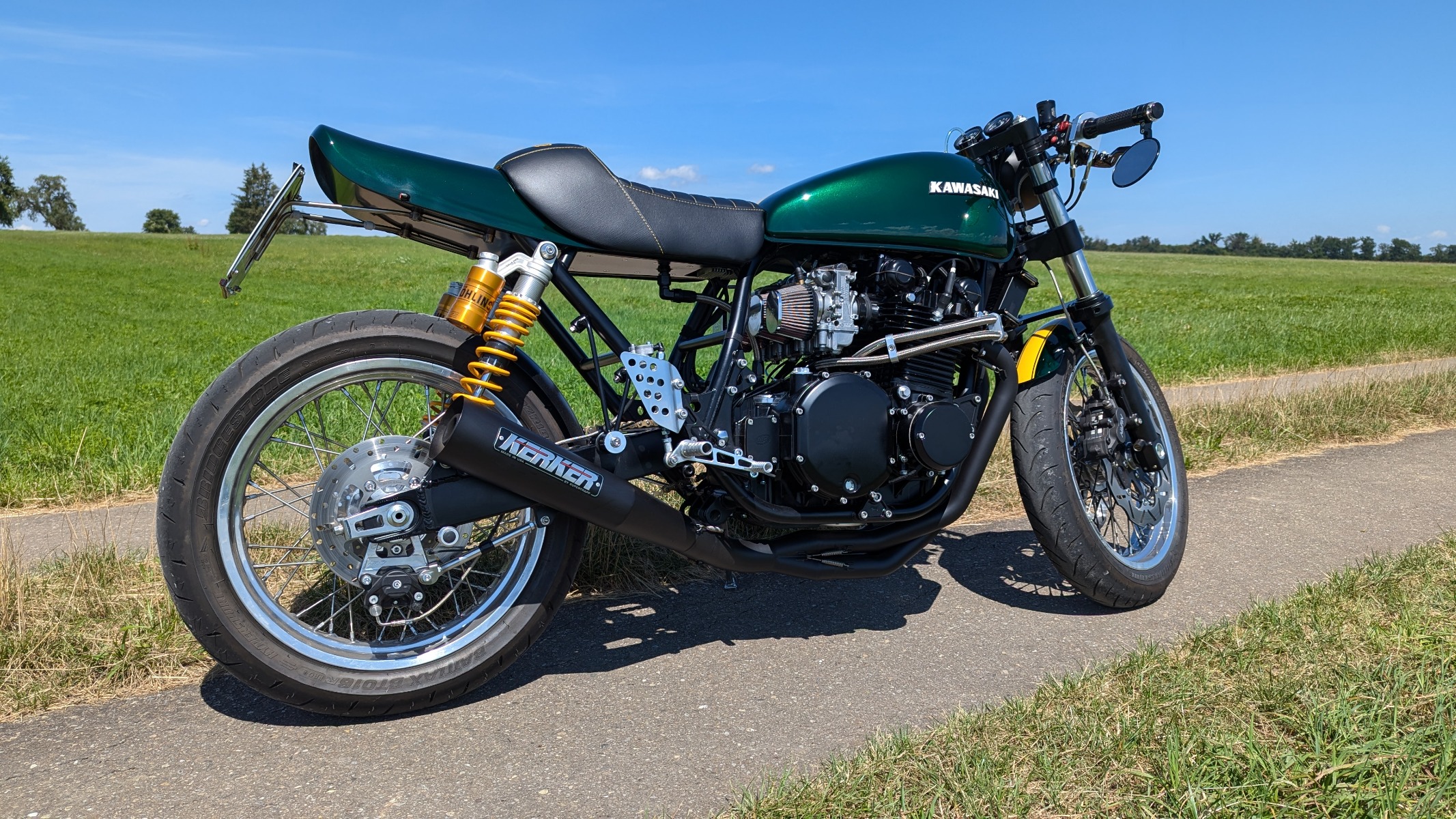

About time for an update I reckon...
Got the bike back about two weeks ago. Put about 500km on it and have got through all the teething problems. Have a very slight oil leak around the stator wires but other than that it seems pretty dry. Need to look at the jetting sometime as well - it doesn't like going slow at all! Also may need to lean it out a bit if I'm going to keep riding in 30-35° heat. I'm hoping that won't be an issue for long, though.
The license plate bracket needs some tidying up, but I'm calling this one "finished" - at least, as finished as any project ever is...

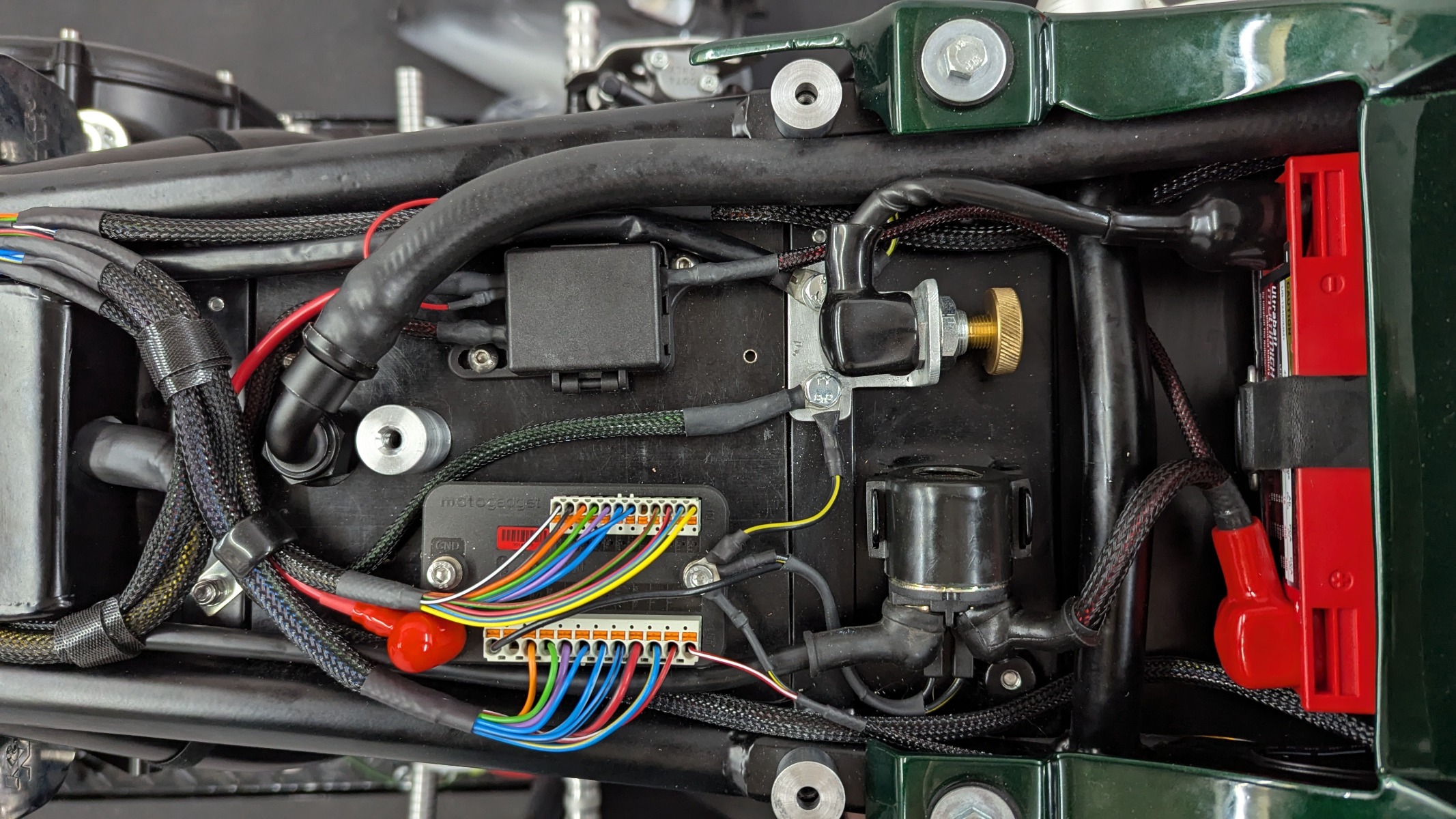

Just an update after a bit of a bad start to the year for this bike. First day out and I gave it the beans when I was almost home. The electrics died on me and I had to push it the rest of the way home (only 1km so not too bad). I've had a few problems with electronics units from this manufacturer so I decided to bite the bullet and go with the mo.unit. This meant changing the wiring slightly... which turned in to me just rewiring the whole bike.
Here's the wiring under the seat. I still need to wrap the part of the loom that runs under the tank, but it's all a lot tidier now.

I like the solution of your electric quick emergency main power shut off switch on the negative battery/frame terminall!
A tilt/tip over switch on top would be fine.......

It's more of a cutoff switch due to my lack of trust in lithium batteries. Don't think I'd be able to unscrew it quickly enough in an emergency. A tilt switch isn't a bad idea, but I'd probably just wire it to the mo.unit ground which would kill the bike without too much current running through the switch under normal conditions. If I had space I could add a relay, but the tilt switch alone would be a tight fit.
@Wookie58 Took your advice and put a 25A fuse on the regulator - there's two midi fuses in the black box at the top of the photo, one for the regulator and one for the mo.unit/mo.lock.
