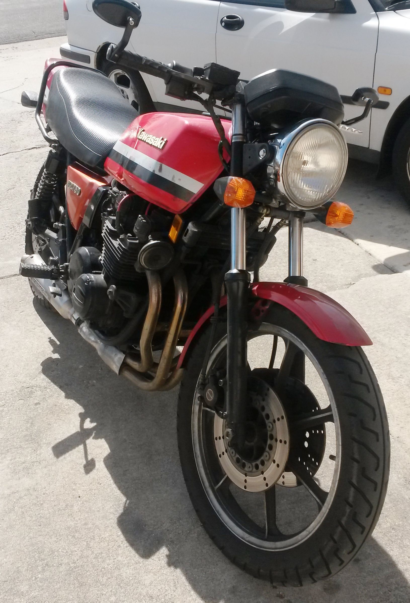

I just took my spring shake down...
I pretty much picked up from where I left off, runs pretty strong on the road but bogs down and is choppy on the highway.The exhaust poppped a bit when the throttle is closed as well, I did drop the needles before i went out and it didn't seem to help much.
I headed home and opened up the pilot screws a half turn and put the needles at their highest. It seems to have improved a bit but it still is a bit lack luster in top gear and WOT. I also noticed that that it isn't as jumpy on the road when i give the throttle a quick twist. I don't think I'm losing any power it just seems to ease to the acceleration instead of lurch into it. I'm not sure about the main jets. I'm leaning toward going bigger and if I do how much. I'm at 115 right now, I think going up to as much as Tyrell Corp has might be a bit much for this altitude... But am going to end up with a bigger mid pipe and muffler.
Here's a shot of her in the driveway after my last run. The handlebars are nice. I just need to lift them slightly for best position.

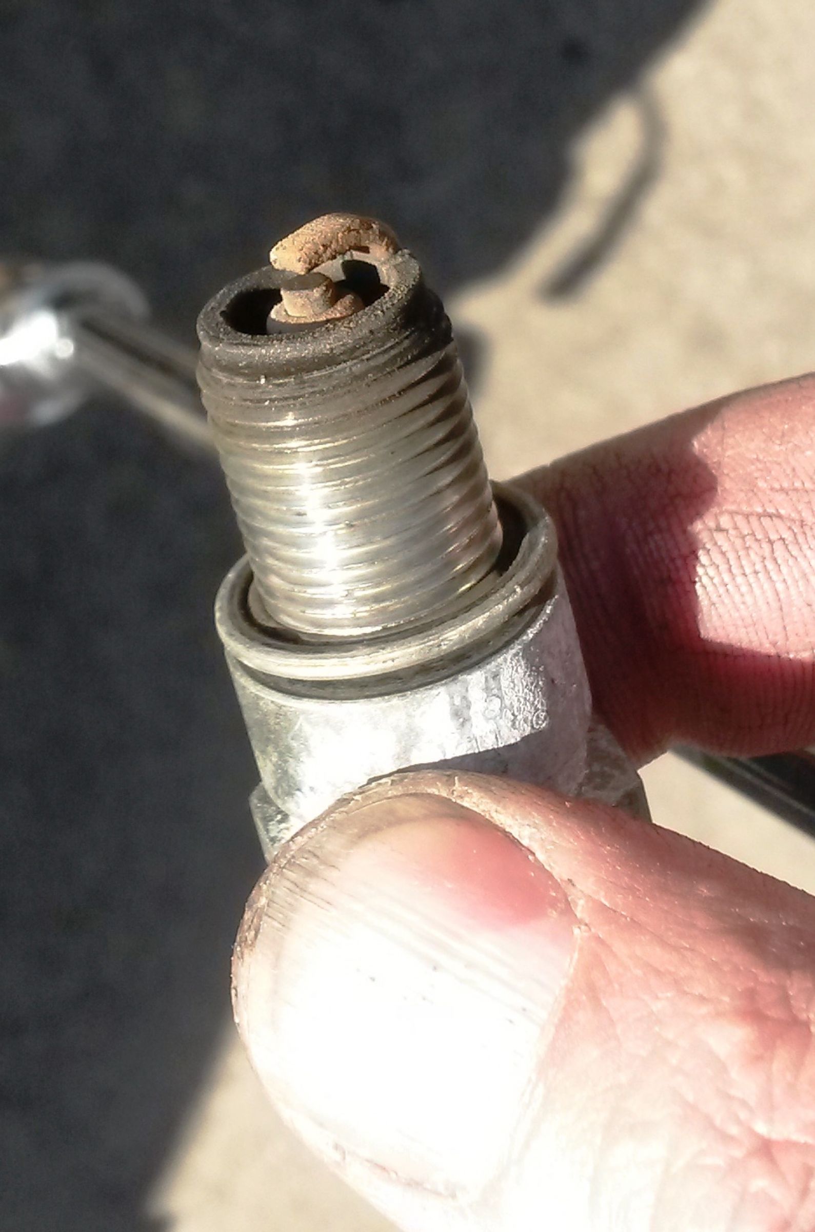

Re: 1982 GPz750 Phase II Making It more Unique.
28 Feb 2016 13:41
Pics of plugs?
28 Feb 2016 14:30
How old is that plug?

28 Feb 2016 14:50 - 28 Feb 2016 14:52Honestly, I don't recall. I either replaced them when I bought the bike or they looked newer when I pulled them to do my compression check. Probably less than 5k regardless.swest wrote: How old is that plug?
Edit: 3k
28 Feb 2016 14:53
That's good. I like the color. Check your lead ends.
28 Feb 2016 15:46#1 plug felt slightly loose and #2 lead MIGHT not have been set solidly. I might have enough time to go on another quick run after dinner before it gets too cold.swest wrote: That's good. I like the color. Check your lead ends.
28 Feb 2016 17:35
Got out just before dark. Same issue, did a full throttle cut out. Lean, dry as a bone and white on #4. Guess I need to order some jets.
