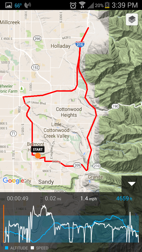

05 Mar 2016 09:22I understood but IDK if you have pods or not. The only size they had available in a full set over 130 was the 132.5 and considering the difference in altitude I figured it would probably work.Tyrell Corp wrote: see my reply on page 1, your 115 main sounds far too small to me. I'm using 137.5, sounds a bit too big I know...
This is my route I took for the second run It varied from 4300 - 5100 ft. Once I start going up those canyons I'll be up over 9k in some cases. There's a few day rides i can take that go above 10.

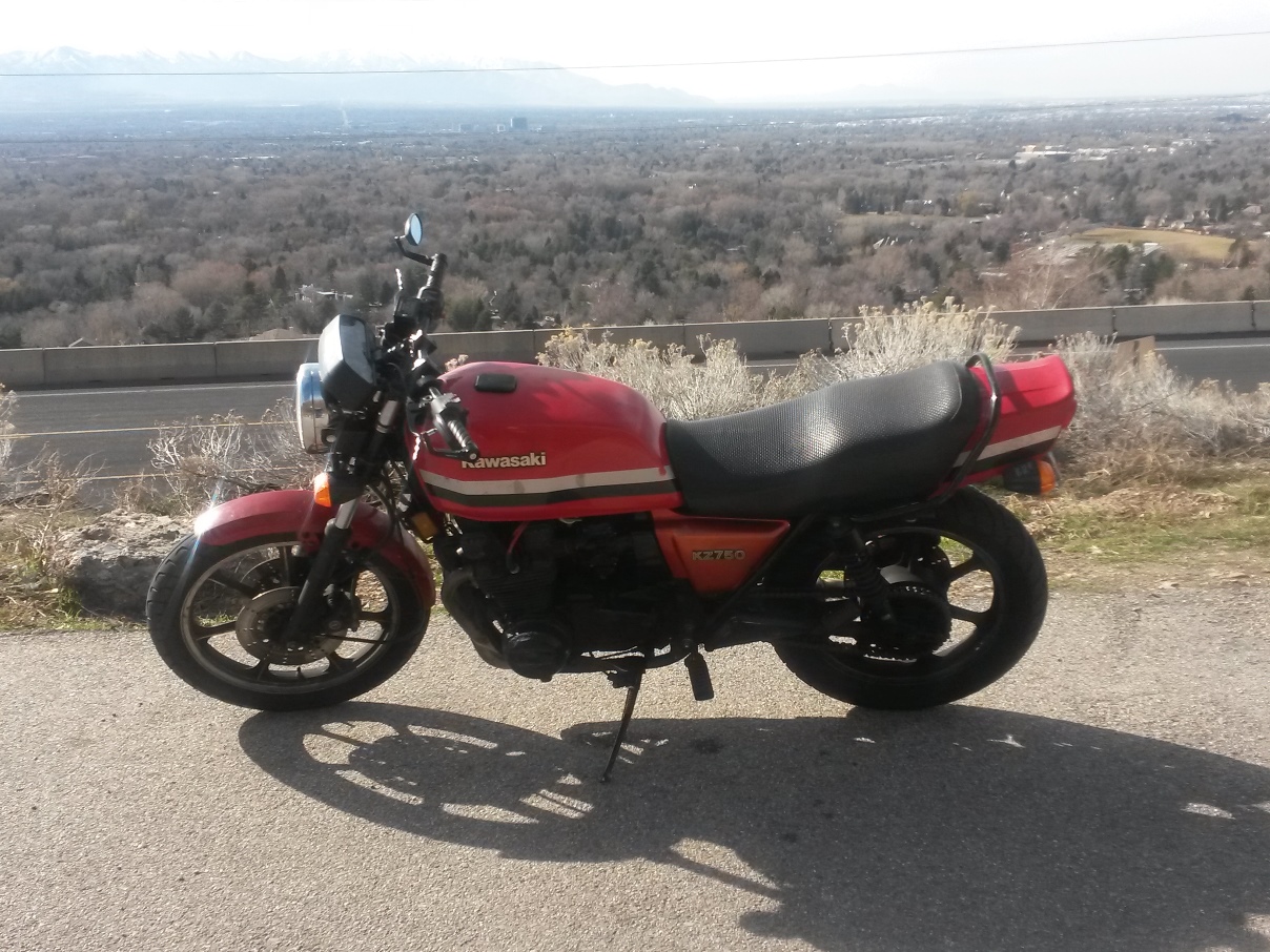

Took it for a nice tame, mostly, I hr ride. It ran really well and I have no complaints. I really like the drag bars. They are pretty much the perfect position for me. Not too low or too far forward. If I crank the bars to one side or the other the switch housings just slightly kiss the top of the tank. I'll se if I can't make some slight adjustments to cure that. I believe it is time to start going to work on it.
