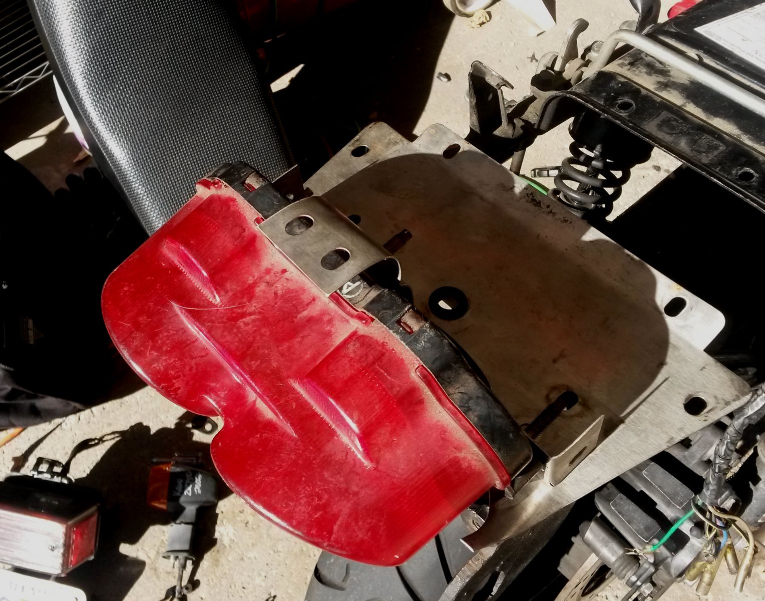

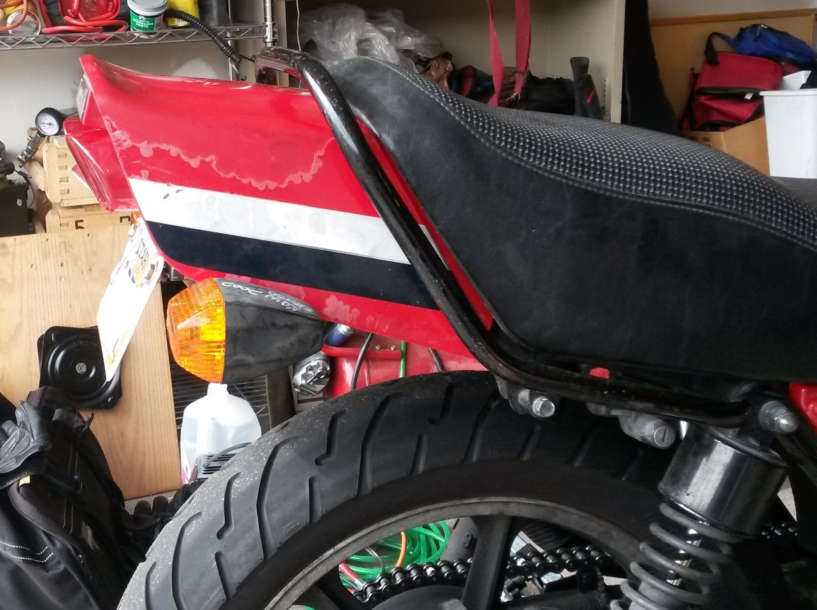

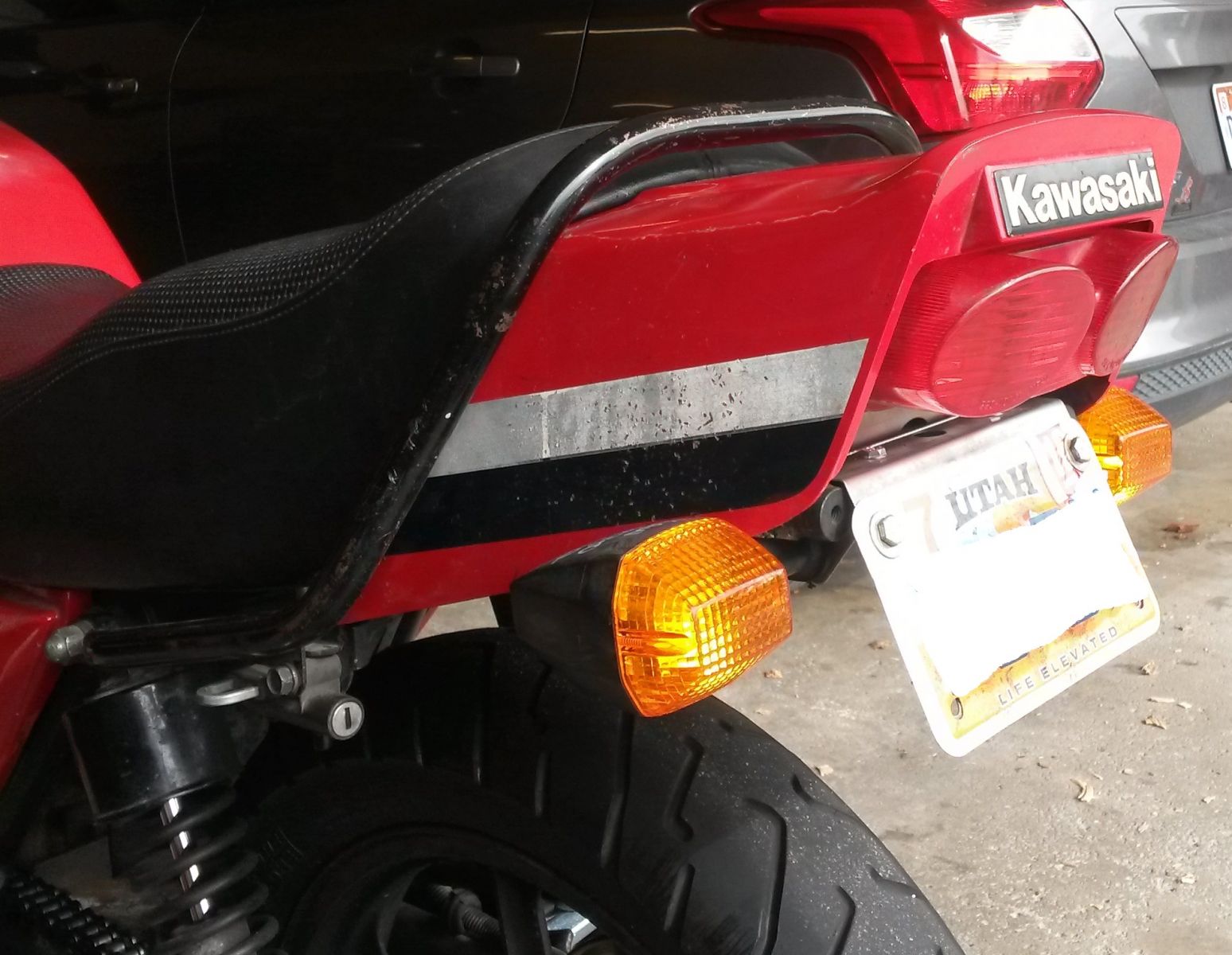

i started to mount the ZR7 tail light today withthe help of a saveaged ZR7 Fender Eliminator kit that I bought of ebay.
Here's a tease shot.
I'll post a pic of when I'm done.
I can do a write up if anyone is interested. I'm trying to do a few picks as I'm going along.

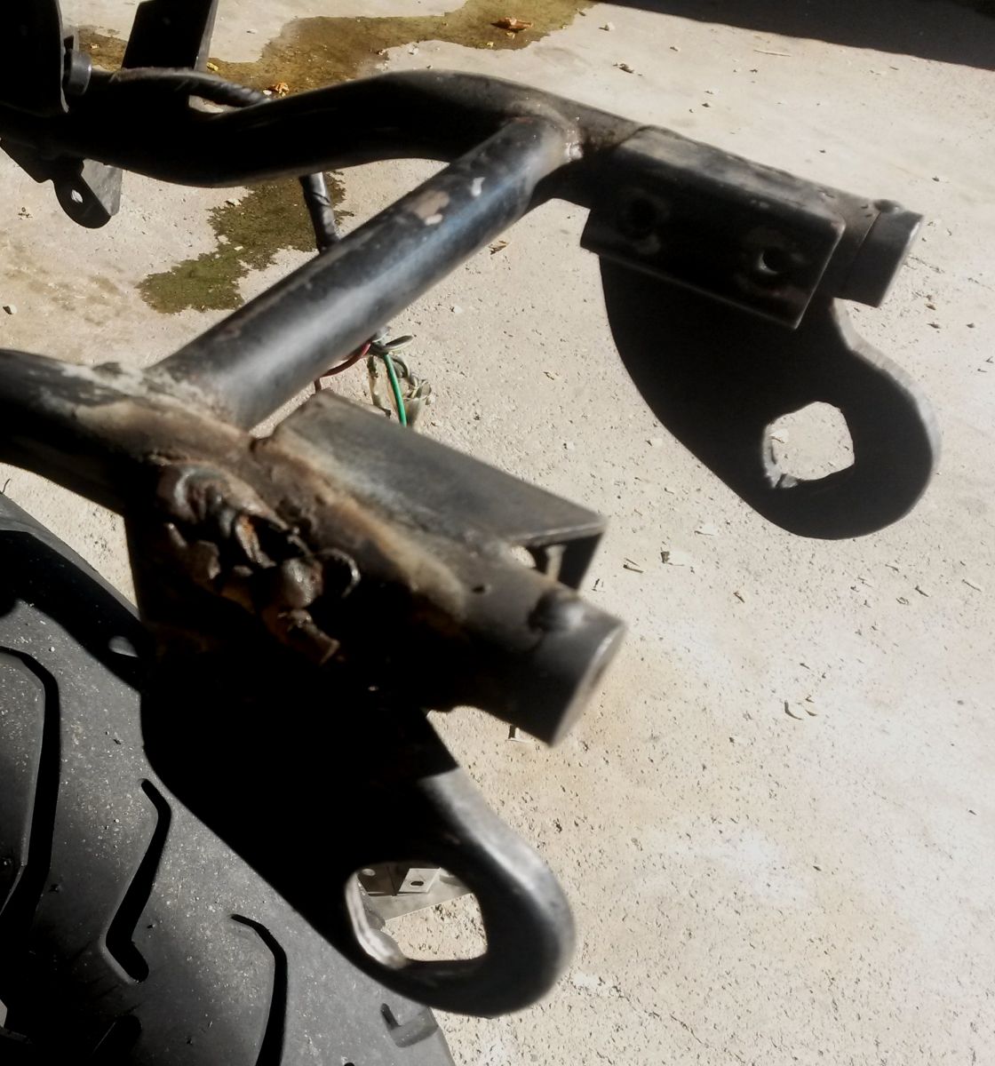

My one and most likely only exception I have just taken. A PO had some sort of issue with he turn signal tabs. One side was a cobbed reweld of the original tab the other side was a fabbed piece out of 1/4" plate. They were uneven and looked like shit. I gound these off, they were in the way of my mounting the ZR7 signals anyway. If this had not been the case I would have done something else with them.

That is the same thing I did to my ELR clone rear tail light, except I used the original light. I cut then welded the light assembly to fit closer and tucked into the rear tail fairing. I thought it made a much cleaner look than the OEM style, that left the light hanging way out.

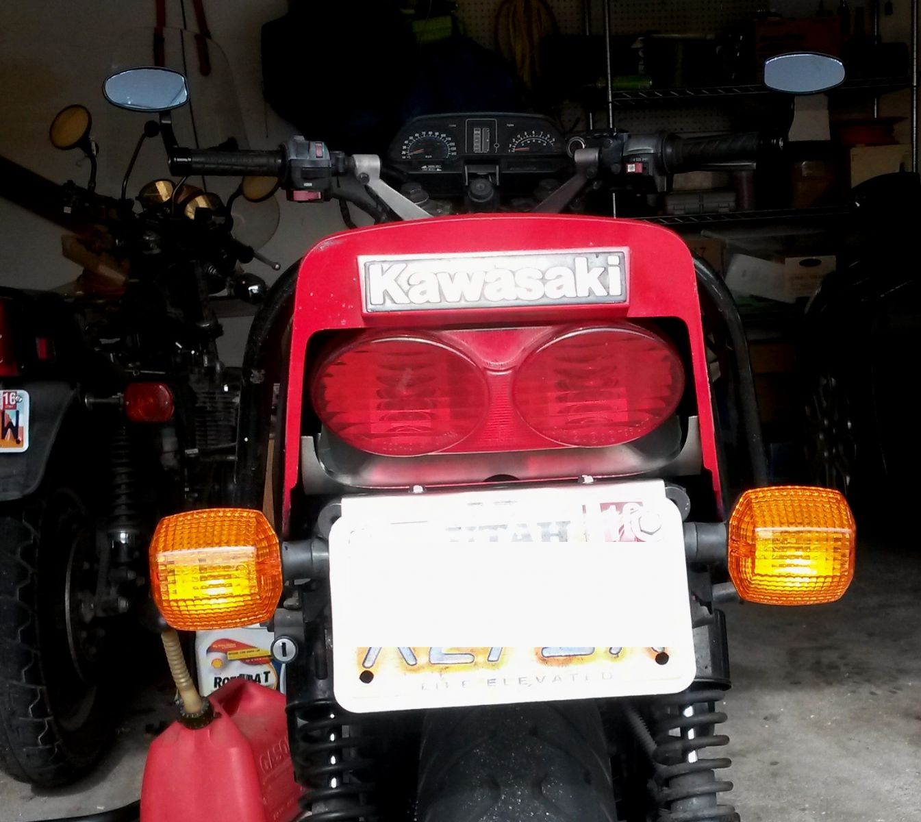

That's cool! i wanted to get away from the squareness of the light too and preserve the original mount just in case.
I just took it for a spin up the canyon and took full side shot.
