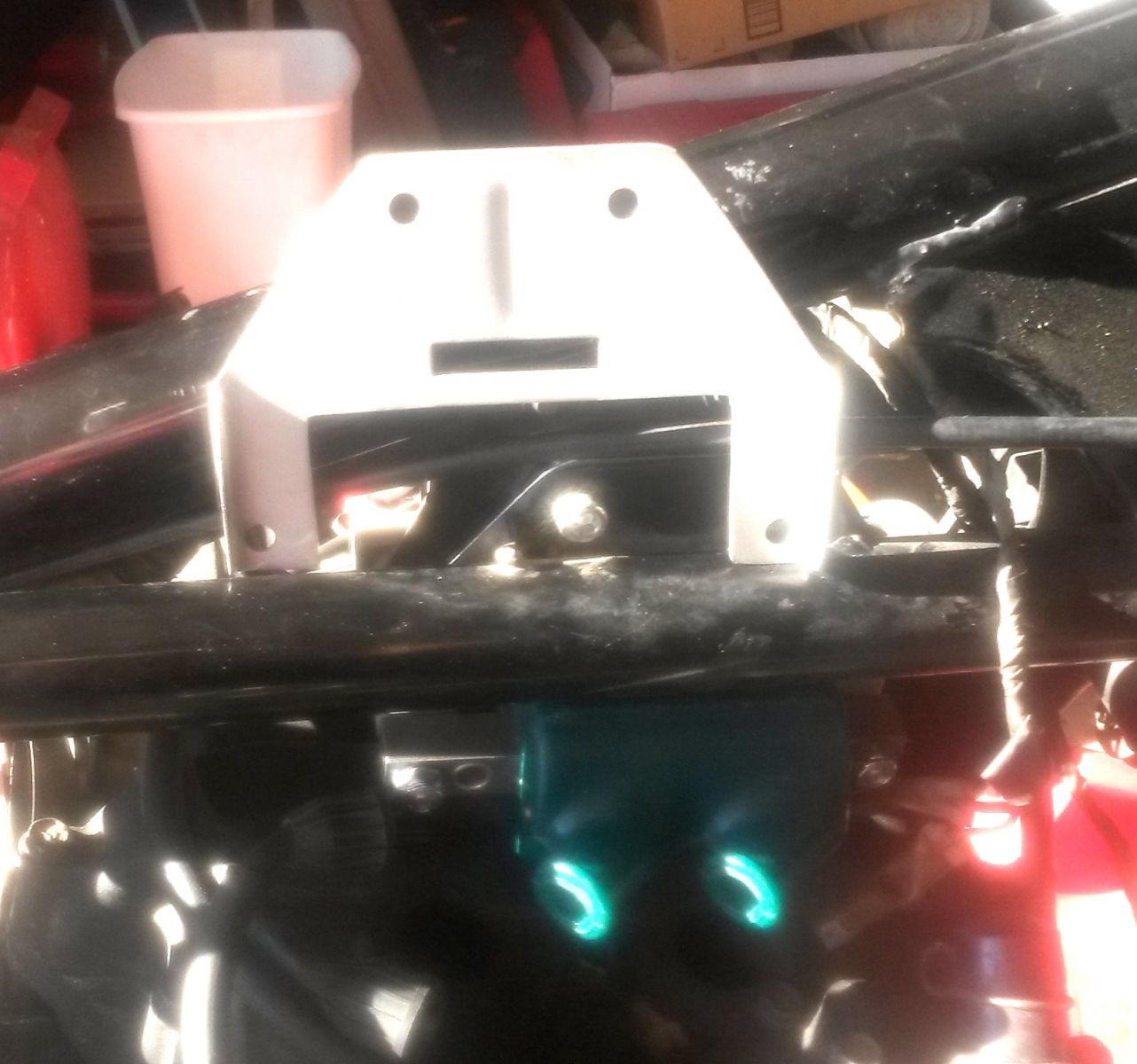

23 Nov 2015 03:03 - 23 Nov 2015 04:34Thanks I'm really liking it and the blinkers are pleasing me as well, much better than the Chinese crap that was on there. I guess that's 2 votes for and at least 1 grumble... I'm not sure if he approves or not, he seemed to be on board with the headlight this is pretty much along the vein. I now have to find something for the front blinkers.Tyrell Corp wrote: Nice work on the tail light, there were mod kits available back in the day to recess the rear light as Baldy has done too. If any of the 'comittee' beat you upover that tell them it is a 'period mod '

Speaking of the Kerker, I've been meaning to post a pic specifically for you. I've dragged it at least 3 times and has the scars to prove it. I know there was that risk but I've been having more fun than I thought I would have. I have to find a way to get it slightly outboard, to the rear and angled up. I'm not sure how to do this except to maybe take it to a exhaust shop and have them bend or weld me something since there is no way I'm going to find just the pipe between the collector and the can.

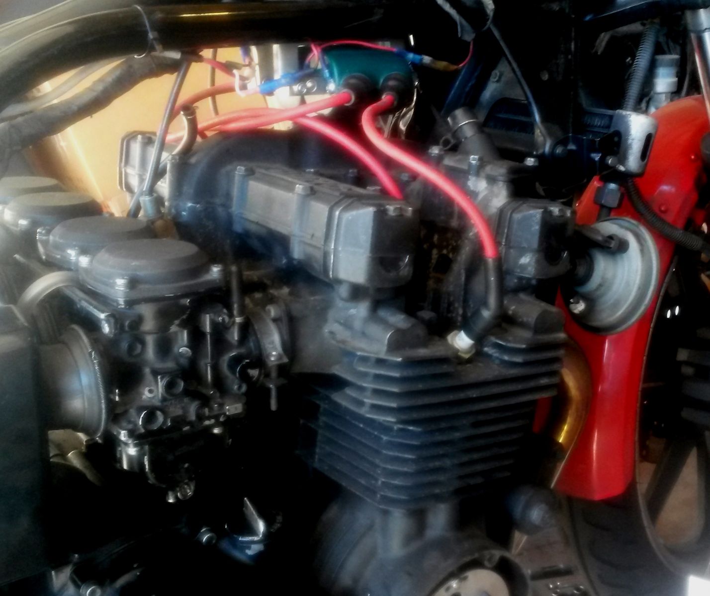

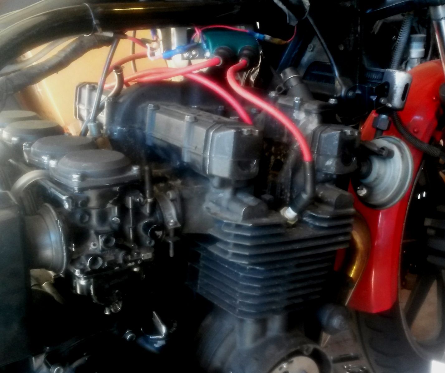

23 Nov 2015 07:41I know, It is nice to know if it something is way off base. You definitely know what I mean.swest wrote: Who gives a SHT what others think as long as you like it. :whistle:
I besides the jacked rear blinker mounts I'm leaving everything alone/reversible. I'd like to reuse other bike parts like I've done for the taillight and blinkers ('07 ZR7) and headlight ('82 Spectre}. I'm trying to keep the aftermarket parts to a minimum, at least use used parts like the fender delete kit. Even then i made use aof the left over 20 gauge SS sheet to make the mounts for my green coils.
This just before I tucked up everything ran a wire from 2-3 trigger contact to the tach wire and put everything back.
