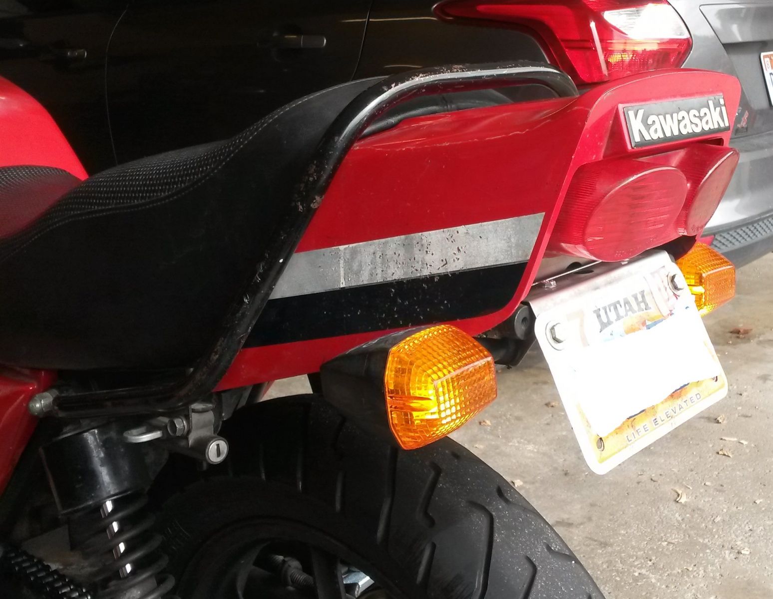

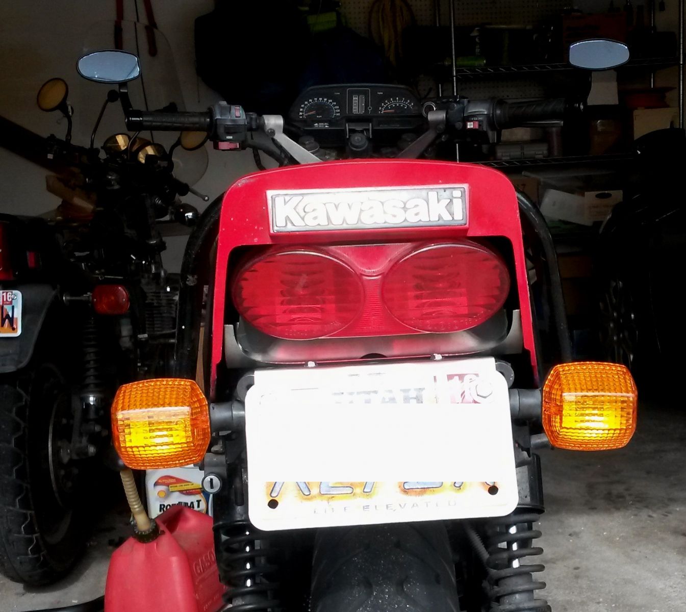

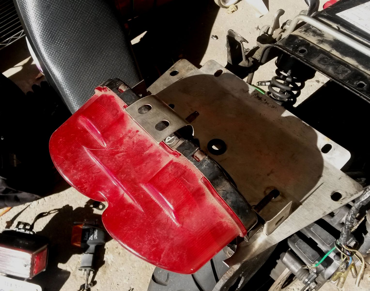

i started to mount the ZR7 tail light today withthe help of a saveaged ZR7 Fender Eliminator kit that I bought of ebay.
Here's a tease shot.
I'll post a pic of when I'm done.
I can do a write up if anyone is interested. I'm trying to do a few picks as I'm going along.

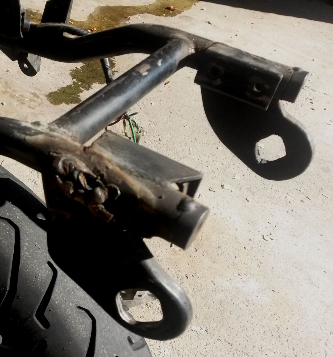

25 Oct 2015 04:13 - 25 Oct 2015 04:13With your help I came to realize how rare this bike is. I did promise not to chop this up at that time which i intend to keep.Tyrell Corp wrote: keep it coming man, we like your enthusiasm here.
Personally, I always thought the body and lines on these GPz twinshock are so timeless and iconic that you can't improve,,,bobber and streetfighter mods to me almost like chopping the tail off a cat.
As for 'more' unique, you'll never park up next to another 750R1 even at a classic bike show, just too rare nowadays.
Around 15 roadworthy GPz750r1 in UK now. ..actually double rarer than my ELR z1000R R2
www.howmanyleft.co.uk/?utf8=%E2%9C%93&q=gpz750r1
But this is your cat so feed it and she will purr
My one and most likely only exception I have just taken. A PO had some sort of issue with he turn signal tabs. One side was a cobbed reweld of the original tab the other side was a fabbed piece out of 1/4" plate. They were uneven and looked like shit. I gound these off, they were in the way of my mounting the ZR7 signals anyway. If this had not been the case I would have done something else with them.

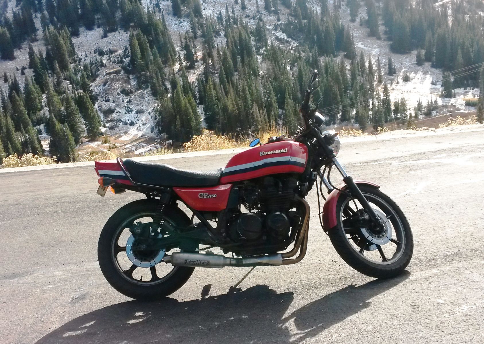

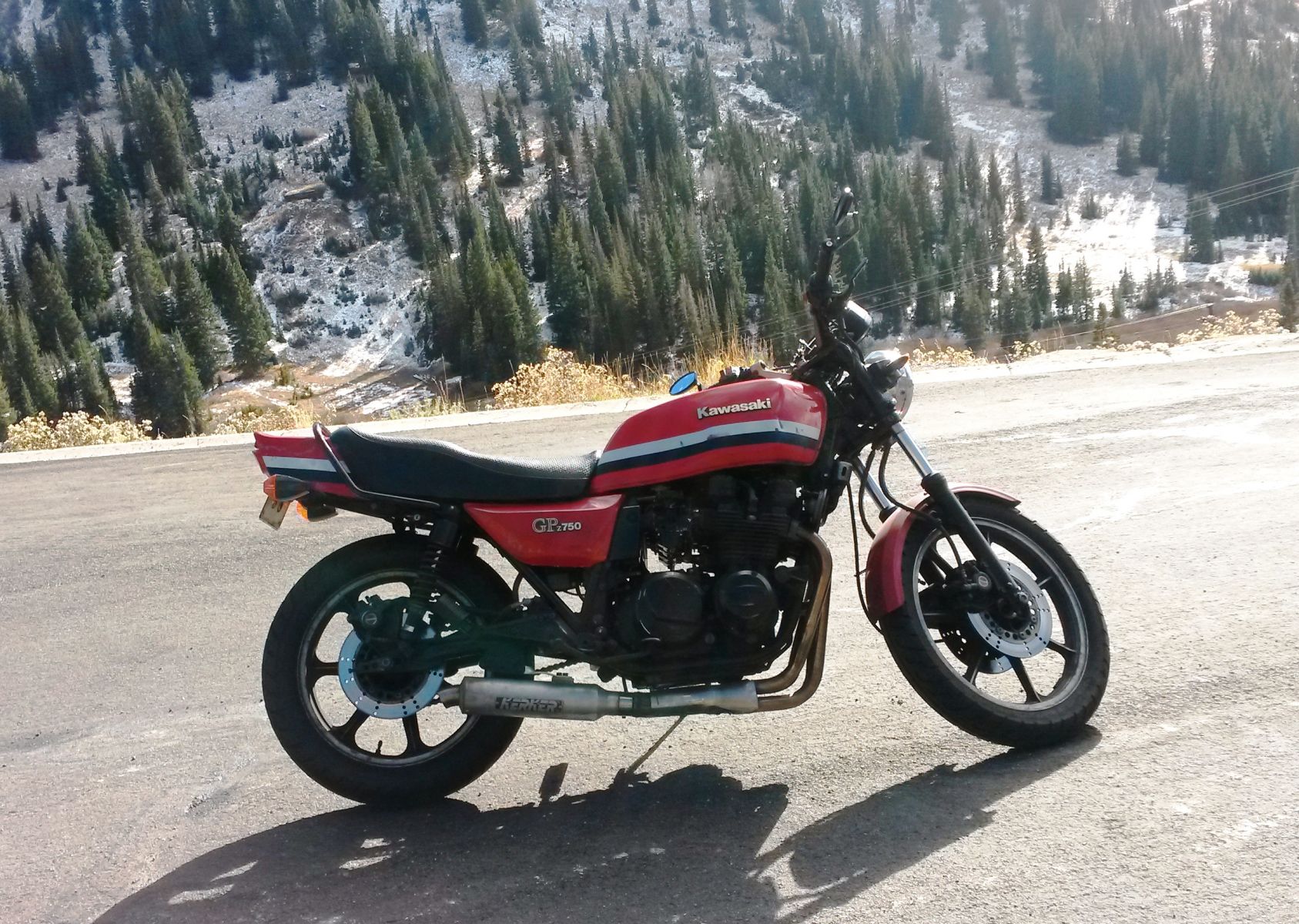

That's cool! i wanted to get away from the squareness of the light too and preserve the original mount just in case.
I just took it for a spin up the canyon and took full side shot.
