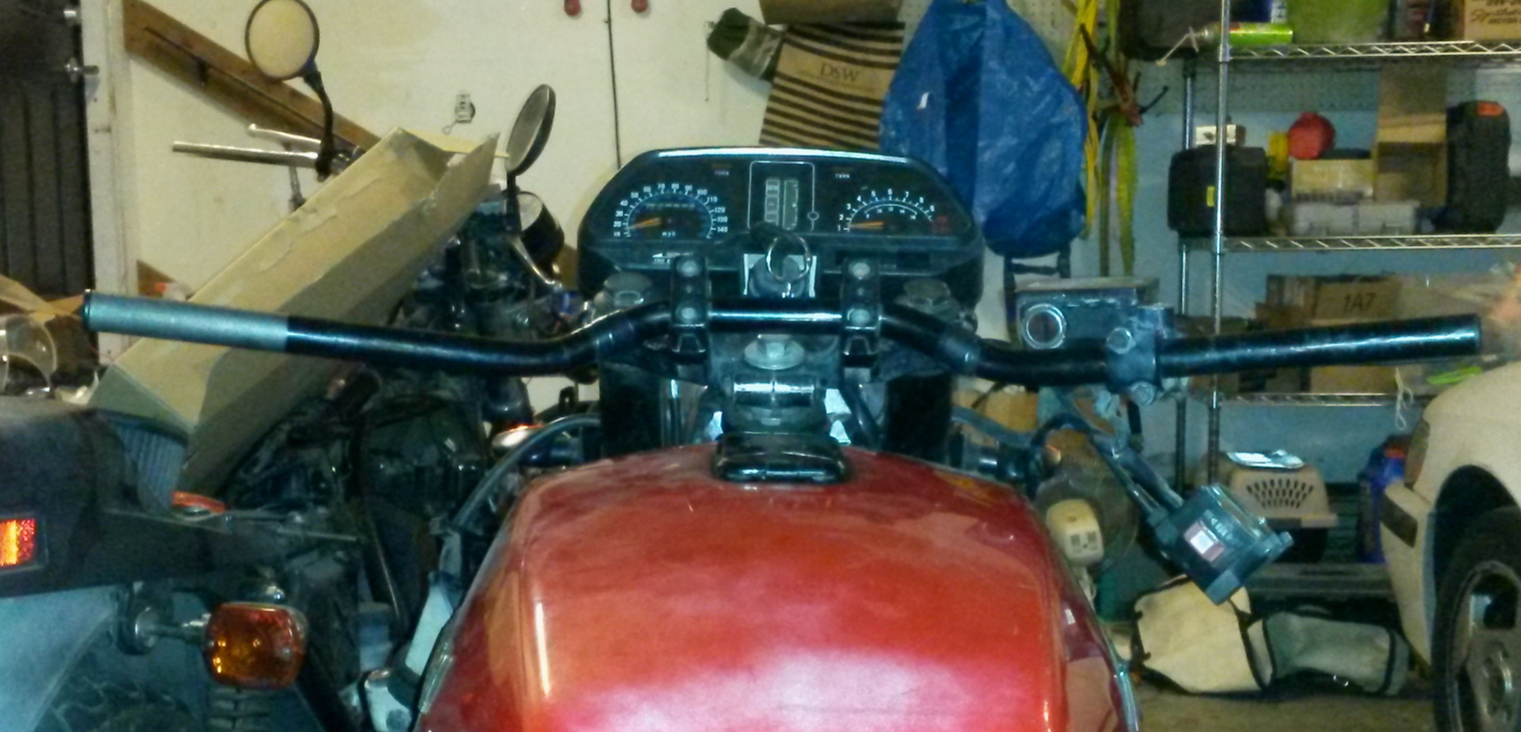

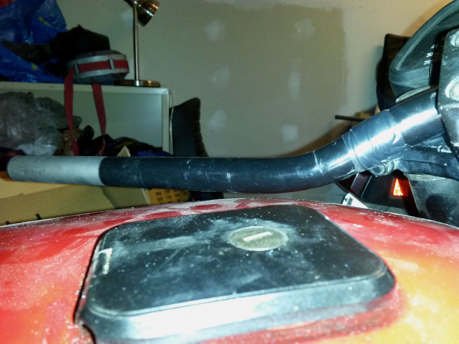

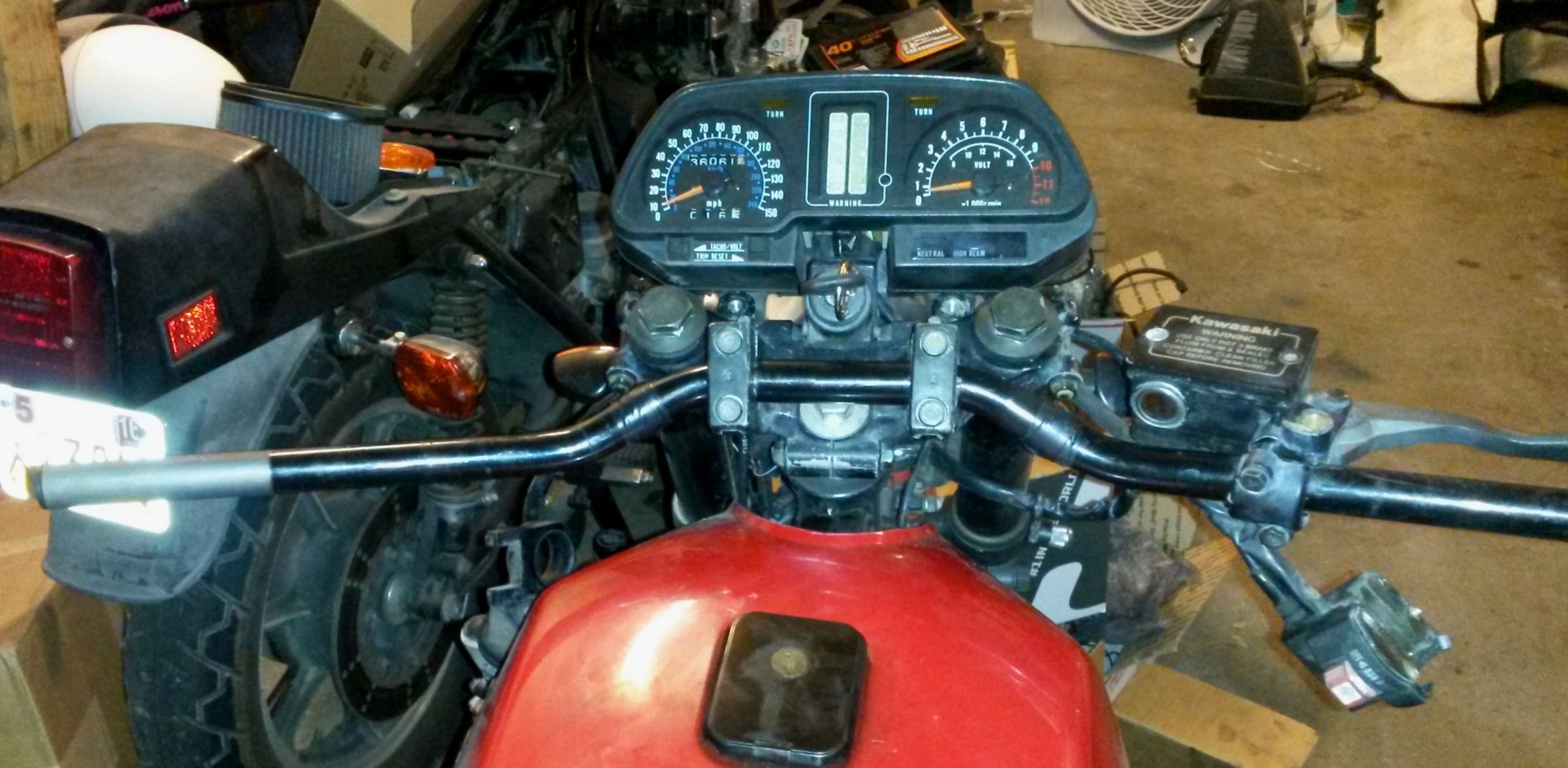

OK, I have a little bit of progress. I swapped out the triple clamps. I put the super bike bars on which dropped the grips about 2 in. That felt pretty good but still felt a little high. I then flipped them over and that felt awesome! The problem is that with the switch gear and grips on they hit the tank before the triples hit the stops. It looks like it will have to be the drag bars then. The drag bars are back ordered and I'm not sure how long it will take before they come in, I guess I'll have to wait.
One thing I did do was mount my instrument cluster to the bottom of the triple clamp instead of the top which dropped it down about 1/2". Oddly the mounting point on the GPz clamp was only about half as thick and it wouldn't have been as low if I'd done the same on them.
Here's some pics anyways. You can see how little clearance the bars have on the last pic.
