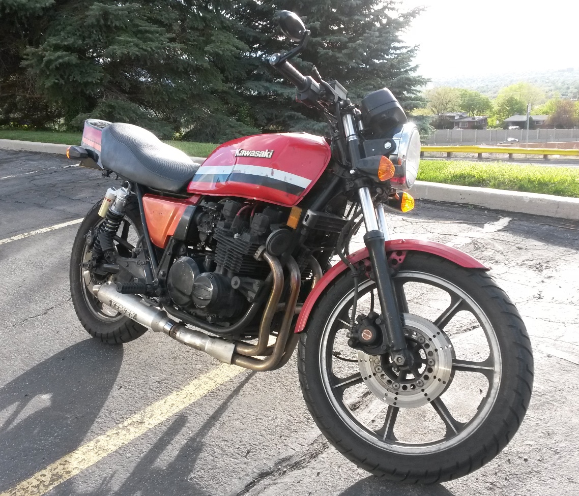

I just took her for a spin with my "new" ZRX shocks.
Rides great. I also got involved in an airbox discussion and ended up modifying the filter cap which works very nice I'm going to have to make some adjustments but i like the way its running.

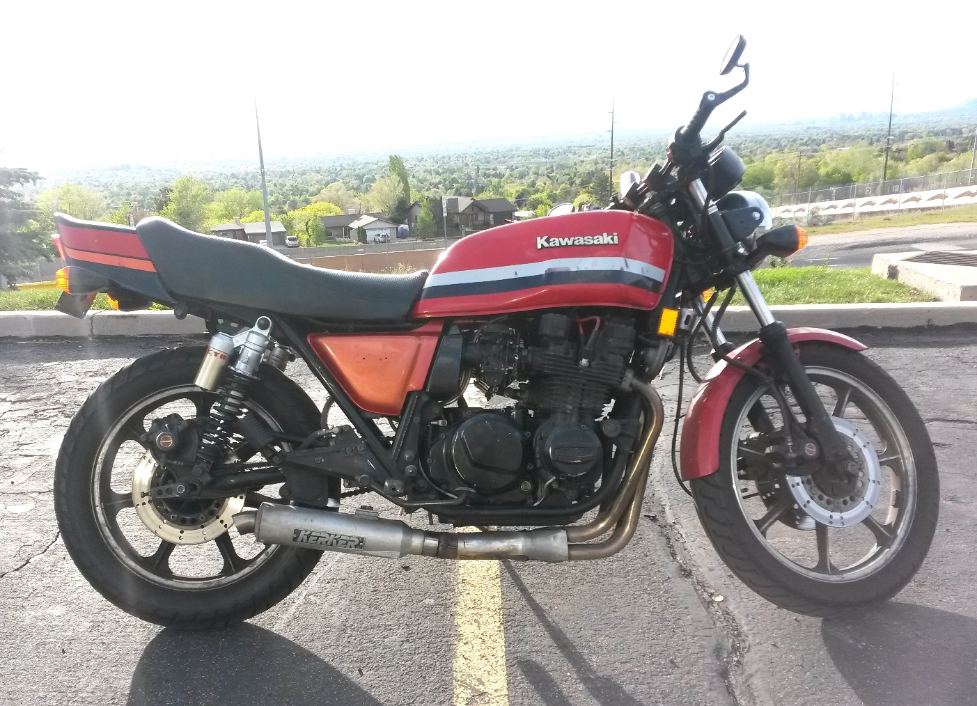

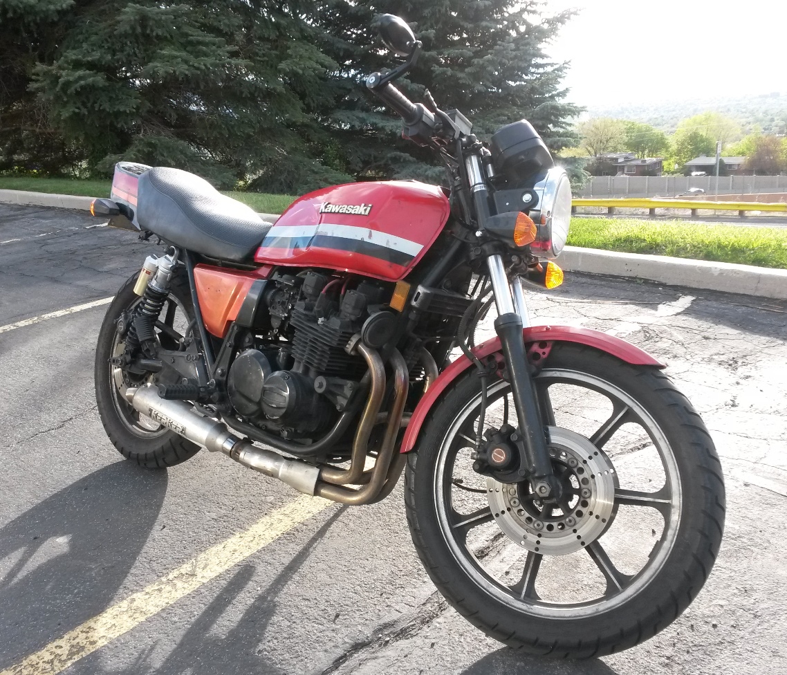

No work done on it lately unless you count the new rear tire and I haven't had quite a year yet. I'm just enjoying it right now.
Here's my favorite pic of it so far.

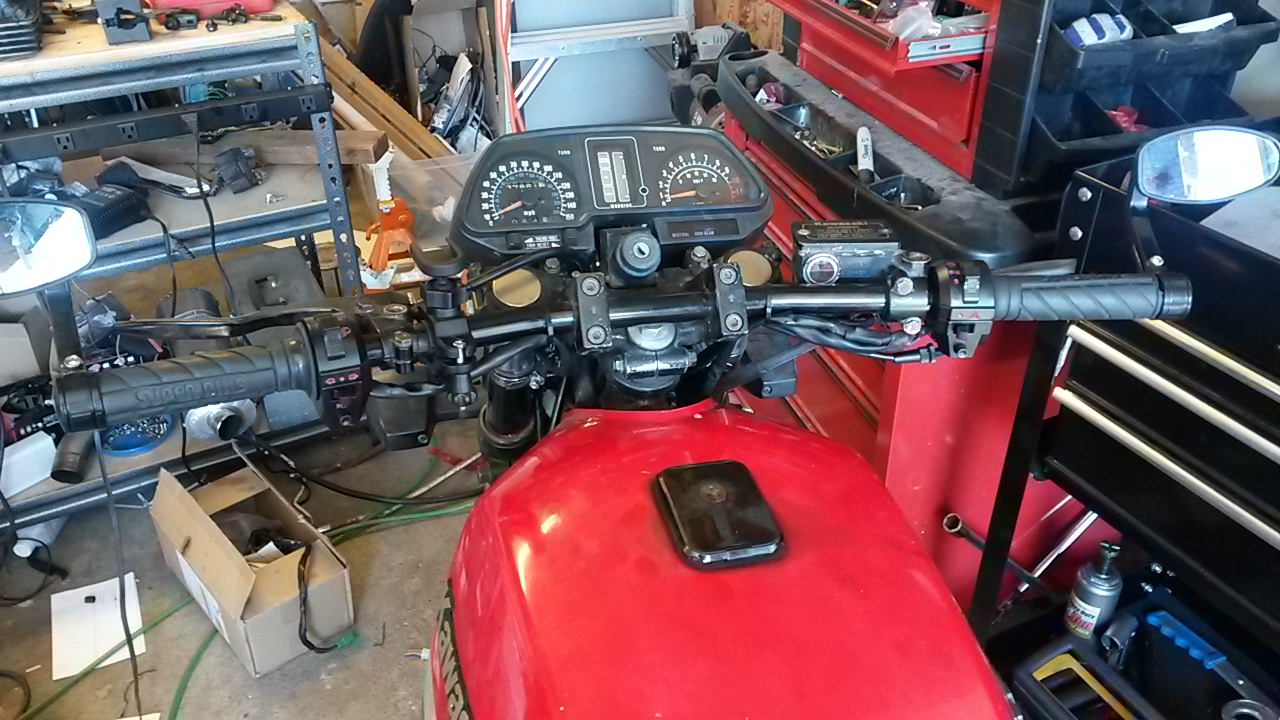

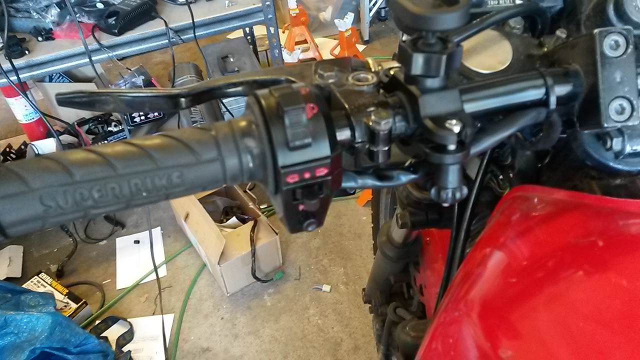

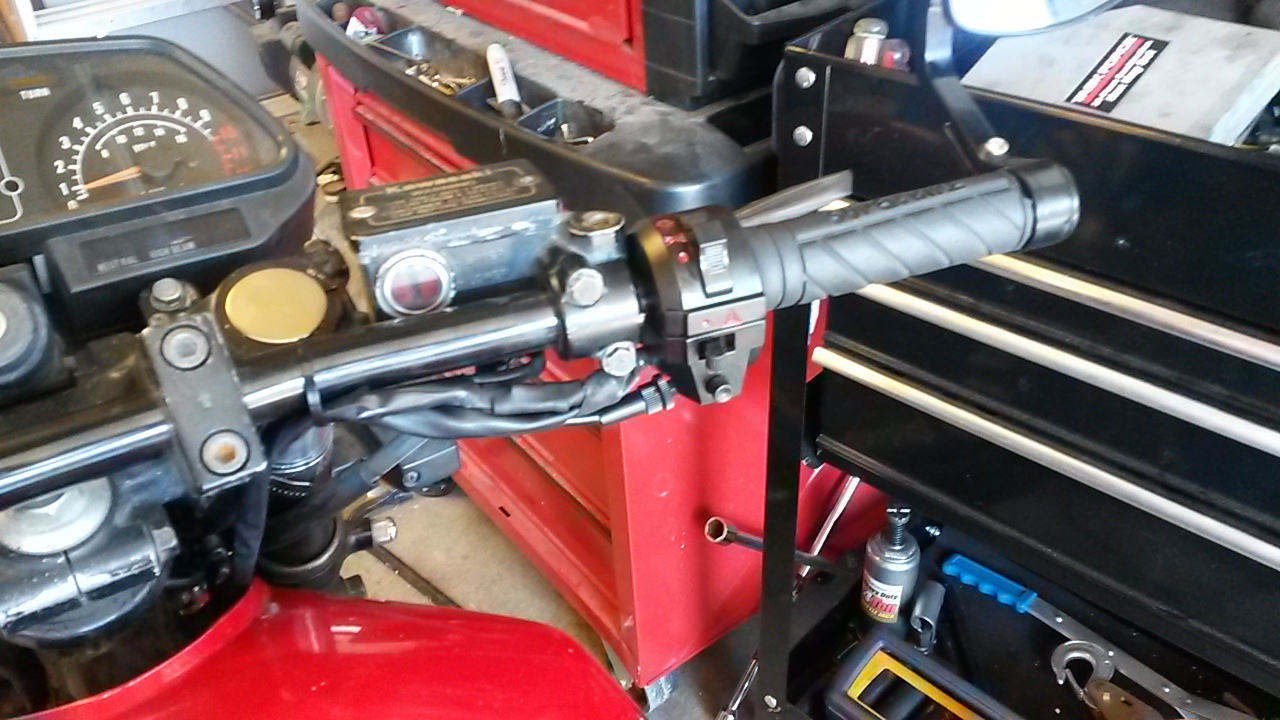

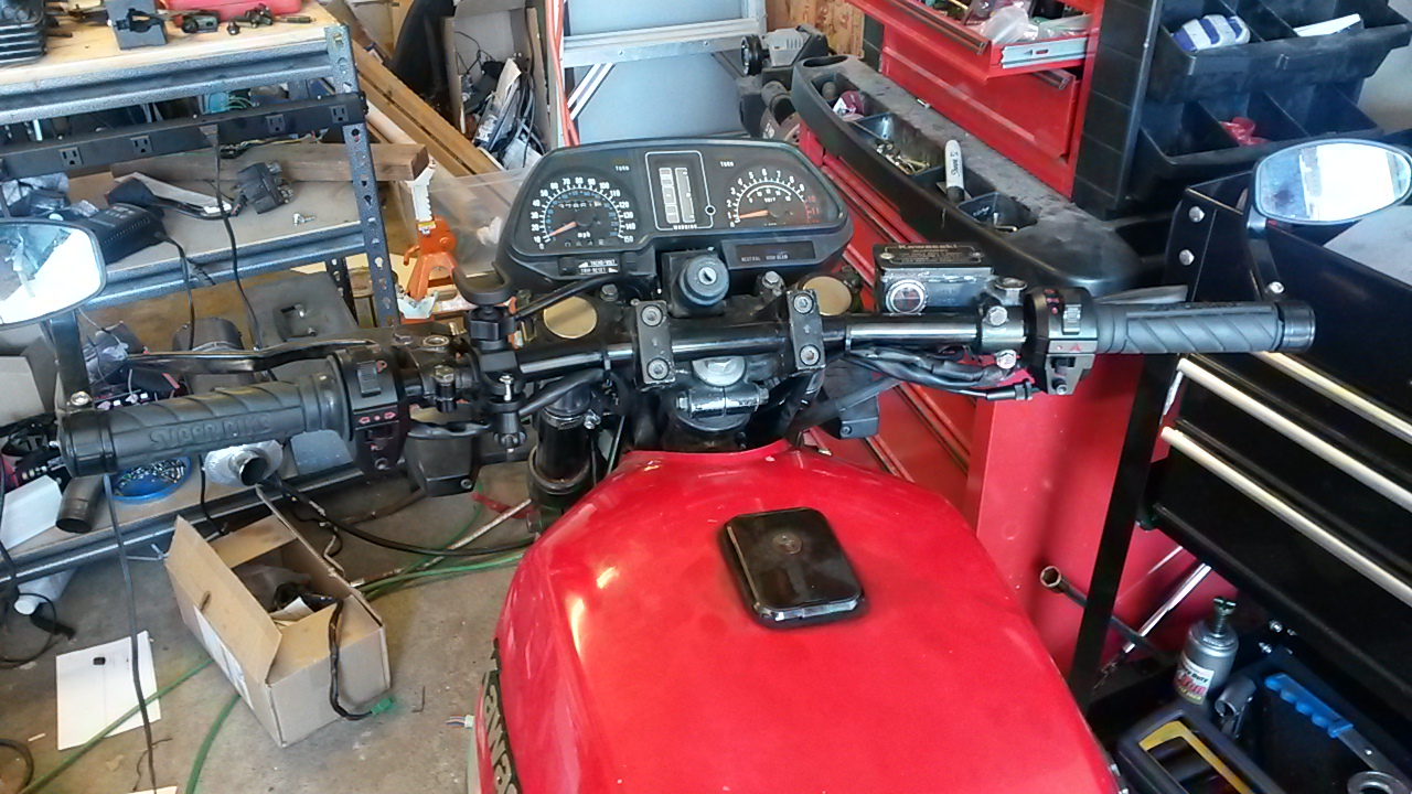

I found myself kind of homebound this weekend so I put the new bar switches on. I can actually turn my bike again!
It would have been nice if I had some sort of wiring diagram but I managed. Now I have to find a new throttle cable. It's set up for the regular threaded tube end which the GPz doesn't have. There was too much tension ton the cable and it was holding the throttle open. I trimmed the plastic end a little to remove the tension but now it's just a bit slack.
Maybe for a KZ650 from a few years earlier?
