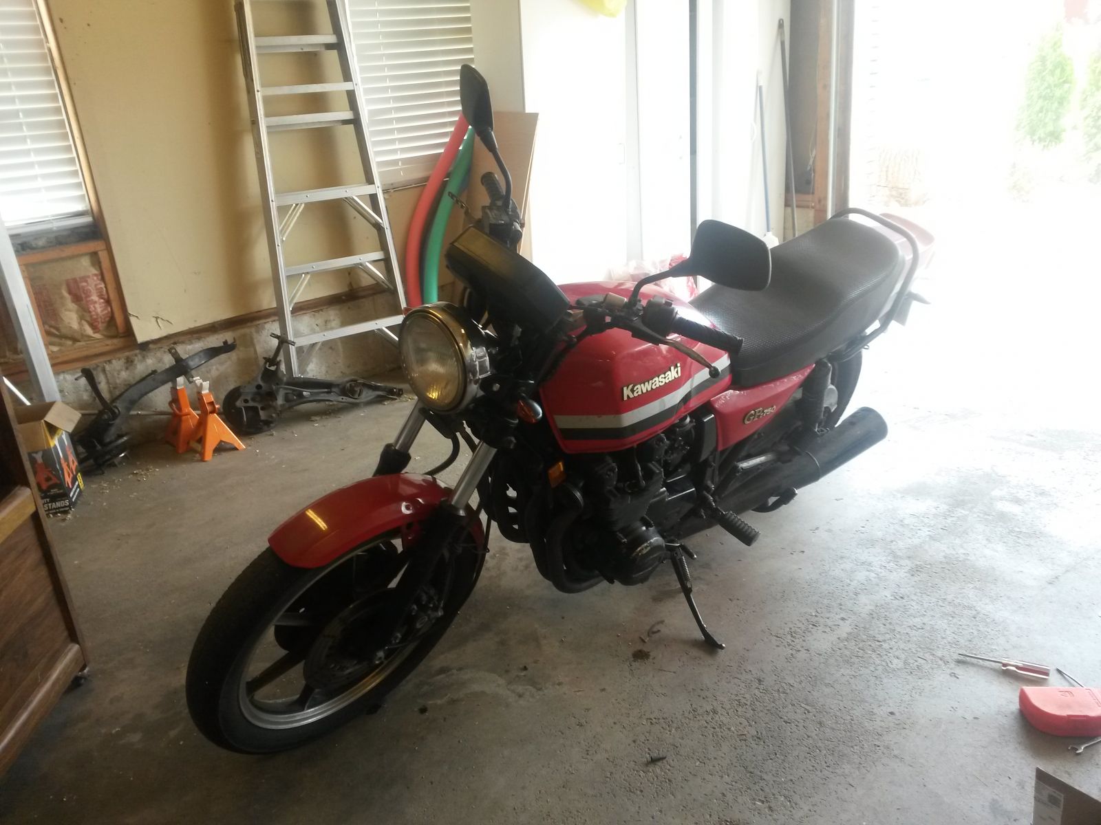

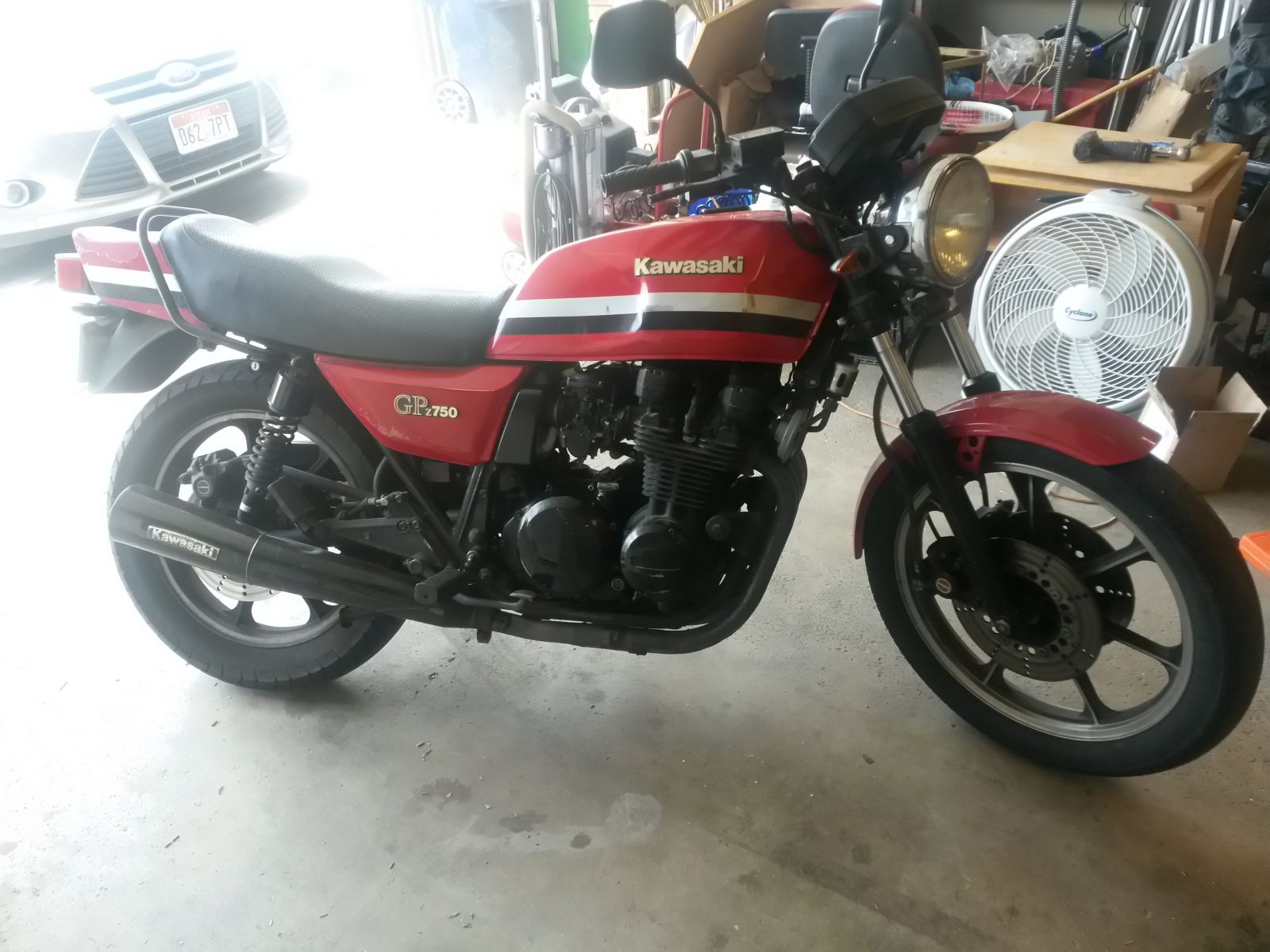

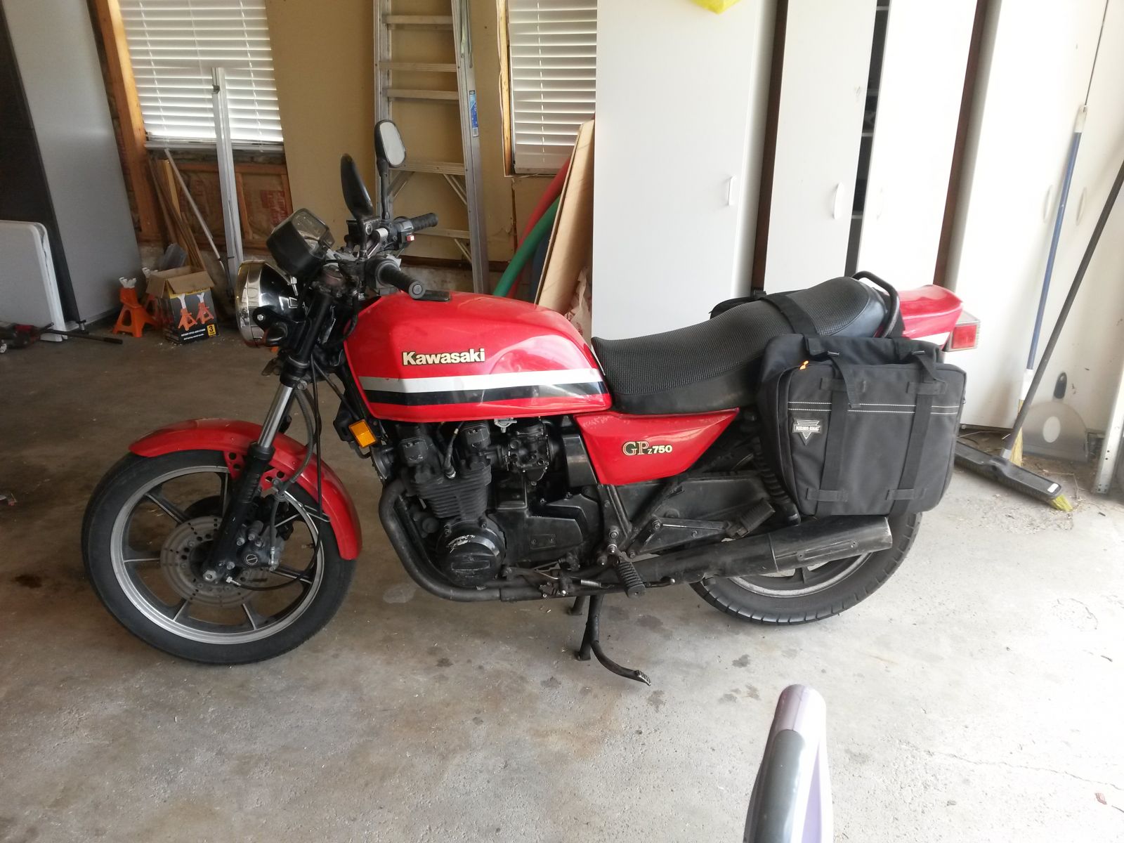

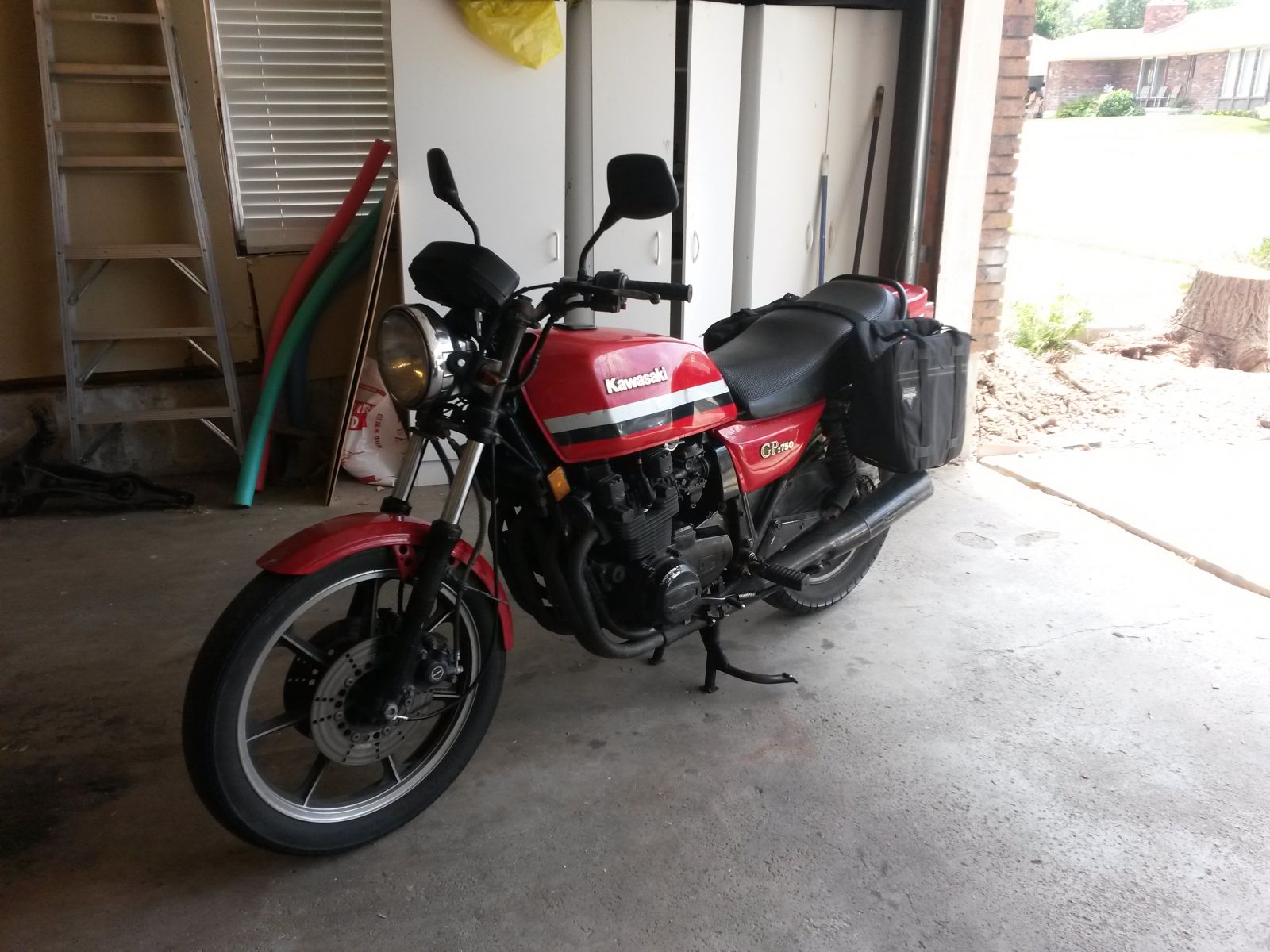

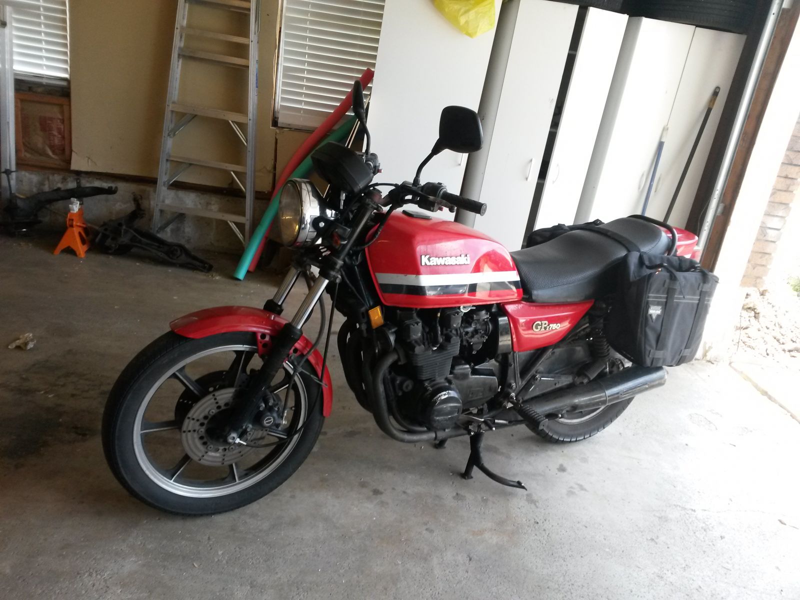

I took it for a 9 mi spin, runs pretty damn good. It started right up, I have to get used to playing with chokes again. A few issues which are fairly minor. The gas gauge sender looks like it's on the fritz, probably the float. The clutch cable needs replacing the clutch doesn't catch until it's almost completely out and the adjustment is at max. Finally, looks like I have a small oil leak coming from somewhere, I put it on the side stand when i got back and there was a small puddle under the alternator cover when i came back out to the garage. I might also need a battery but that's not a surprise either.
Here's some pics. Sorry about the glare on some of them.
With $40 eBay saddle bags
