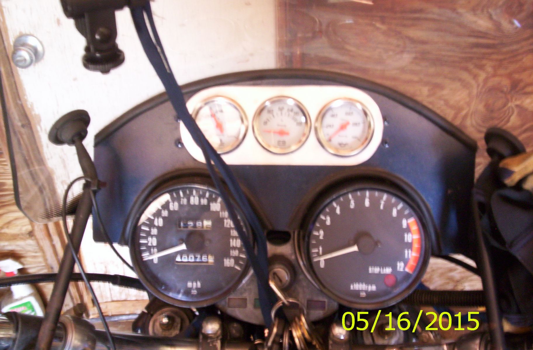

Thanks, I think I'll stick with the stock assy for now. My speedo was toast so I found a another cluster on eBay. It's a GT750 cluster which looks identical to the one I have.
While surfing around for parts i saw somewhere that they had sprocket sets that increased both sprockets by one tooth increments. I'm guess that if you up both sprockets it will mitigate the loss of low end grunt while still helping cruise efficiency
I went out earlier to check the charging system but couldn't get it started. Not surprising since the previous owner said he could only get it started cold by by pushing it. Ain't nobody got time for that! I checked it for spark and i assume its got compression, I don't think its getting fuel. So I just pulled the battery, put it on the charger then pulled the carbs. I just ordered a set of rebuild kits and I'll check the valve clearances before they get here. after I get it started again I'll check the timing and so on.
BTW, I checked the petcock function by using a vacuum pump and it worked just fine.
