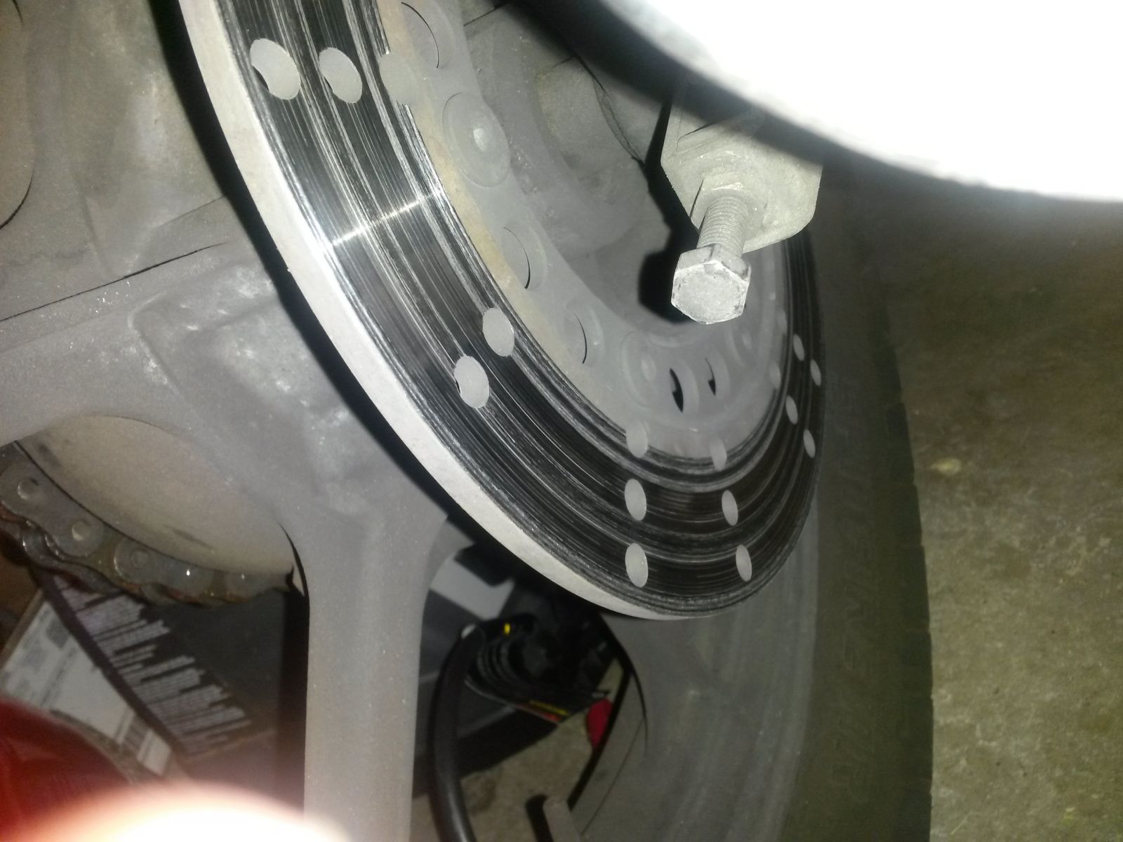

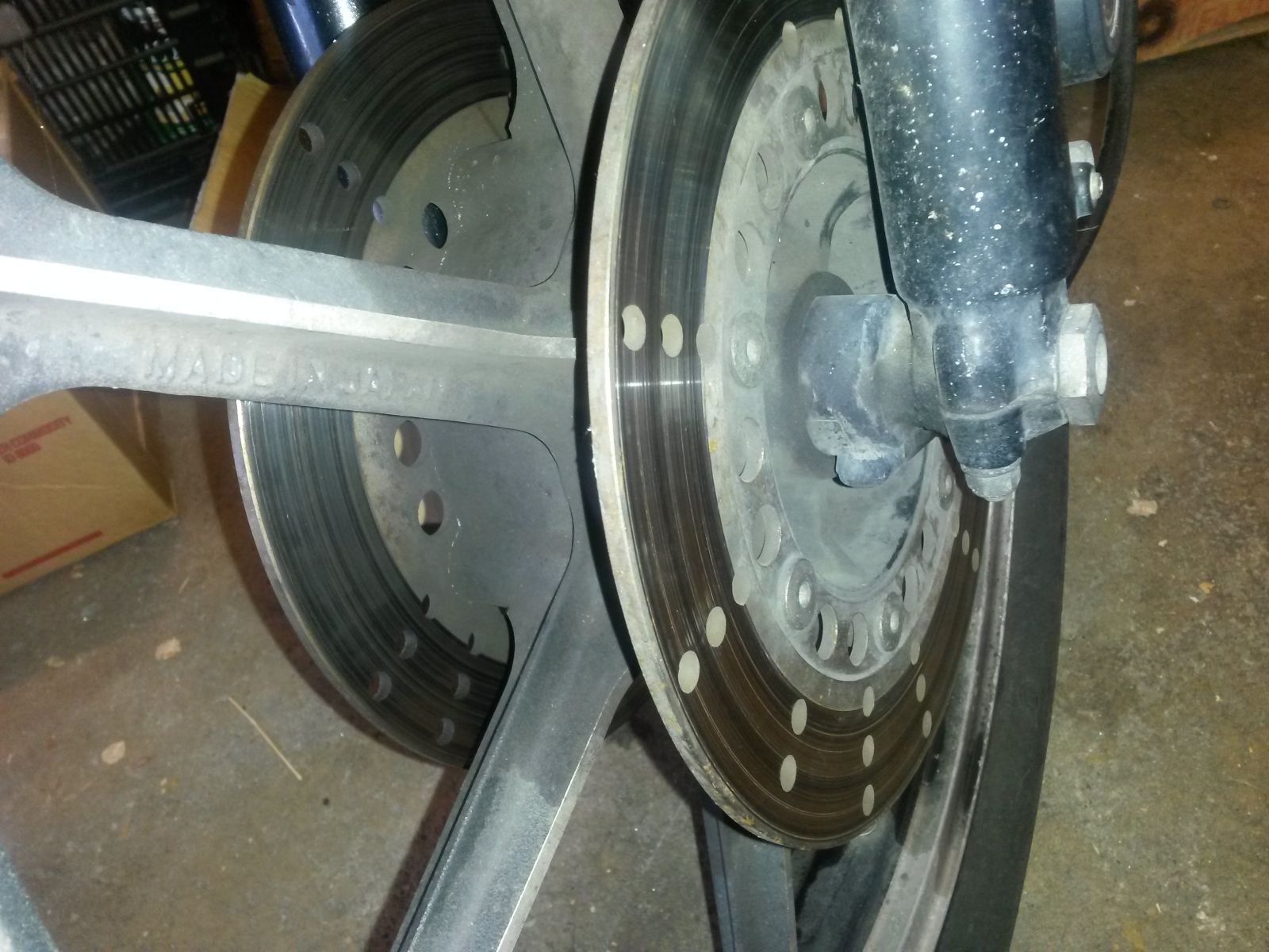

I got my drilled rotors on eBay. They were fairly cheap. Pics of you rotors?

I got these pics and on further examination they actually don't look too bad, I used some calipers and they are about 0.198" I wish I had some blade mics for getting a better measurement of the low spots.

0.198 works out to be 5.04mm. Minimum thickness is 4.5mm. They look good. You might put in new pads and run them like they are.

11 Jul 2015 11:43Sounds good, I'll throw new pads on when i get the tires replaced....swest wrote: 0.198 works out to be 5.04mm. Minimum thickness is 4.5mm. They look good. You might put in new pads and run them like they are.
