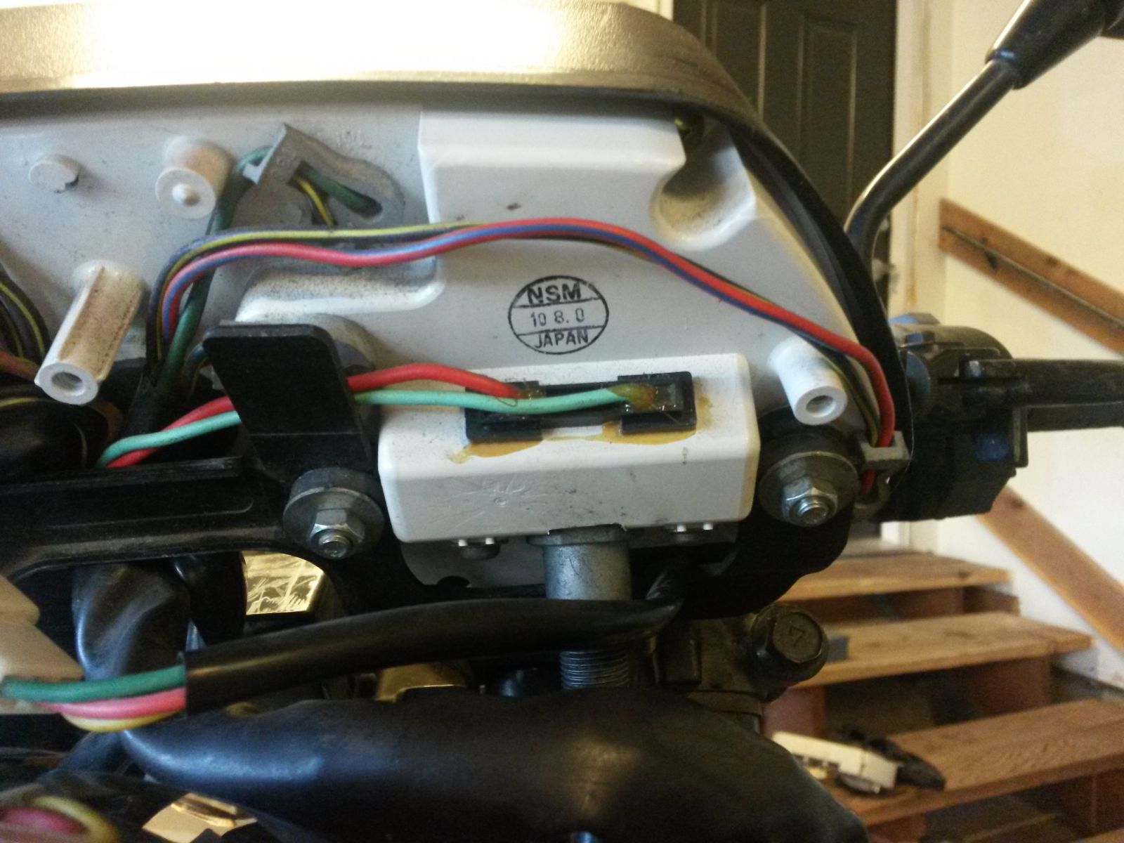

I got the replacement instrument cluster mounted, You were right Tyrell, the LCD group has a male connector while my old one has a female. Rather than cut and splice I just transplanted the original It seems to be working great! There is another difference, There are a red and green wire coming out the back of the cluster just above the speedometer stem and in and out with the rest of the loom that my original cluster didn't have. The red wire must go out in the block connector but the the green one comes out in an adjacent female bullet connector with no corresponding connector in the main loom. Anyone know what this is and if I need it? Is it going to cause me any problems?

Self cancelling turn signal distance sender.

Cool, won't be worrying about that then.
