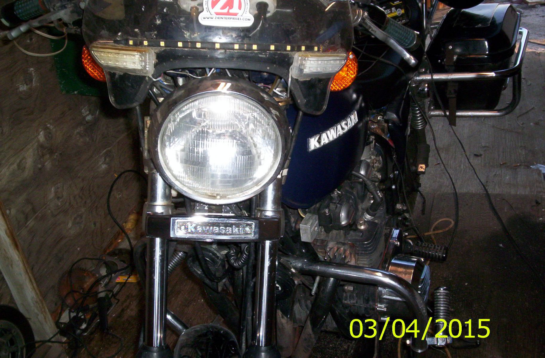

Bat wing tool? That's just for shim over lifters. If you have shim under you have to take out the cams. I'd do it one by one being sure you don't change the timing. I don't have a stock head light on mine ether. I have a Vetter head light bucket. Mine was damaged in the wreck and I had one on hand so I used it. It has a ring that spins with a ratchet lock so it's easy to change bulbs. The bolts are tight enough to keep it from moving. My bike is not bone stock. I changed things to my taste. I like it and that is all that matters to me. I like the new one you have. BIG improvement. The 80's was a lame decade in my opinion. Everything was squared. :sick:

11 Jul 2015 08:39 - 11 Jul 2015 08:39Crap! I was doing some research and thought I saw others using this thing on KZs, My bad! It hasn't shipped yet so I'll see if I can cancel the order.swest wrote: Bat wing tool? That's just for shim over lifters. If you have shim under you have to take out the cams. I'd do it one by one being sure you don't change the timing.
I agree, I;m going to do this to my taste as I go and as budget allows, If I had gotten it with the stock fairing I might not worry about it but since I didn't that thing needed to go. The brackets have an offset to them bias upwards. I figured if I flipped them over and swapped them around I would look more aggressive. One of the mounts is slightly bent and they kind of rotate inwards to hold the Spectre bucket so I'm thinking I'll have to bend them a little bit , make some spacers. or go with some aftermarket mounts. I think I'll need to build a shroud around the instrument cluster so it doesn't look so ugly once the headlight is dropped.swest wrote: I don't have a stock head light on mine ether. I have a Vetter head light bucket. Mine was damaged in the wreck and I had one on hand so I used it. It has a ring that spins with a ratchet lock so it's easy to change bulbs. The bolts are tight enough to keep it from moving. My bike is not bone stock. I changed things to my taste. I like it and that is all that matters to me. I like the new one you have. BIG improvement. The 80's was a lame decade in my opinion. Everything was squared. :sick:

I had a Suzuki quarter faring on my bike in the wreck. It turned into shards of plastic that literally cut me a new A hole. I still have scars on my arms from it. The quarter faring looked great and I could tuck in behind it at high speeds. It looked like the one meant for your bike just for a round head light. I wanted a dash for it too but didn't get around to it. I don't ride like I use to so the one I have suits me just fine.

11 Jul 2015 09:06 - 11 Jul 2015 09:22swest wrote: I had a Suzuki quarter faring on my bike in the wreck. It turned into shards of plastic that literally cut me a new A hole. I still have scars on my arms from it. The quarter faring looked great and I could tuck in behind it at high speeds. It looked like the one meant for your bike just for a round head light. I wanted a dash for it too but didn't get around to it. I don't ride like I use to so the one I have suits me just fine.
More pics, need more pics.
Yeah I was thinking about a round light fairing but I like to ride naked anyway, Not much has changed from the last pic yet except I moved it to the opposite corner of the garage.
