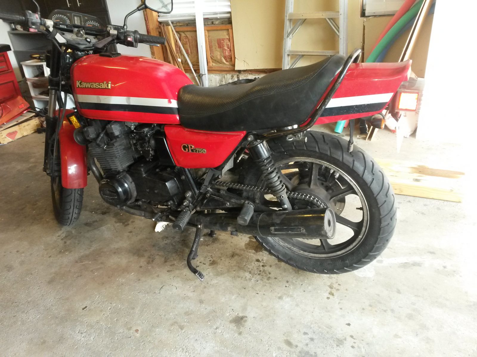

I Also took the rear fender and chain guard off. They were both trashed so does that make it a cafe racer now?

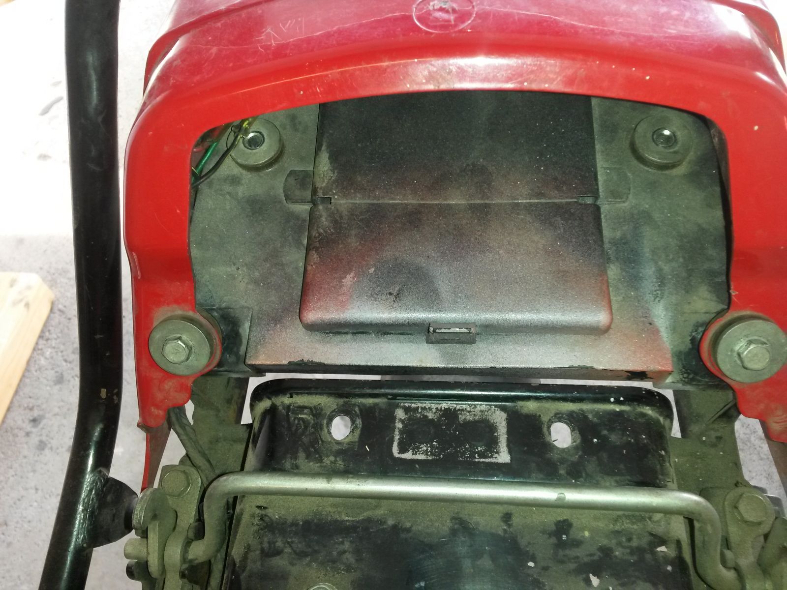

I stuck a tail piece accessory shelf from KZ750E under the tail piece it doesn't fit perfect but dang near and I'll fit it permanently later on.

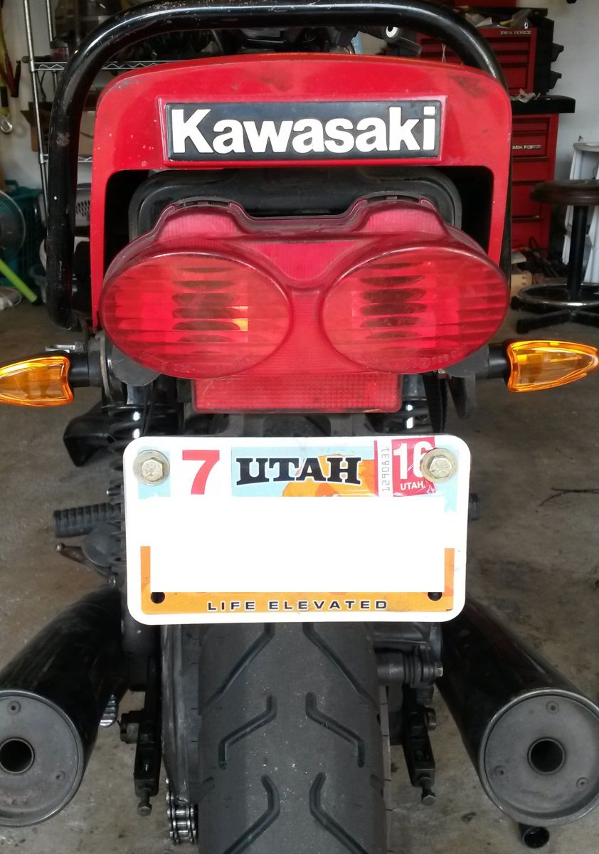

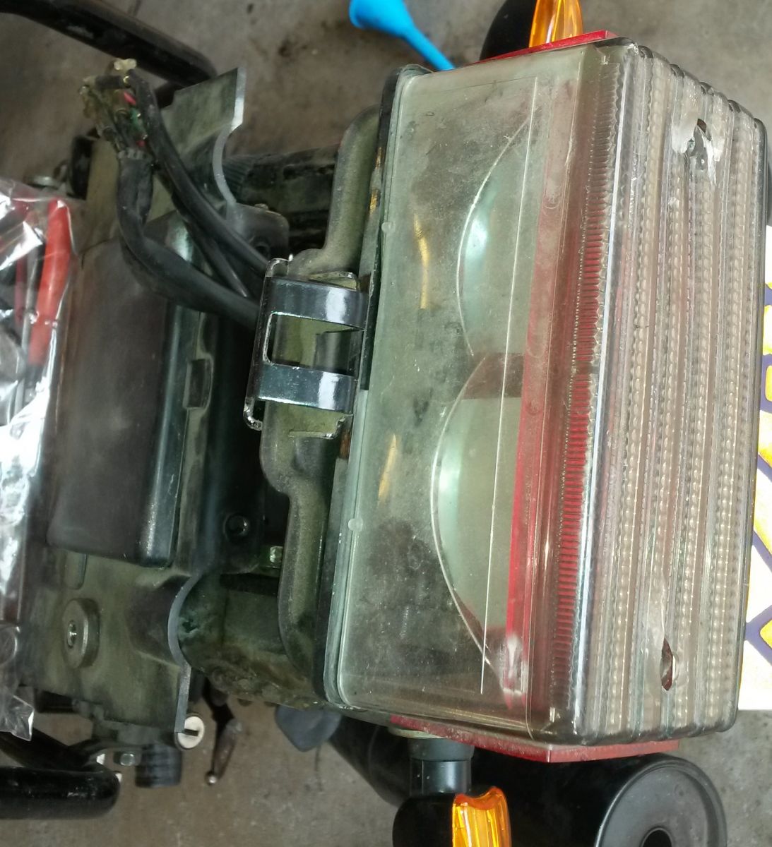

I also realized my tail light was on upside down. Flipped that over, During he process I mocked up the ZR750 tail light I bought for it. I'm going to have to build a custom mount for it, It sticks out too far behind the tail piece, so does the stock one for that matter.

It's running pretty much perfect. I've gone through 2 tanks of gas getting practically 50 mpg. I'm not going to do one more mechanical thing to it unless I have issues.
The only things I want to do are put bar end mirrors on and cleanup the tail piece compartment set up.
