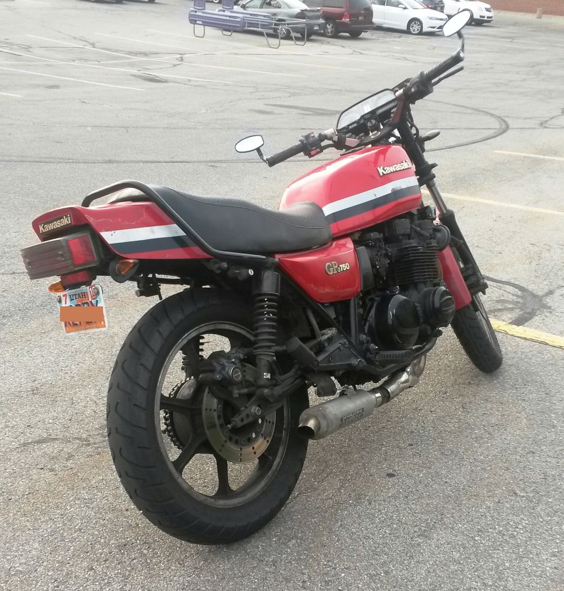

Not much done on it this week except I got the exhaust hung. You can see the latest shot of it
here
I've been spending the last week just trying to figure out in my head where my power issue is.

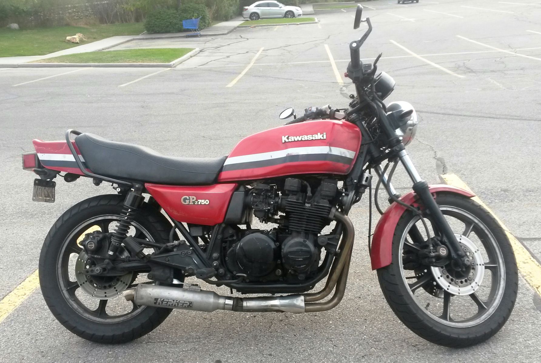

Re: 82 GPz750 keepin' it real,.. for now
12 Sep 2015 15:11 - 12 Sep 2015 15:12
I put the GPz back together and it sounds real nice, I broke #1 plug cap so looks like I'll be getting another set of wires. It's running really strong right now but I did find that #3 carb boot is leaking on the carb side even after tightening the clamp as hard as possible. I checked the timing and it's dead on. I think I'll still end up ordering a dyna 2-2 ignition just to be safe. I ran it around the block and it just wants to fly. It's hotter than hell today and it didn't stumble once.
I am getting some popping on decelerating and down shift. I'll adjust the carbs tomorrow, if that doesn't help i guess I'll re-jet which will give me a chance to see why that carb boot isn't seating.
15 Sep 2015 04:01
I'd try to tuck the tailpipe in a bit higher and more angled, also that rear hanger isn't up to the job. Getting there though.
