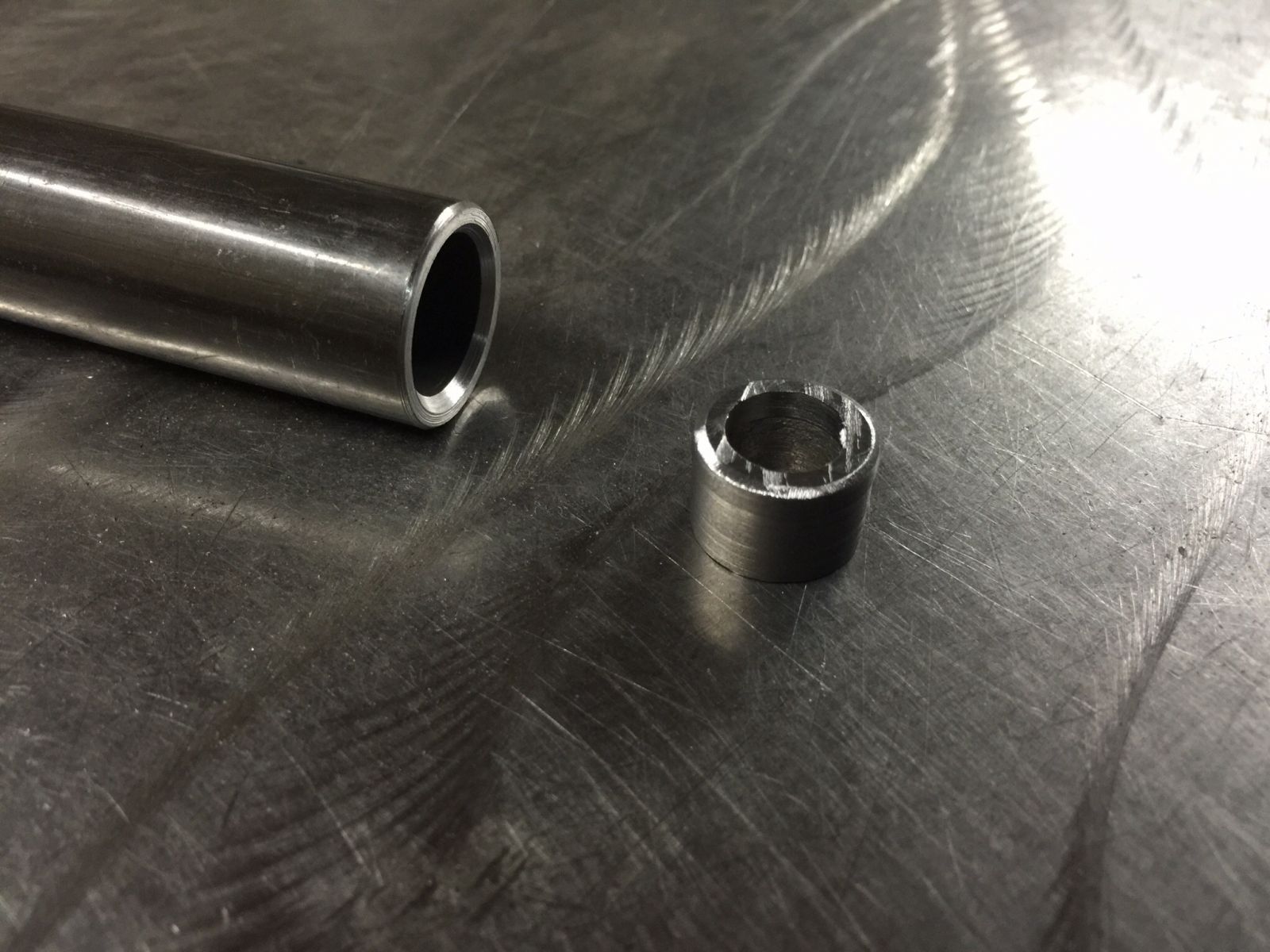

Great looking fabrication, and I like what you're doing with the bike, but that rear brake is worrisome.
Whereas the rear brake stay originally had a good lever advantage over the rear wheel torque by virtue of the fact that the stay was holding the hub from several inches away from the center, the new setup gives the wheel a huge lever advantage over the spacer-attached stay. Secondly, the original stay was a bar under tension which is very strong, whereas the new stay is a bar under torsional stress, which is far more prone to a tearing action where the majority of the load is at one point, initially (much like the difference in tearing a piece of paper versus pulling the paper apart all at once).
I've seen a few ill-engineered stays result in the hub rotating and wrapping the brake rod around the hub during a hard stop.

03 May 2015 15:54 - 03 May 2015 15:58loudhvx wrote: Great looking fabrication, and I like what you're doing with the bike, but that rear brake is worrisome.
Thanks loud for the compliment
I do appreciate your concern though loud none the less. I know problems will surely present themselves once the bike gets on the road, I'm hoping and trying to keep it from being fabrication problems caused by me. Chances are, the way I have the rear brake set up now, it may change? I didn't cut the tabs for the original setup just in case.

I'm going to chime in here.
2 reasons you should reconcider.
1) Unsprung weight, how much do the fabricated mounts and axle spacer
along with filler rod used weigh compared to the stock spacer and rod?
This issue is minor and the lesser of the two.
2) The more serious problem will be when the axle bolt is tightened down.
The friction will prohibit the rotation of that axle spacer. This will affect both
directions of travel. Both in the application and the release of the brake.

Well I hope you don't get hurt, but here are some numbers to consider:
Lets assume the OD of the tire is 22 inches, the stock brake stay location is 4 inches from the center of the axle, and the fabricated stay is 1/2 inch from the center of the axle.
The wheel/tire has a 11:4 lever advantage over the stock brake stay. That is 2.75.
The wheel/tire has a 11:1/2 lever advantage over the fabricated stay. That is 22.0
That is an 8 fold increase in the torque the fabricated brake stay has to handle. But that is only part of the story.
Look at how much aluminum is used on the hub to reinforce the bolt that holds the brake stay. That ensures the stock brake stay merely has to handle the torque in a purely tensile load.
The fabricated arm is designed such that the arm has to handle the torsional load with no reinforcement. This means the backside of the arm is holding all of the tension while the front is acting like a fulcrum. This is another lever trying to tear the arm from the base metal.
The way it is set up is analogous to having a wheel with one single large spoke to handle the torque.
Can you at least box section the two arms together so they help each other?
Imagine if you made the spacer about 8 inches in diameter, then simply bolted the spacer to the hub and swingarm at the same points you have them now, then milled away all of the excess metal. You would end up with a pie-shaped wedge attached to the spacer. Then you would hollow it out. This way the torque is transferred from hub to frame somewhat directly.
You could put the attachment point on the underside of the swingarm so the box section could be more like a rectangle than a wedge.
As a side note, will the brake lever still work even though it will be pulled the opposite direction? Some levers can go either way. Or were you going to make the brake rod a push-type instead of pull?

Something that just occurred to me is, when the bike is being ridden, power is applied to the wheel, stress is present at the end of the swing arm at the axle. A certain amount of flex can occur. If braking is applied, the end of the arm is under more stress. With the break arm fastened close the pivot and frame, the braking force is transferred there, not to the end of the arm.
If that makes any sense.

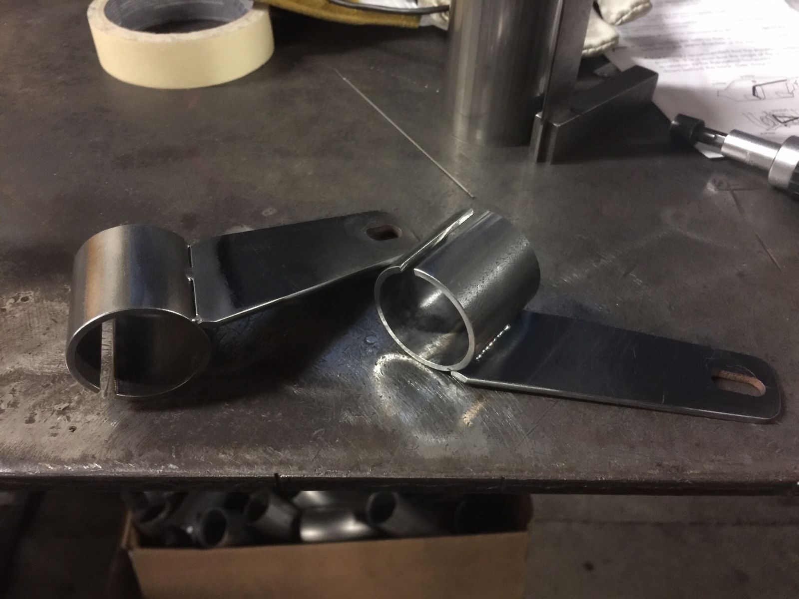

Months ago, I did an impulse buy on some forktube headlight mounts.
eBay forktube headlight mounts..
Didn't like how much it made the light stick out so made me some new ones.
sucked in a lot more..

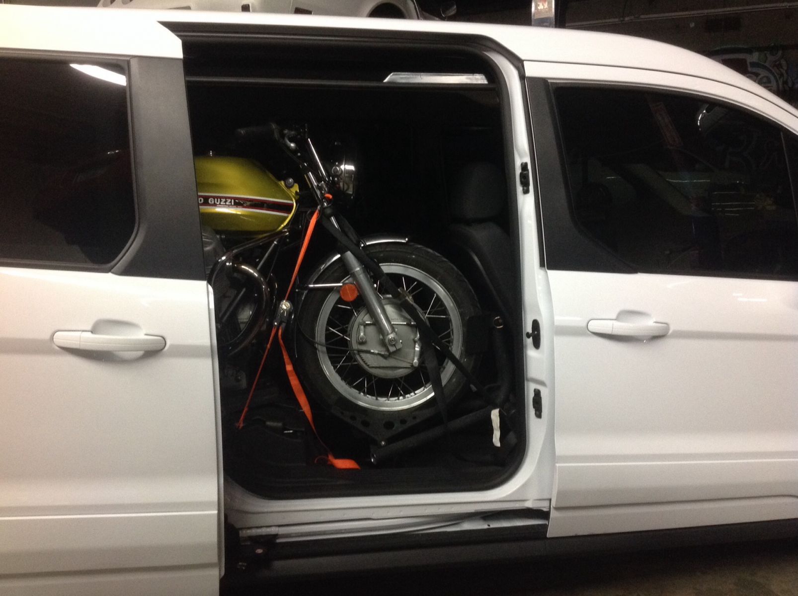

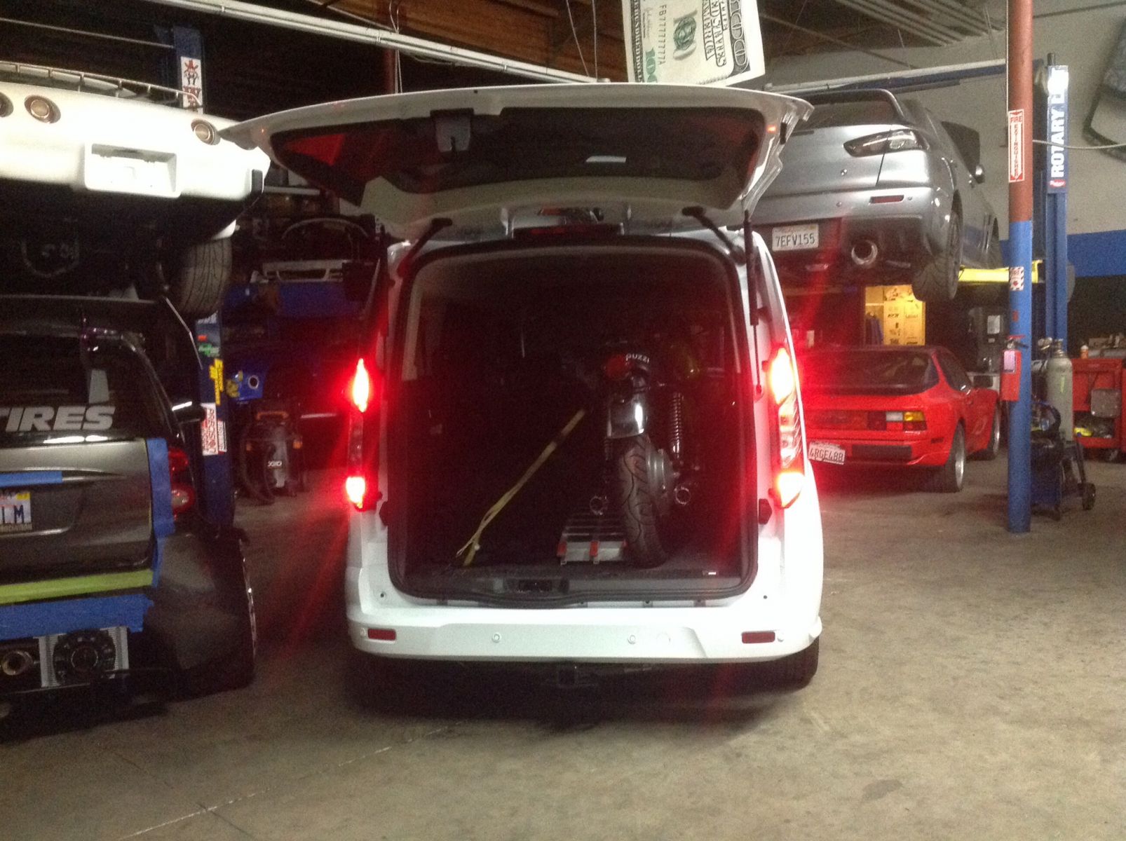

That's really all the progress I've made the past month. Aside from finishing/shortening the harness since I removed the self canceling signal unit and the new electrical box/tray under the (soon to be where my ass is suppose to) seat. Secured the throttle and clutch cable to the frame. New chain put on, Got the clip-ons under the top triple (which reminds me of something). Still a bunch of work left. I still need to get some rearsets on. The stock ignition switch is buggin me how it sticks up so high now? A concern a few post ago of how I have the rear brake setup is still not set in stone. That will be addressed later on before the bike gets underway. Need to finish a seat and a clever(or not so clever)way to mount it. The tail section, I have to get that mediocre cowl looking thing I got going on, into aluminum or other easy working material after I finalize a shape of it. So far it's just a cover for the battery. So yeah...bunch of work left. I'm looking forward to it also! Now I just have to turn off the nice guy be that asshole when some needs MY help?
Don't know if you can see what's going on here? lol
A guzzi in the back of fords new transit?
remade the tire chock to bolt down..
couldn't say no to this guy since he was the one that gave me the bike in the first place.

I like the headlight mounts. Nice fab as usual. However, I think I'd like to see the headlight a little bit lower if at all possible. I prefer the headlight to flow with the tank profile so the "mass" of the headlight is in line with the "mass" of the tank.
Keep up the good work!
I see what you mean there loud, Didn't really get a good side view for myself and now that you mention it. Thanks?!..lol jk. I can see what's going on and have to agree that it does look outta place. Looked good from the front?

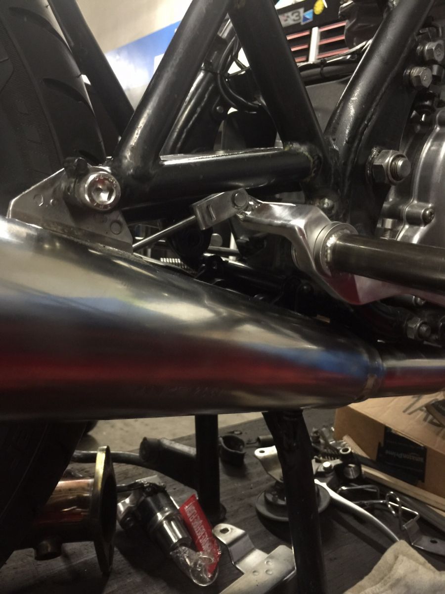

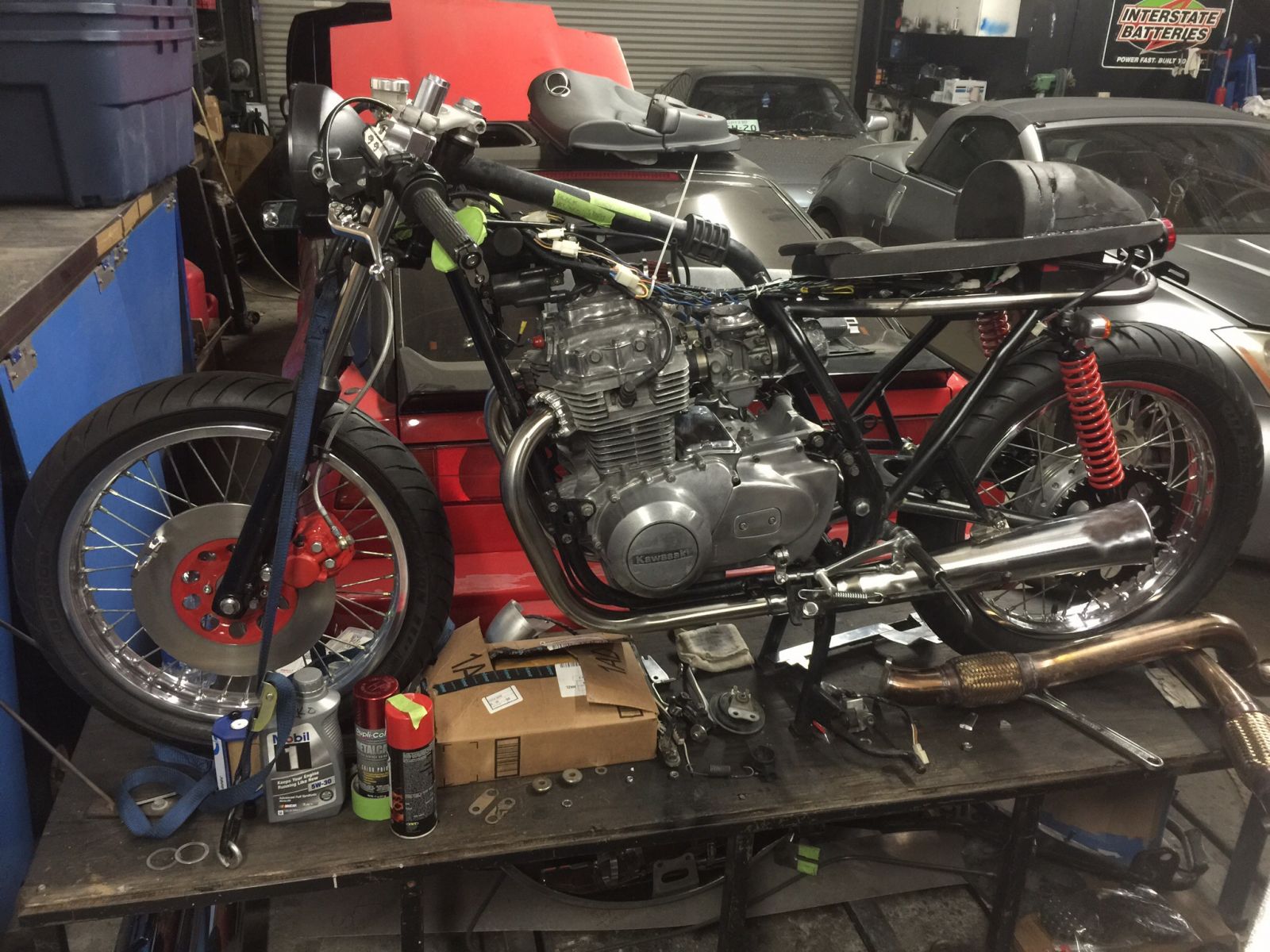

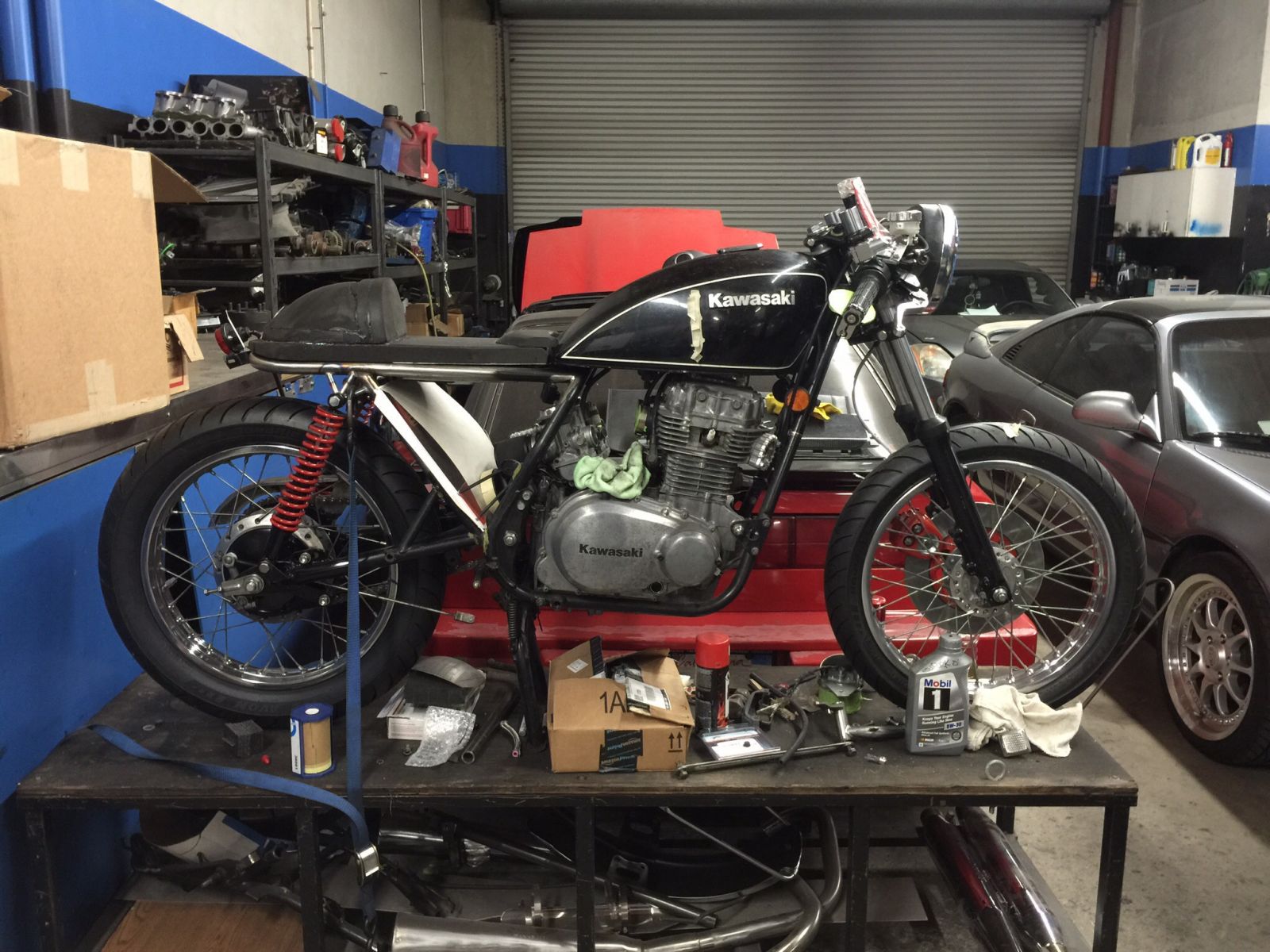

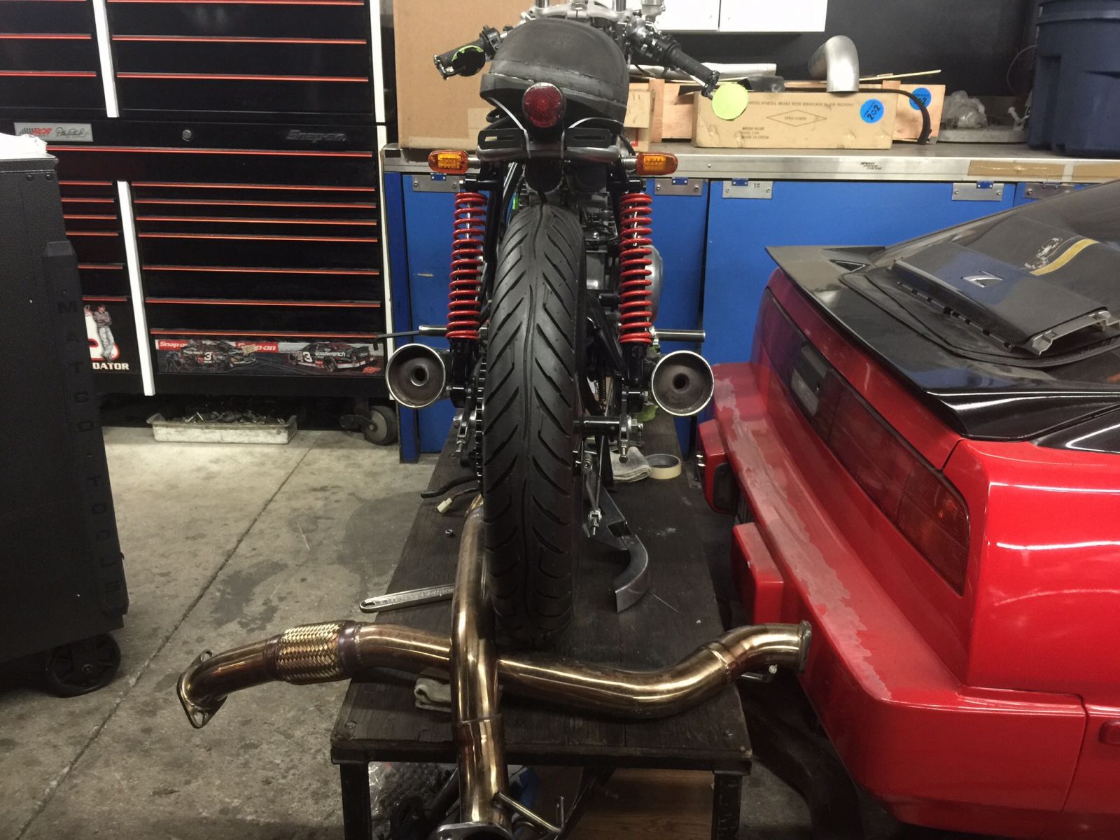

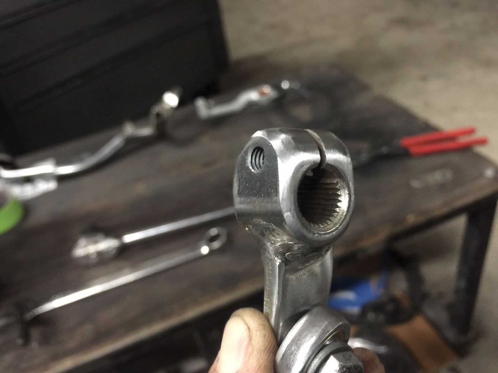

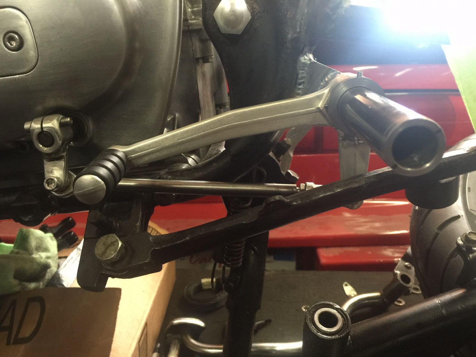

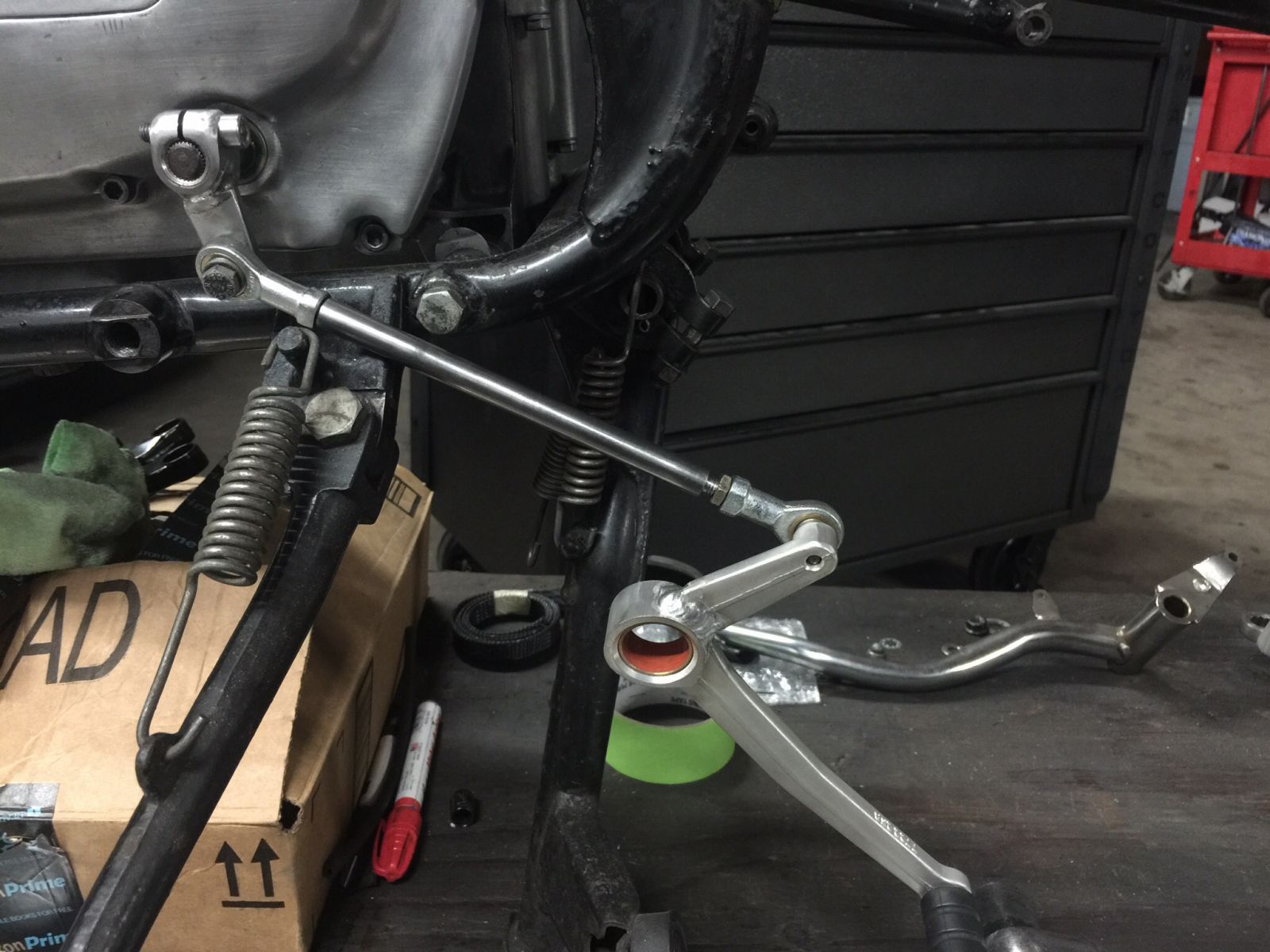

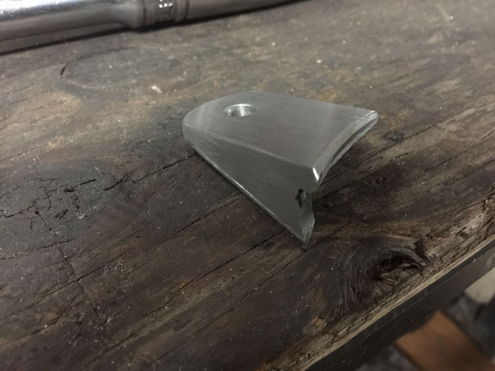

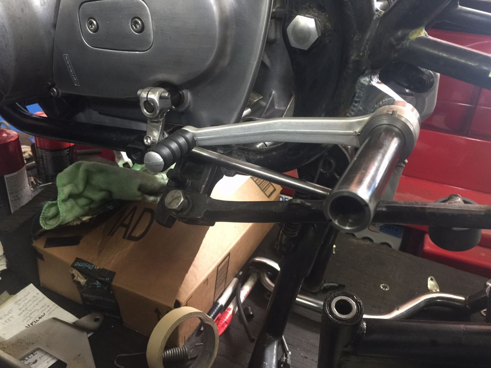

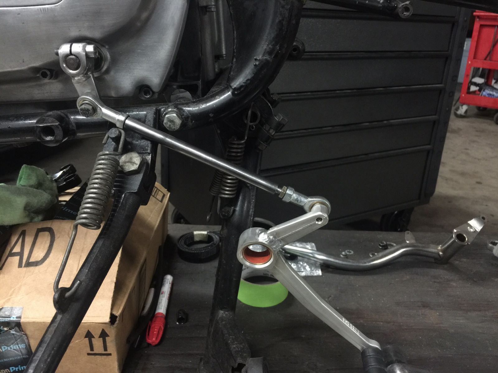

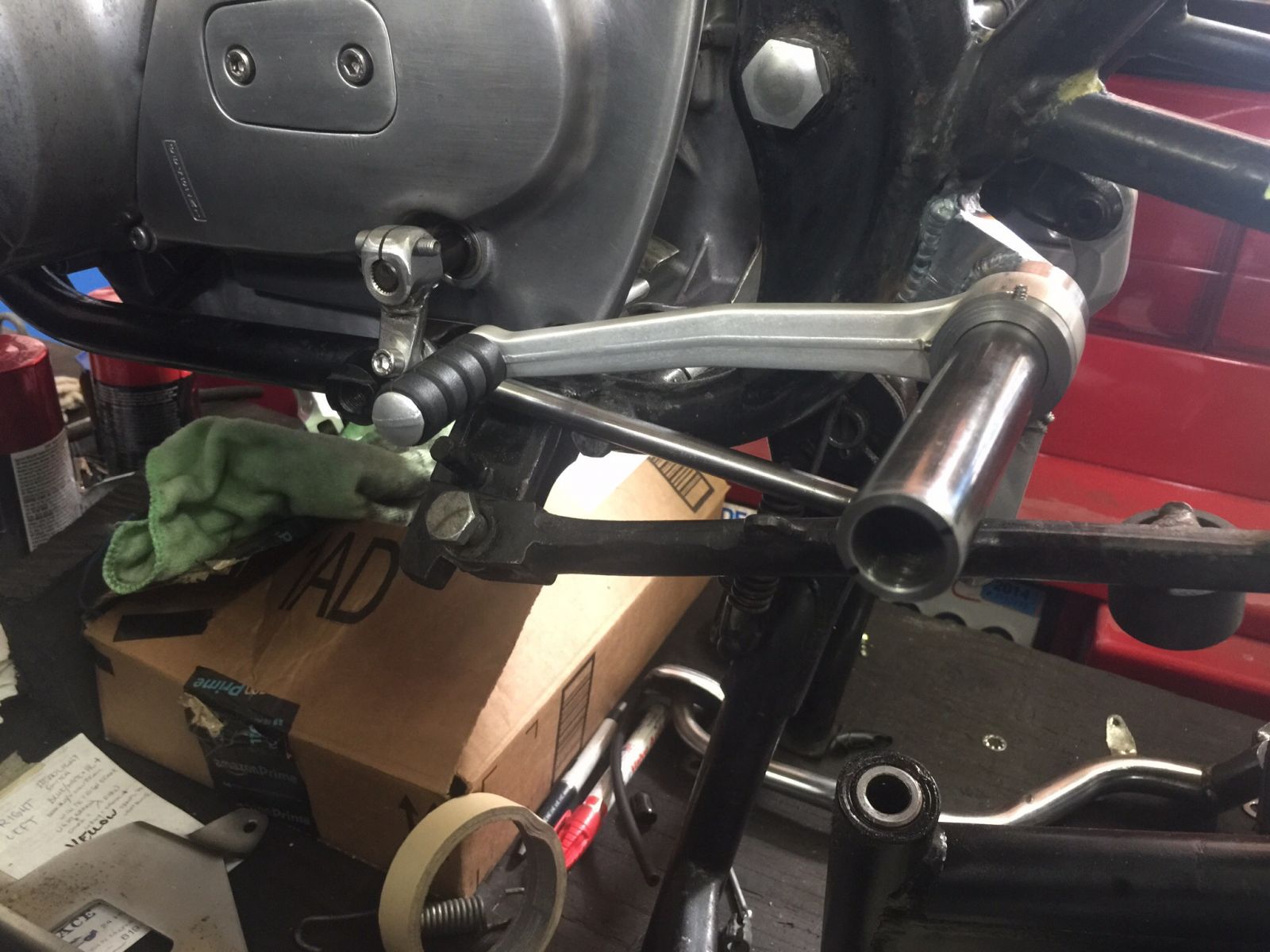

Couldn't find my post for a second there..lol So another update and another question. Got some rearsets in place finally but totally air headed on how much room I was gonna have on the left for the new shift linkage and muffler. Crude pics coming up, I'm gonna have to update them with better ones later on once the bike gets underway.
New rearset shift side..It looks like the side stand is in the way, but I actually have a lot of room for up shifting. If anything, I'll relocate the spring behind the stand.
some random pics of left side progress.

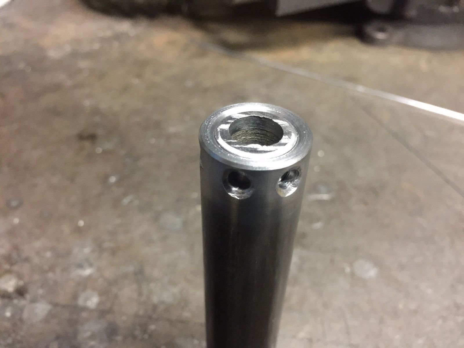

had to machine and weld in a spacer inside my pegs so the m10x1.5 allen has something to tighten on.
Prepped and ready to weld..
The shift linkage and first smell of burning raining brain cells.

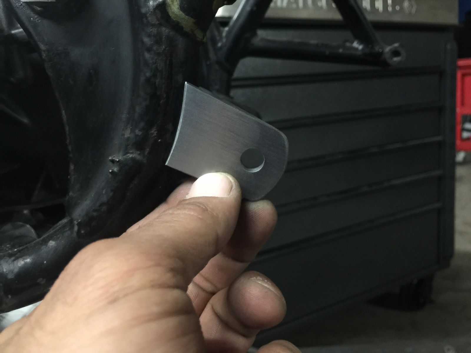

First tab fabbed up to weld in it's new home to support my left footness.
Where its presumably gonna live now.
Original shift lever cut and cleaned up a lot. Seemed so damn bulky? More eye pleasing now. Wish I woulda took a before shot though.

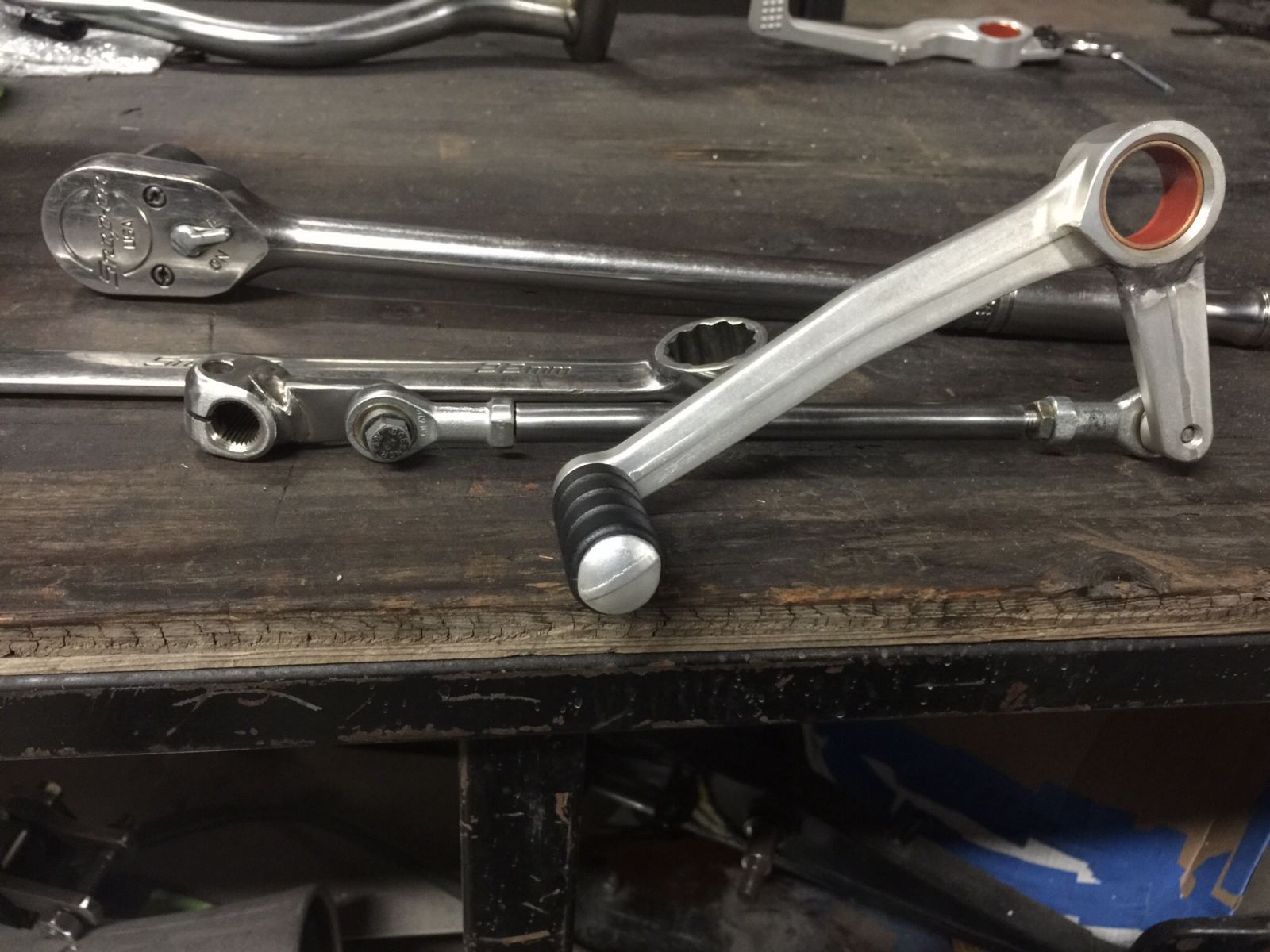

Another shot. 6mm hiems. Even have a left hand thread one on there. Shift lever came off my buddies BMW RR. Had to cut the ear where the hiem goes and re-weld to the bottom.

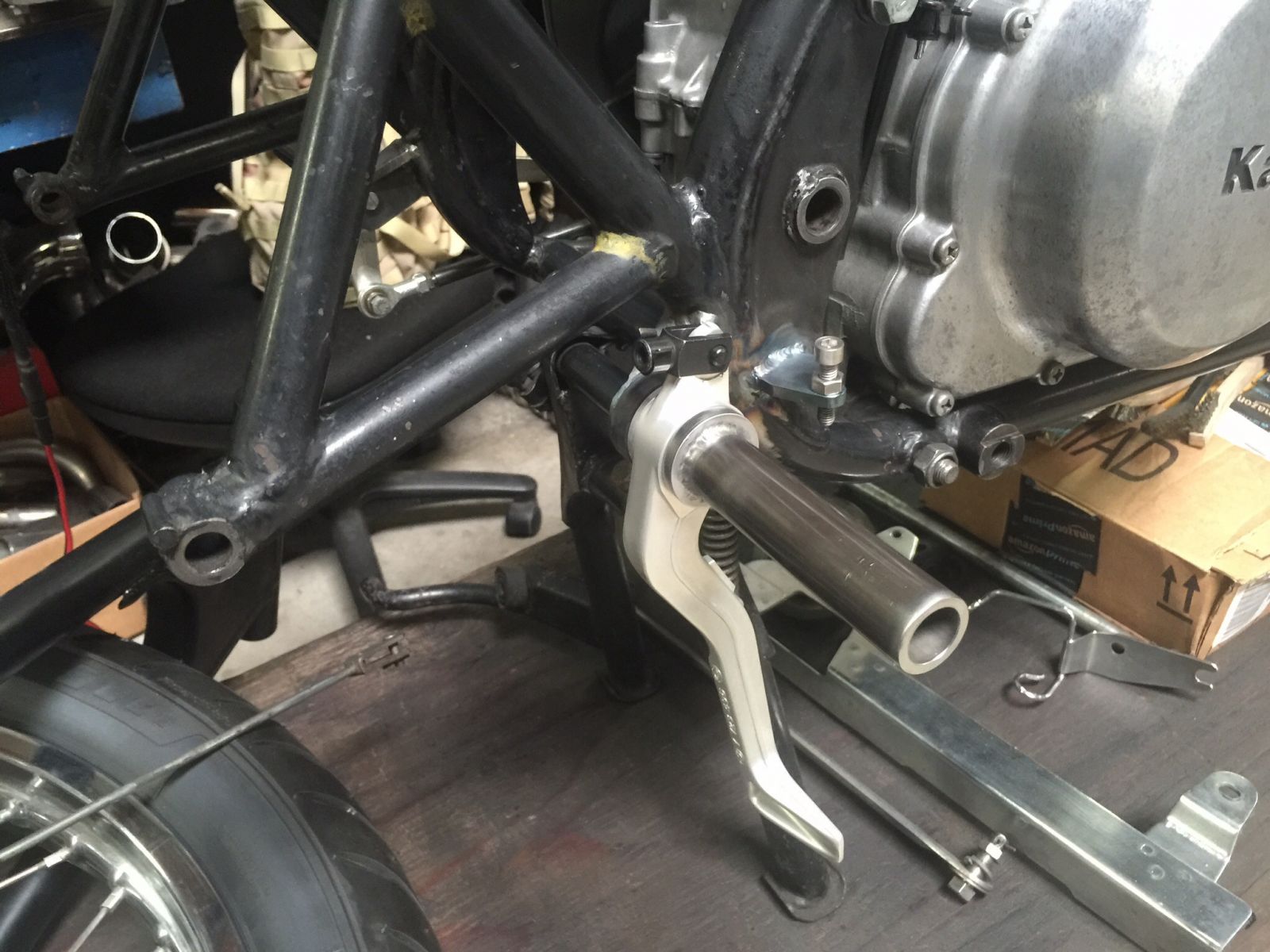

Here's the right side mocked up..
This was gonna strain a little more of my brain cells to attach the pull rod for the brake. But got it sorted! and I thought this side was gonna be the pita..
Driver side with the muffler on..
Yeah that's a total fail shot to even see what my problem is. But hopefully I'll get it sorted outsell this week.

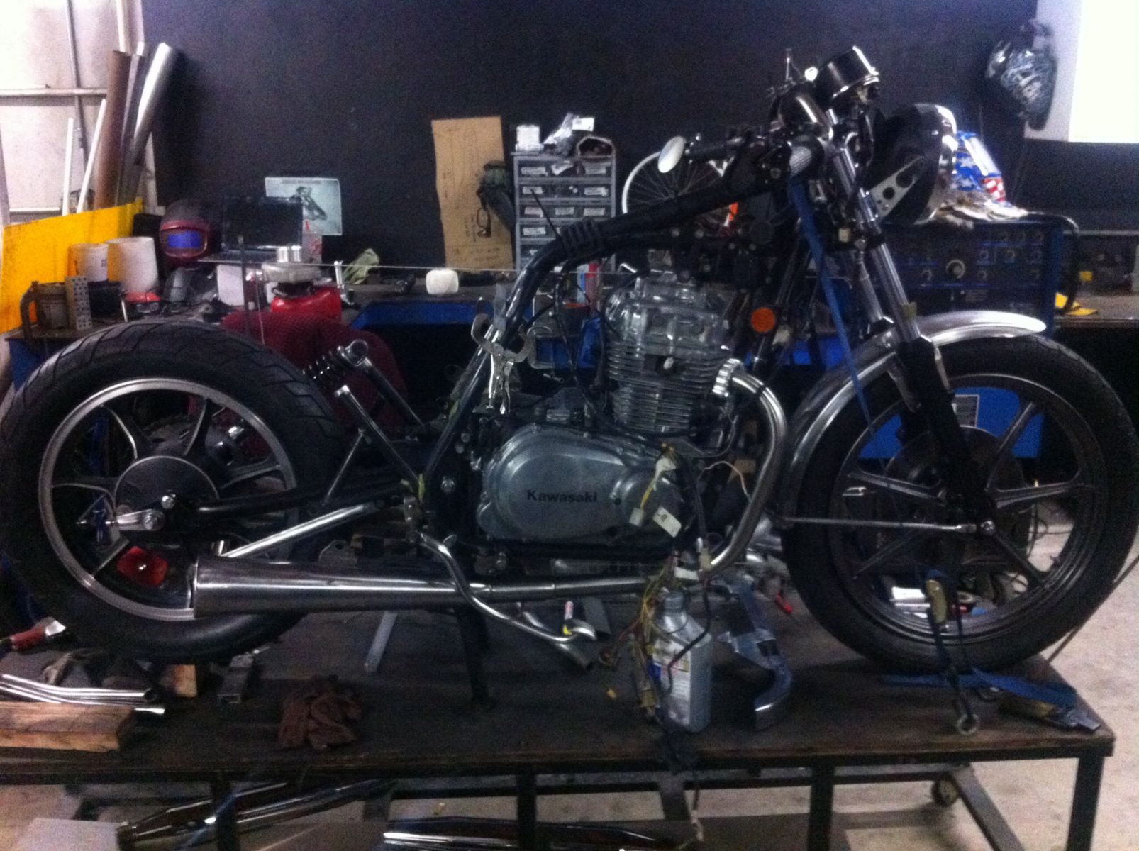

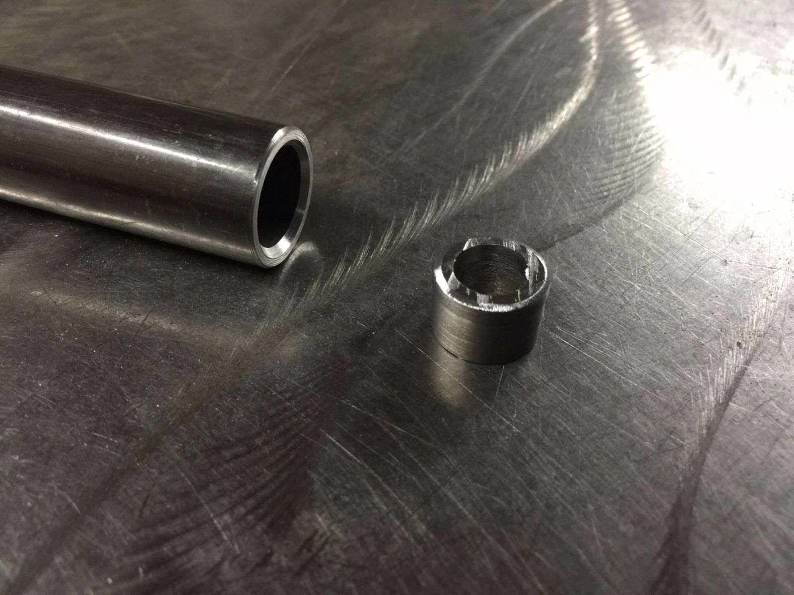

Shot from the back with stock muffs and new sets.
Oh and I took your advice Loud and flipped the ears for the headlight. Thanks for catching that for me. Looks waaaay better! I'll post a pic of that tomorrow, since my idevices are having wifi syncing issues with my photo stream..
