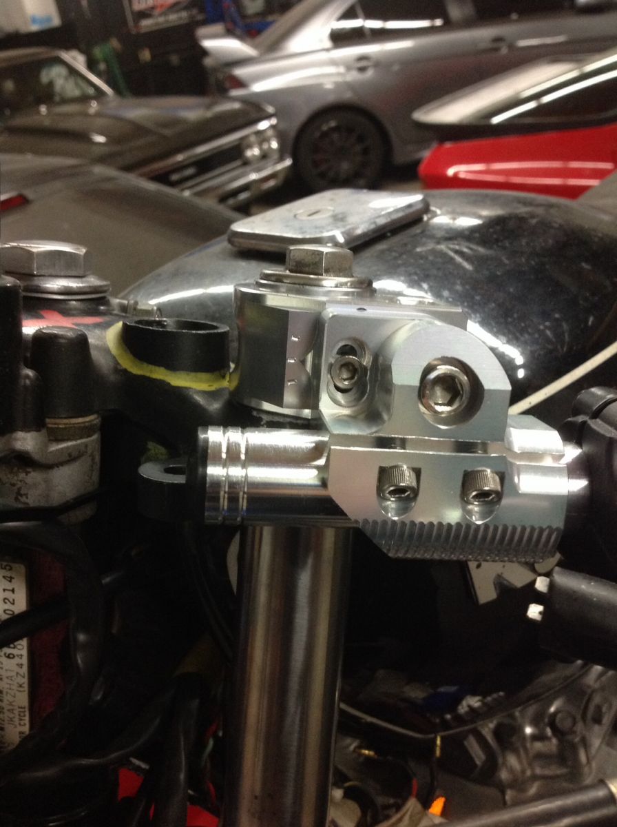

Got a "very impressive" pair of cnc'd clip-ons from eBay. I'll admit to buying Chinese knock offs. There's some things you'll get and know right away if you should just throw it in the trash now. Soooo here's the clip ons. tell me what you think. I'm only gonna change out the hardware to 8 grade ss instead of their 4..
3 adjustable angles. There's a recess for two tiny ball bearings on both the bar mount and tube mount to me them interlock and not budge.
I gotta take it apart again, then I'll get a pic of what I mentioned above.

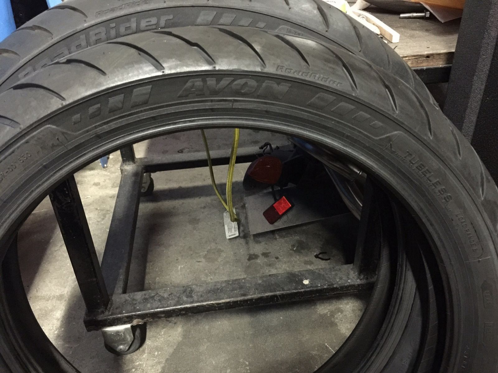

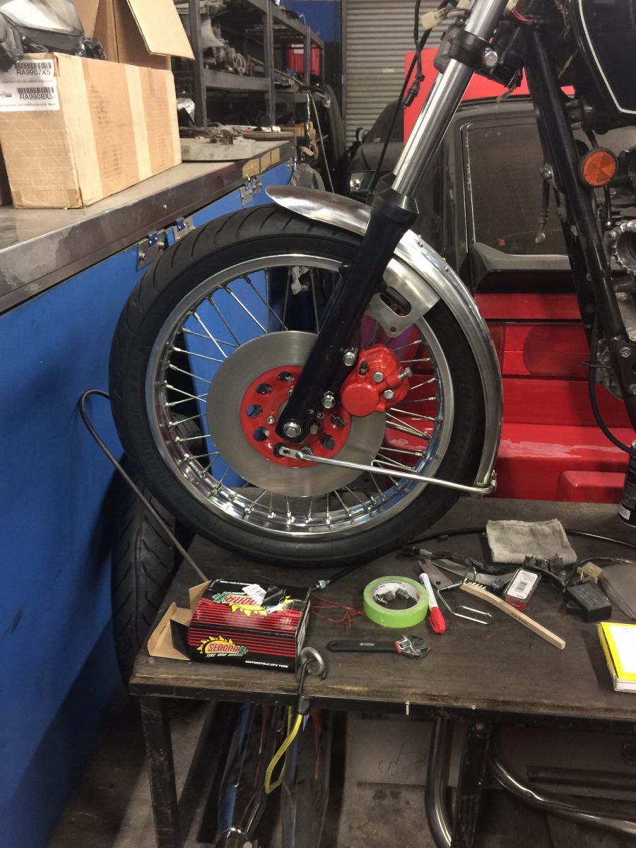

Yup I'm still doing it! Works been swamped getting some cars ready for shiftsector this weekend. Anyways, I got my tires on Monday, excited about that..
got the front squared away, thanks to Docs very helpful info..didn't put the rotor on yet cause I didn't wanna screw up my paint job.
Was gonna order up some tubes now but just wanted to get a few other second opinions on sizes. From a posted chart on another forum I was looking at on google, it seems like I can get away with a 325-350 tube for front and back. My tires are AM26s 90/90x18F and 110/90x18R. Or should I do a 375-410 for the rear? Thank you in advance once again...

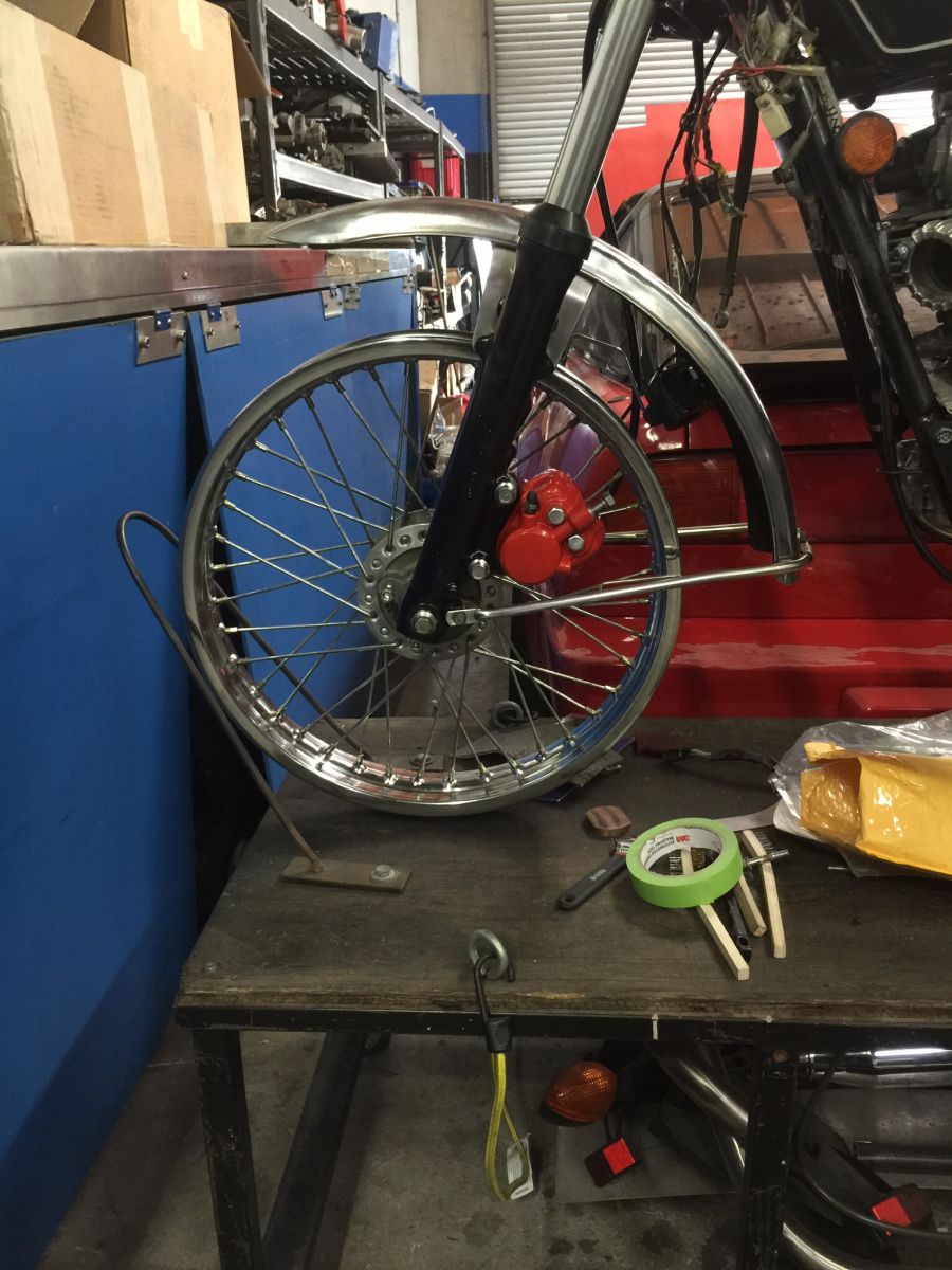

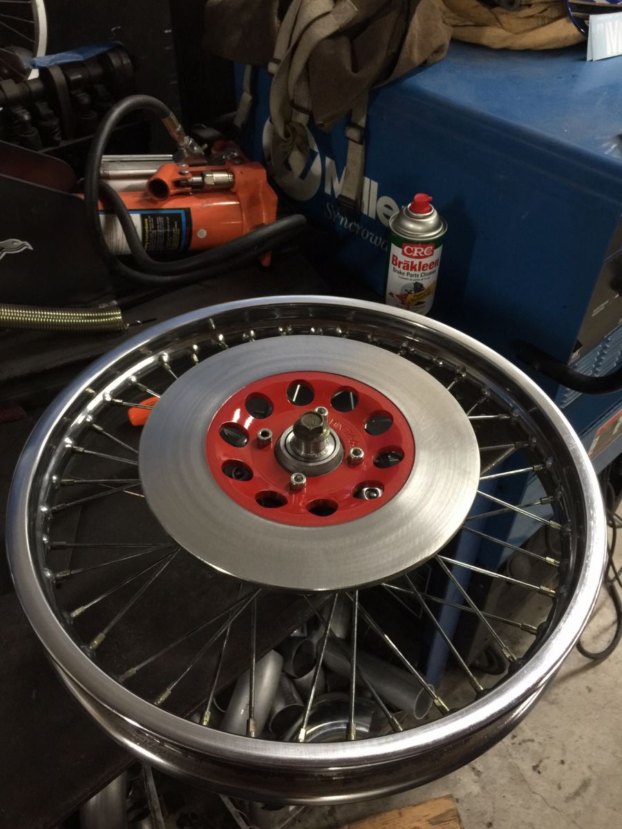

Finally had some free time so got the front torn down again so I can install my refurb'd rotor...
I'm thinking I shoulda painted this or the caliper a different color from each other. They might clash, but I'll know soon enough..
The rotor before getting pampered and the spacer that needed machining. Decided to weld a dust cover for the seal since the 400s axle spacer had one.
[atachment=83757]image-23.jpg[/attachment]

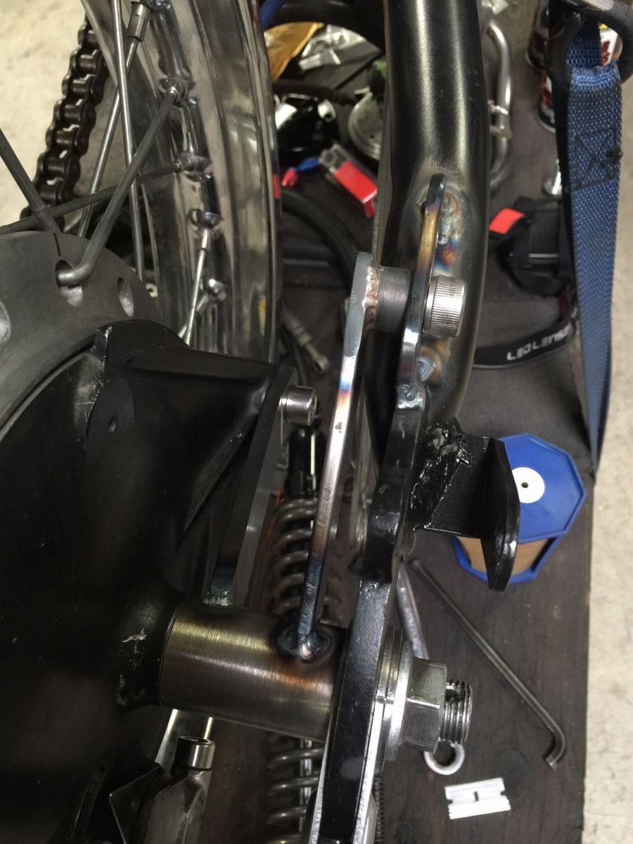

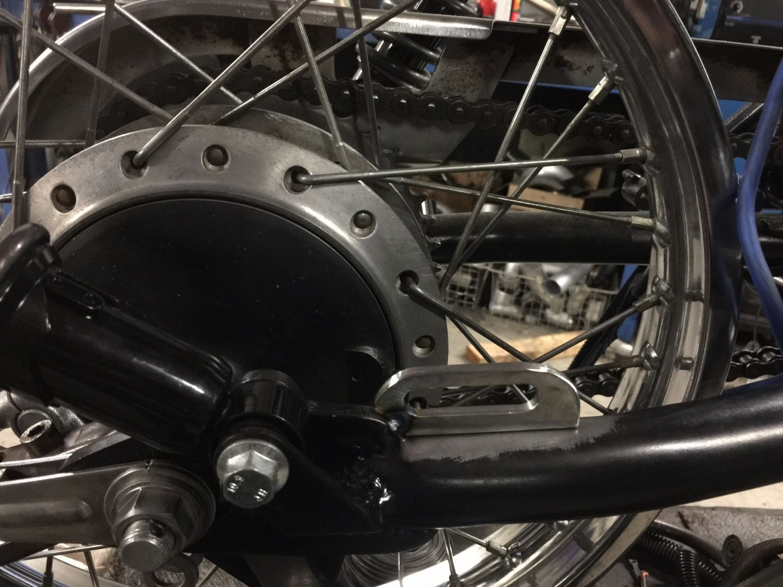

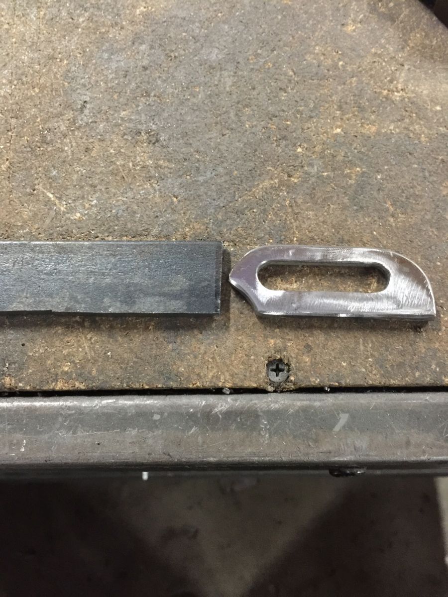

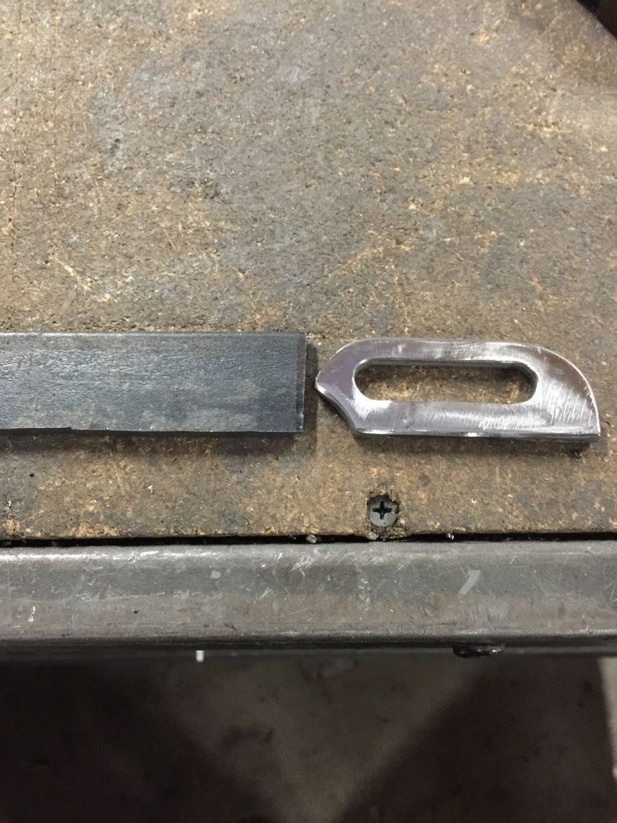

I finally got the front squared away brake wise, just waiting for my banjos so I can make some brake lines.

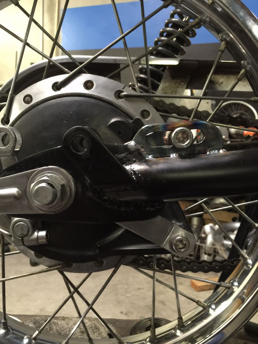

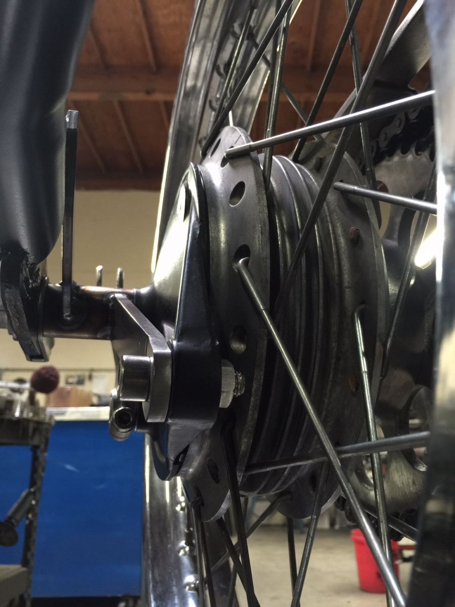

So moved towards the back and fabbed up a new brake stay. I think it came out pretty decent, still gonna brace it a little on the earlier fabbed spacer for the wheel.
Adjustable mount I milled out for the new brake stay. Made it too adjustable though.
New location for said mount..
A top view of it all together..
side shot..
Bottom looking towards the back..
Originally I was gonna take a .120 wall tube and cut it in half to make a C shape, then have that rest on top of the swingarm. I'm sure it wouldn't have moved once the axle nut was tighten down. So I think I went a lil overboard? Now just gotta figure out how to get the lever connected once I get my new rearsets on/fabbed.
side shot..

All that's left is a brake line(on it's way, Thanks Mike), fiddle with tire a bit to get it to seat squarely around the rim. Mechanically, the front is 90% done more or less. Mounting 90/90 Avons with a tube is a little tough.
Should I air the tube up to what the tire would hold tubeless?

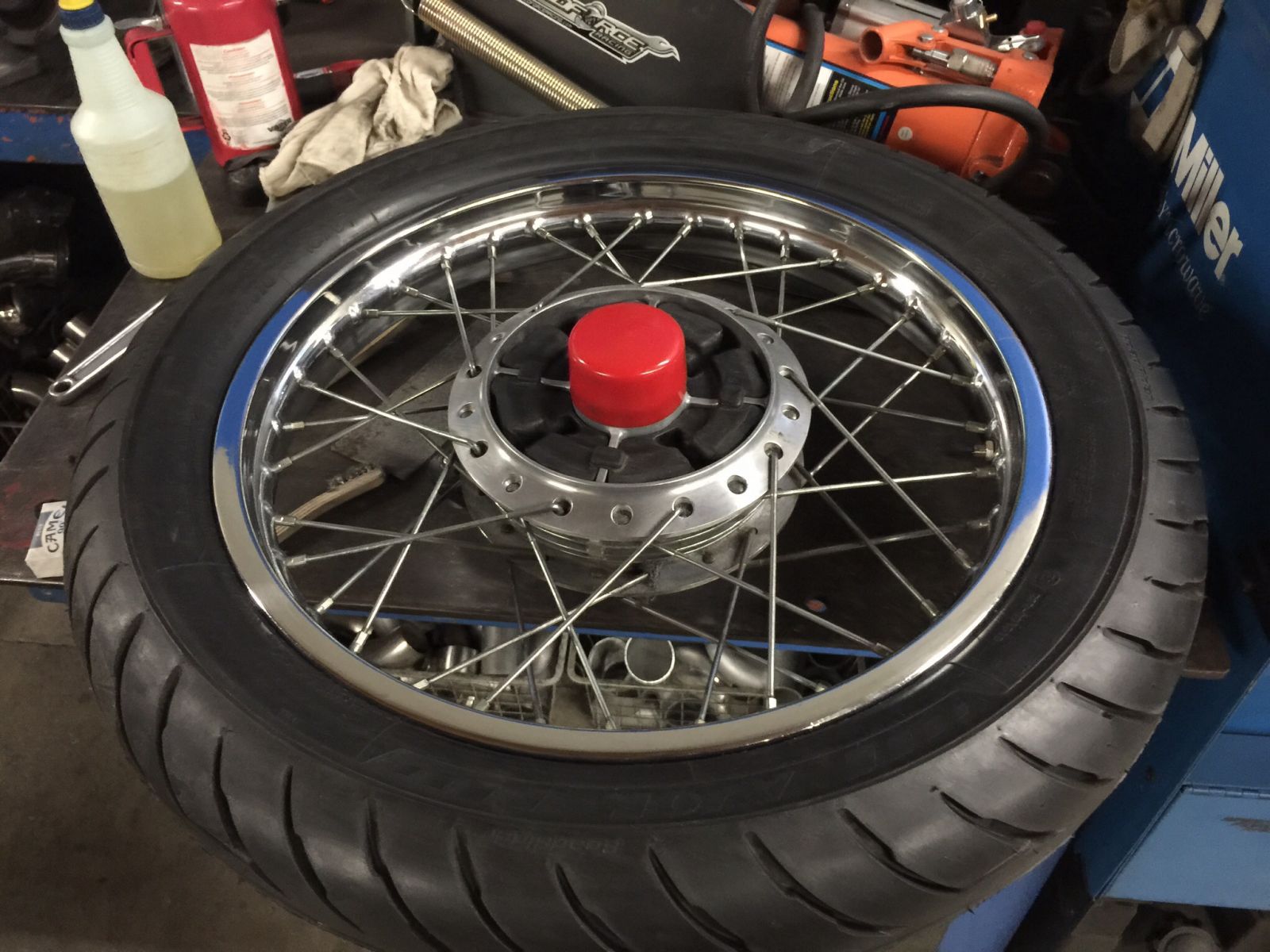

rear tire mounted.
Gonna paint the brake housing and cush hub. Or maybe polish it a bit so it'll match the hub? Then back in it's place.
