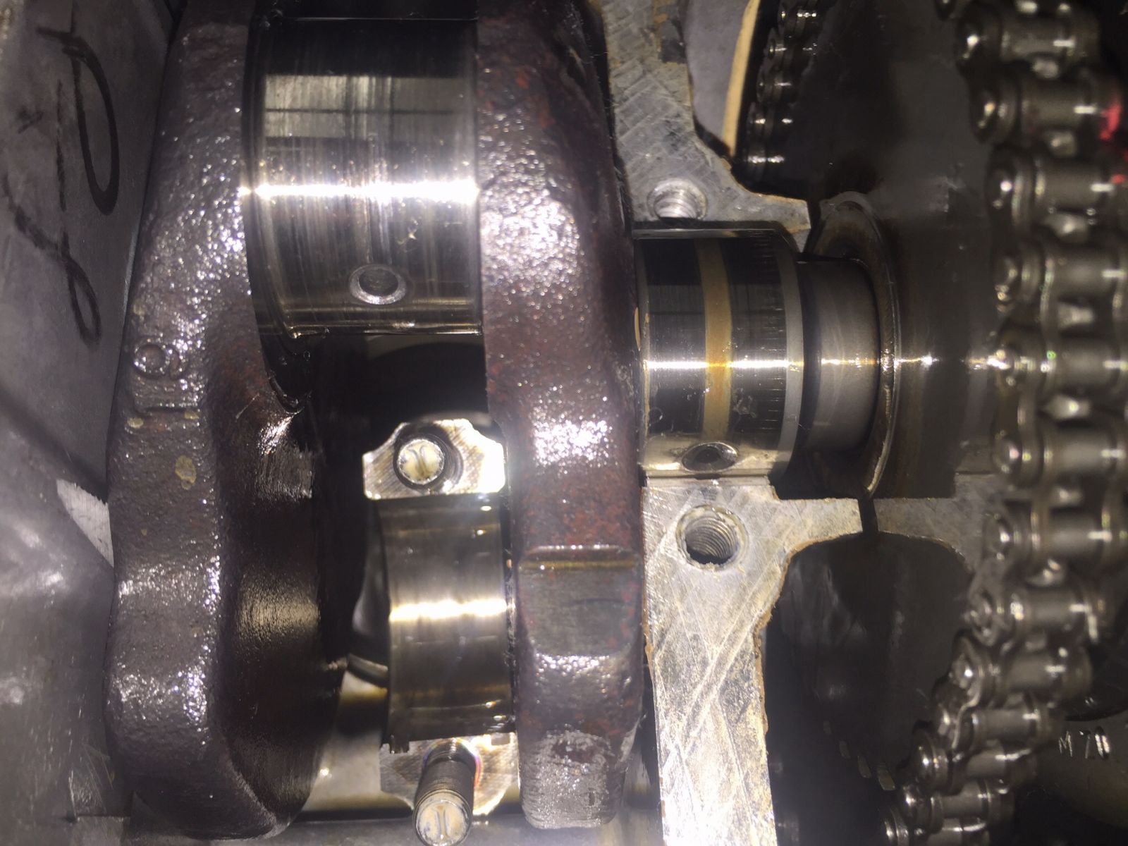

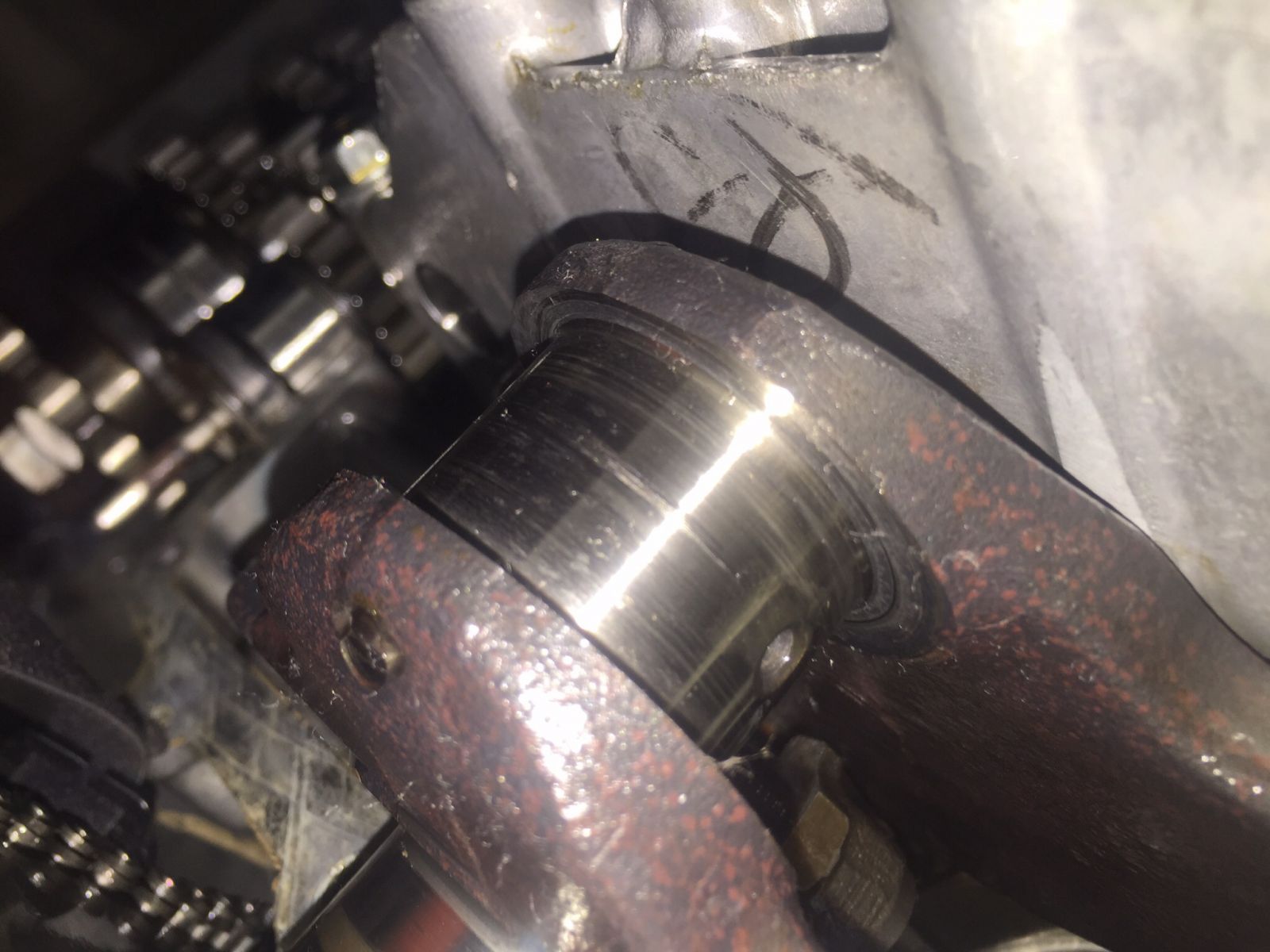

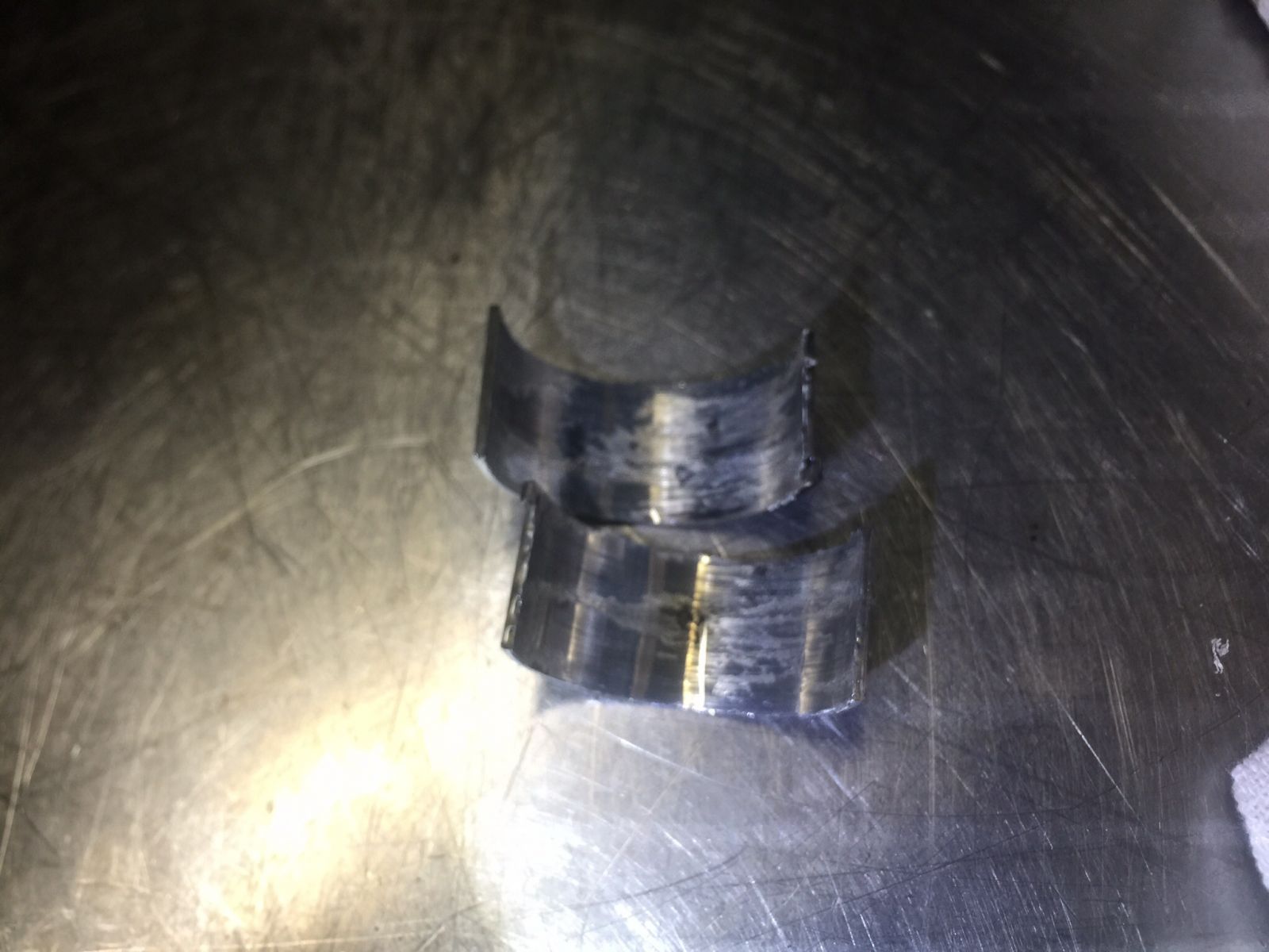

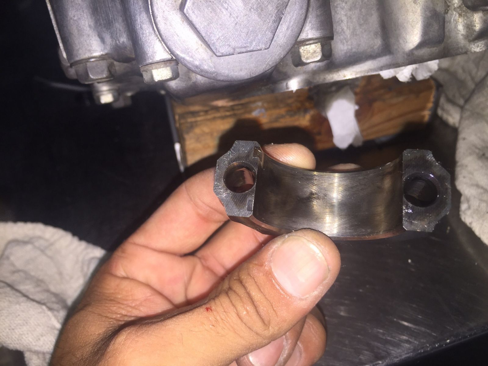

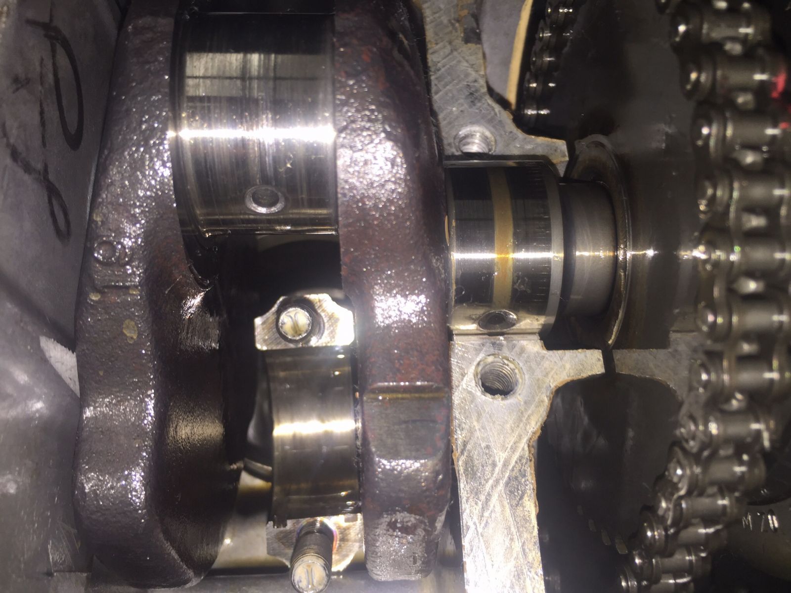

boooo! my ipad foiled me. Had a lengthy post too. Anyways, took a week off work (along with some other close friends and fams) to spend some QT with a nephew of ours that got diagnosed with Danons disease..enough with the tmpi emo stuff.
Finally split the case earlier today and firmed that the left cylinder is the culprit. Now this is where I got confused or it just got weird? Both the crank and rods were unmarked, no color stamp on the front. Mic'd the bad rod journal on the crank, 34.91mm. Going off the numbers from the manual on kz400.com the service limit is 34.97? Big end of the rod came in @37.94. I measured everything 3 or more X's with 2 different calipers. The crank looks like it can get a minimal amount of grinding done then a polish. The measurements are whats throwing me off? Im guessing i should now hunt down a pair of green coded(1097) bearing halves? That is if the crank is reusable? The scoring is minimal at best. If it were a honda civic, id squirt some WD40 on a sheet of 600 up to 1000-1200, clean it real good, make sure theres no severe play as well as nothing binding up then call it a day! Been there done that.
Oh and on a side note, I wanted to see just how hard it was to pull the motor from the frame rather than pulling the frame from the motor laid on its side. Omfg..what a PITA!! Will do the "lay on its side" method when the time comes. Then i thought of something thats used on a lot of sandrails now a days.
weld a pair of these in one of the lower frame tubes?
The business end of the crank..
another angle..
You can see a hot spot on the cap but the crosshatching is still clearly visible. but heres cap and the ugly shells..whats left of them anyways.
Motor isnt totally disassembled yet, just wanted to get to the knocking one. The mains seem more readily available so 4 pairs of the right ones are on my list. Im trying to find a "seal kit". Ive seen a few for a 750 and 1000.
So now im requesting guidance from the forums Kawi gurus once again...pwease

Polish the crank. Don't worry about bearing color unless you can find ZR7[?] bearings.
KZ650,750/4,ZR7 use the same. Bearing cap is ok. Buyer beware on crank assemblies.
I once drove 3 hrs. one way to find out it was in the same condition as yours. No seal
[kit] I'm aware of. Last I knew all seals are available except the clutch push rod seal.
A valve stem seal can be used with an original taking up the difference to the cases.

26 Oct 2015 06:34Nebr_Rex wrote: Polish the crank. Don't worry about bearing color unless you can find ZR7[?] bearings.
Thanks for that precious info Neb. So the color code crosses over..That'll broaden the selection for me. Just using kz440 in google gives me 2 links and the funny thing about that is they're posts/threads by or from you..lol One link comes here and the other takes me to DTT. Damn crafty with that EFI setup. Ever hear of a company called "splitsecond" .
Of course the push rod is the first to change. All the lower seals, even the clutch rod are still the consistency of a soft rubber as opposed to a dried out 30+y orig that is two days from being plastic.
