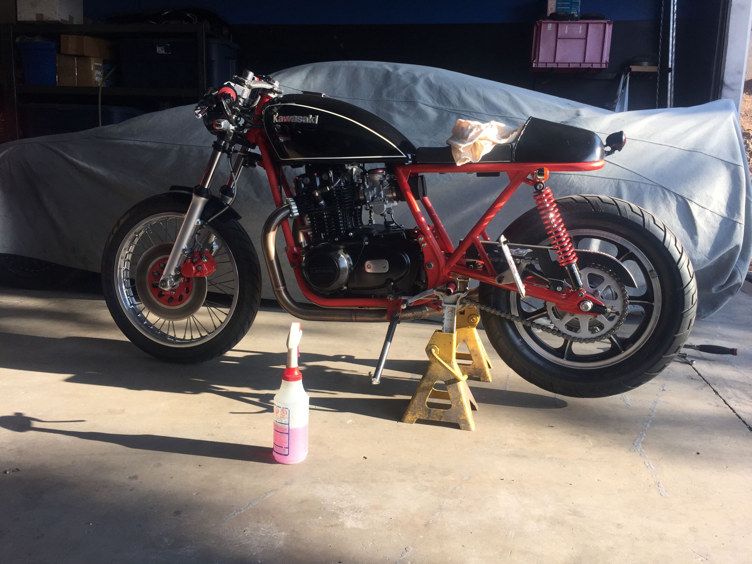

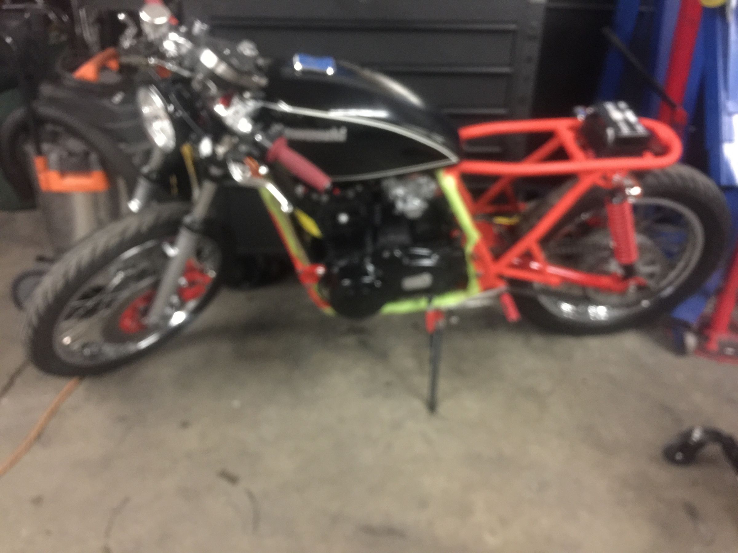

Have a few pics of very slow progress, but progress none the less.
what my bike currently looks like..

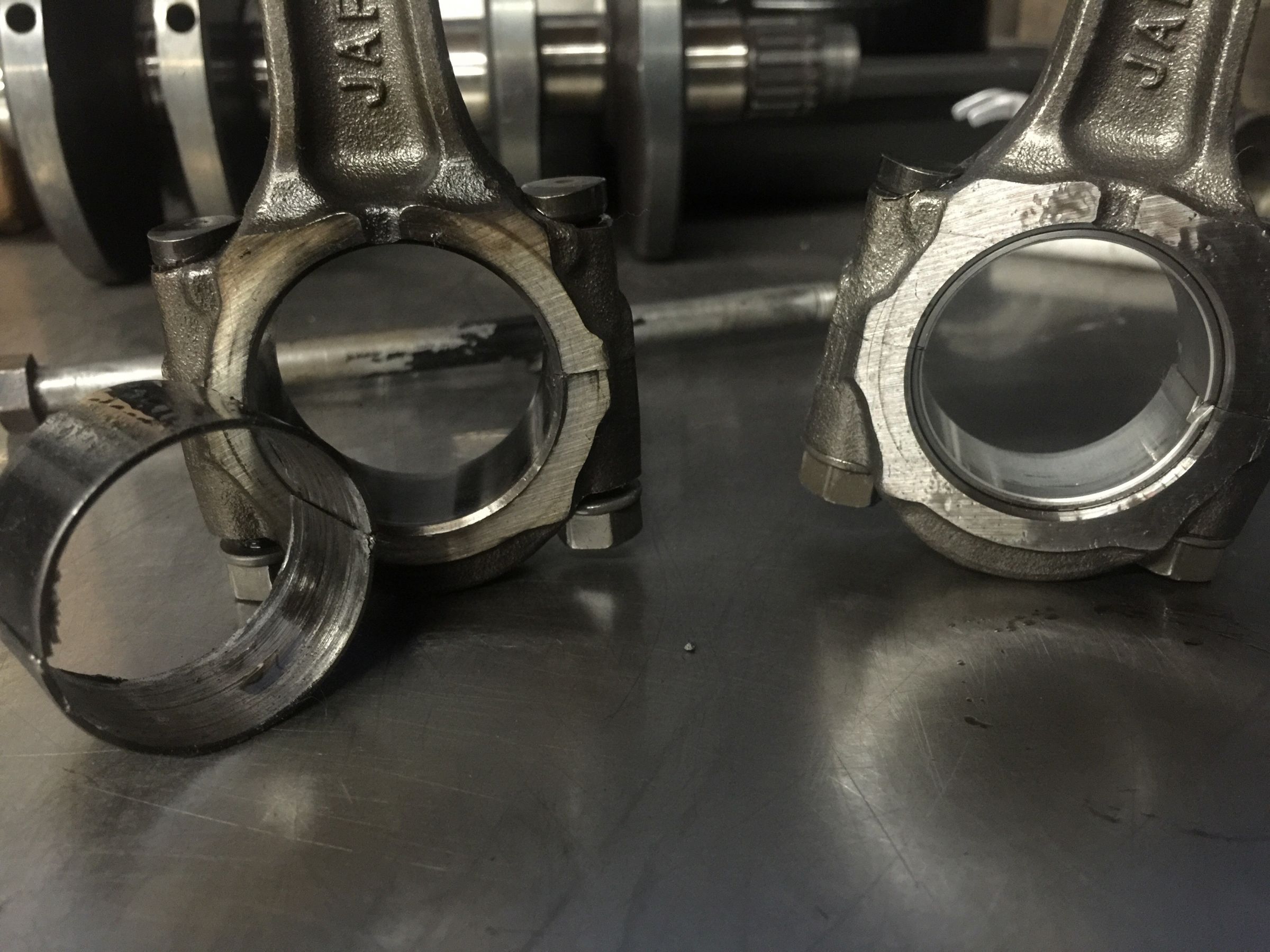

The bad bearing. I got the clearance pretty well on the right shells?

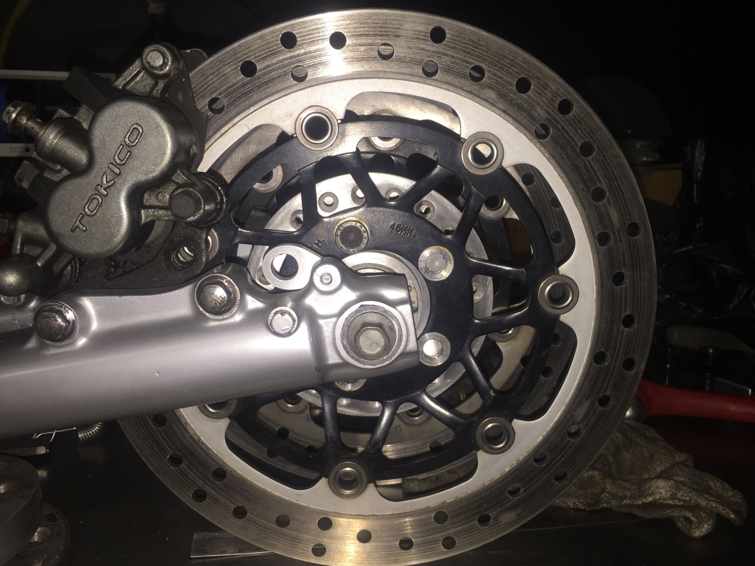

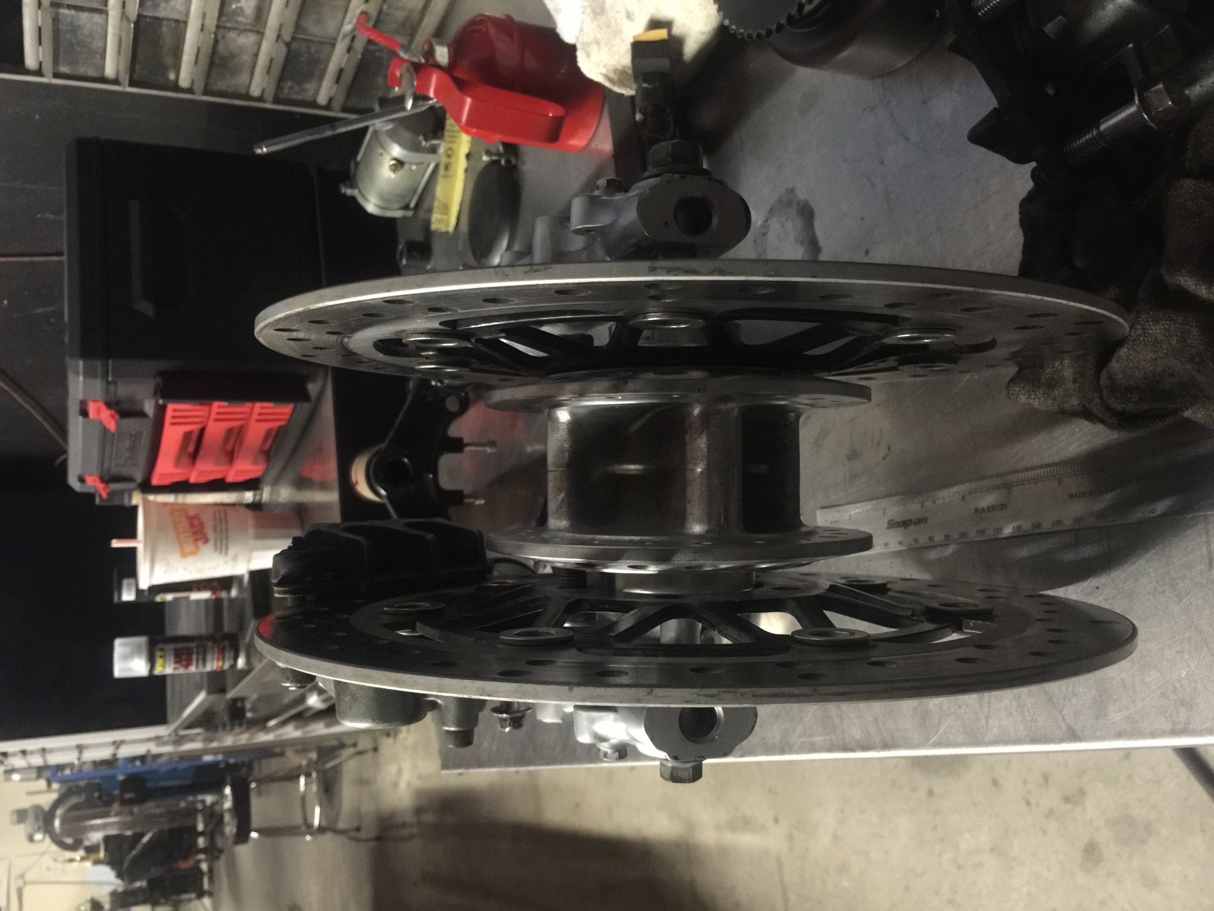

Mock up of the front brake upgrade.
Now that I had all the parts In front of me I might postpone this mod till a future date? A lot of machining off the back side of the cals and the carrier bosses on the forks is gonna be needed to get the clearance between the cals and spokes.
I'm sure I can get it all working properly and safely but it'll mostly be an aesthetics thing which I was aware of before starting. It sure would look damn sexy though

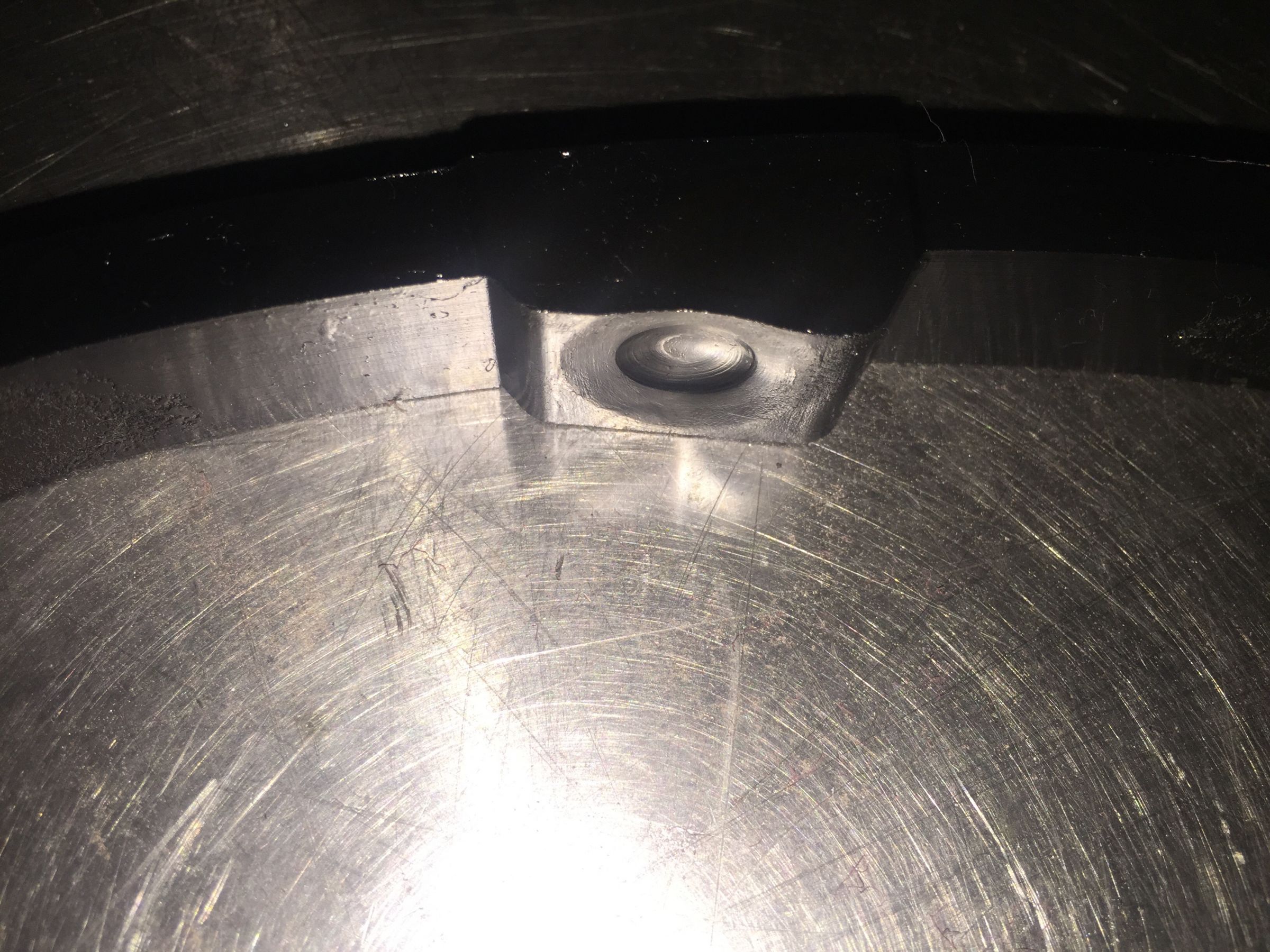

Need an opinion with this? Is the indent from the auto adjuster normally that big?

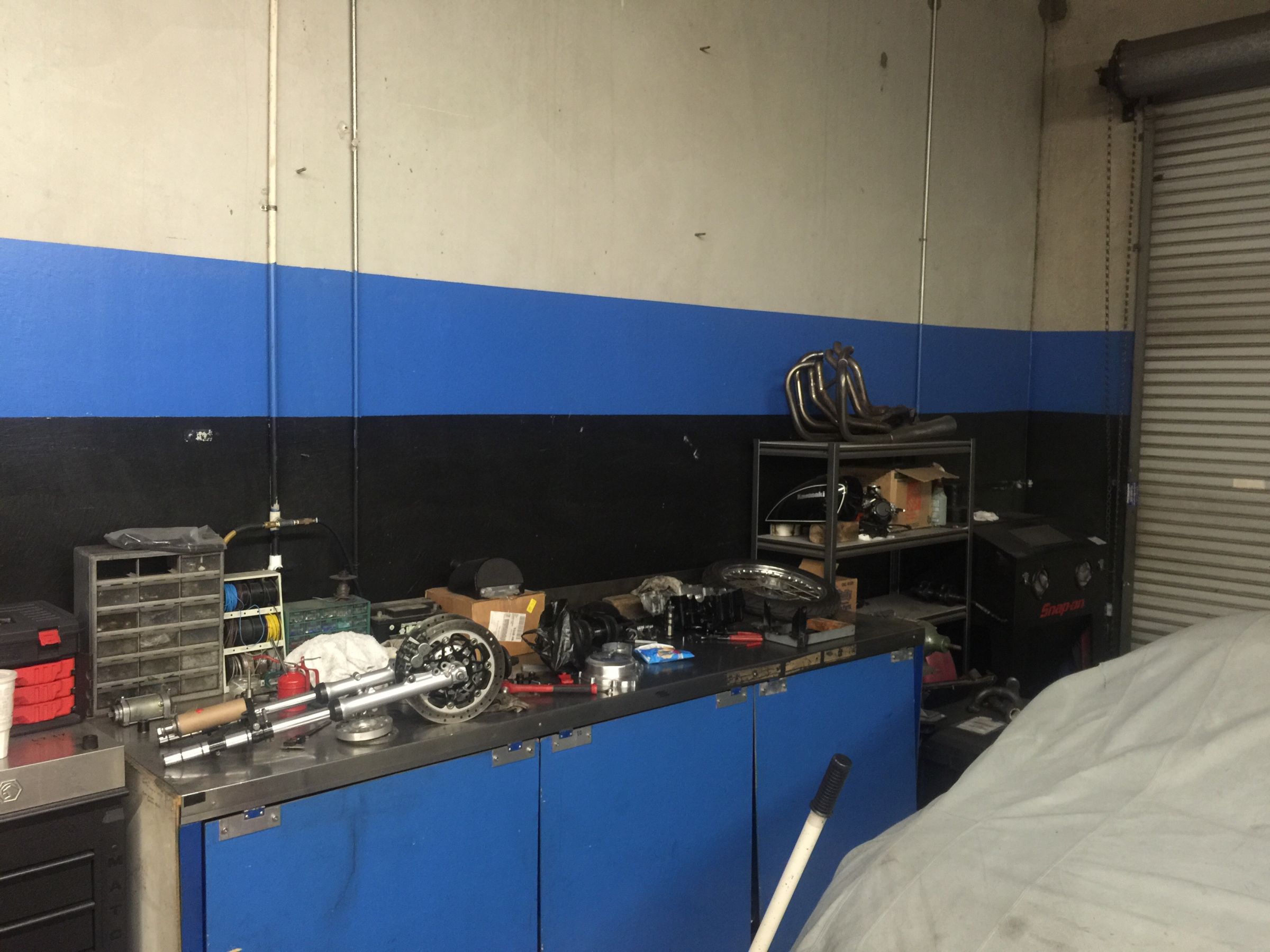

Some random shop pics..

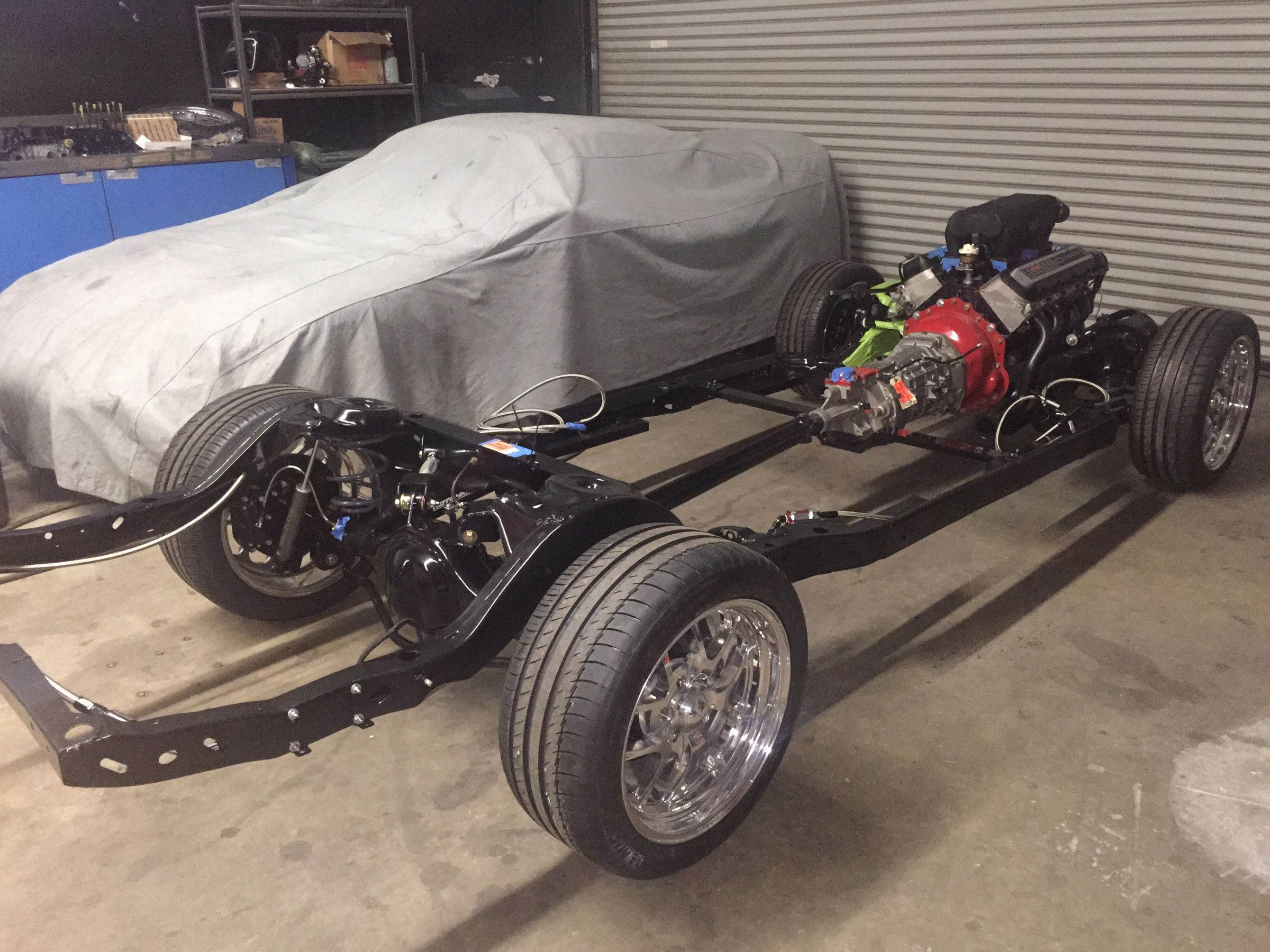

Prototype invisible car chassis.. :whistle:

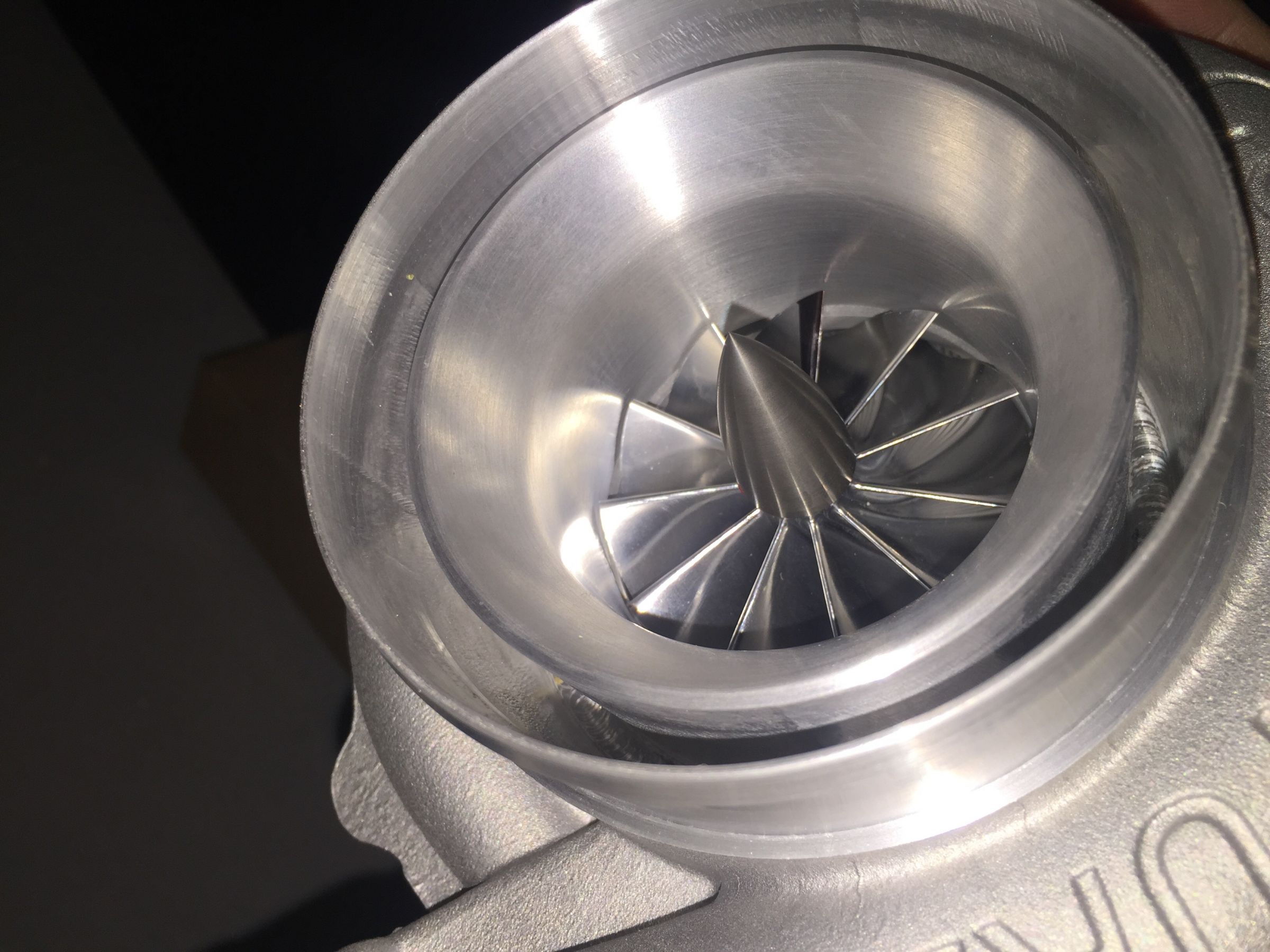

Oil less turbocharger. Has a zirc fitting to pump grease into it every time you do an oil change.

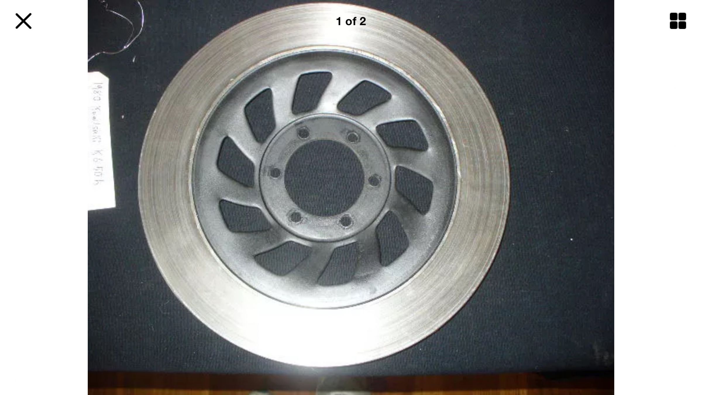

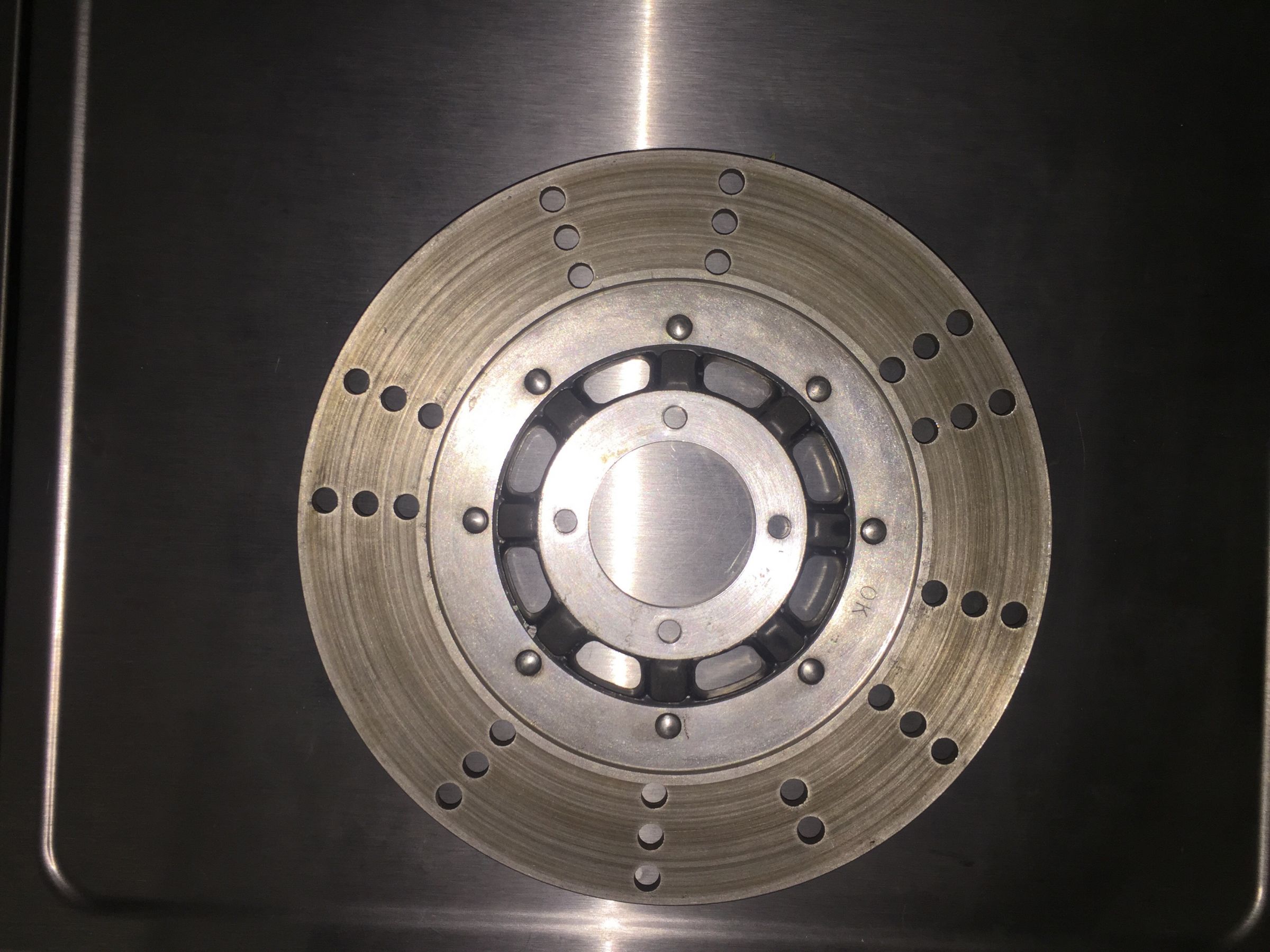

My 5" slugs came in today for rotor spacers. I might as well do the brakes and take advantage of still having new lathe bits on hand.
During my ebay browsing earlier, saw this rotor labled as a KZ650H? I like the pattern in the "hat section"
Any ideas or what not for the uneven pattern of factory holes. Balancing thing maybe?
my rotor at the bottom to compare. Above pic was borrowed from google

Your project is coming along well.
As far as the drill pattern, notice the one set of only two holes.
These two holes are spaced off the rows of three, to sweep the pads on a different line, for better wear and to help clear the pads of dirt, is my theory.
if all rows had three holes, the pads would show wear in similar lines.

There's probably a harmonics element to the asymmetrical spacing as well.

The first disk you posted with the swirly pattern carrier and a 6 bolt pattern is definitely not for a kz650h
If you don't want to do both sides for brakes I'm sure a single disk setup would be plenty of brake for that little 440. I had to mill material off the forks to get the calipers to not hit the spokes on a brake setup i'm currently working on for my twin. Was pretty easy actually.
