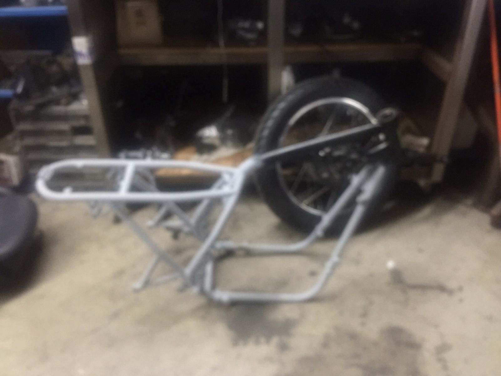

jk. Last weds. I had began a hefty and informative reply here with lots of pics, when I was finally finished I hit submit but my browser decided that it wanted to have a problem and all of the post was gone. . .smh. cookies were of no help. I gave up immediately out of frustration after that and moved on.
..Ahhhhh life..wonderful game. Anyways another attempt for an update and crappy phone pics are in order. It'll be pics with captions this time..lol

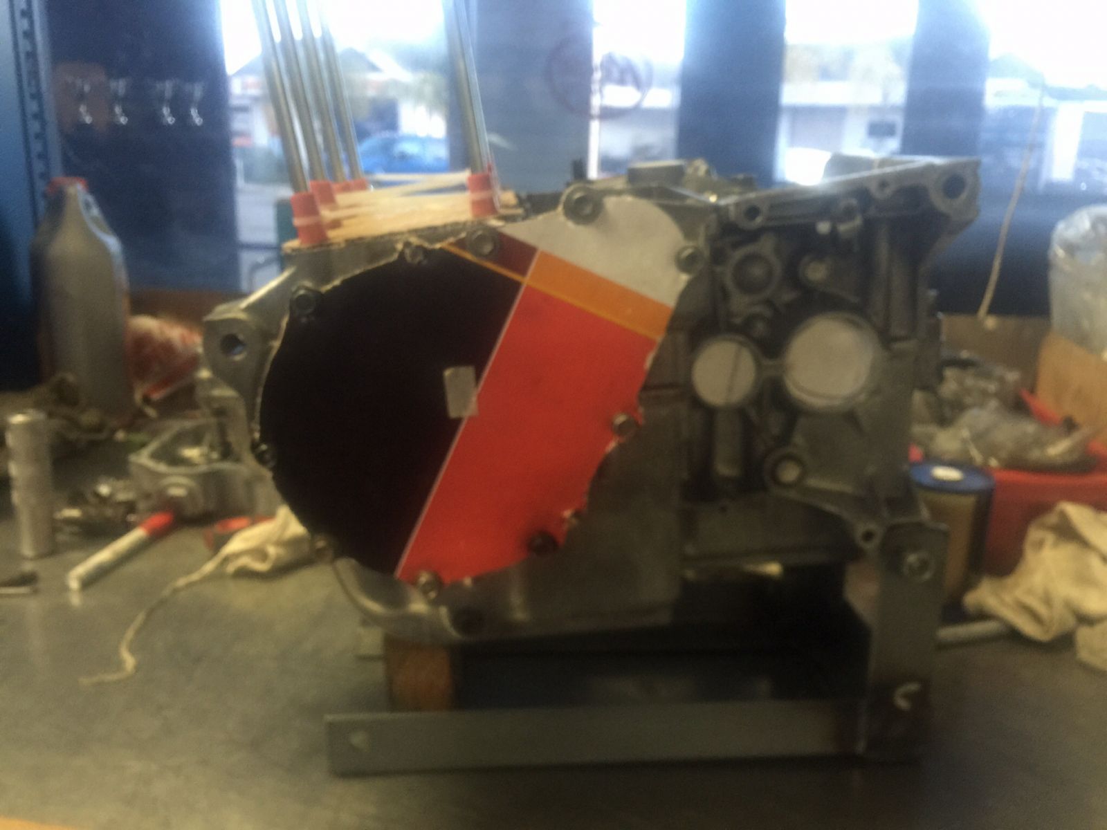

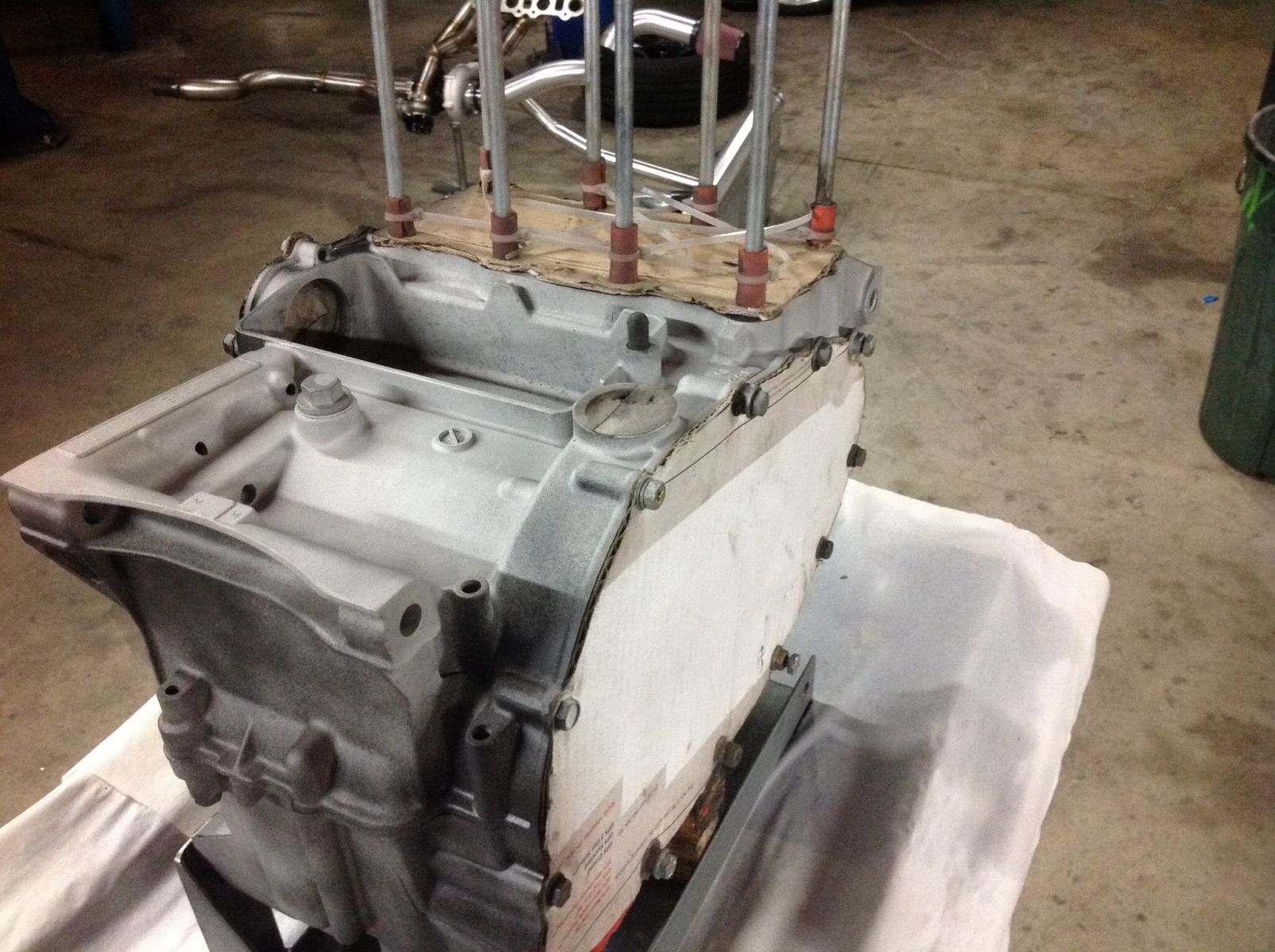

Motor torn down..gonna sandblast it.Tthe case was completely empty mechanically, just wanted to keep most of the media out as well as protect bearing surfaces more.

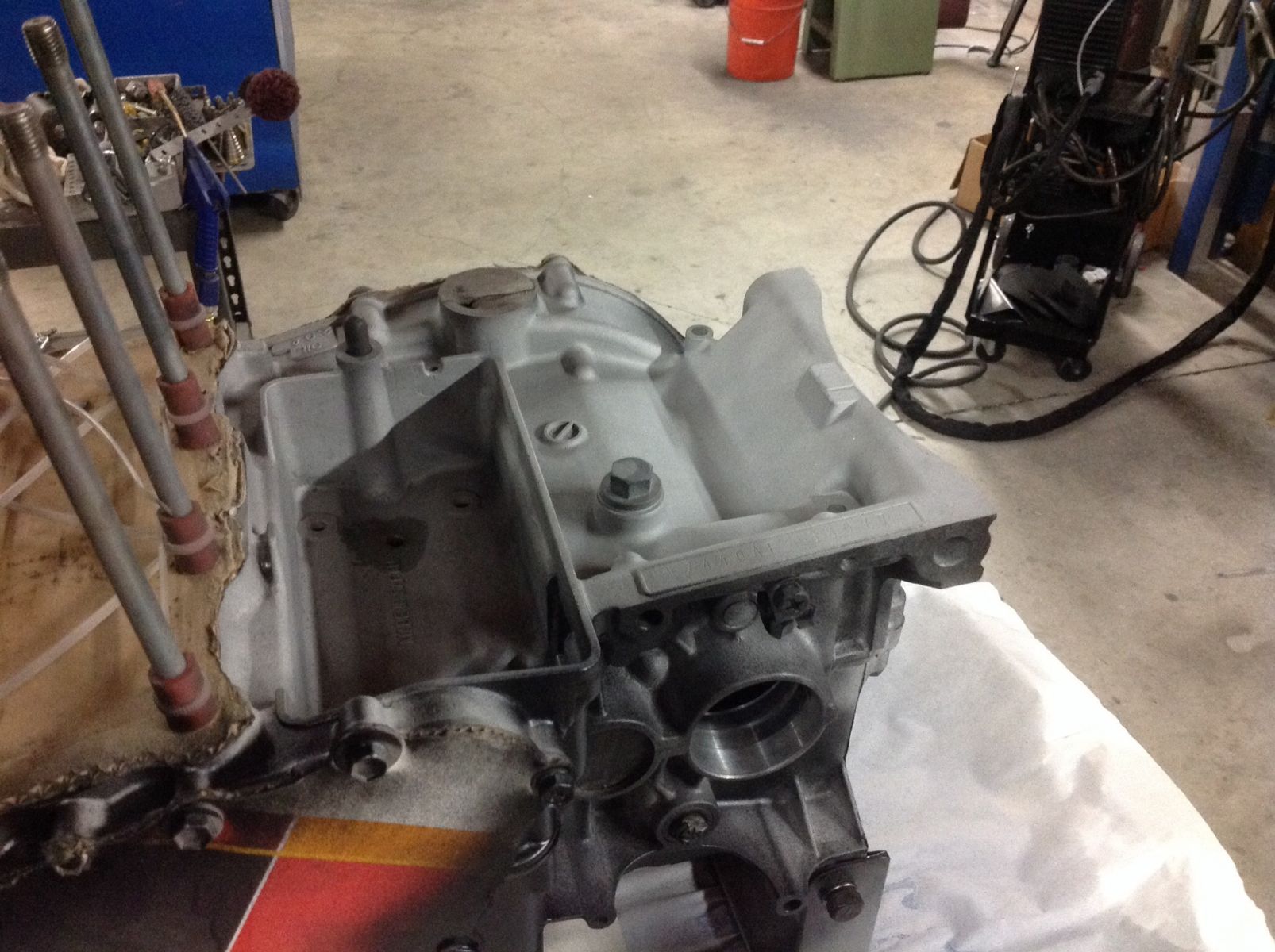

Stator side..
I opted not to pull the studs because, 1..my stud pullers were too small or big. 2..didn't wanna gall up the studs with visegrips. 3..couldn't find a new set. But case is blasted the best I could in my cabinet.

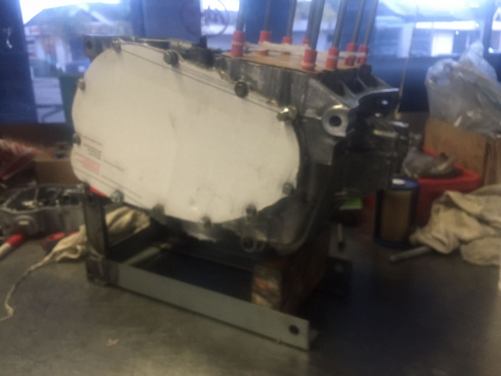

Stator side again..sand blasted
I should've taken A LOT more pics! But my hands were either oily or not electronic device sanitary safe 80% of the time. Had my buddy polish out the crank journals. definitely did a better job considering they have the tooling for it. no pic of though

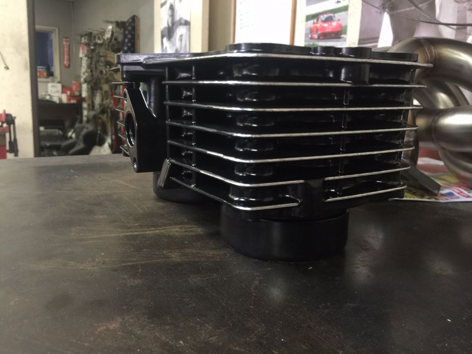

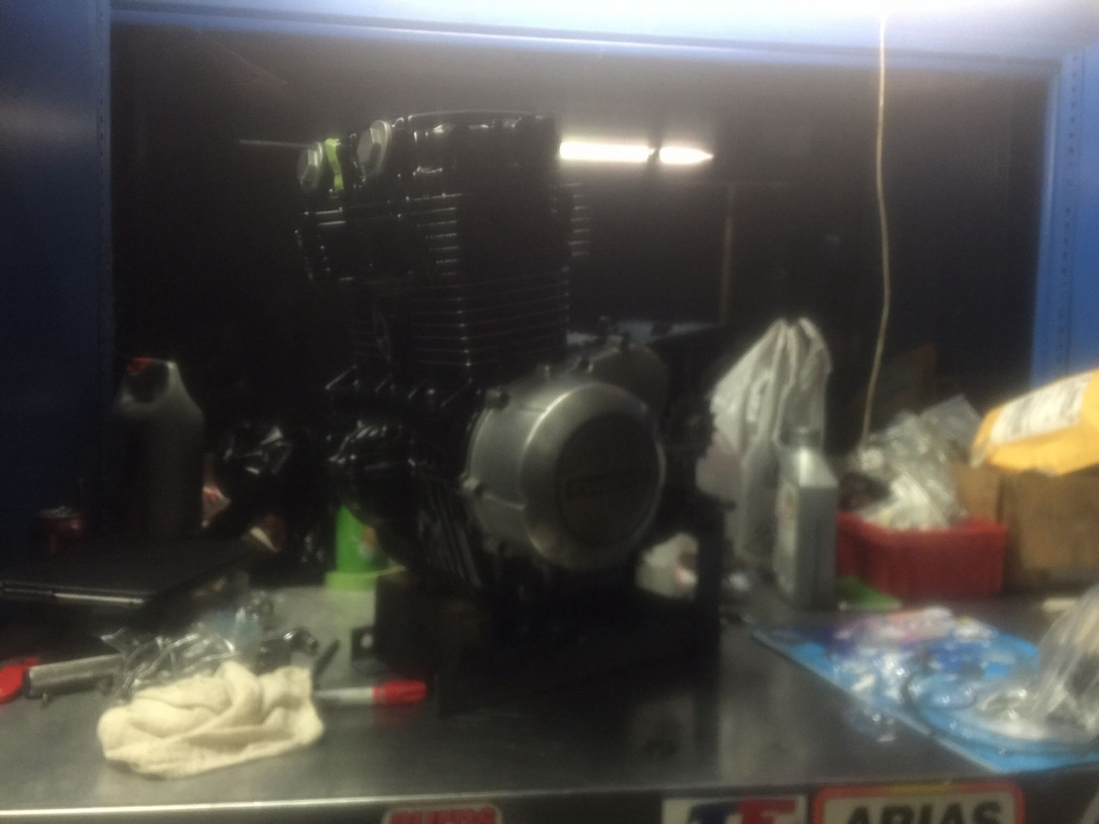

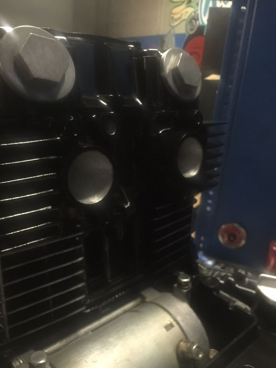

Since it was all out and apart..out came the rattle cans..I used the fancy engine paint the has "with ceramic" on the label. Then sanded the edges..Pretty?..lol.
Gave the head some TLC before the valves and paint went on.
Motor assembled and ready to go back home.

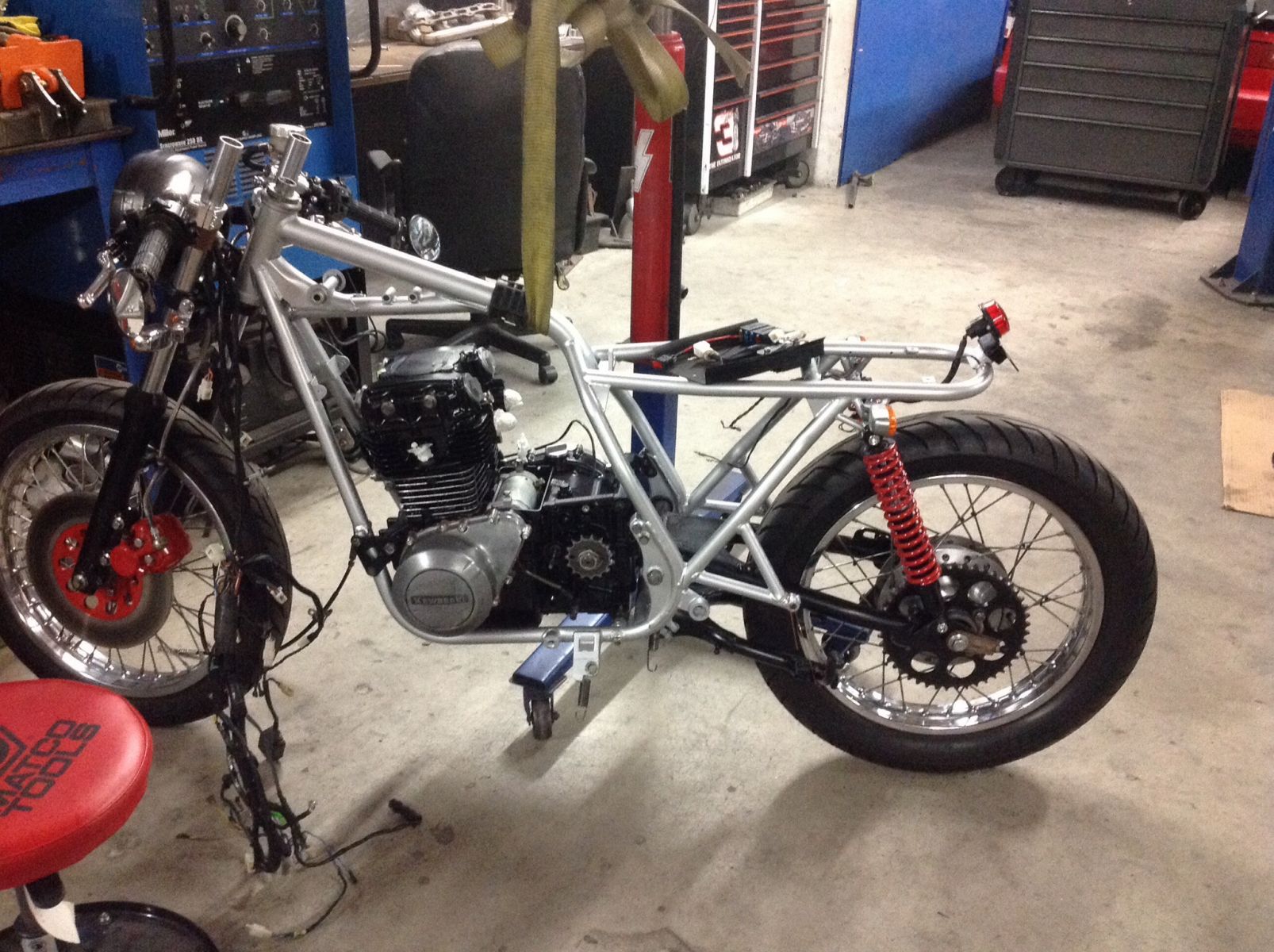

since the motor was out and looking nice and shiney, couldn't think of putting back into the dull frame..
Well...coming together. lmao..I sat the motor on it's side in my welding chair and dropped the frame on. I reassembled most of the bike while it was on my chair. no pic though. But here's what else my tranny jack does in it's off time. Absolute help when fabbing turbo manifolds under the car..

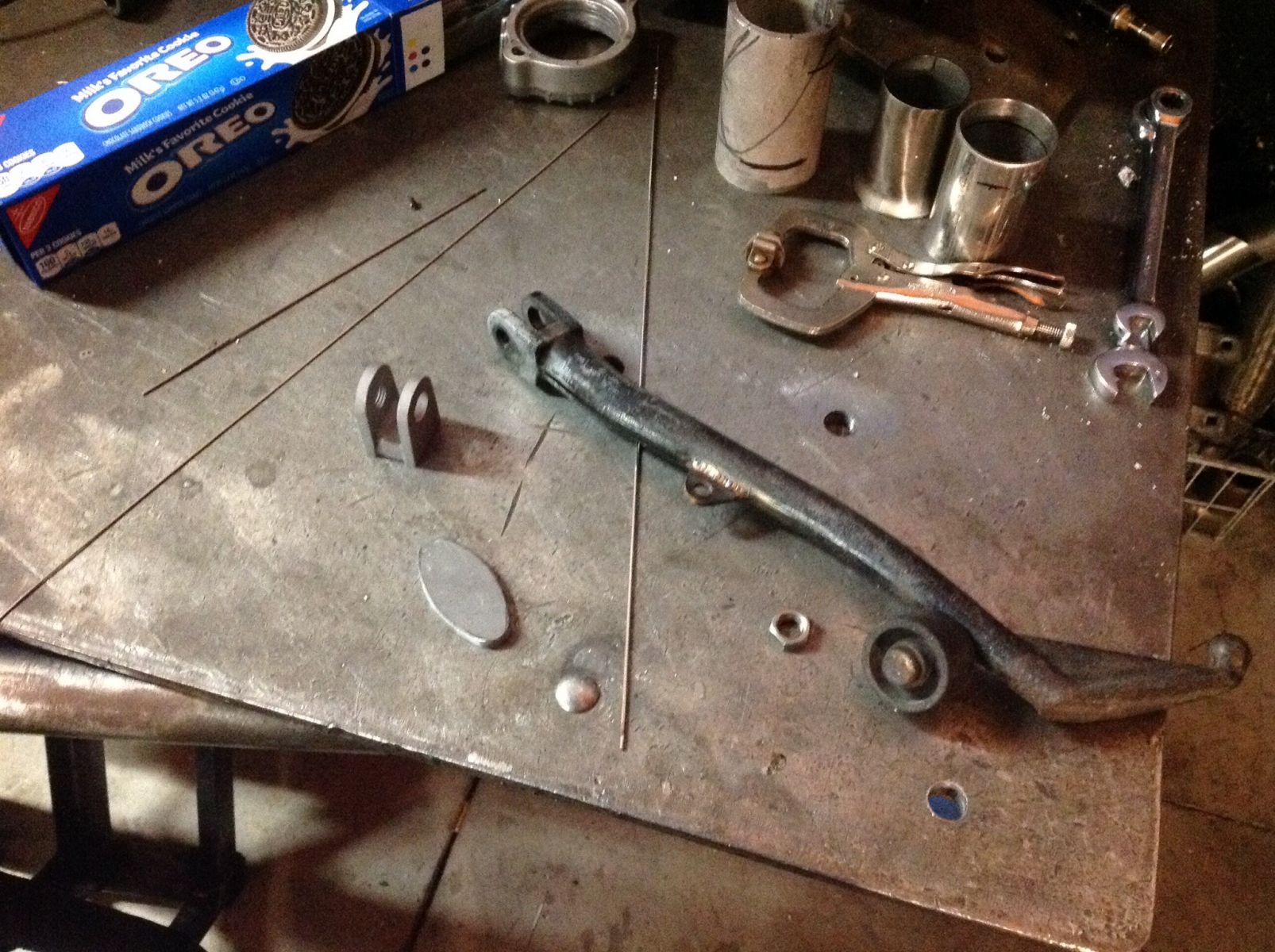

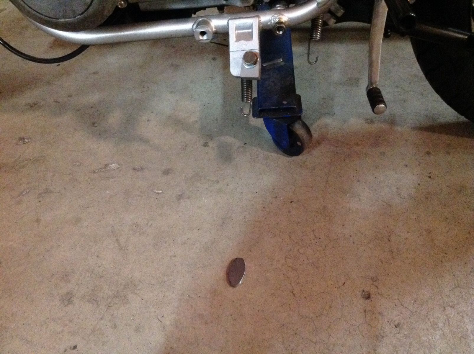

Thinking ahead, I moved the side stand spring to the backside of it's mount to give me more foot clearance for shifting, but didnt notice the kickstand shape wasn't gonna allow it. So had to make a new one
Trying to get the angle and foot rotation just right..
coming along nicely..

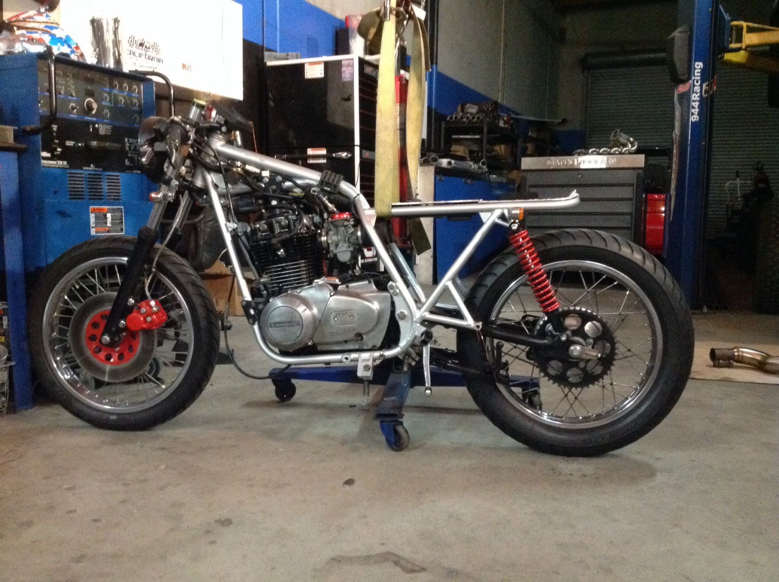

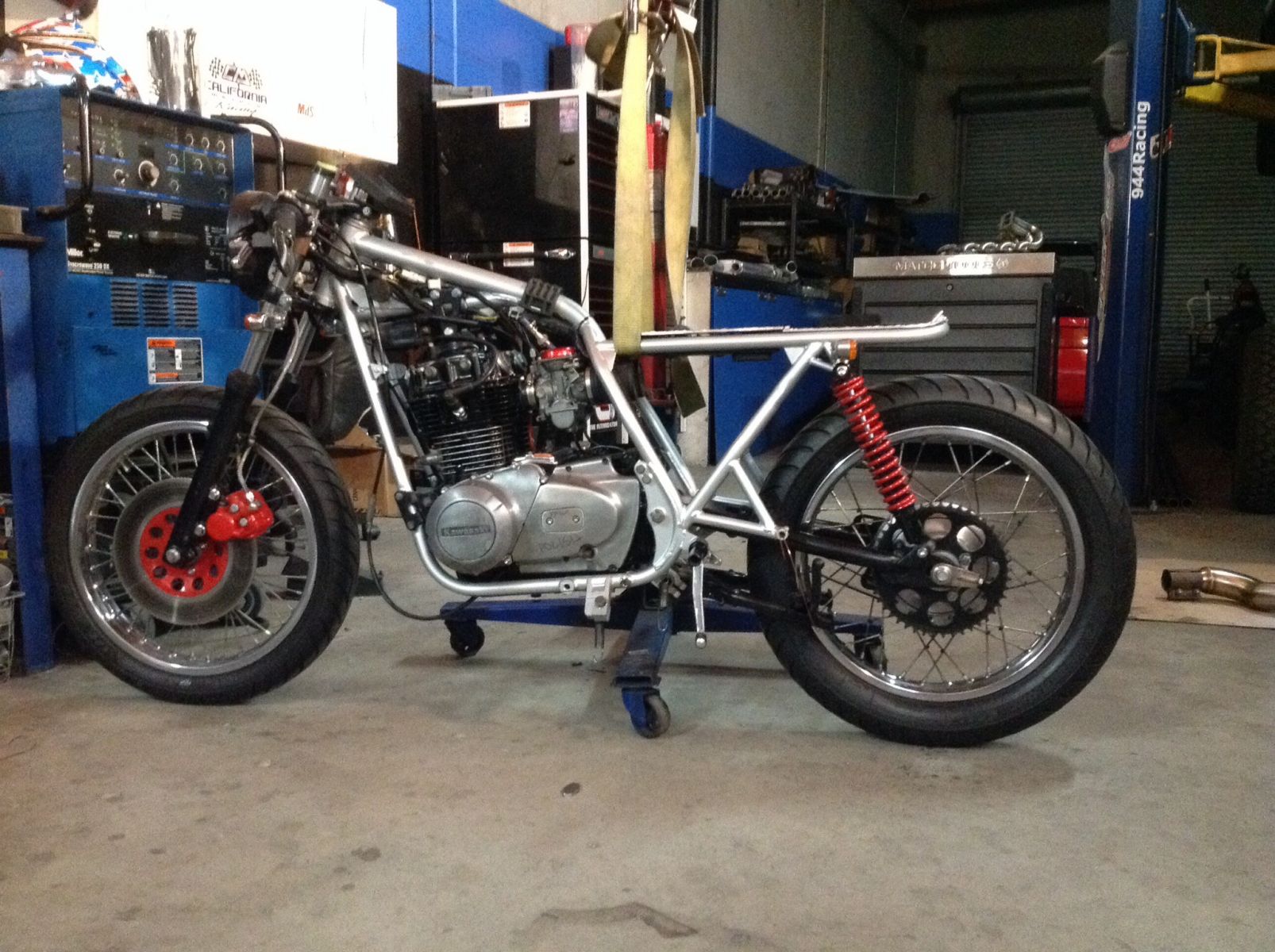

Side shot with the bike complete..
Don't mind the tail light..I broke the plastic lens on the old one and needed a brake light like now..Also had to redo the seat and tail. Before they had an overhang that would cover the frame. Didn't wanna cover that up now do we? The tail is still work in progress. What a journey..lol

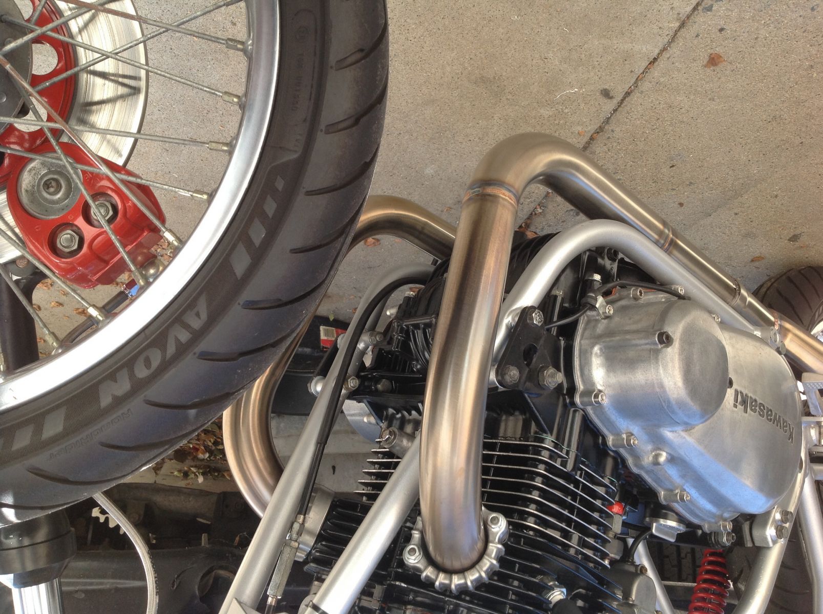

header and exhaust pic update..
head pipes...

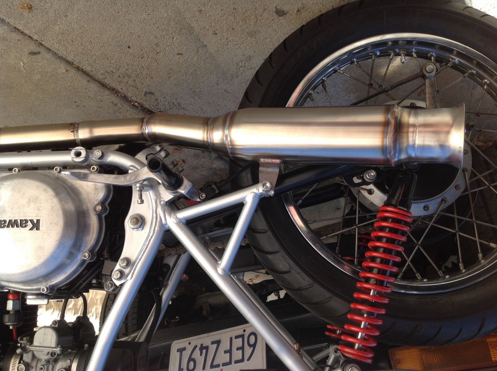

exhaust..

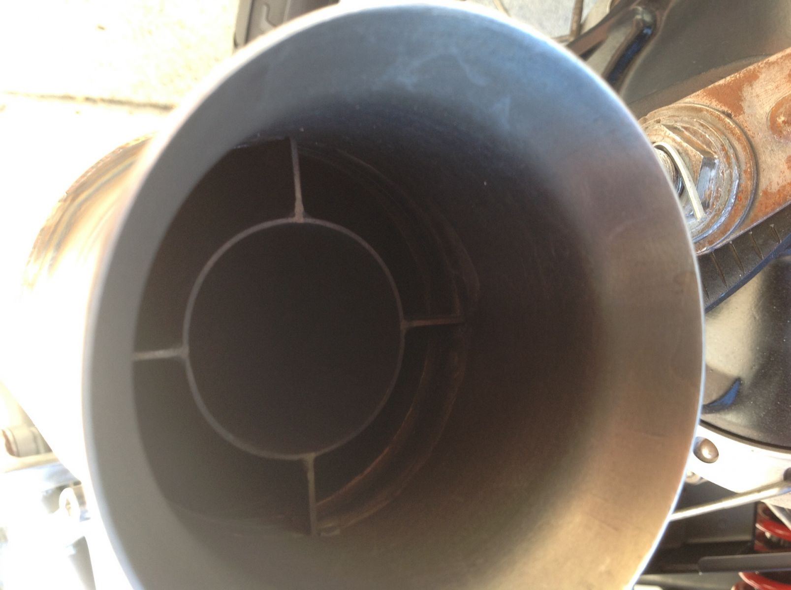

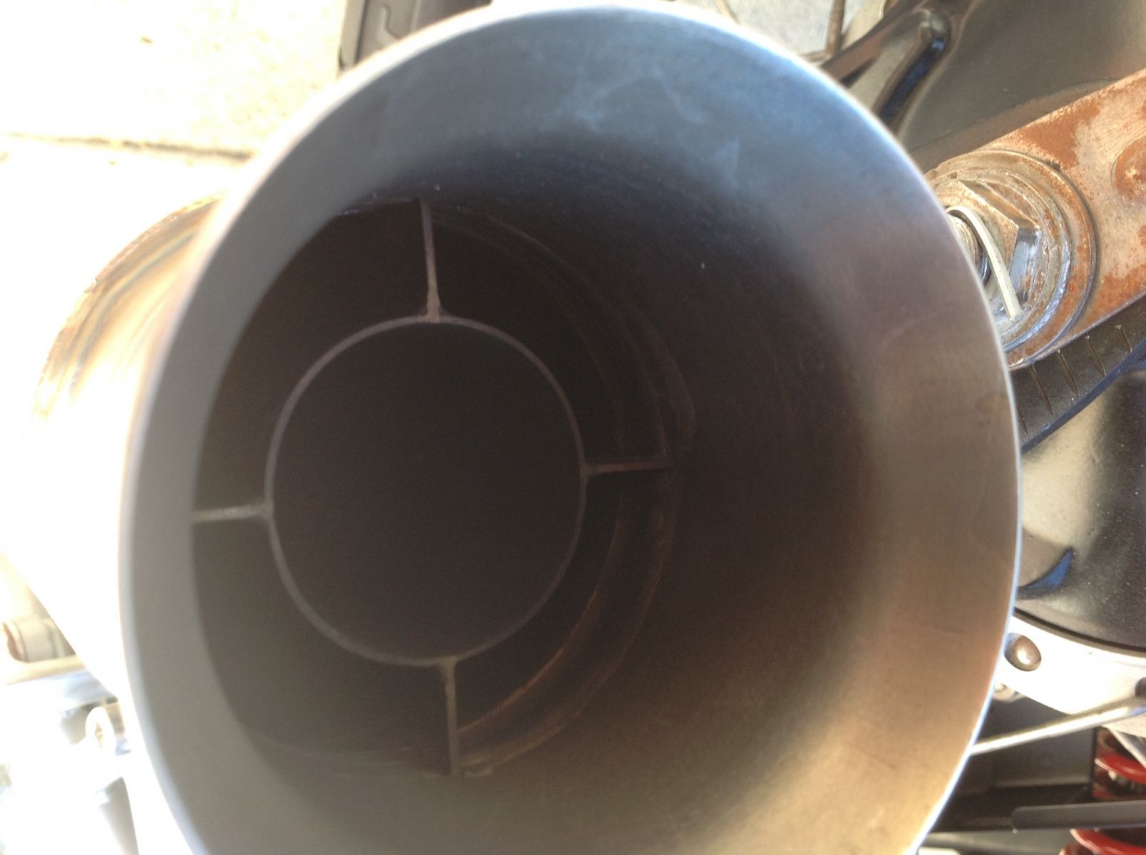

might remember this part. it's the inside baffling I used from a Harley exhaust I had on hand..
