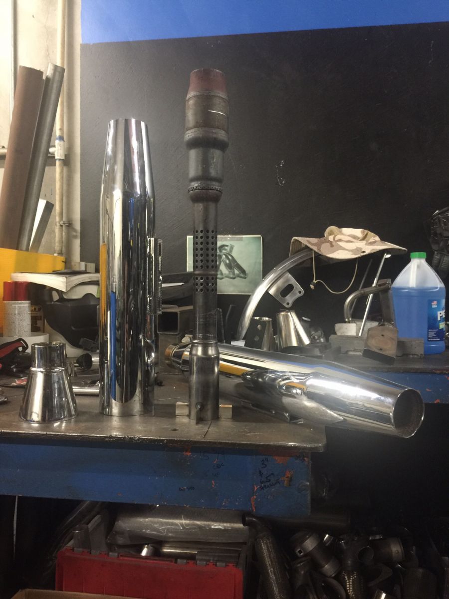

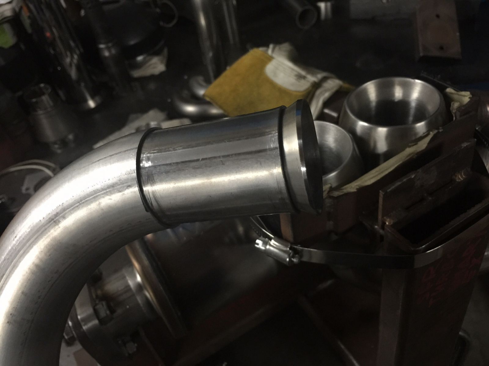

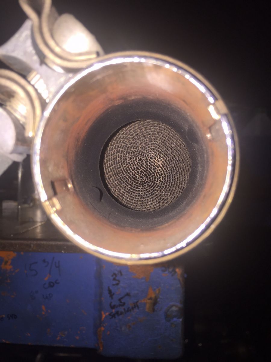

Thought finally can move on and start fab'ing up the headers. But of course ran into another problem material wise cause didn't think to check that the factory pipes are dual layered? I've got 1.75" bend .049 wall for the start but been the stockies are 1.5/8id. I had the right diameter bend in stock in a tight radius, but gave it a try aesthetically anyways. I have a couple ideas I'll post later. So moved onto finding a muffler to buy. idk why I'm having such a hard time with how I want the muffler to look? I went through so many pages of google?! :dry: Well I remembered that I had some stock Harley pipes for consumption and started operation on one.

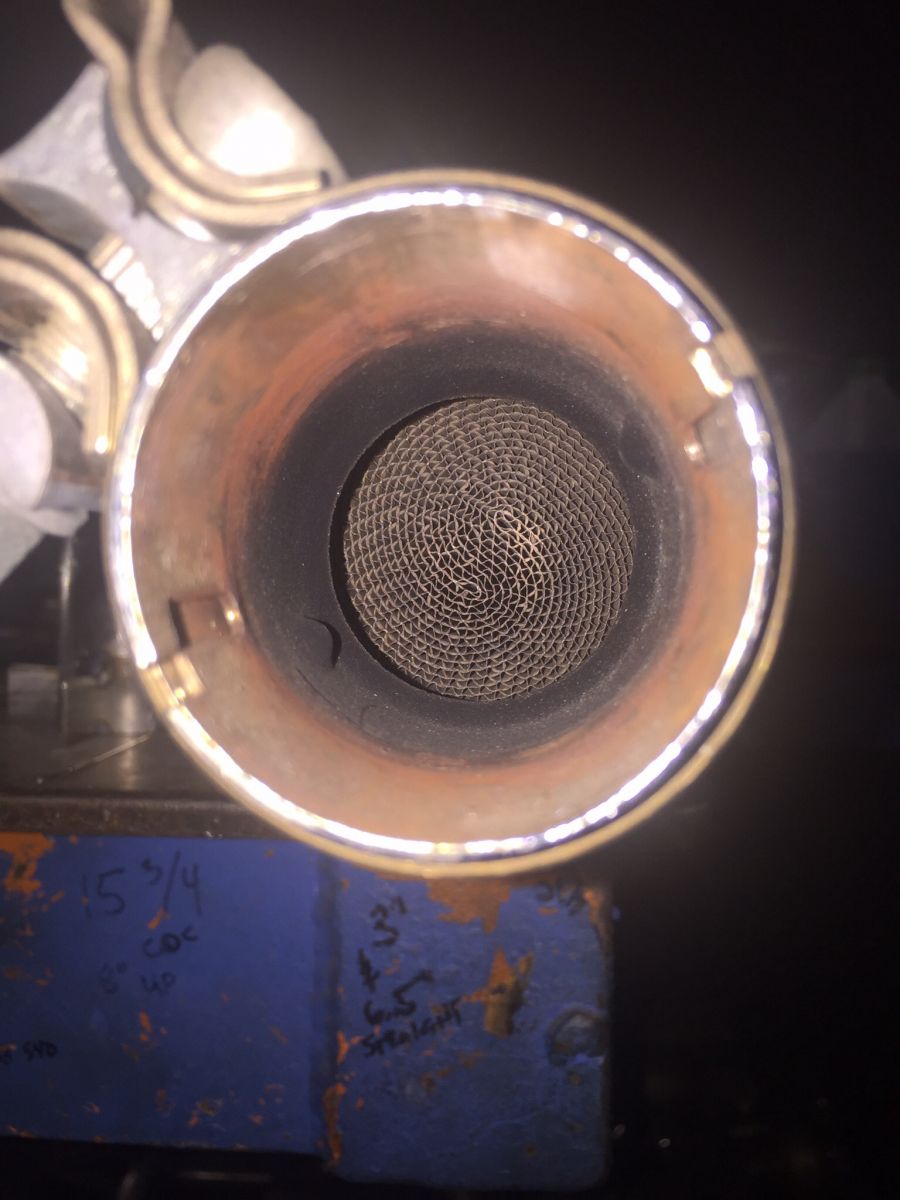

left side of pic is one of the mufflers guts minus the packing. right side is obvious. 3.5" can
Smallest and cutest catalytic convertor I've seen.
I've never actually built then used a muffler? Should be interesting.

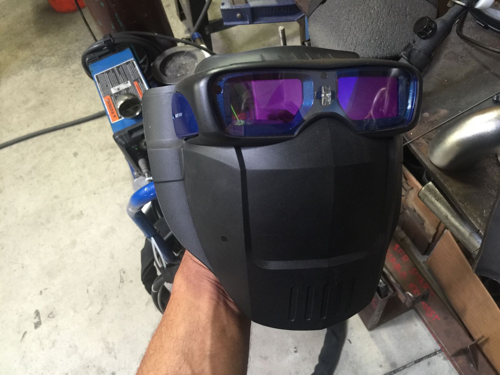

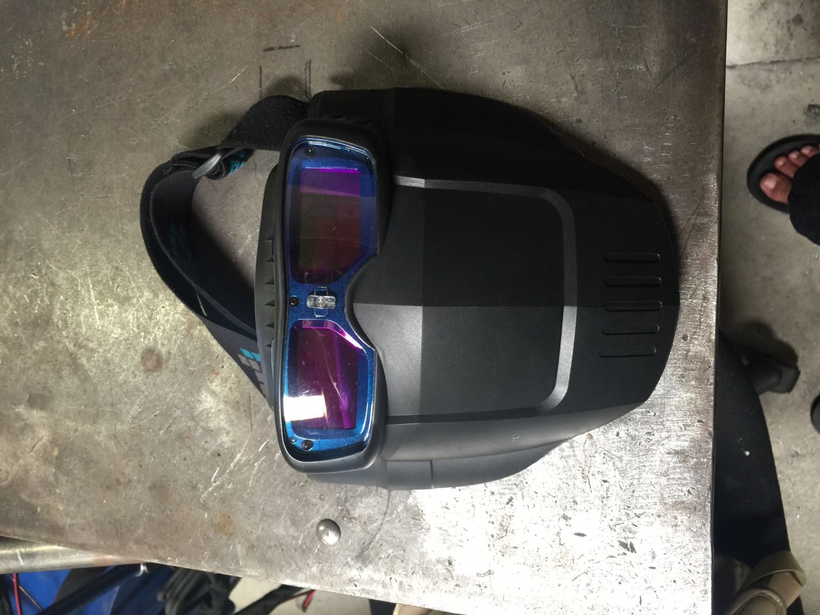

damn those welding goggles are cool.

I missed that post 3 weeks ago... been super busy lately... but not really getting anything done... how is that possible?
Anyway, bike looks great! Glad to hear you've been riding it and the rear brake is working flawless.
So are you getting close to 14v when revving it? I suppose you are if you're able to ride it around without issues.
Interesting looking mufflers. Do those 4 "wings" just keep it centered, or is there a baffle or something that attaches to them?

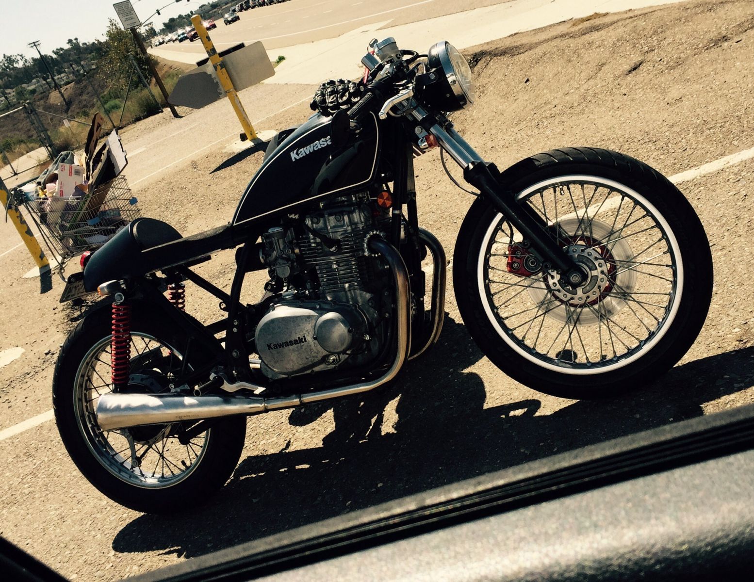

Oops :huh: . sorry Doc, the last pic was suppose to be one of me on the freeway that a friend took. Fat finger syndrome is to blame. On a side note, I was actually gonna post this to share with all the fellow fabricators on here. Bitchin goggles, Auto-darkening 5-11 and has an attachable facemask as to not get instant sunburns.
Lou, no worries, just glad there's more people that feel the same
. Thought I was alone in that category. :whistle:
Yup, I'm getting my voltage, finally and exactly as thought about those fins. I actually added those in cause originally the stock baffling ran the whole length to keep it center.

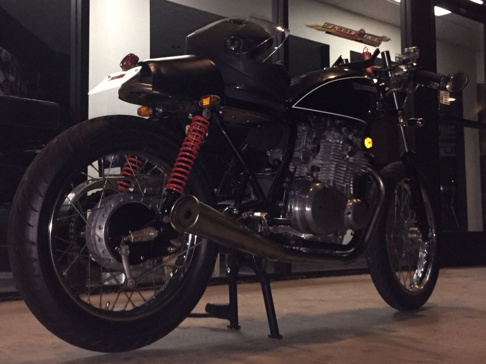

wire wheels look great i love mine ,they look so classic perfect for a cafe racer

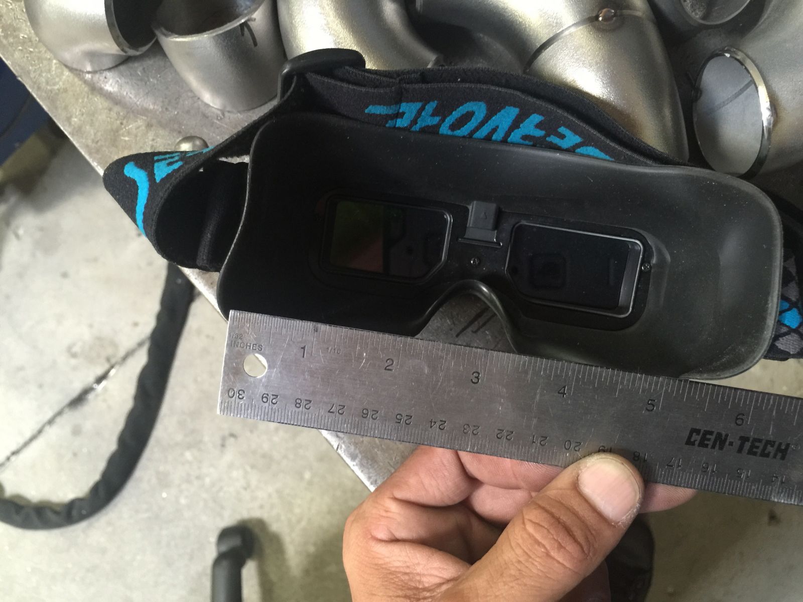

pretty sweet looking welding goggles.
do they fit well?
i always hated the way old time goggles felt so front heavy like they were trying to roll off your face.and then crappy little straps that wouldn't hold em on anyways.
i am still welding with an old jackson hood with a tinted lens.
i have auto darkening hoods but got tired of messing with them.
i had them act up and flash me a couple times(prolly low battery).
and just haven't revisited them .
i have seen some guys using the speedglass hoods and thought i would like to try one but the price of admission is a bit hard to swallow.
the ones you posted tho seem reasonable enough .
i wonder how well glasses fit under them???

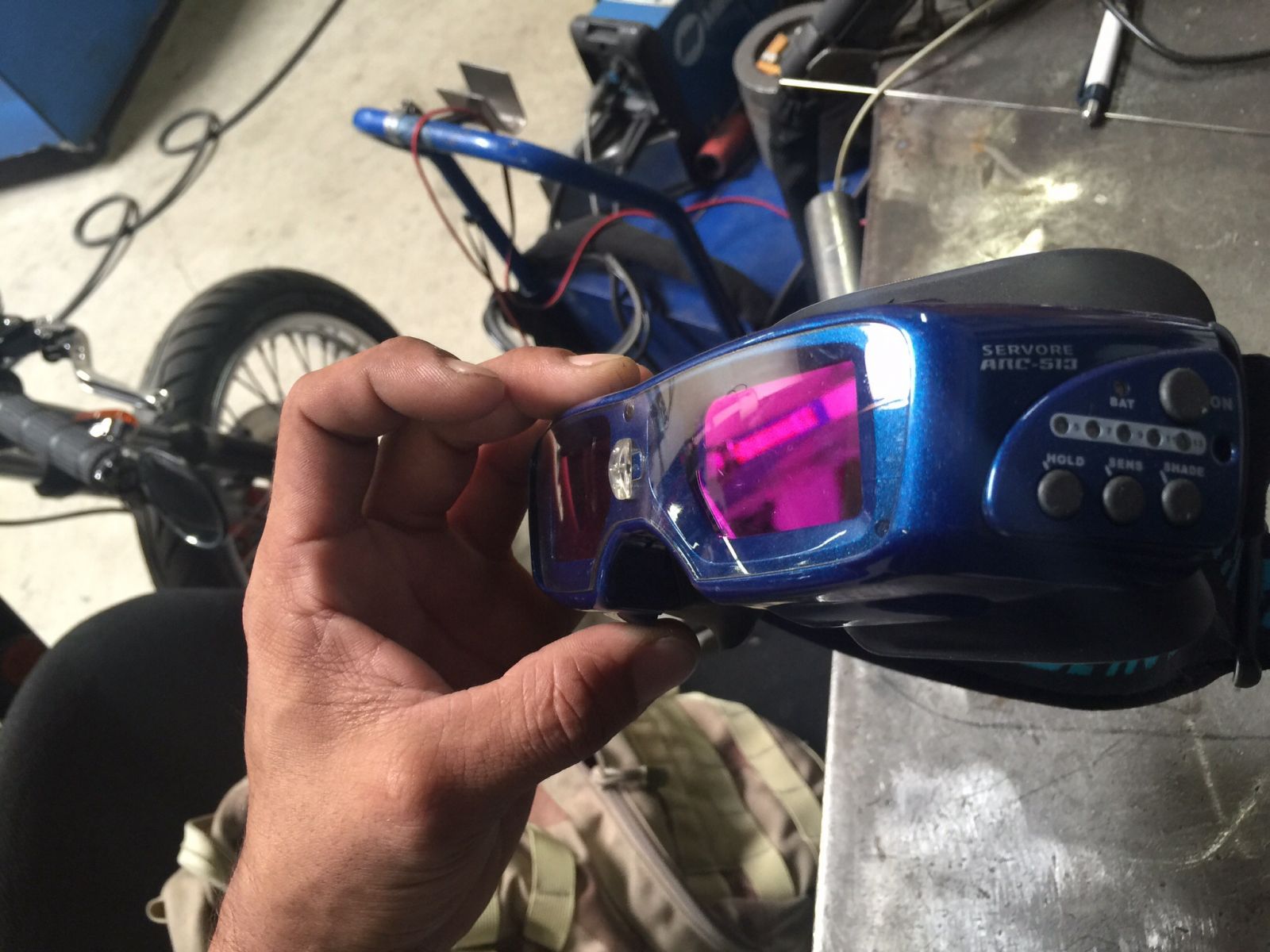

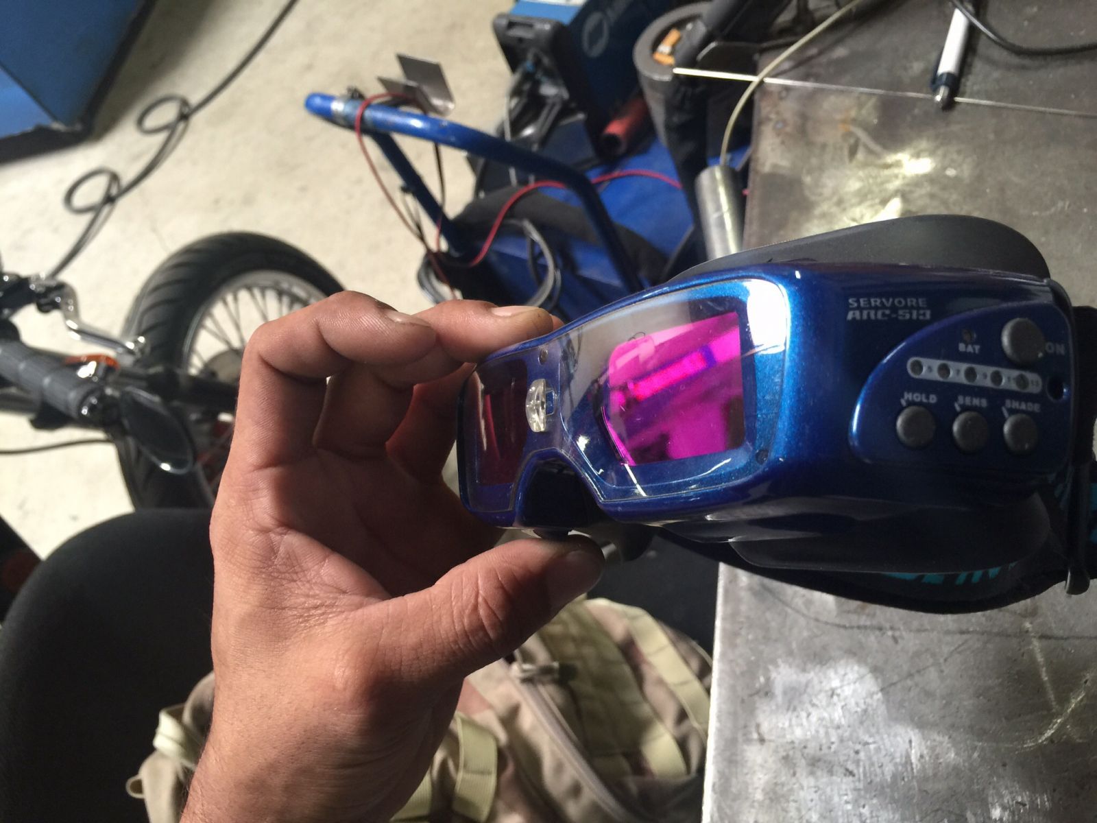

24 Sep 2015 11:20531blackbanshee wrote: pretty sweet looking welding goggles.
do they fit well?
I know exactly what you mean with the pricey speedglass hoods..smh. I sent my 9000 across the shop cause I couldn't get my face anywhere near where I needed to weld while doing an exhaust on this rock crawler late last year. I mean it did its job and dimmed, but I just couldn't fit my head, hood and torch all at the same time. So for the price of one speedglass, I got the Sevoré goggles and a savephace (same place that does paintball masks) AD hood.
The goggles actually fit pretty well. There's enough space between the goggles and your face for the small Rx focals.
and they look nice with face mask attachment also.
The only thing that I don't like when using them is (even though it's vented well enough) they occasionally fog up when I have them on too long. Physically the headband attaching hinges seem fragile as fuck!? and so far I haven't came up with any creative way to make it stronger.

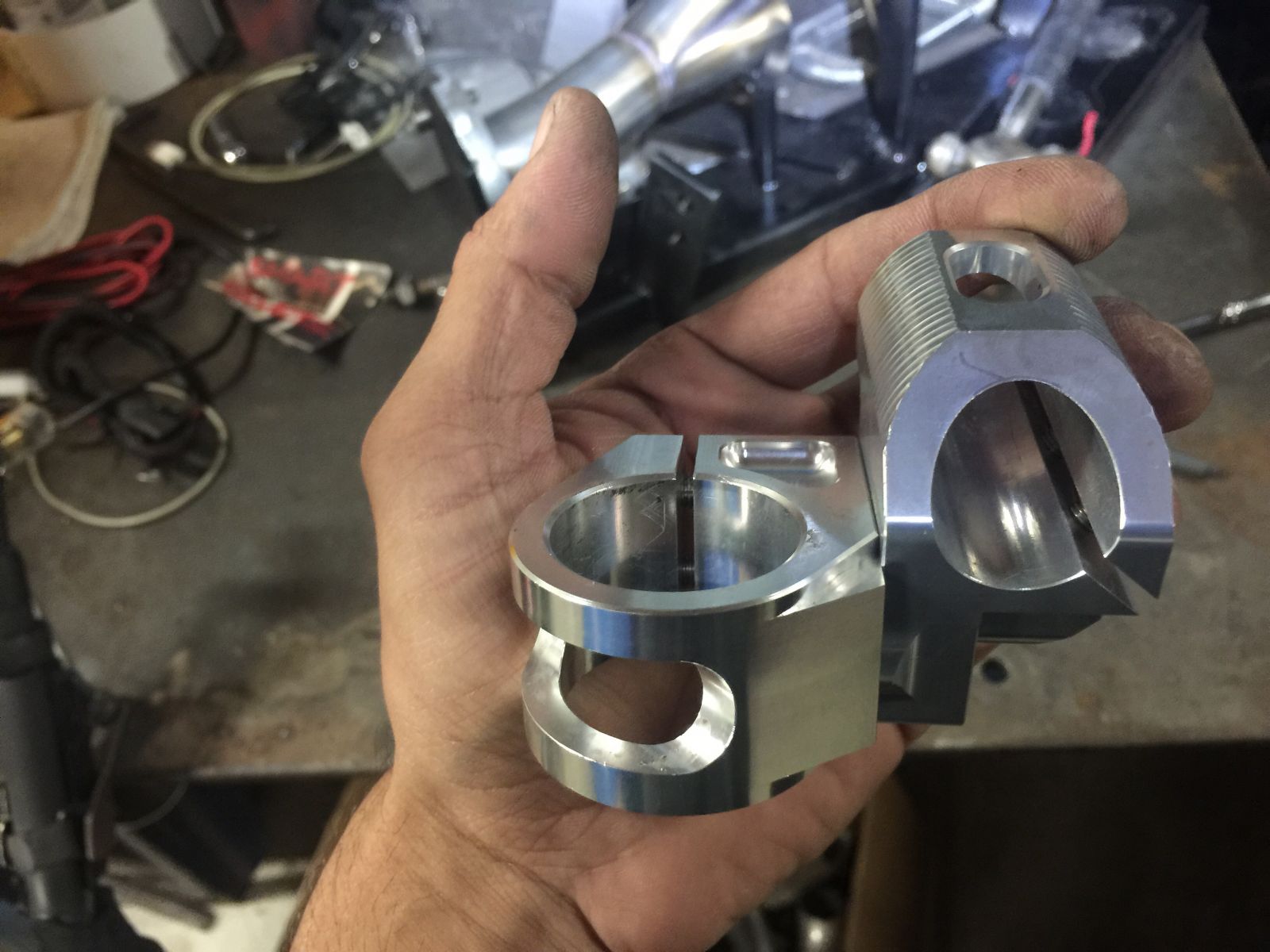

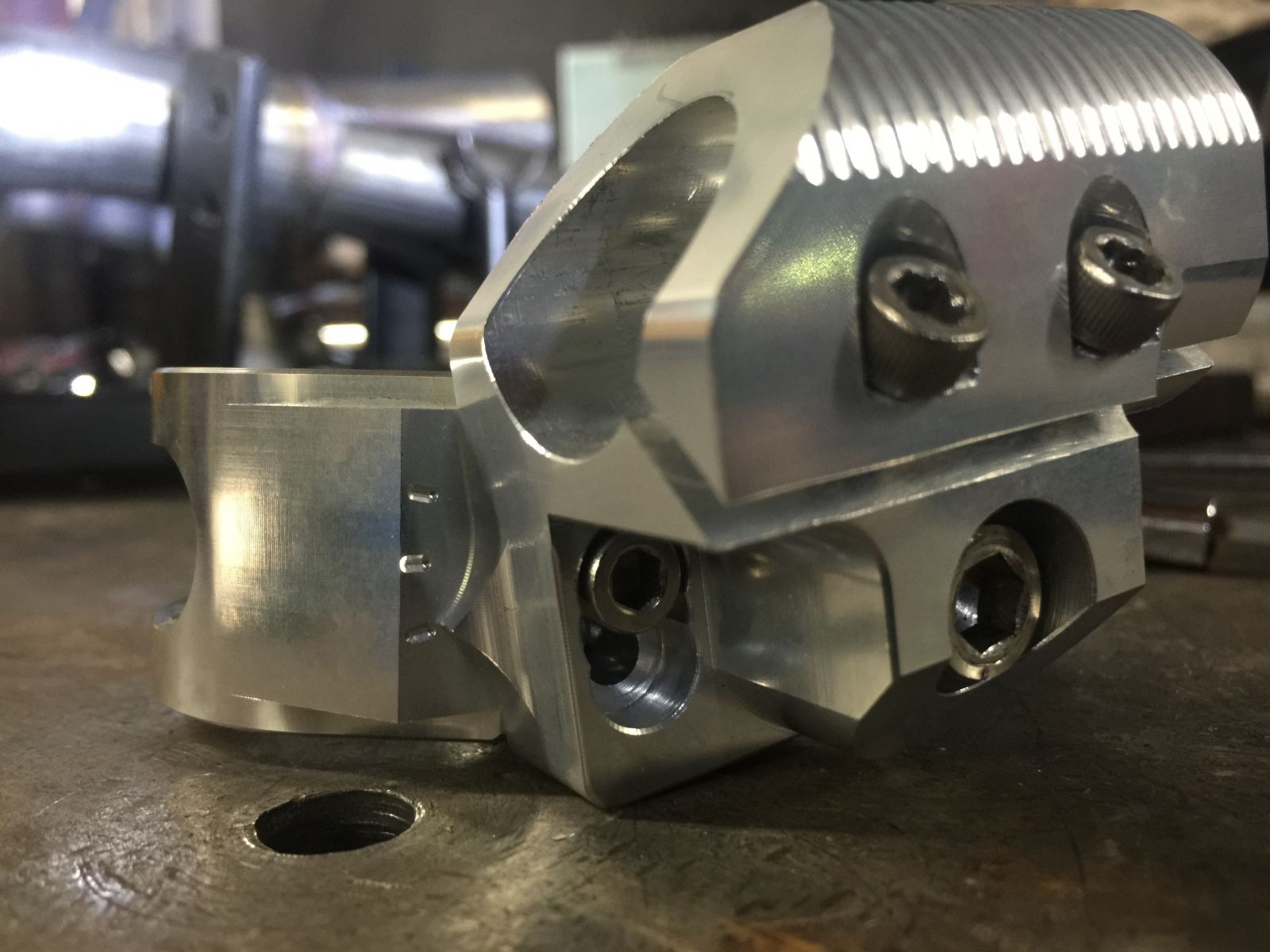

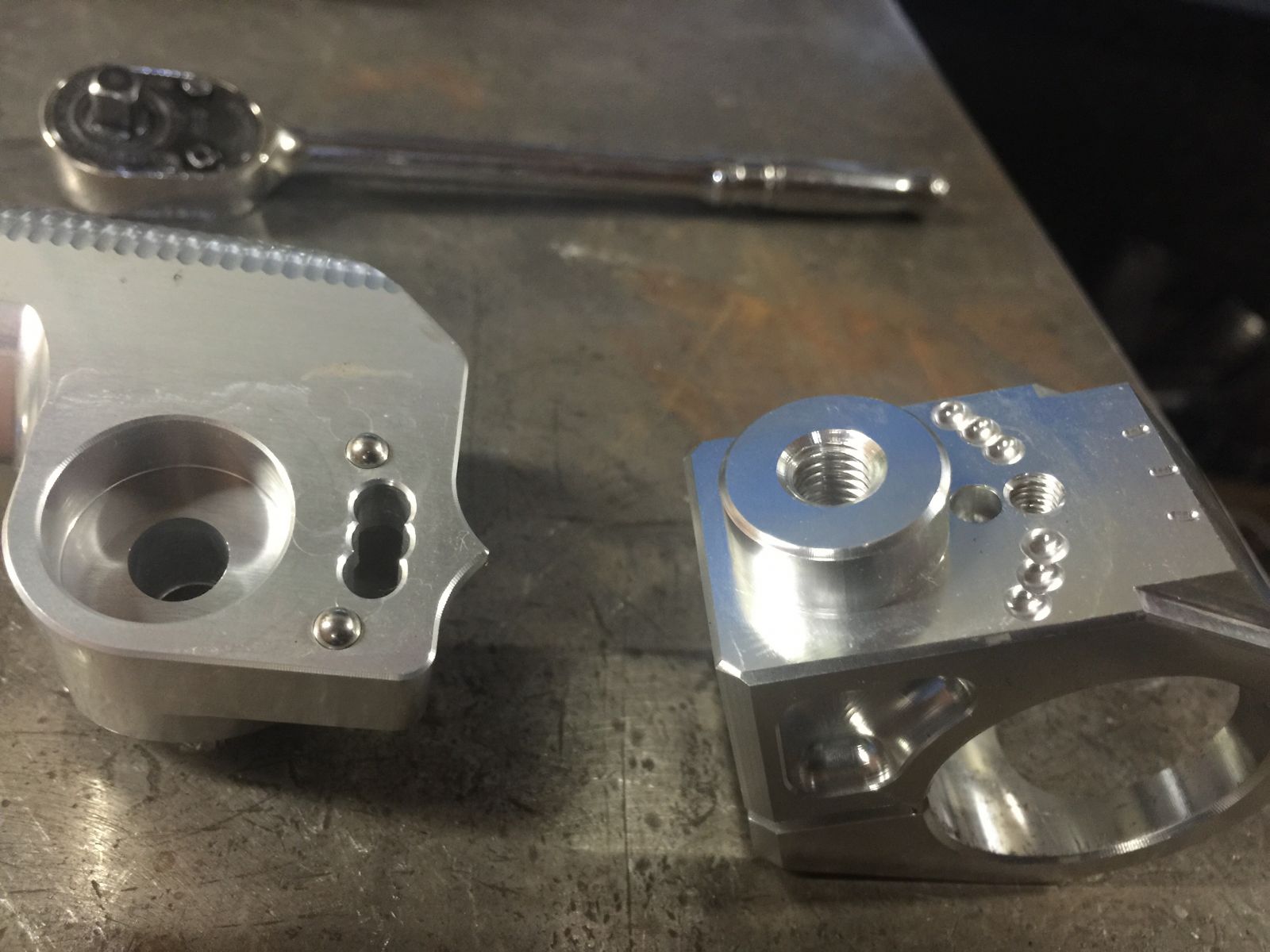

Oh I was suppose to put some pics up of my clip ons disassembled...soooo here's how it works.
another angle..
notice the 2 little ball bearings that sandwich between both pieces and lock into place to the correspondings holes.
ed

very trick adjustable clip on mounts there sir! :evil:

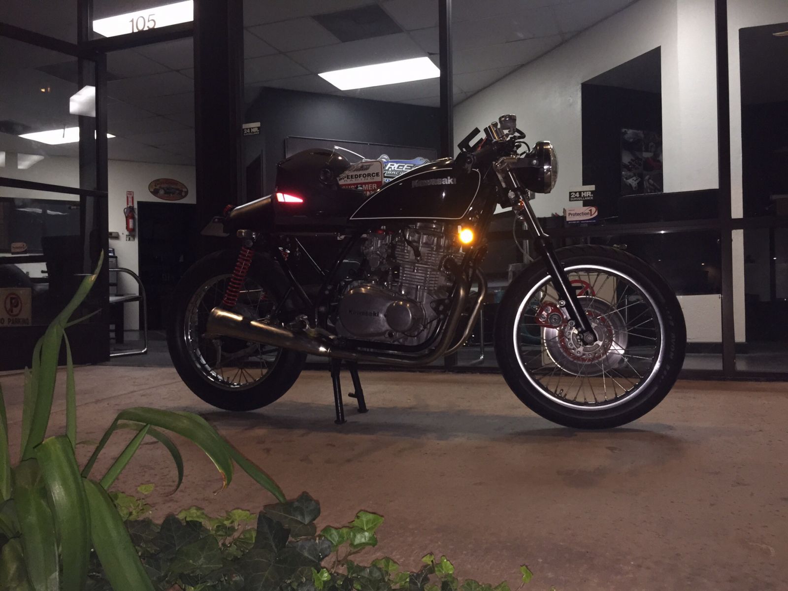

Back on topic..much needed update. Bike is running fantastic so far, I think I dodge a few bullets with my carbs and pods? Did a lot of plug chopping, I'm definitely not sizzlelean or thick sooty carbon rich. judging by the NGK plug color chart I have and the almighty google, I'd say on the rich side of normal. I also haven't had any back stabbing electrical problems the past 3 weeks. One little issue I had was a vibrating headlight. Thought I fixed it, but it came back with a vengeance! So swapped out the stock bucket and hl for a 7" H4 I had. The night after that swap, low beam goes out..smh. Thought the 7" looked too big anyways
. Took apart the stock one and noticed not much plastic left for a bushing in both pivot joints. Used a rubber grommet(ones to make holes in firewalls safe)on both holes...omfg! it's so peaceful now! I swear i almost wanted to cry on the freeway..hahaha! but now.... I can hear shit, like my chain is rubbing either on top close to the pivot of the swing arm or the foot of the center stand or maybe both?
I'll see in the morn.
Other than that, I have no regrets of how much I've spent yet alone the time I invested into this project, my very first motorcycle build, I'm lovin my KZ and the thumbs up I get on the freeway and compliments at stops. Best part is that I'm not even done with the bike yet!? I think my red springs are hypnotizing? lol..Couple nights ago decided to take a super scenic route home. Half way through, 2 crotch rockets and a converted DRZ zoom pass me. I was 10 over the posted limit. I'm sure 2 of the 3 riders were novices, since I was able to safely stay behind one of the riders R6. The supermoto must've been the experienced rider cause he was parked in the shopping center lot eating a burrito. they didn't believe me when I said it was a 440.
Late night..
Front..I gotta remember to take the side reflectors off before taking pics...lol

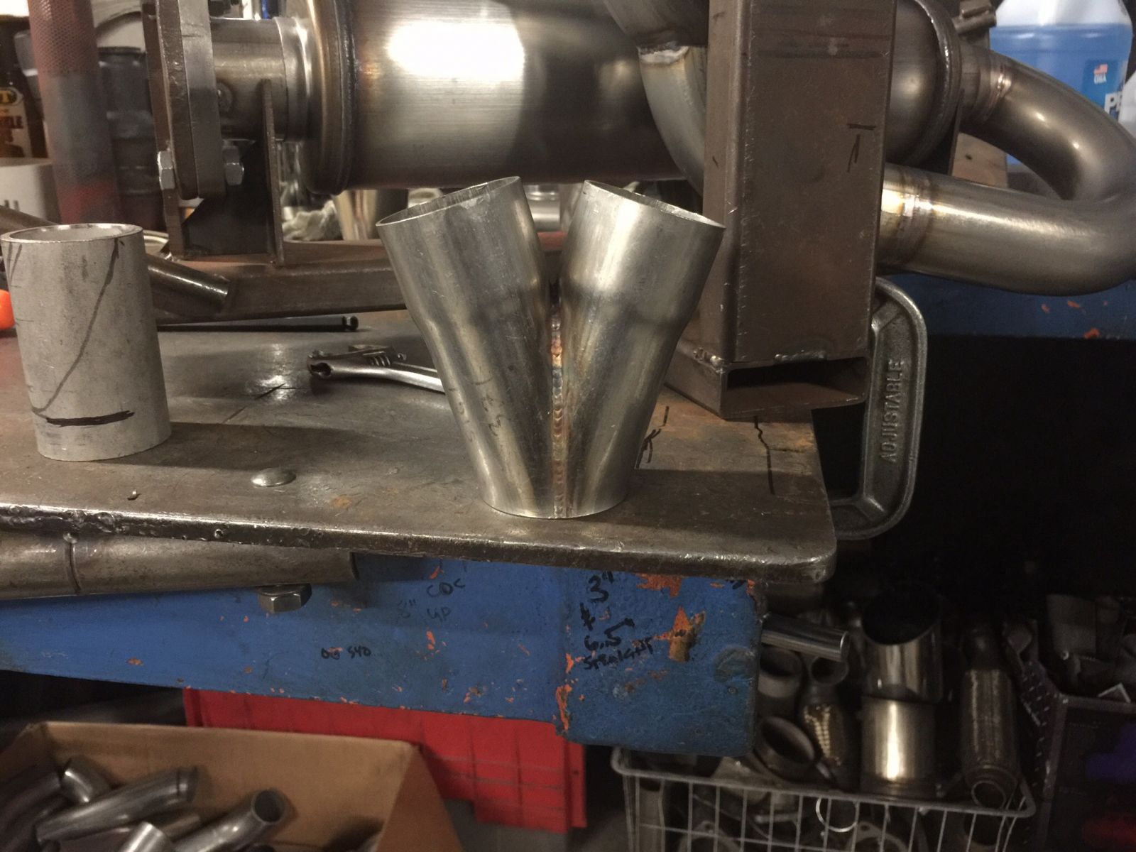

decided to do a single..so here's the merge I made..

Those clip ons and that merge are very clean!!! Jealous of your machine skills, mucho custom parts!!!!
