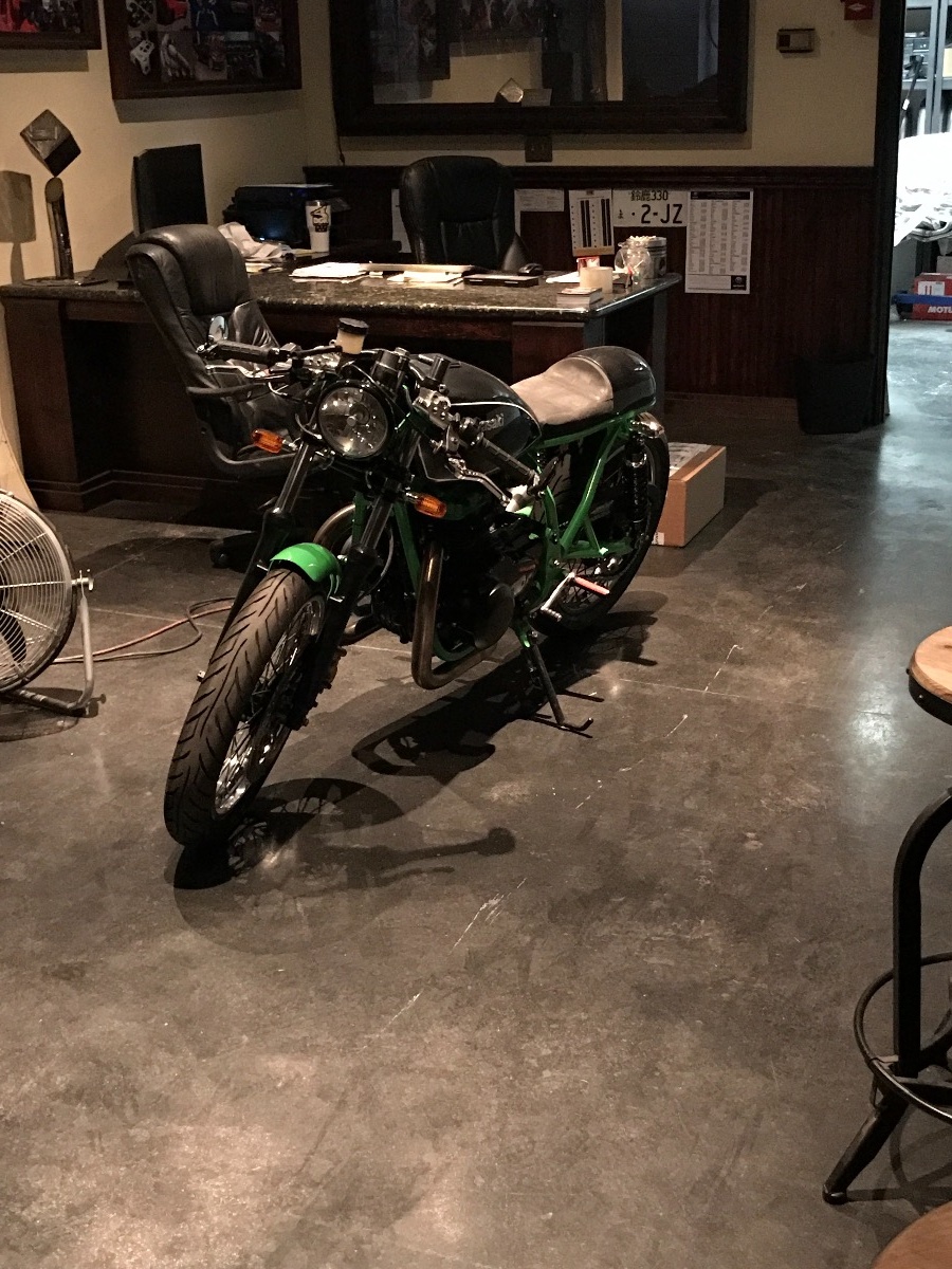

best parking at work. inside the office.

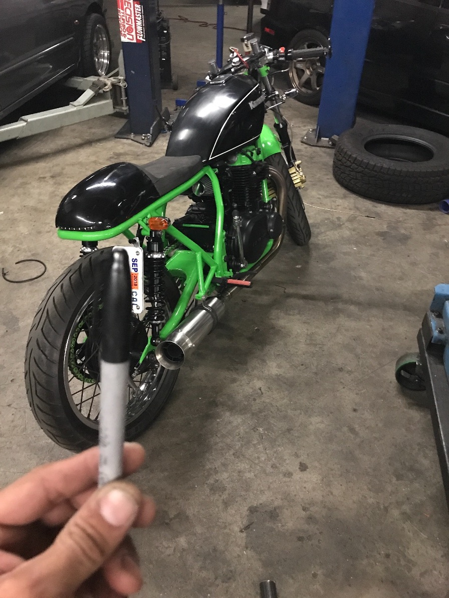

Tell me if you see the problem..lol

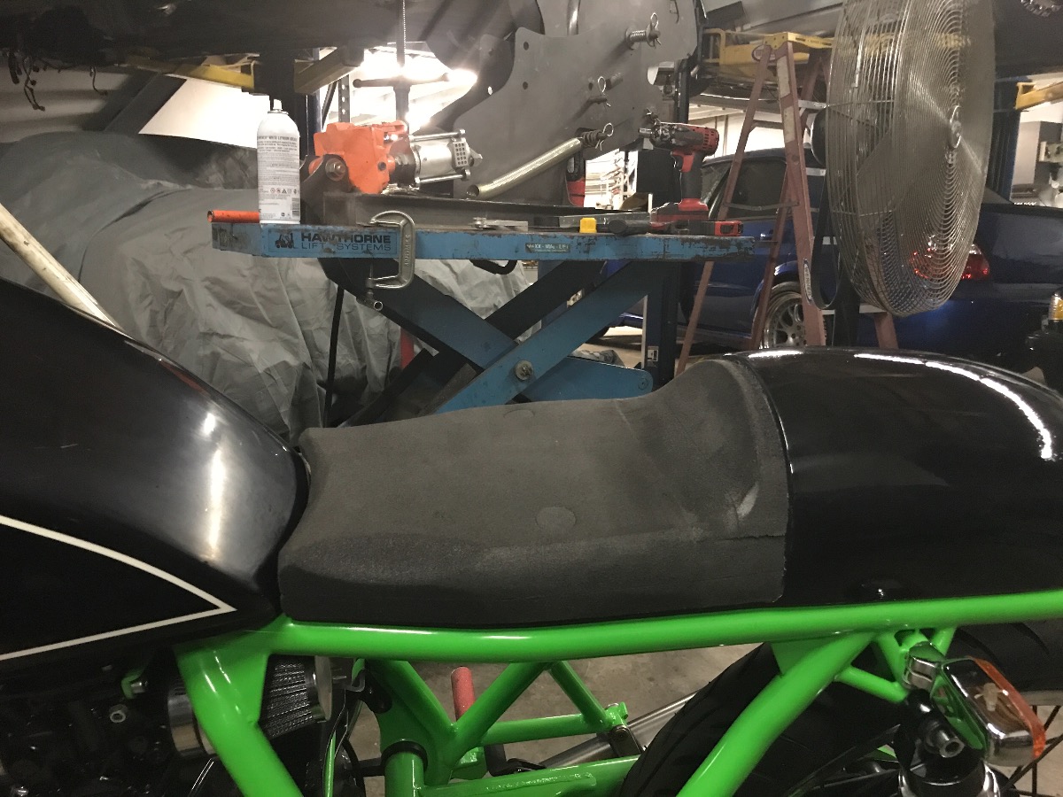

this foam i have is awesome for seat padding. original seat from day one, just added the little back riser to it.
Another shot of "what's wrong here?" oh and the front brakes work better than i anticipated.

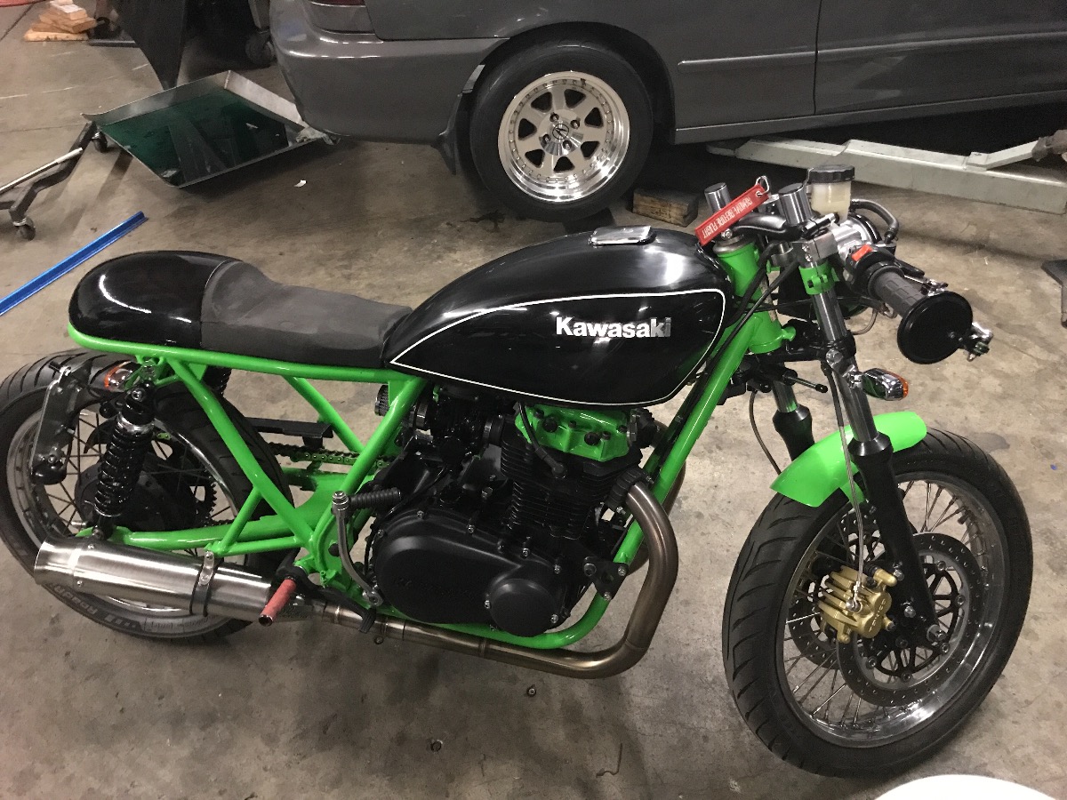

Got about 25 miles on her now. Gotta do an oil change and check/adjust the valves, clutch cable, drive chain comp test and check the sync of the carbs again then a plug chop. On the way to work this morn, I was getting some half throttle hesi underload, getting too much fuel there also felt like an intermittent misfire but didn't hear any popping or backfires from the carbs or exhaust. So as i got to the shop i pulled out my laser thermometer to get some temp readings, the right bank seemed to be running too cold (almost like it wasn't firing) so gotta look into that. But other than that, she ran and felt great! I was expecting to do an indo when applying the front brakes but they engaged nicely with a light squeeze. Can even hear the cross drills buzz pass the pads, so cool! hahaha. A more violent squeeze and yeah, it'll squat the front! had to test it a little.
