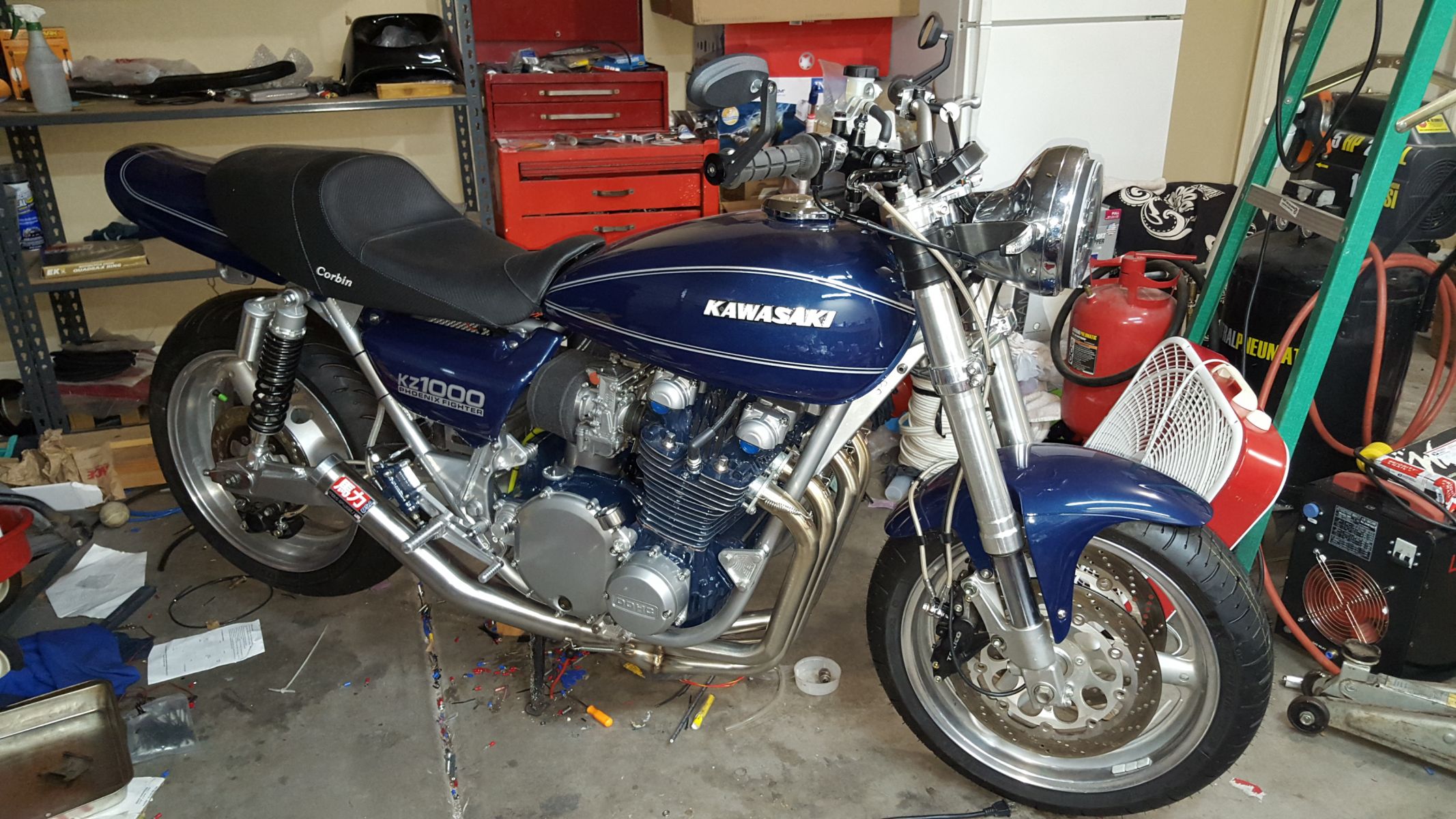

28 Nov 2015 16:18 - 28 Nov 2015 16:19Great info there! Do you know what your ratios were, and what they are now? Just curious....kaw-a-holic wrote:DoctoRot wrote: yeah the ratio of MC to caliper is super important.
www.vintagebrake.com/mastercylinder.htm
That article would have same me some money. Thank you for the info.

29 Nov 2015 05:0579MKII wrote:Great info there! Do you know what your ratios were, and what they are now? Just curious....kaw-a-holic wrote:DoctoRot wrote: yeah the ratio of MC to caliper is super important.
I would have to measure the caliper pistons to figure it out. The front brake MC is 14mm, its cast into the bottom of it.

That was supposed to be the hot set up. Mine is off a GPZ. It had duel binders, that's why I used it. Now I'm going to have to measure it unless the bore size is cast on the bottom. My brakes worked fine with the stock M/C but I read it was too small. If the fluid capacity is larger, it's not by much.

As it turns out the pistons on the 89 Tokico calipers have 2 different sizes. 30mm trail 34mm lead pistons. That averages out to 32mm, which according to the chart gives me 10.45:1 ratio, not even close to the sweet spot. This is the stock setup for an 89 GSXR 75. What is not mentioned in the article is the weight of the vehicle the brakes are on. The GSXR has a dry weight of 429 lbs, my 77 KZ has an approximate dry weight of 525 lbs. If I am lucky I shaved 25 lbs. with the front and rear end swap. Right now all I can do is try the setup I have now and see how I like it.

Very nice build! I see a "BOTM" candidate! Patience pays off! Love the 2 tone theme. Blue engine stands out with the shaved fins!
I did not go back and see the build yet, but, are the aluminum parts, engine covers painted or powder coated? Same with frame?
I have an idea (opinion) get another set of tank emblems and paint them the same silver.
Very nice! This will turn some heads!
Re: Phoenix Fighter
29 Nov 2015 06:24
I was thinking some pin stripes on the front fender too to break it up a little. Didn't want to say anything and seem like I was trying to pick it apart. I'd know that bike anywhere. :woohoo:

29 Nov 2015 09:54 - 29 Nov 2015 09:54Unfortunately if you have never gone down this road it is a bit of a guessing game, but that should get you in the ball park. Mike also mentions "Disc and wheel diameters, as well as hand lever ratios, must be considered." Also you can give him a ring, He is very knowledgeable and helpful. He helped me with my brake setup for my 1000 project; and he had a very reasonable deal on a brembo MC for me.kaw-a-holic wrote: As it turns out the pistons on the 89 Tokico calipers have 2 different sizes. 30mm trail 34mm lead pistons. That averages out to 32mm, which according to the chart gives me 10.45:1 ratio, not even close to the sweet spot. This is the stock setup for an 89 GSXR 75. What is not mentioned in the article is the weight of the vehicle the brakes are on. The GSXR has a dry weight of 429 lbs, my 77 KZ has an approximate dry weight of 525 lbs. If I am lucky I shaved 25 lbs. with the front and rear end swap. Right now all I can do is try the setup I have now and see how I like it.

29 Nov 2015 20:26z1kzonly wrote: Very nice build! I see a "BOTM" candidate! Patience pays off! Love the 2 tone theme. Blue engine stands out with the shaved fins!
They are powder coated. What I picked was a color called Almost Chrome. The powder coater said he hated the color. I advised him that I did not expect it to be chrome rather semi-polished aluminum. This is not it. I would have made him redo it but at the time I thought I was still going to be able to get the bike together for the Rally in Colorado. Had I wanted silver I would have done metallic silver. I powder coated them so I would not have to polish them all the time. I will have to think about the emblems.

29 Nov 2015 20:27DoctoRot wrote:Unfortunately if you have never gone down this road it is a bit of a guessing game, but that should get you in the ball park. Mike also mentions "Disc and wheel diameters, as well as hand lever ratios, must be considered." Also you can give him a ring, He is very knowledgeable and helpful. He helped me with my brake setup for my 1000 project; and he had a very reasonable deal on a brembo MC for me.kaw-a-holic wrote: As it turns out the pistons on the 89 Tokico calipers have 2 different sizes. 30mm trail 34mm lead pistons. That averages out to 32mm, which according to the chart gives me 10.45:1 ratio, not even close to the sweet spot. This is the stock setup for an 89 GSXR 75. What is not mentioned in the article is the weight of the vehicle the brakes are on. The GSXR has a dry weight of 429 lbs, my 77 KZ has an approximate dry weight of 525 lbs. If I am lucky I shaved 25 lbs. with the front and rear end swap. Right now all I can do is try the setup I have now and see how I like it.
Good to know, thanks Doc!

I was thinking what you have on the tail. Hardly anything just to break it up a little. It looks fine now and those brakes, massive. :woohoo:

30 Nov 2015 06:35swest wrote: I was thinking what you have on the tail. Hardly anything just to break it up a little. It looks fine now and those brakes, massive. :woohoo:
Yes the brakes should be a vast improvement over stock.
I plan on repainting in a couple of years. As we all know, these bikes are never "done".
