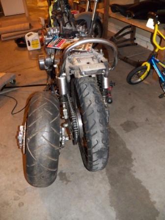

It still hurts a little to look at her this way
Like the Phoenix which rises from the ashes for rebirth, so will the Phoenix Fighter!
That resurrection began today.

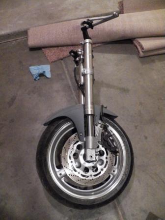

99 Gixxer with USD forks
98 Gixxer swinger
A quick comparison :woohoo:
I'm so flipping excited right now!
I will get some mock up pictures up soon! There is so much work to be done in the next 6 months so she is ready for the rally in August.

Looks like a great build your starting. After my crash my poor 650 sat in the corner of my garage for about 1 year before I could work on her. Hope to see you at the rally, Good luck.

Sorry to see your bike in such sad shape. Just in case you didn't know, the front end is either a Gsxr750W ('94-95) or a Gsxr1100 which stopped being made in 1998. And the swingarm is a Gs1100E item with a Gsxr7500/1100 rim.

StreetfighterKz wrote: Sorry to see your bike in such sad shape. Just in case you didn't know, the front end is either a Gsxr750W ('94-95) or a Gsxr1100 which stopped being made in 1998. And the swingarm is a Gs1100E item with a Gsxr7500/1100 rim.
Later, Doug
Doug thank you for the information I did not know I don't know how you know all that information just by looking at them. I bought the front and the two wheels from a salvage yard was on a drag bike project. they told me they were 99 forks I didn't know how to identify them. the swingarm I knew about I bought that separately off of ebay a few months ago. Again thanks for the information though. unfortunately that takes me out of the AllBalls bearing swap opportunity.

if front end is from a 1100 ...look just like mine....bearing conversion will work
