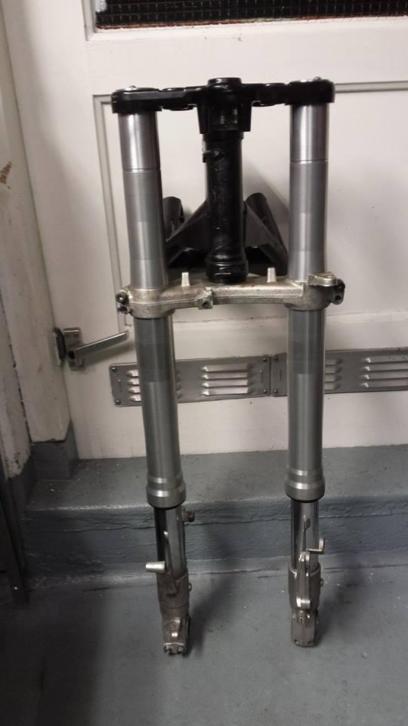

kaw-a-holic wrote: That would be great I am using 1998 Suzuki GSXR 750 Showa forks.
Double check your years before spending $$.. '96+ Gsxr750's have a 25mm axle, no speedo drive and flat brake rotors. I think you have a '93-95 Gsxr750 front end.
Later, Doug
1978 z1000 Streetfighter
1976 z900 ‘Stripfighter
1978 z1000 w/RC Turbo
1979 z650 Resto-Mod
1983 Gpz750 Resto-Mod
2018 Z900RS
  • StreetfighterKz
  • StreetfighterKz's Avatar
  • Posts: 1667
  • Thanks: 249
Re: Phoenix Fighter
07 Dec 2015 08:08
#702285
Just went back through your thread. Measure the OD of the upper fork tubes at the top and bottom clamps. It's possible you have a Gsxr1100 front end. The Gsxr750 measures 50/54 and the Gsxr1100 is 52/56 I think.
