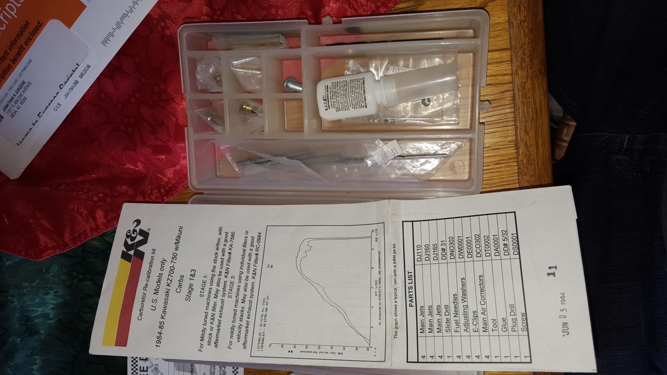

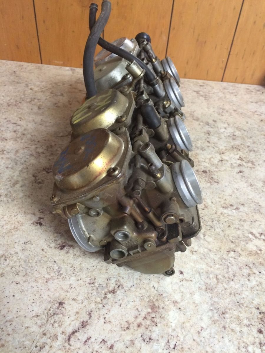

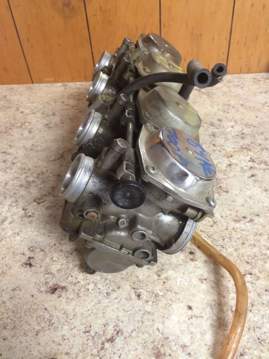

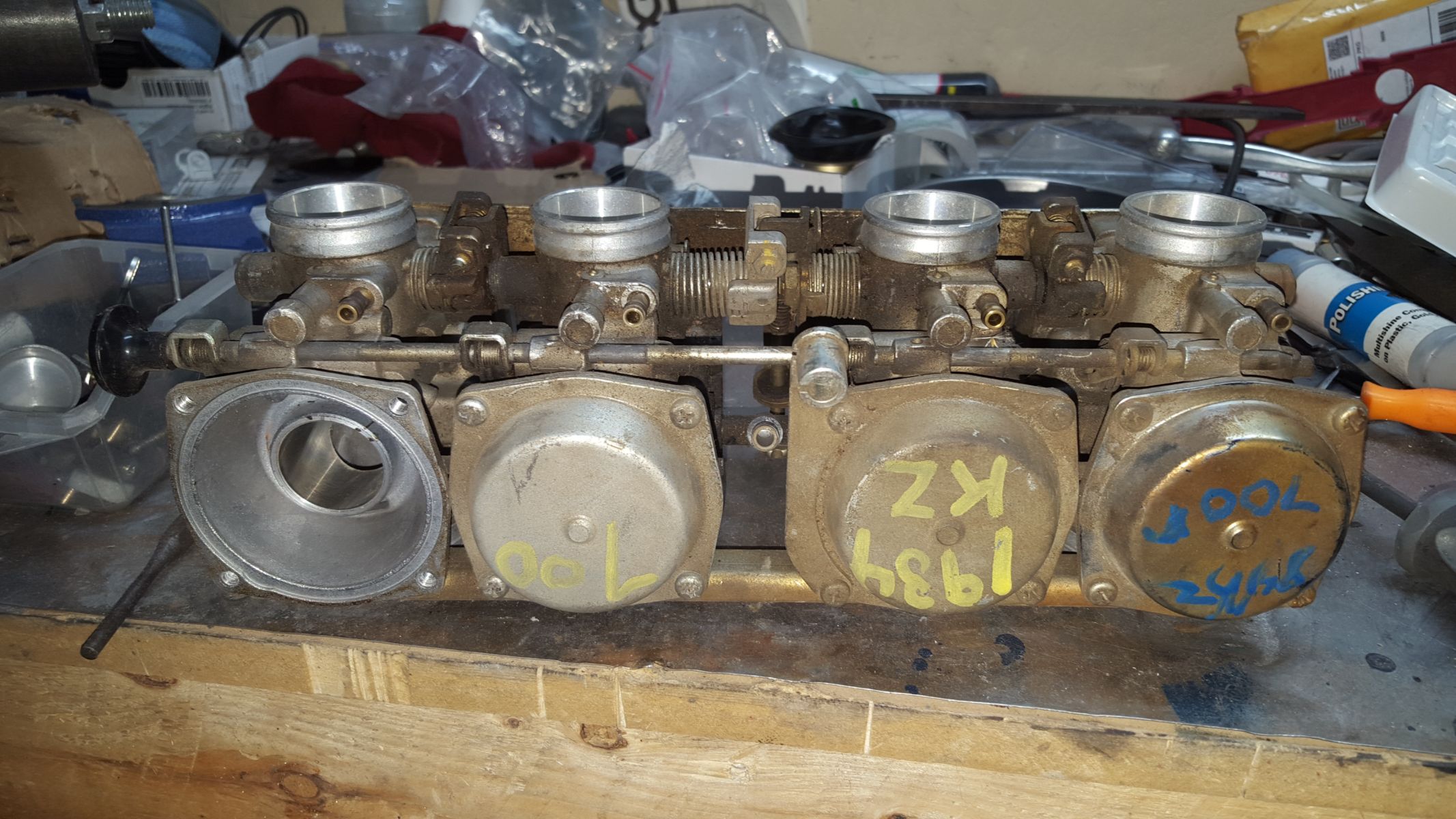

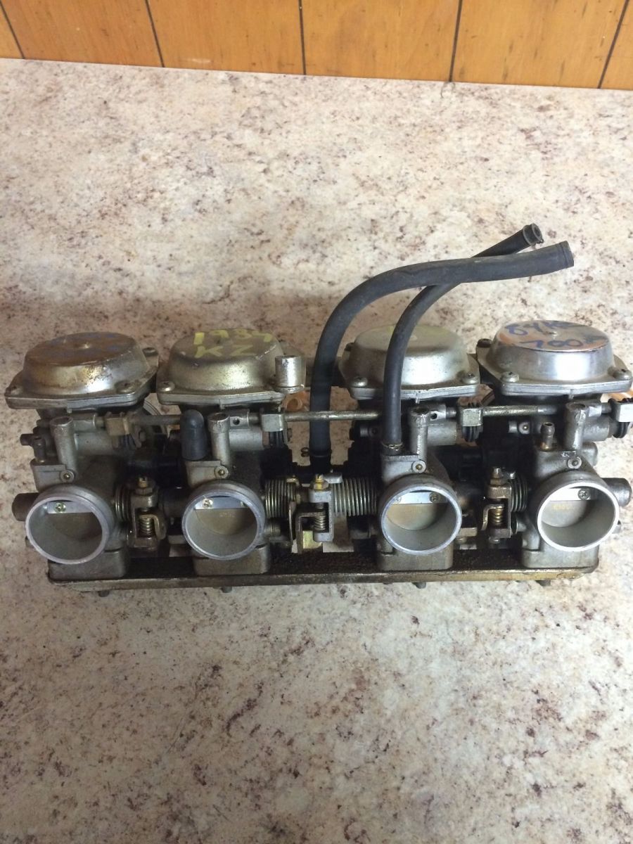

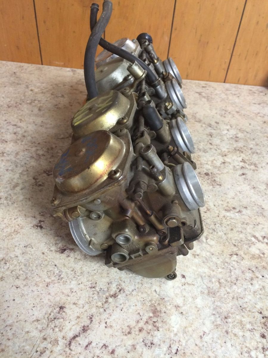

I decided to try some different carbs on the bike. The Mikuni RS36's are to big. After talking to some local guys and Wired George I decided to try some Mikuni BS34's with a stage 3 jet kit from K&N.
Old school Dynojet kit
Still waiting on the carbs but here are some pics
I'm going to have them ultrasonically cleaned then I will get the kits in and once that is done.

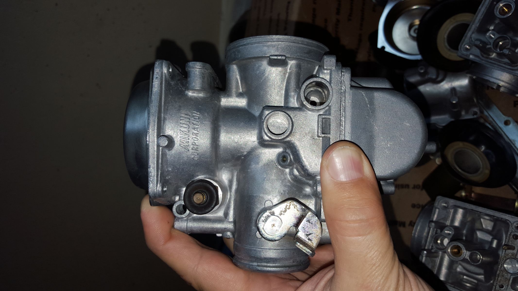

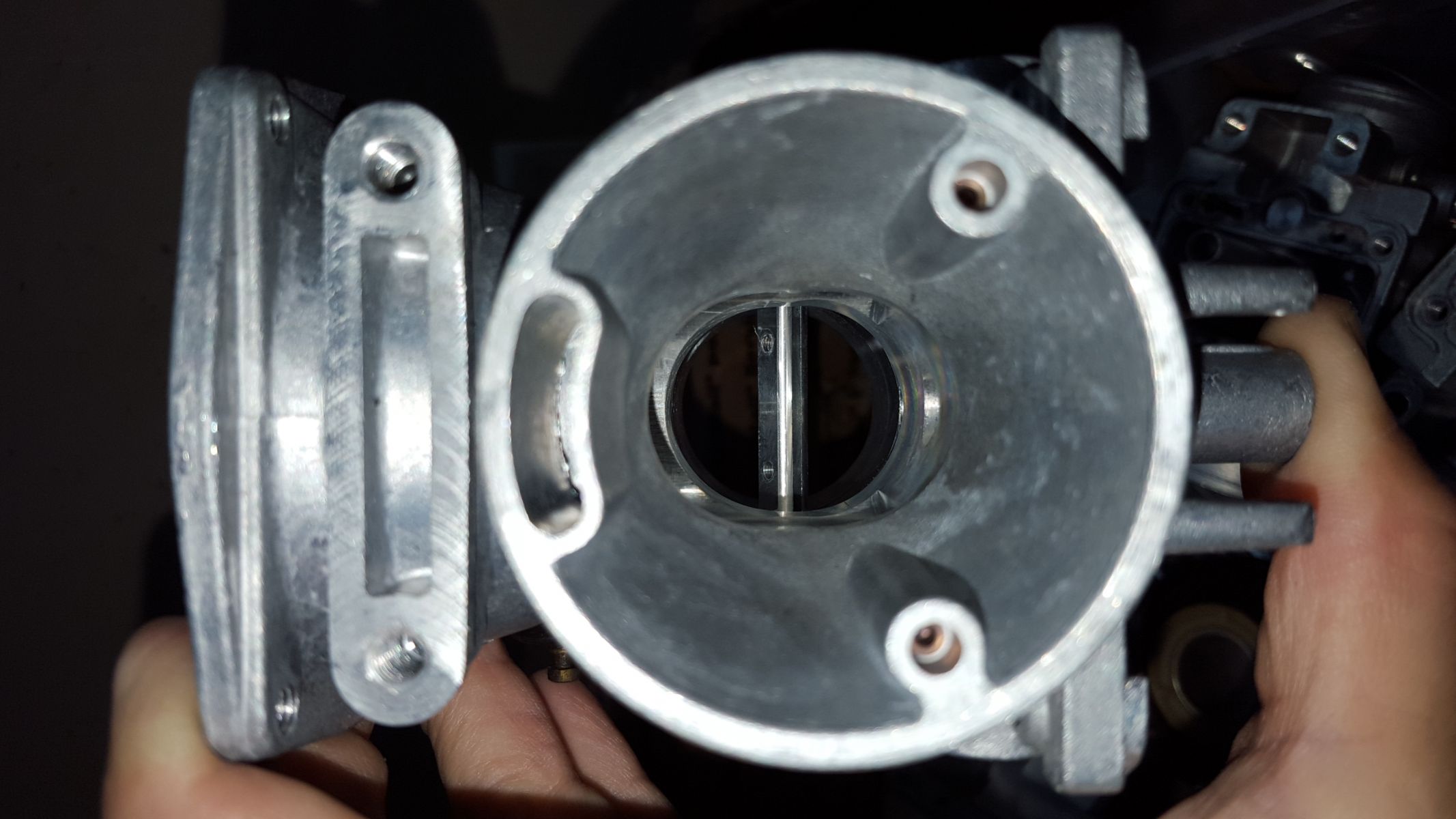

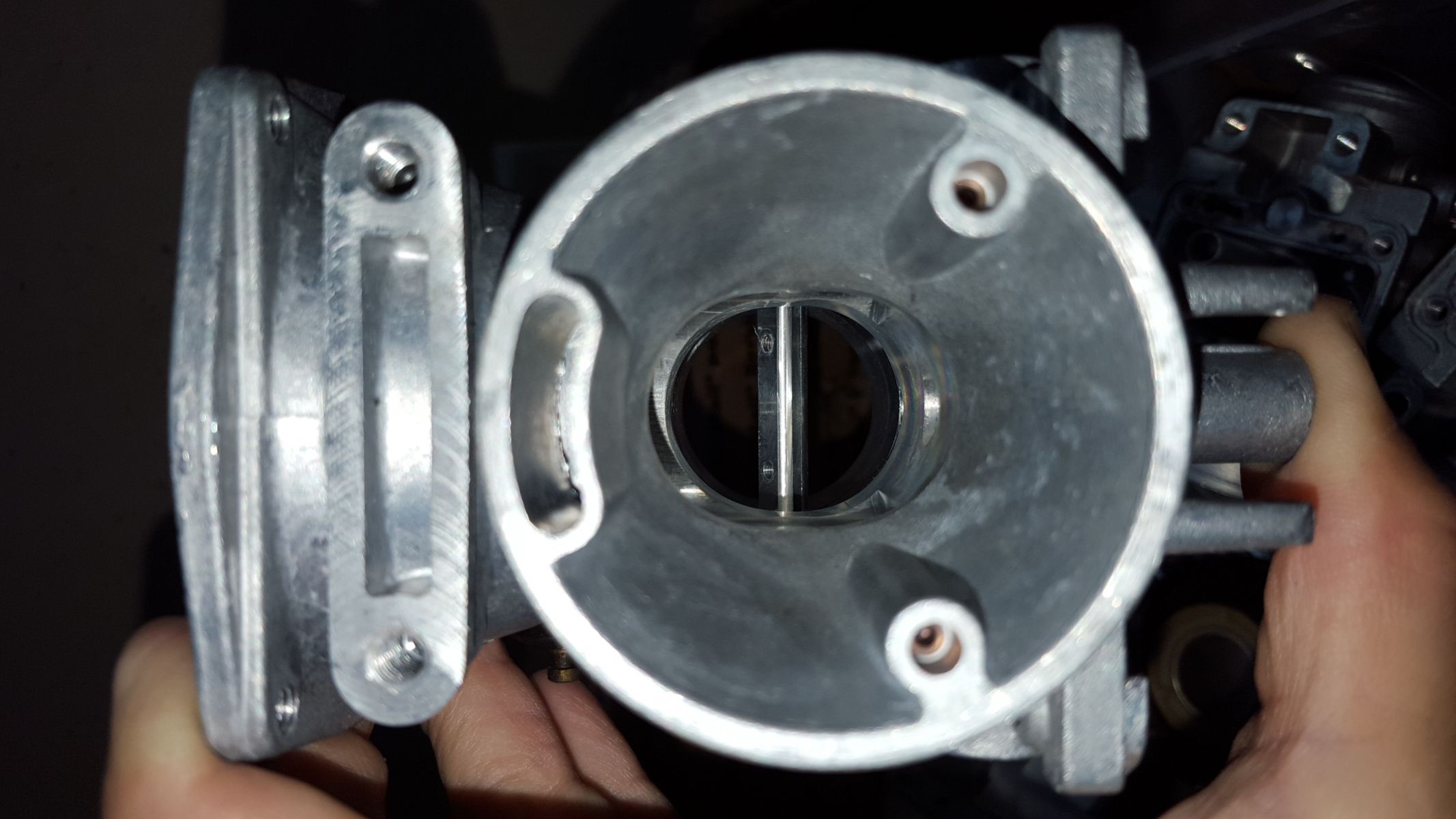

Ultrasonic cleaning kicks ass
BEFORE
AFTER
I will document the the Dynajet process for those that have never done one before.
BEFORE
AFTER
