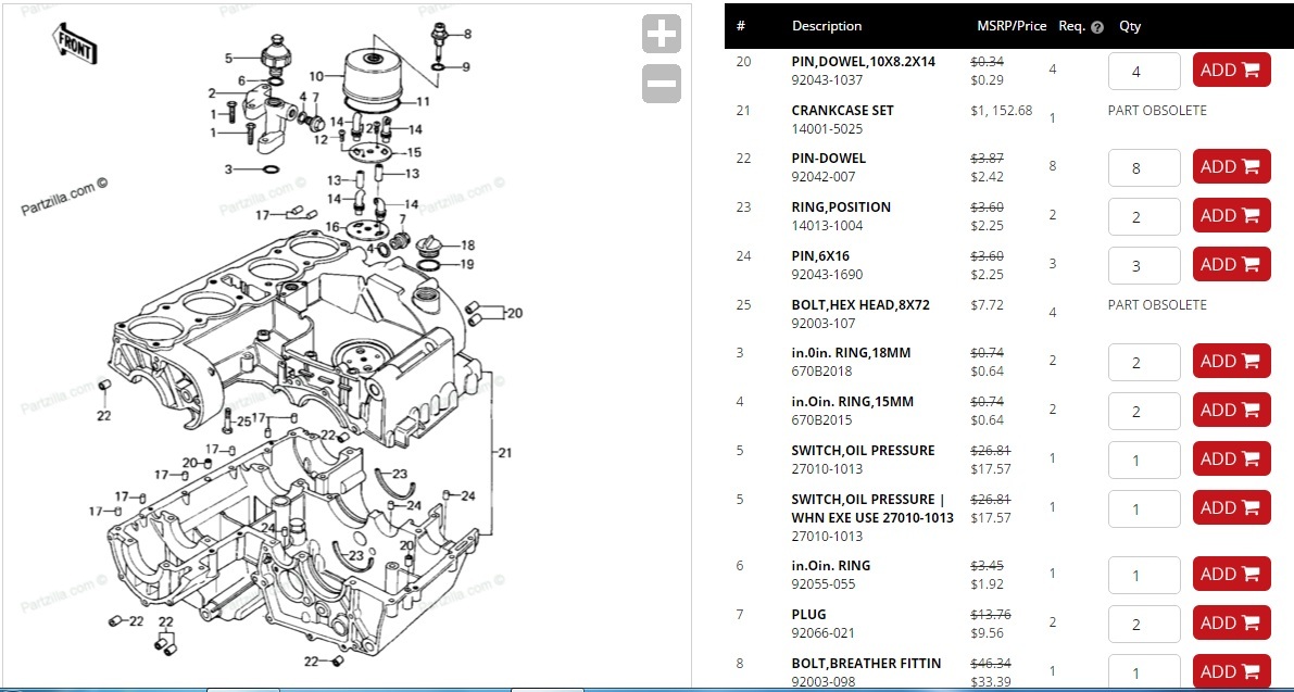

18 Jan 2016 16:40 - 18 Jan 2016 16:46kaw-a-holic wrote: That's a good question Steve, I don't think mine are the right diameter. If they were they probably wouldn't leak. Well technically only the lower one leaks. I picked up a metric o-ring kit at the parts store. I'm hoping there is one that will work better.
O RING,18MM
670B2018
Qty - 2
(from KZ1000 A2 parts diagram, #3)

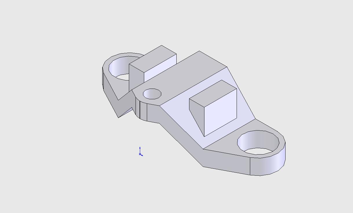

Got a design together for the custom triple my brother and I are designing. I have already made changes to this drawing as well.

The only one you have to lower is the top one? Can you use the plastic one to make a mold and cast it in aluminum? Looks good.

Good concept.
Need to build up bosses for pinch bolts at tubes and stem

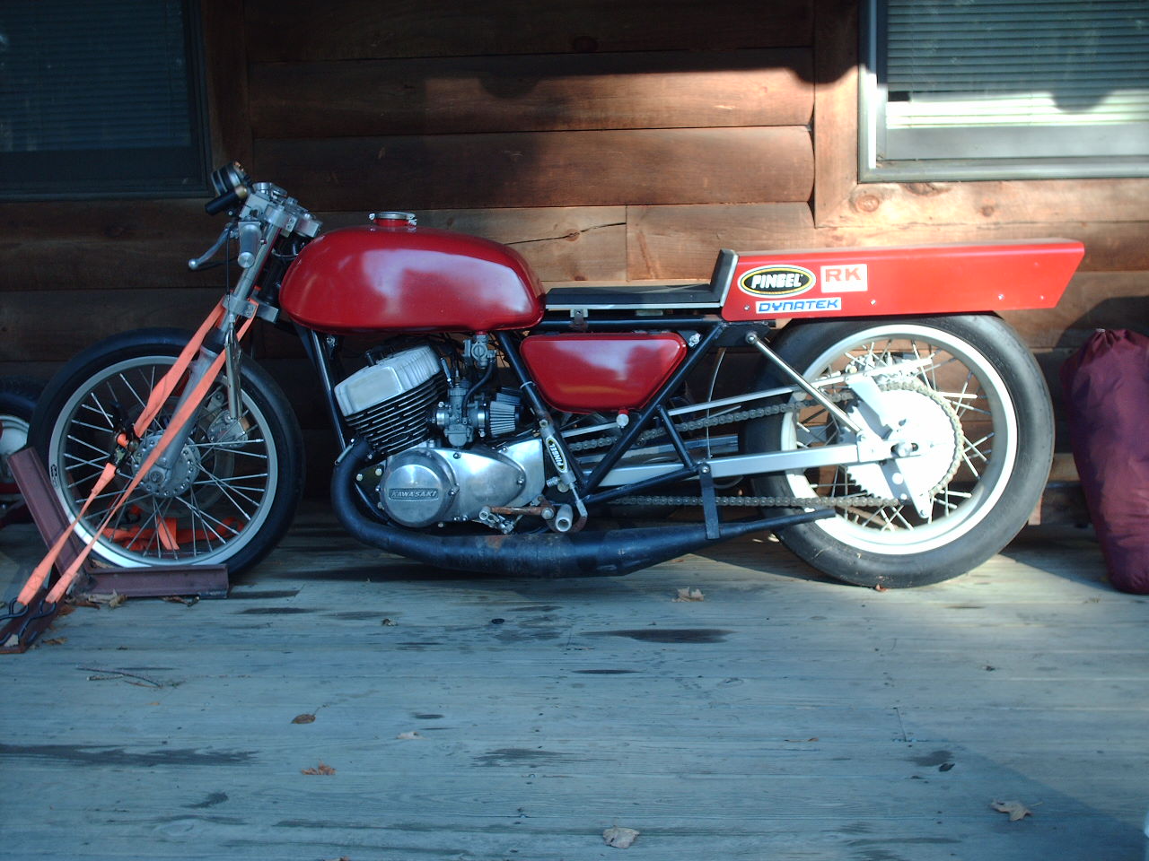

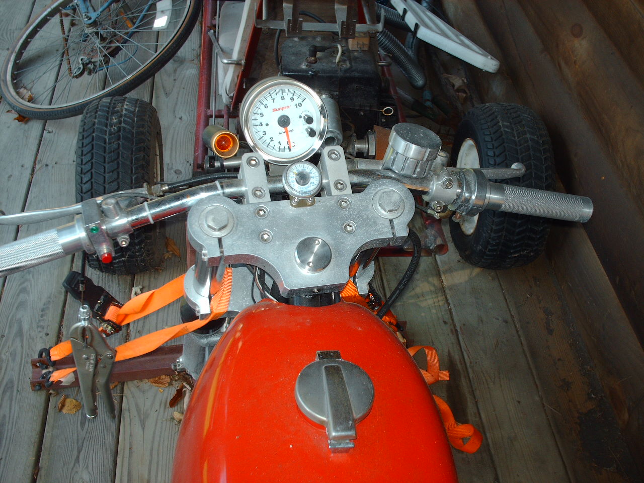

Old School Milling on a 60 year old Bridgeport! Before Cad Cam & CNC. This picture is about 10 years old.
It's an 72 H2, what a shame it's still sitting on the same porch, oxidizing away, My machinist friend's bike.
He's too busy making stuff for everyone else.

This is just the basic concept. Pinch bolts areas are still being added. No, this will not be cast. Yes, Steve, only the too needs to be dropped. I am making you and bottom because we are also changing the offset to closer to stock so I can get turning radius back.

Sounds good. Will you have some plastic mock ups to test sizing? MAN it's got to cost a bundle. If it weren't for that, I was thinking you could beef up around the top and use those extenders. I'm sure it's better the way you're doing it. Like to see pics of the progress.
Question; Weren't the early Honda top triple clamps sand cast? I read they did that until they knew if the bikes would sell or not then the tooled up molds. That's why I suggested casting the top clamp.
