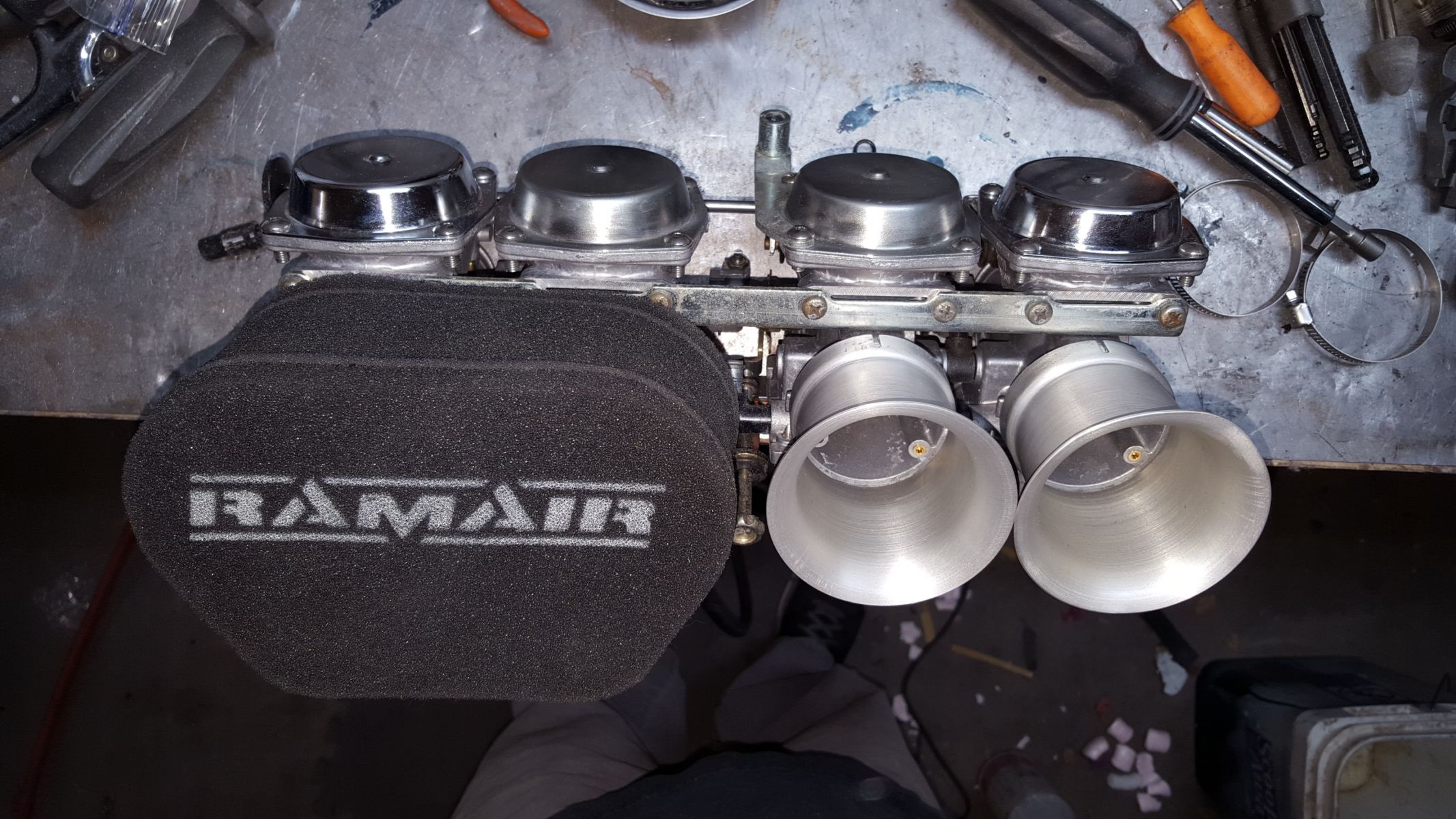

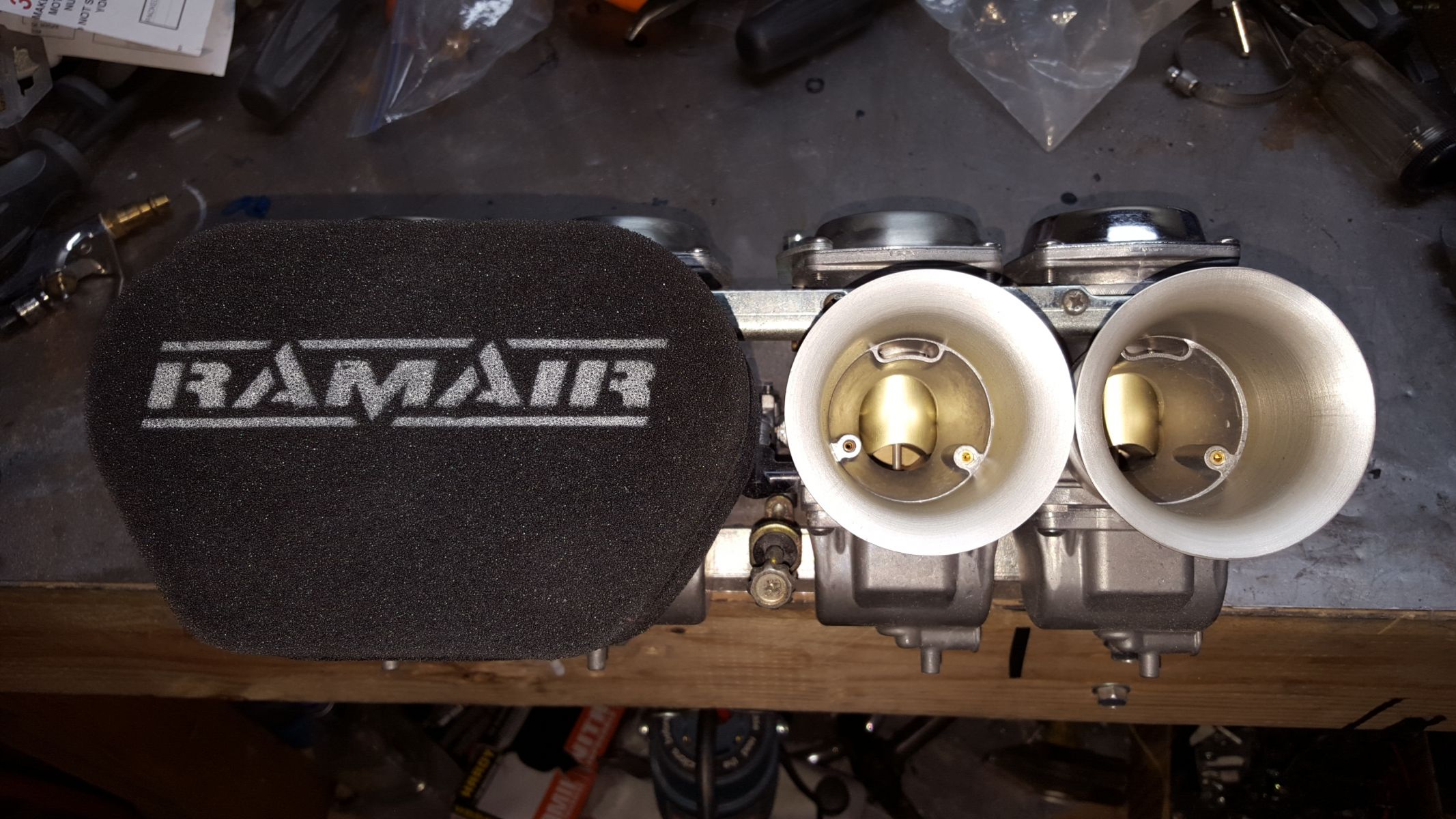

No offense taken OMR, quite the opposite., I truly appreciate the feedback.
As for the BS34's they are already purchased and the K&N stage 3 kit is purchase, carbs have been ultrasonically cleaned. There is nothing left to do other than install the kit and try them on the bike. If I don't like them then I will most likely buy some CR31's. I do have the 1075 kit, I ported and blended the head a bit and am running Andrew's 1X cams.
Due to the front end I chose to use I have to spend a bunch of money on a custom triple tree sp these cars will have to do for now. I will let you know if I owe you that Dr. Prepper or not.

I was actually looking at Microsquirt. May be something I try at another time. For now I want to get it on the road and enjoy it a bit. I have to agree with the cheap pods comment. I am running velocity stacks with filter covers so I should not have that issue.

Got the BS 34's cleaned, rebuilt and Dynajet Stage 3 kits installed. Waiting on a new throttle cable and we will see how they do.
